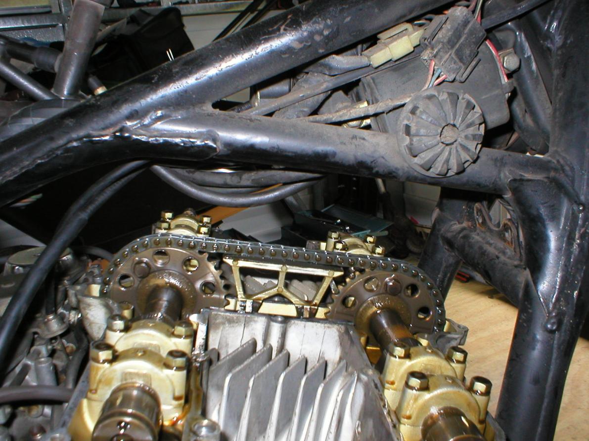

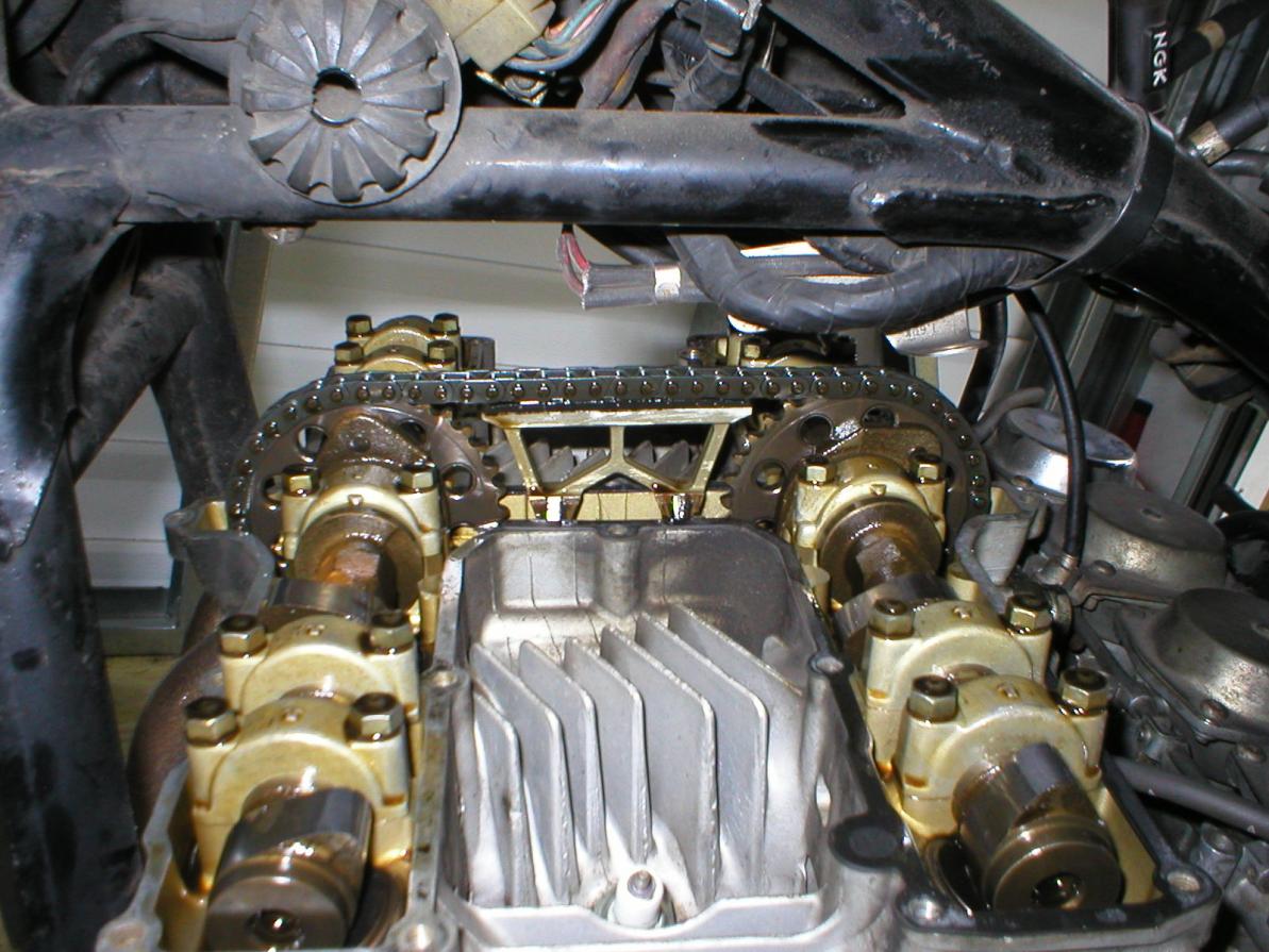

                                cover off...what to look for? Click image for larger version
ID:	870749 Click image for larger version
