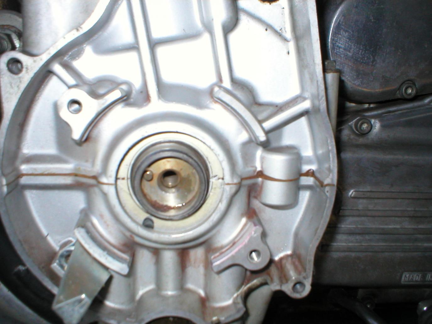

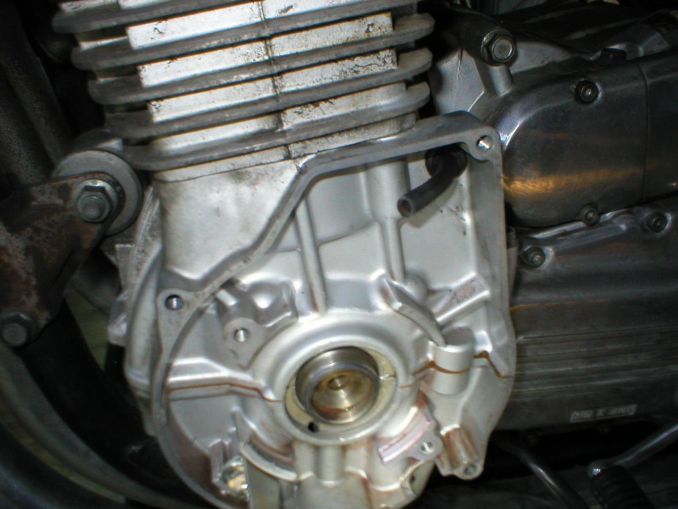

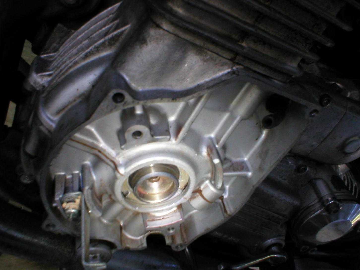

          Looks clearly leaking from the shaft and seal and nowhere else. You can sorta see the groove. This is the right part-size and depth look right. Click image for larger version

            Looks like you're on the right track, good luck with the install.

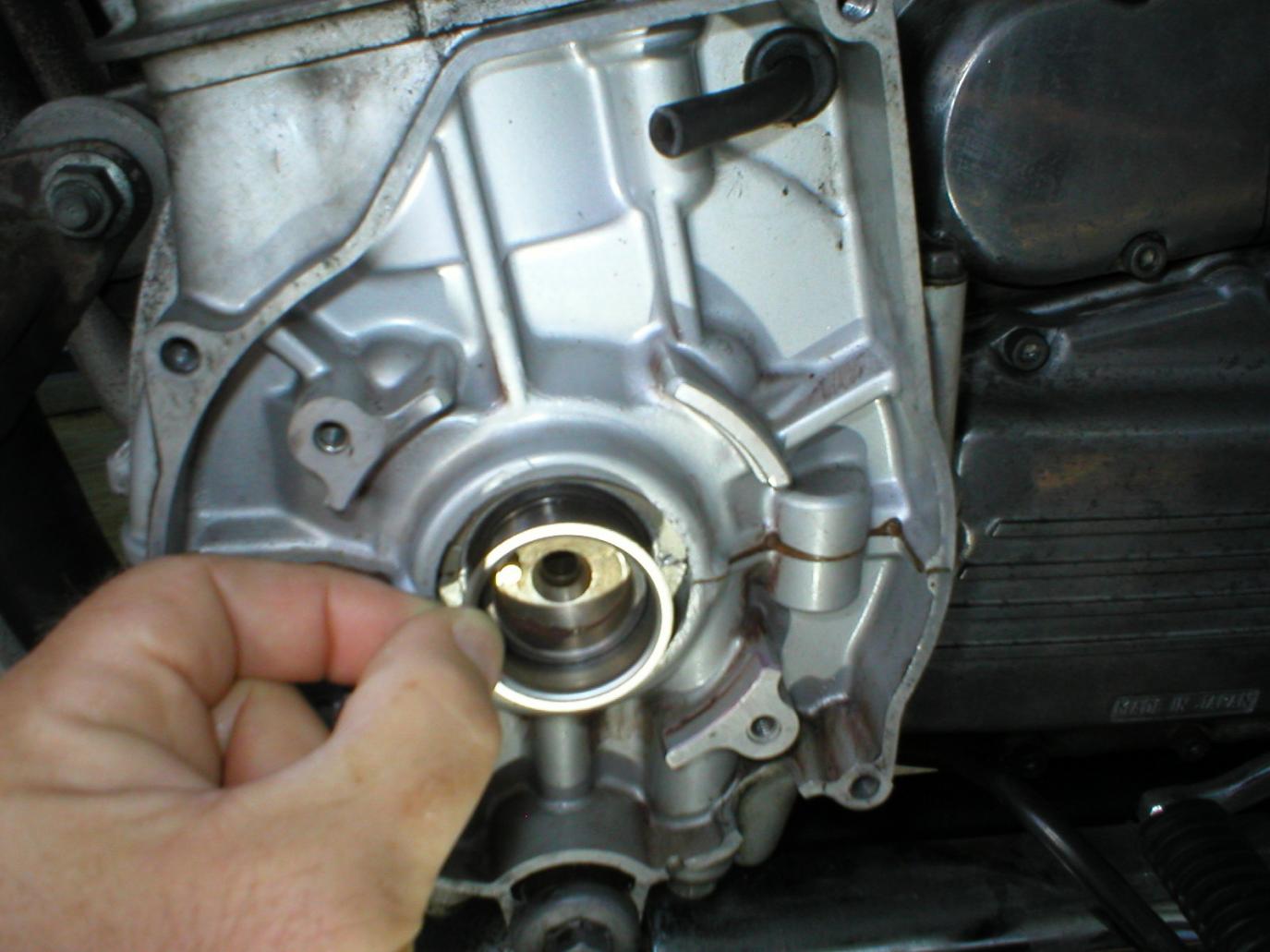

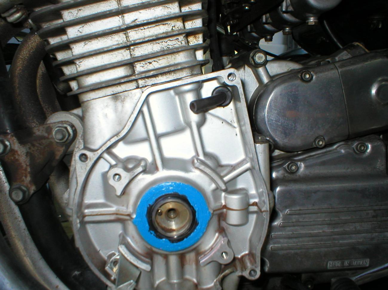

              #96

                Looks good, third time's a charm. <fingers crossed>
