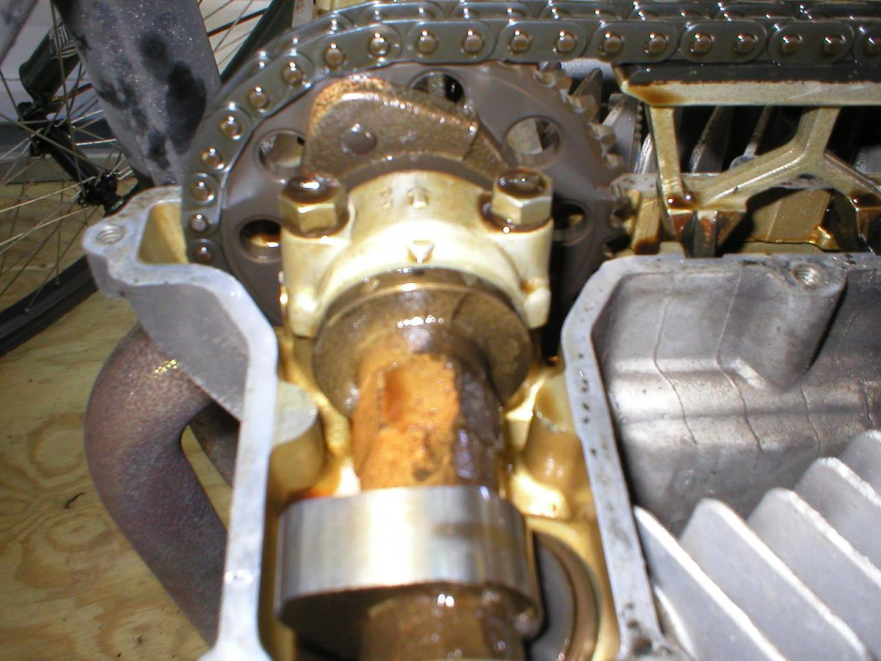

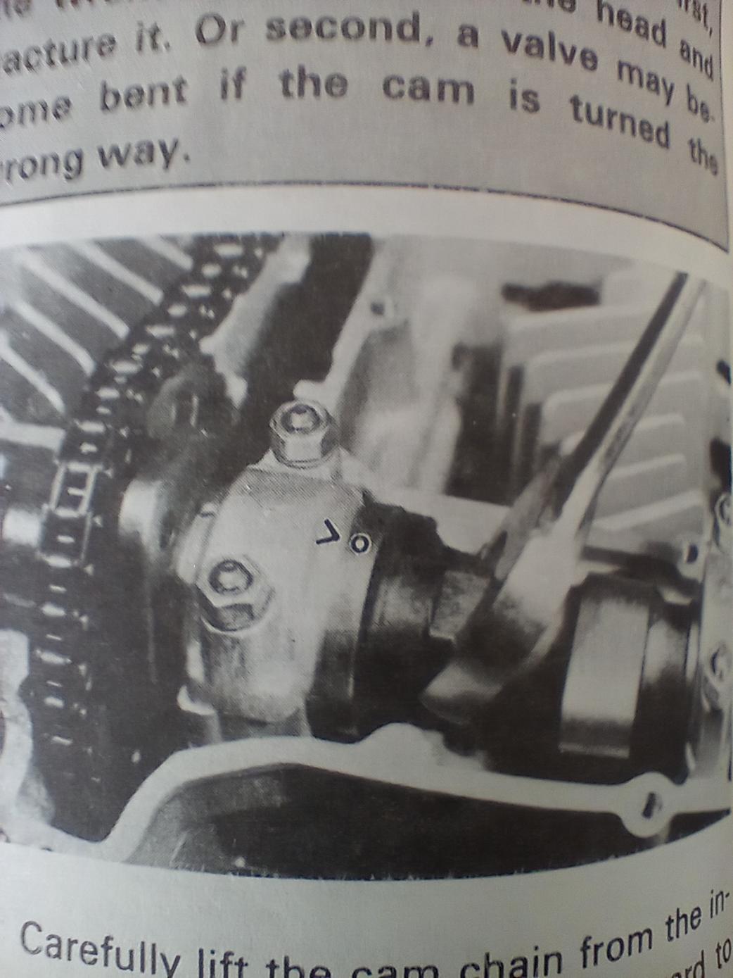

      #122
      See those arrows on the #3 cam bearing caps? There are dots on the two camshafts that should line up with those two arrows when the crankshaft timing plate is at the "T" mark.
      The crankshaft rotates 2 times to every 1 time of the camshafts.

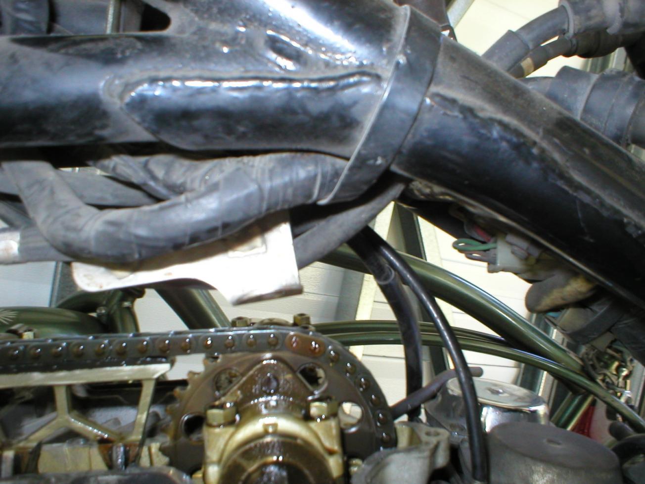

        #123

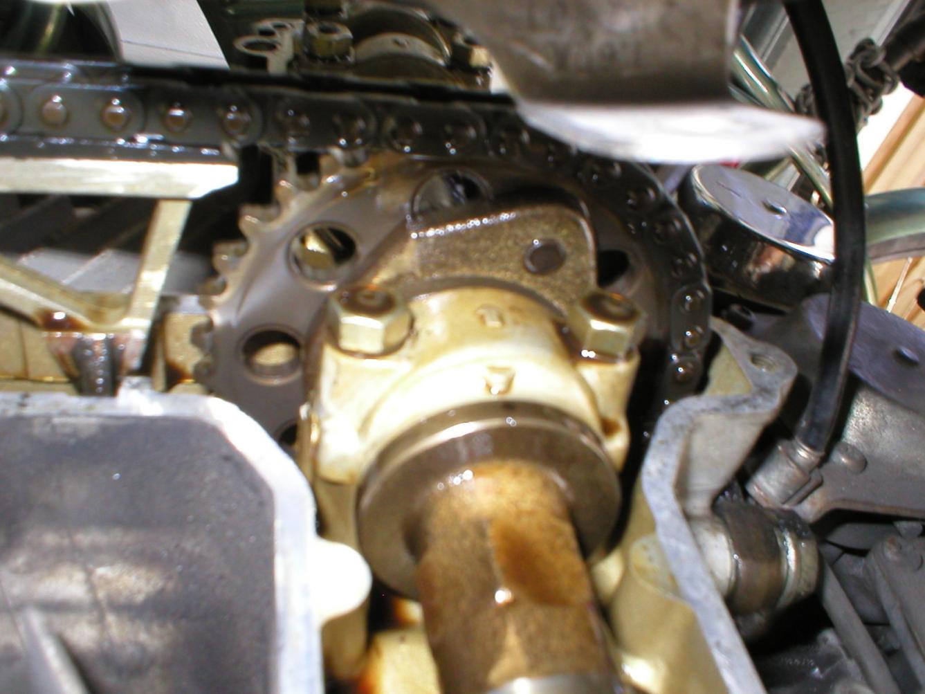

        That black dot under the chain?Click image for larger version

          #124
          No, on the cams right next to the #3 caps...

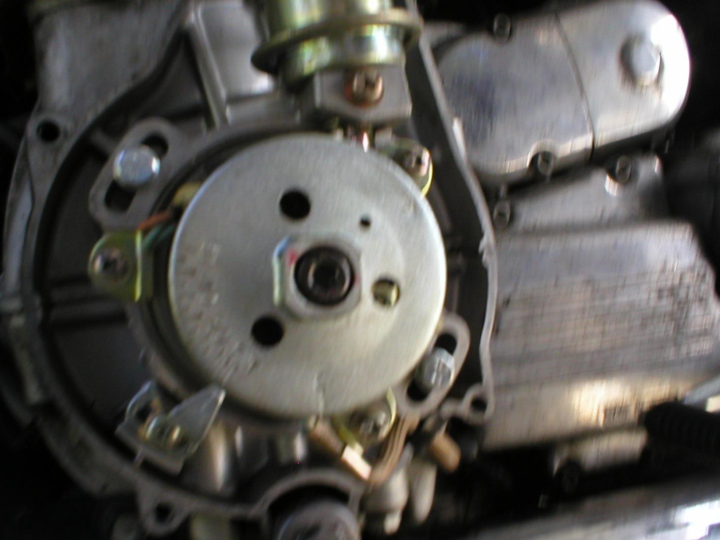

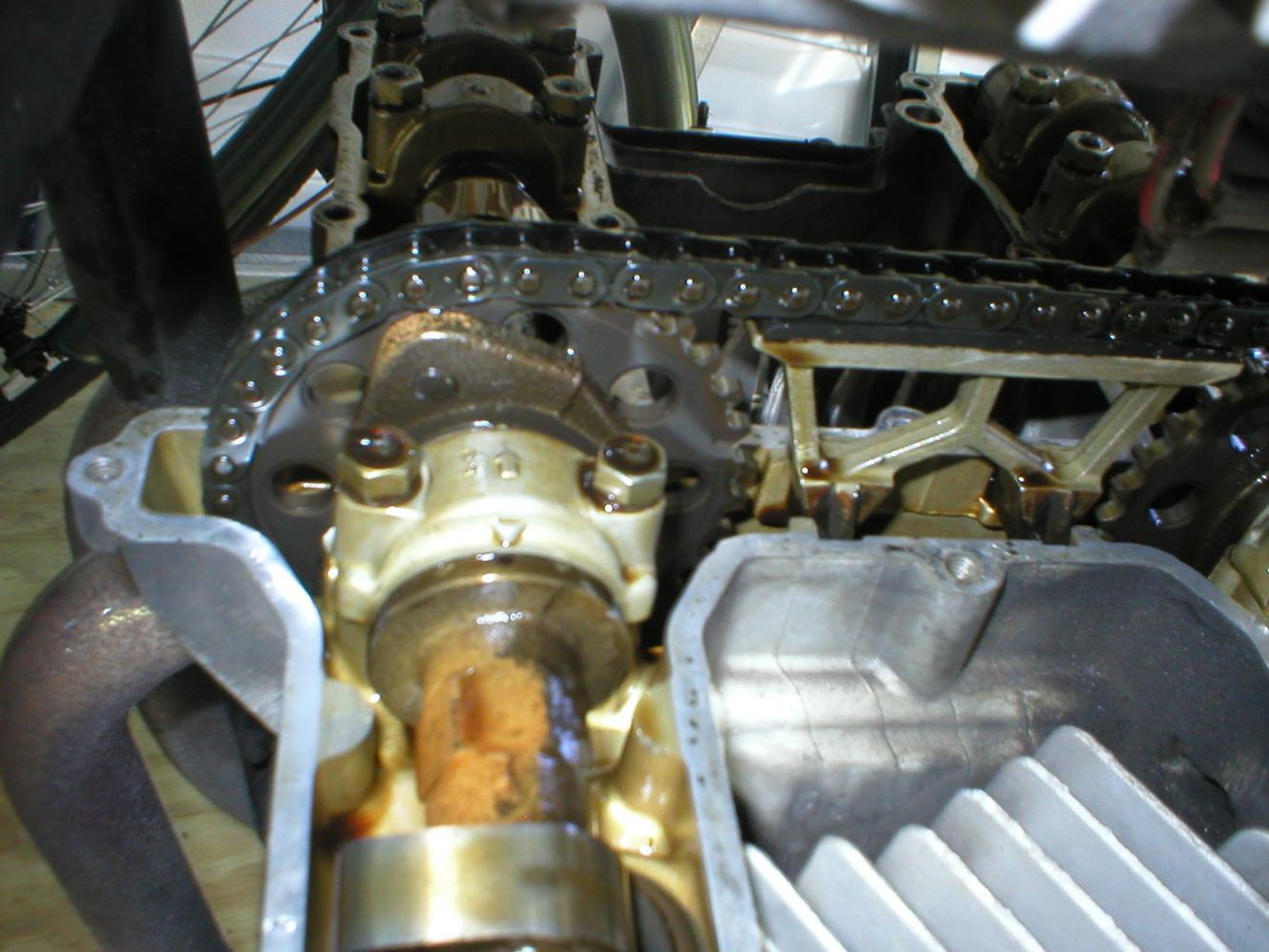

            #125
            This looks close to right. Click image for larger version
ID:	870762 Click image for larger version
ID:	870763 Click image for larger version

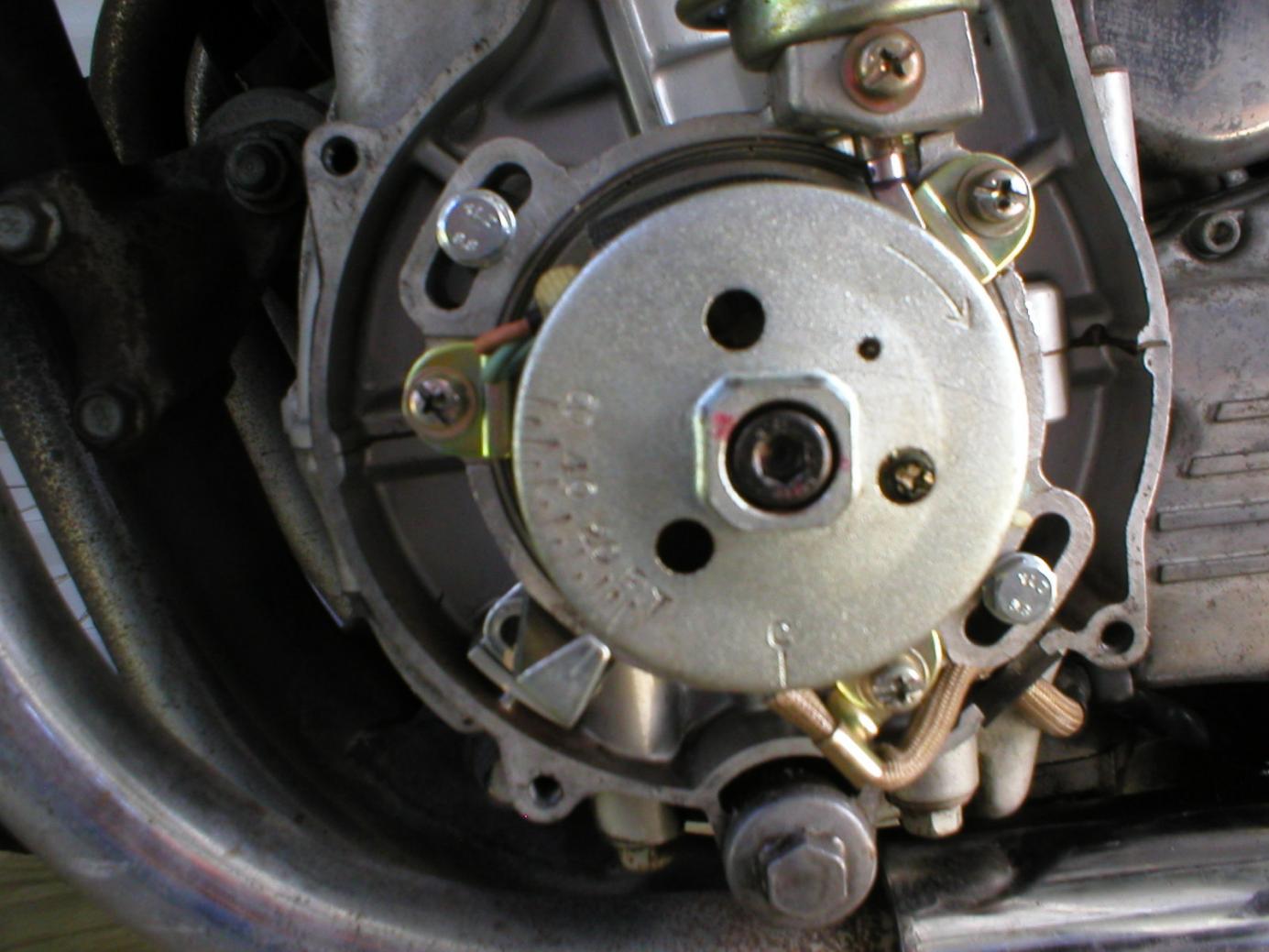

              • Gainesville, Fl.
              #126
ID:	870766 Click image for larger version
ID:	870767 Click image for larger version
ID:	870768 Clear pic
              80 G
                • 8893
                #127
                Yeah, it looks spot on. This is good. I don't know why you only had 90 psi compression, can't bend a valve if the timing is correct.

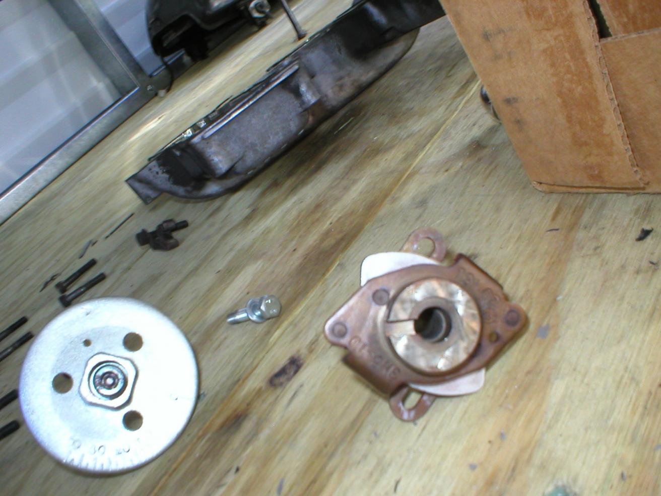

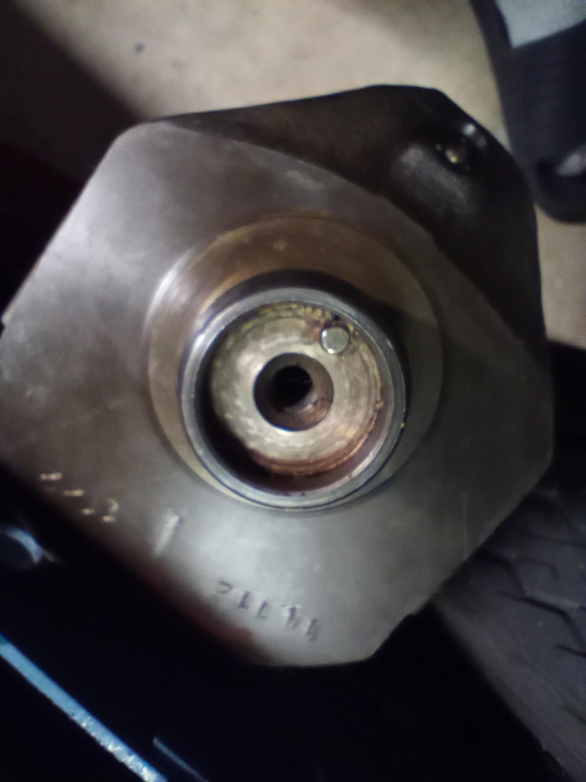

                  The only other thing I can think of ATM is when you reinstalled the mechanical timing advance in the crankshaft, the pin wasn't properly lined up and it forced it into the crankshaft causing the reluctor to move into the wrong position, causing a timing issue. You did say you had trouble tightening down the plate bolt that one time.

                    #129
                    Should I take the mechanical advance out and look at it?
                    I thought we were looking to see if the chain was off teeth.
                    I hit the mechanical advance into that pin with a rubber mallet each time.

                      #130
                      The chain did not skip teeth if all the marks line up as they did.
                      Yeah, I would double check that mechanical advance, I've made that mistake myself before. That would throw off the alignment of the timing plate I believe.
                      Also looks like your timing needs advancing a little by rotating the base plate CCW a little.

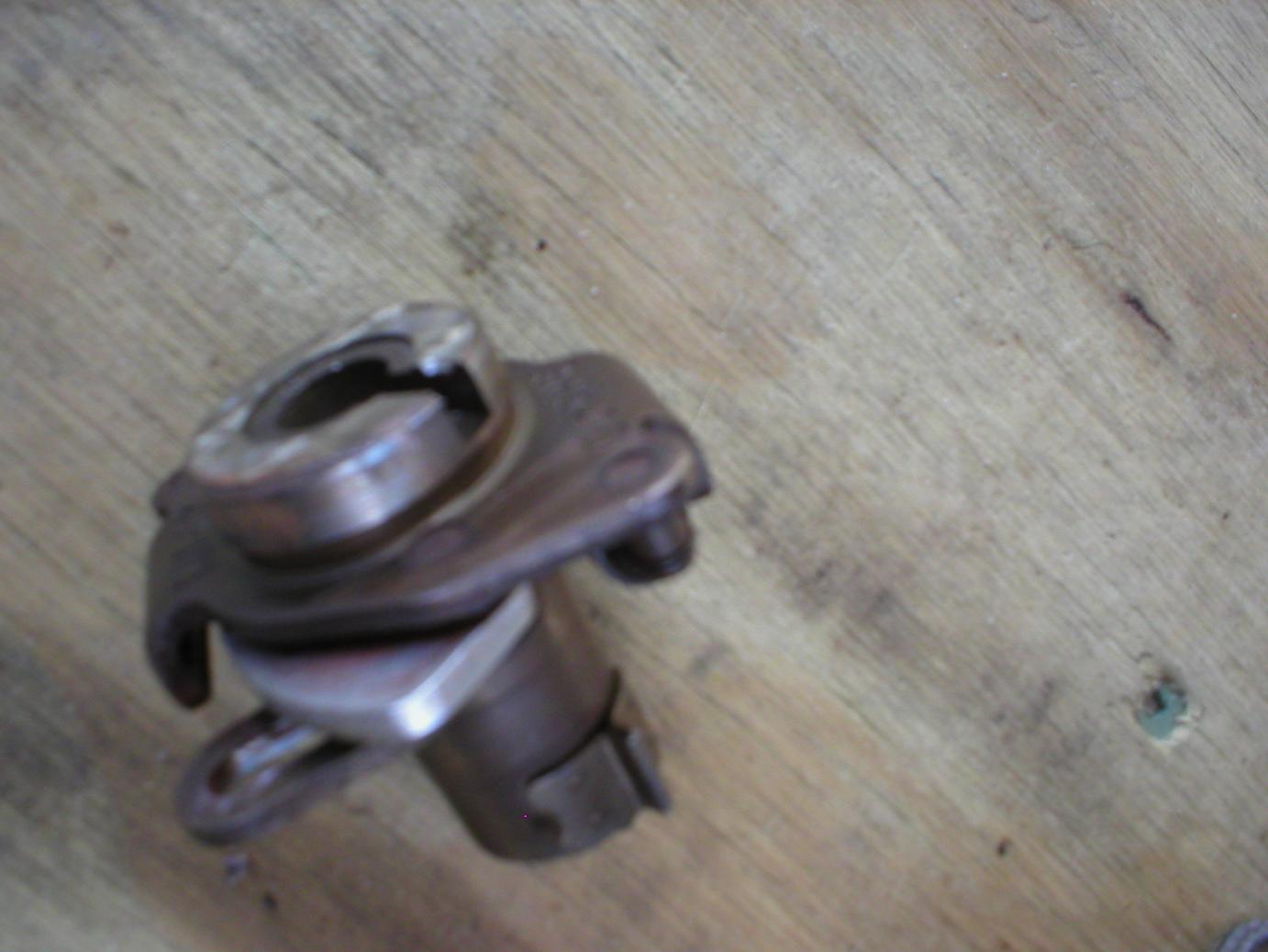

                        #131
                        There is a small nick in the mechanical advance
                        Click image for larger version  Name:	014.JPG Views:	0 Size:	125.1 KB ID:	870776 Click image for larger version  Name:	015.JPG Views:	0 Size:	98.0 KB ID:	870777 Click image for larger version  Name:	016.JPG Views:	0 Size:	98.6 KB ID:	870778 Click image for larger version  Name:	013.JPG Views:	0 Size:	110.4 KB ID:	870775
                        80 G
                          • 8893
                          #132
                          Ok, that wasn't the issue, it can now be eliminated. As for the nick, if it is preventing the unit to fully seat, I would file it down so it doesn't interfere.
