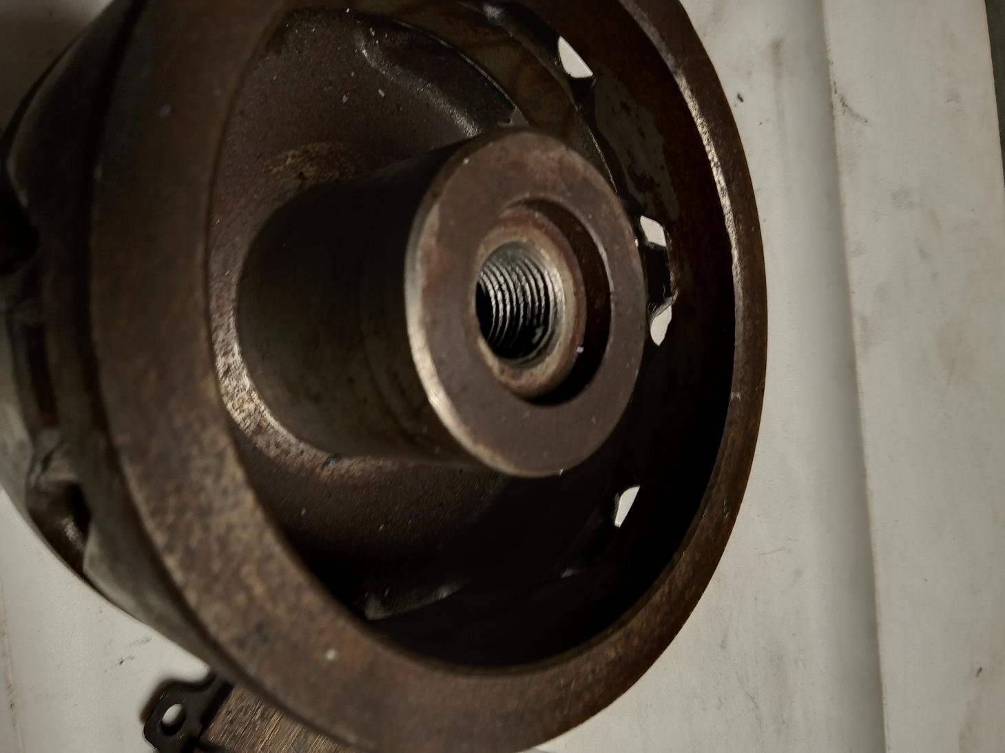

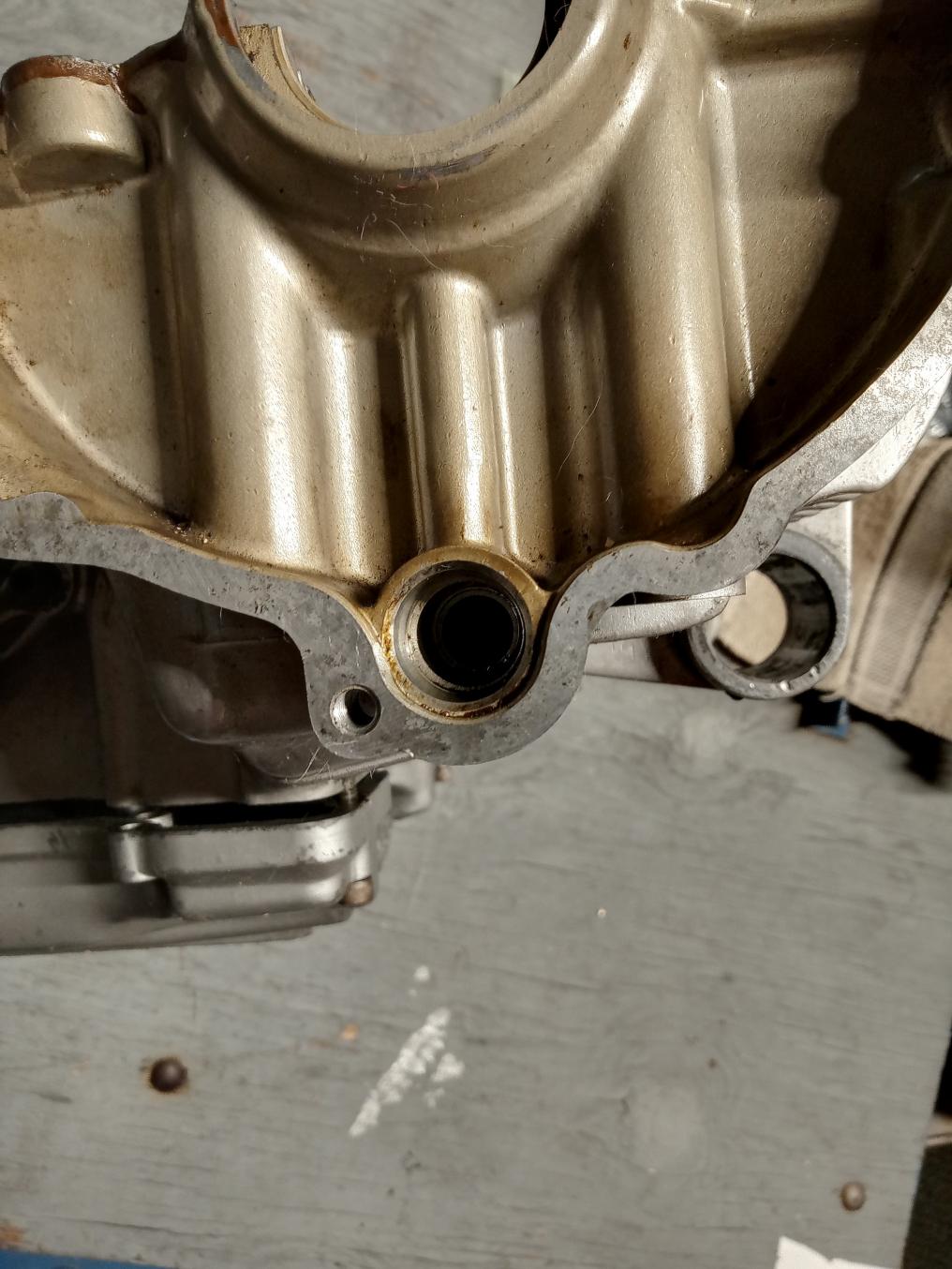

            The o ring goes on the plug under the right side cover. Pull the plug straight out with a pliers. It is a super special size o ring unlike the one on the left side.
            Click image for larger version  Name:	IMG_20220903_203220.jpg Views:	0 Size:	139.5 KB ID:	870301
            Yes, the 32x45x8 double lip is correct, better order an extra one just in case.
            As for removing the rotor, first remove the bolt that holds the rotor on. Then take the 16mm bolt and thread it into the threads on the rotor. Put a little oil on the threads first. Tighten the bolt down until the rotor pops off. When re-installing the rotor, just tighten it down to spec (47 ft-lb) with the original bolt.
            BTW, do not remove the 3 center bolts on the alternator cover, just the 5 around the outer edge. Also, do not run the engine with the alternator cover off. It is the only thing holding that plug in, otherwise the oil pressure will shoot the plug across the shop and there will be oil everywhere.
