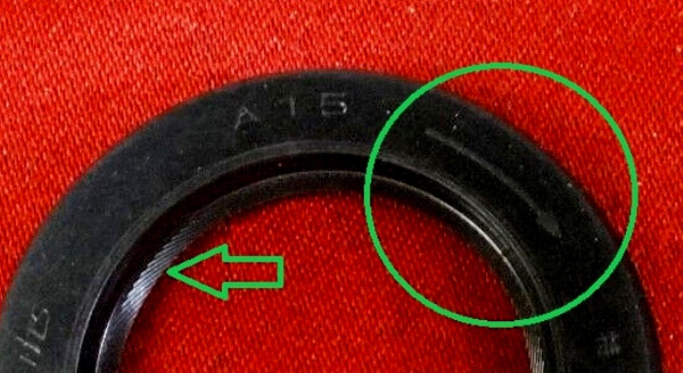

                    #234
                    Bingo! . Must be directional to pull oil in towards the motor. You can actually see the directional ribs in this picture (stock "split_the_case" type seal).

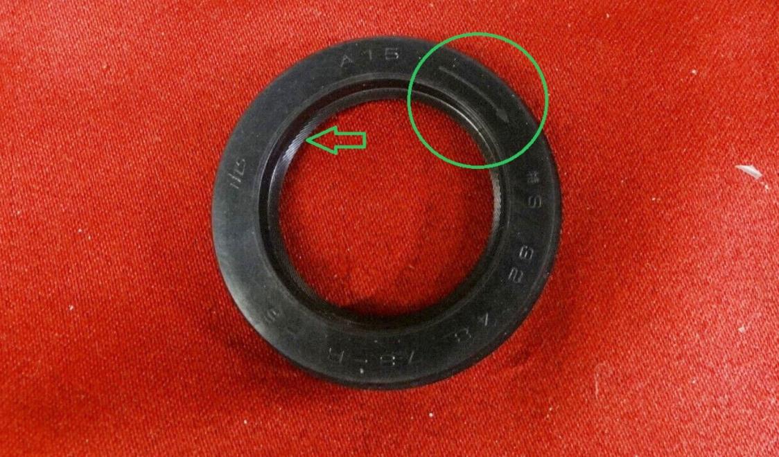

                      • 2010
                      #235

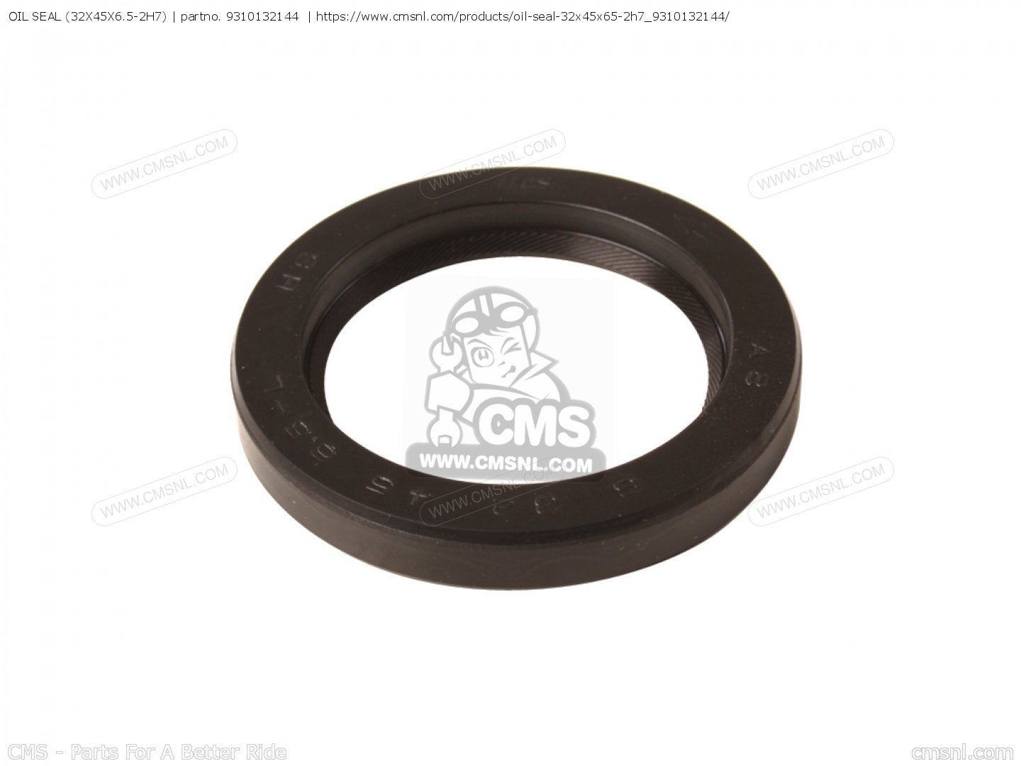

                            That may be possible. How do I know if it needs to be removed? I would then need to install another, right?
                            https://www.oreillyauto.com/detail/c...0/99128?pos=10
                            yamaha seals:
                            https://www.partzilla.com/product/ya...eeb19b62f81350
                            https://www.cmsnl.com/products/oil-s...h7_9310132144/
                            Other side replacement seal looks directional.
                            Phil's is working and mine was, the seals we are using are good steel with high temp rubber (bi-directional I think).
                            https://www.oringsandmore.com/oil-sh...-ref-cr563065/
                            https://www.oringsandmore.com/fkm-oi...rice-for-1-pc/

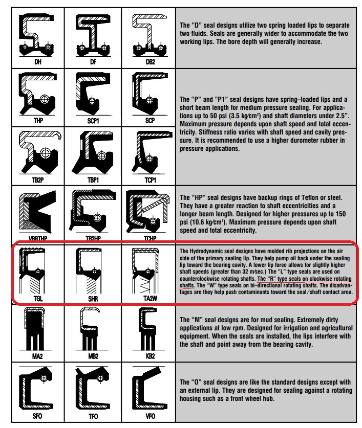

                              #239
                              There is possibly more to this seal issue than an off the shelf 32x48x8 size. Material & design of the original part must be taken into account. It's very possible that there was nothing really wrong with your installation that lasted 10,000 miles or mine that lasted 7,000 miles. I think a badly installed seal will leak right away. The issue could be seal design and material. There are directional seal designs and specific materials that come into play. Our replacement seals were possibly good but could have simply wore out quick from friction and heat and possibly directional rotation.
                              https://rlhudson.com/wp-content/uplo...seal-guide.pdf
                              Click image for larger version  Name:	seals.jpg Views:	0 Size:	221.7 KB ID:	877738

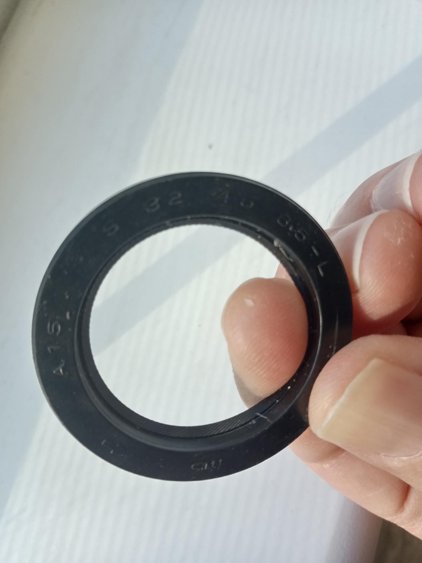

                                #240
                                The other side has lines going the other way. I got this one from yamaha. It is the replacement seal on the phish for both sides
