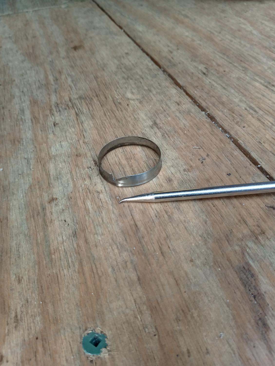

      Can Torching the sleeve to pull it out work...and be safe?
      A mechanic at a car shop said just torch the top of the sleeve and have someone pull it with needle nose pliers at the same time.
      80 G
        • 8891
        #258
        You should be OK doing that, just go easy, I wouldn't go so far as getting it cherry red.
          • 2010
          #259
          Heat should do it. You could try to start with a good heat gun and if that doesn't work a little propane with a pencil tip. Map gas might be too hot. Just be gentle with the pliers.

            #260
ID:	877802 Click image for larger version
ID:	877803 Got the sleeve out. Crank looks good.

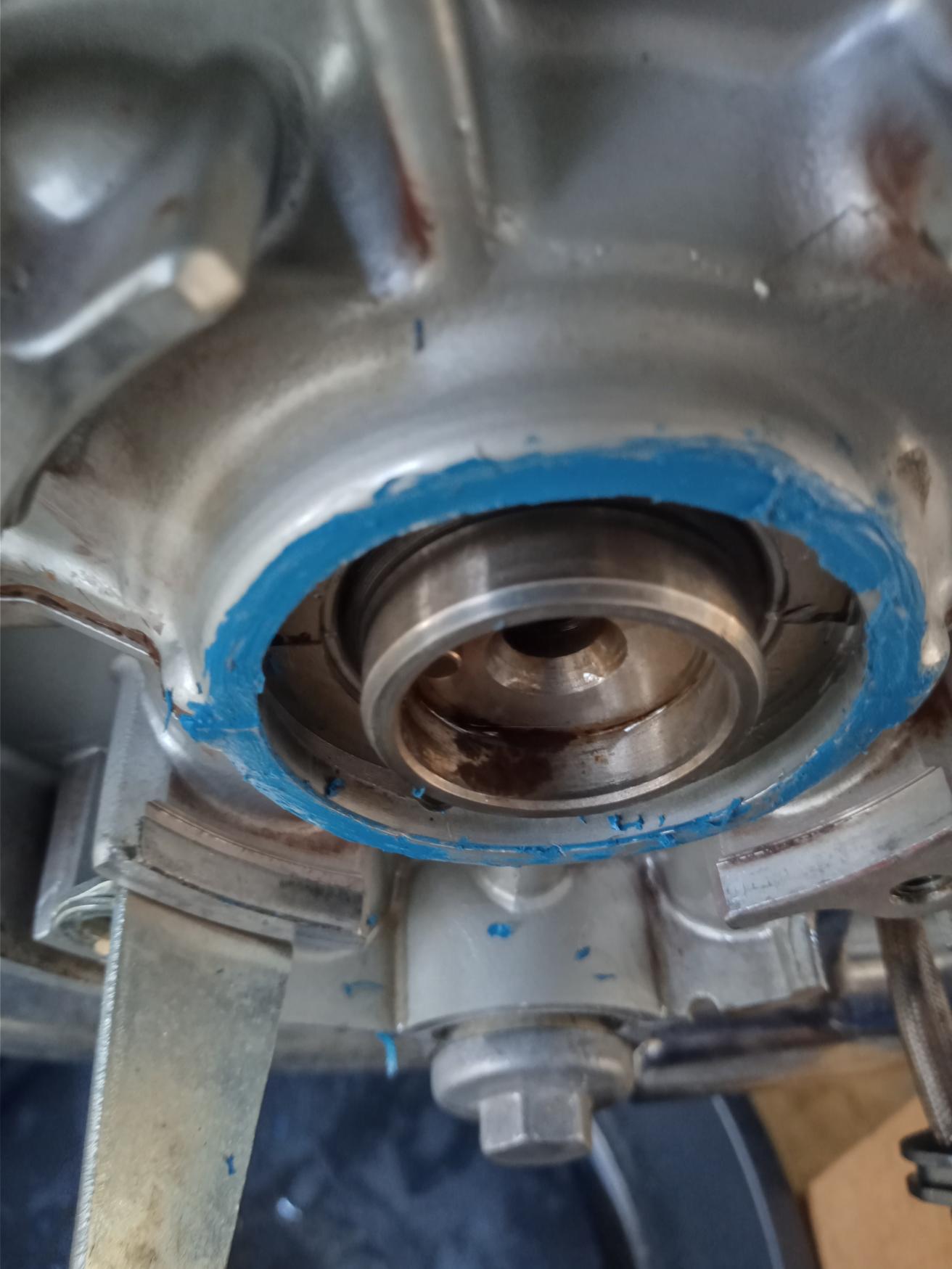

                #262
                I tried a seal without silicone and it leaked right away.
                Now got the other single lip with high temp grease on both sides of the lip and silicone on the outer edge.
                I was able to push the seal most of the way in with my thumbs since the bike hadn't cooled all the way.
                The crank is wider in toward the bike like it bellows or the opposite of a bevel. A design to ensure the seal works? The lip of the seal is against the surface of the metal around the shaft and on the back edge.
                The sleeve had conformed to this shape reflecting and has a groove from the seal.
                I believe this means the seal needs to be as far in as possible to seat right.
                80 G

                              #269
                              After it set overnight, got it back together, runs great - need to put miles and see if it is sealing. new seal 65,100 mi
                              I'm trying to cancel the order for the 7mm seals- I don't think it'll work.
                              Might get more https://www.oringsandmore.com/metric...-ref-cr563065/
                              Working on Phil's bike and on mine it was for a while...
                              80 G
