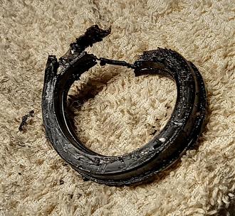

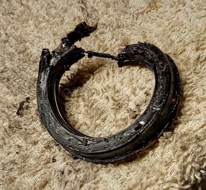

      I just did one of these crankshaft seals, it is a real pita getting the old one out. The seal has a lip on it that rides in a groove. You really have to destroy the old seal to remove it, trying not to gouge the aluminum case or scratch the crankshaft. The replacement seals don't have the lip, so installation is a breeze.

          It took me about 30 minutes to get this seal out...
