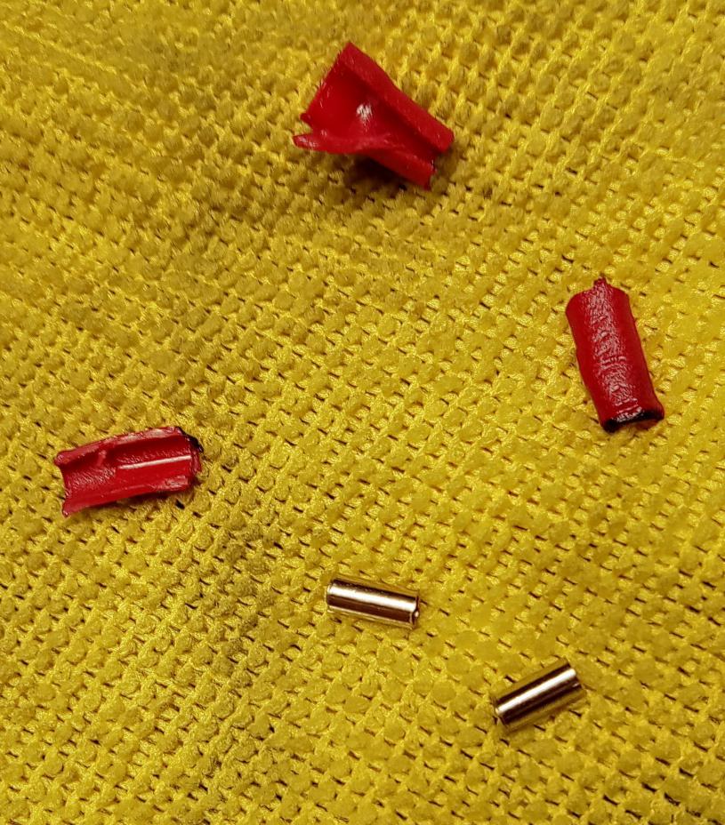

            Well, if you think a wire is broken causing the misfire, you need to pull on them in small segments and if one is broken, it will stretch. If the factory crimps holding them to the backing plate are still in tact, that is a common place for them to fail.
            The method I use to fix the break is...
            Cut a red butt connector in half with a hack saw. Use a lighter to heat and soften the insulation so it can be cut and removed easily. Now you have 2 small butt connectors. Just slip a small piece of heat shrink tubing on the wire before crimping.

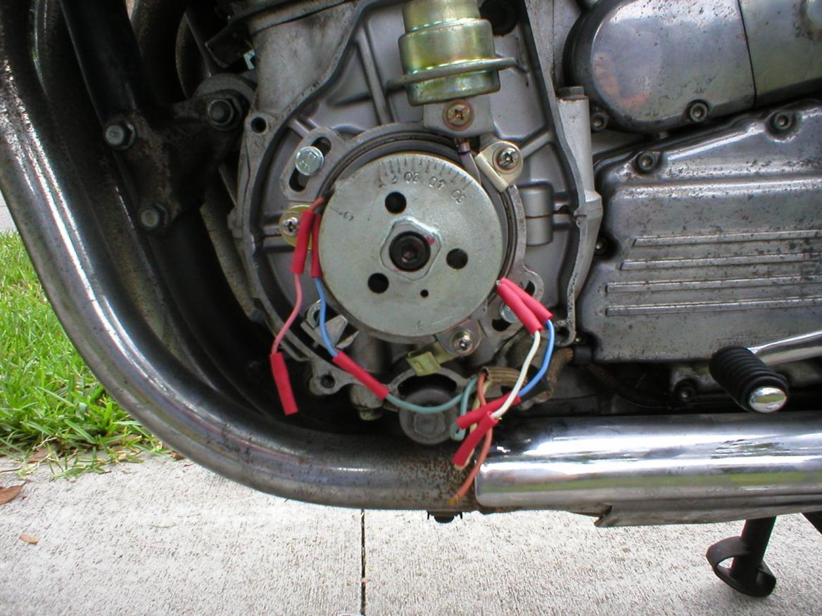

                  Speedlimit85, the wire you replaced look ALMOST correct. The BIG problem I can see is there isn't a lot of room for the wires to flex as the plate moves left and right. Did you check and verify the wires will not get tight at both ends of travel? If they do, you may be able to fix it by keeping the zip ties loose, as in a 3/8" loop, and not tight to the backing plate.

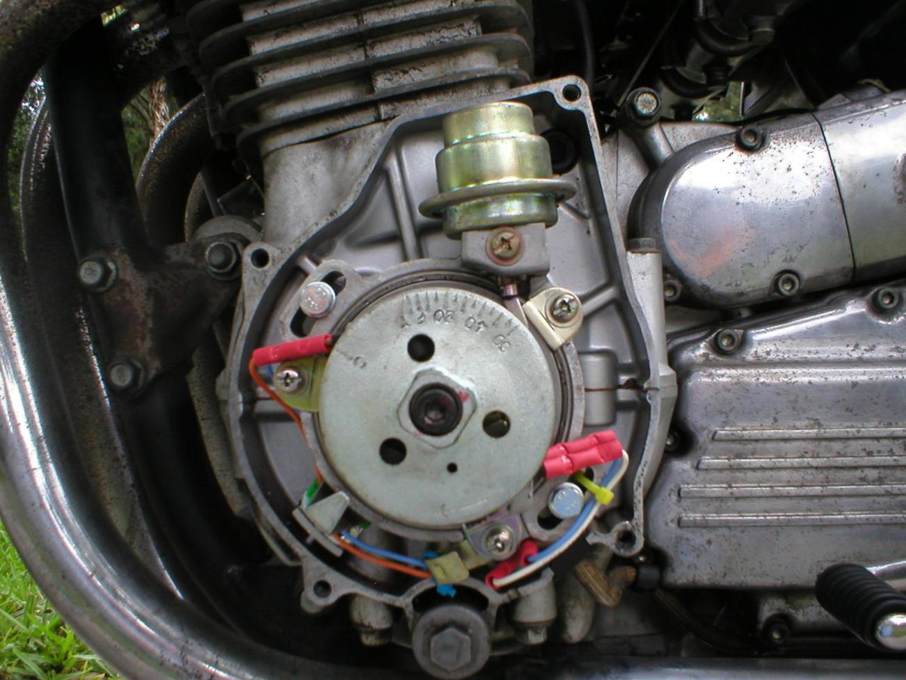

                        This is the bearing right here. You can spray some penetrating oil on this gap in several places around the clock to ensure smooth travel. Wipe the excess away. Nice that you found some NOS P/U coils.
