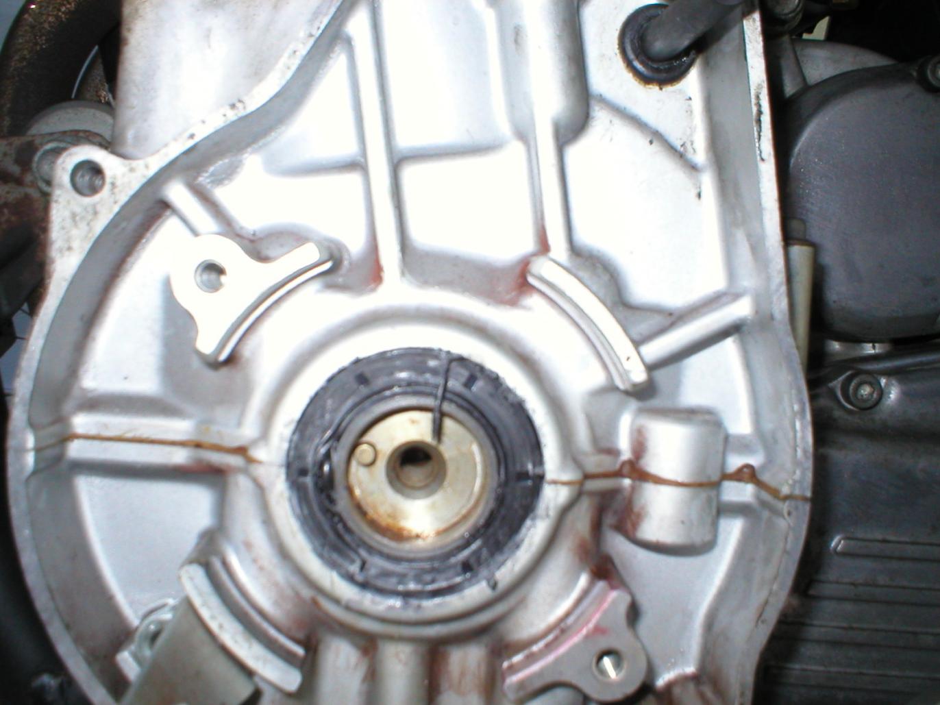

ID:	869811 well, that's not right. I need a new one. I need to put it in right.

              Is this the wrong seal? the seal is 30x48x8 but the label is 32x48x8
              80 G

                The numbers should be stamped on the seal 32 48 8. If the inner diameter is 30 on the one you installed, that would explain why the seal collapsed.

                  Yes. They are sending me the right one.
                  80 G
                    • 8938
                    #39
                    That's good, put a little oil on the inner part of the seal before installing the new one. So if I understand correctly, the wrong seal was in the box marked 32x48x8?

                      Yes. I didn't look at the seal only the label. I thought I was doing it wrong-was hard to install. After getting the seal out saw the numbers on seal were wrong.
                      I was told gasket maker-silicone on the outer part too.
                      80 G
                        • 8938
                        #41
                        Yes, thin layer of gasket maker on the outside edge of the seal only, a little oil or grease on the inner part of the seal where the crankshaft spins.
