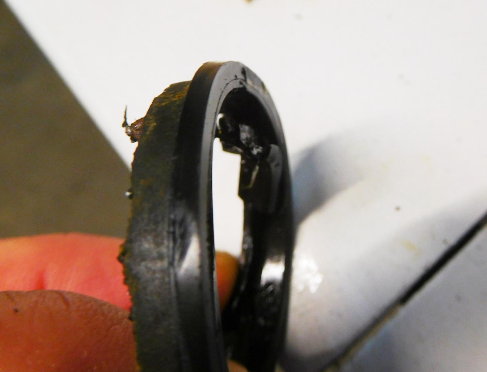

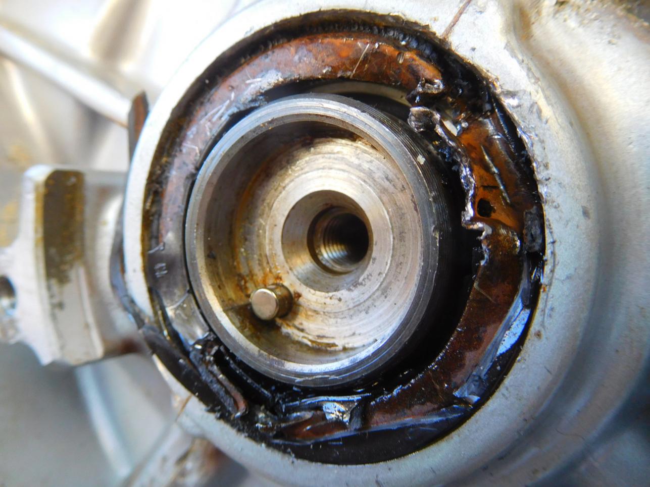

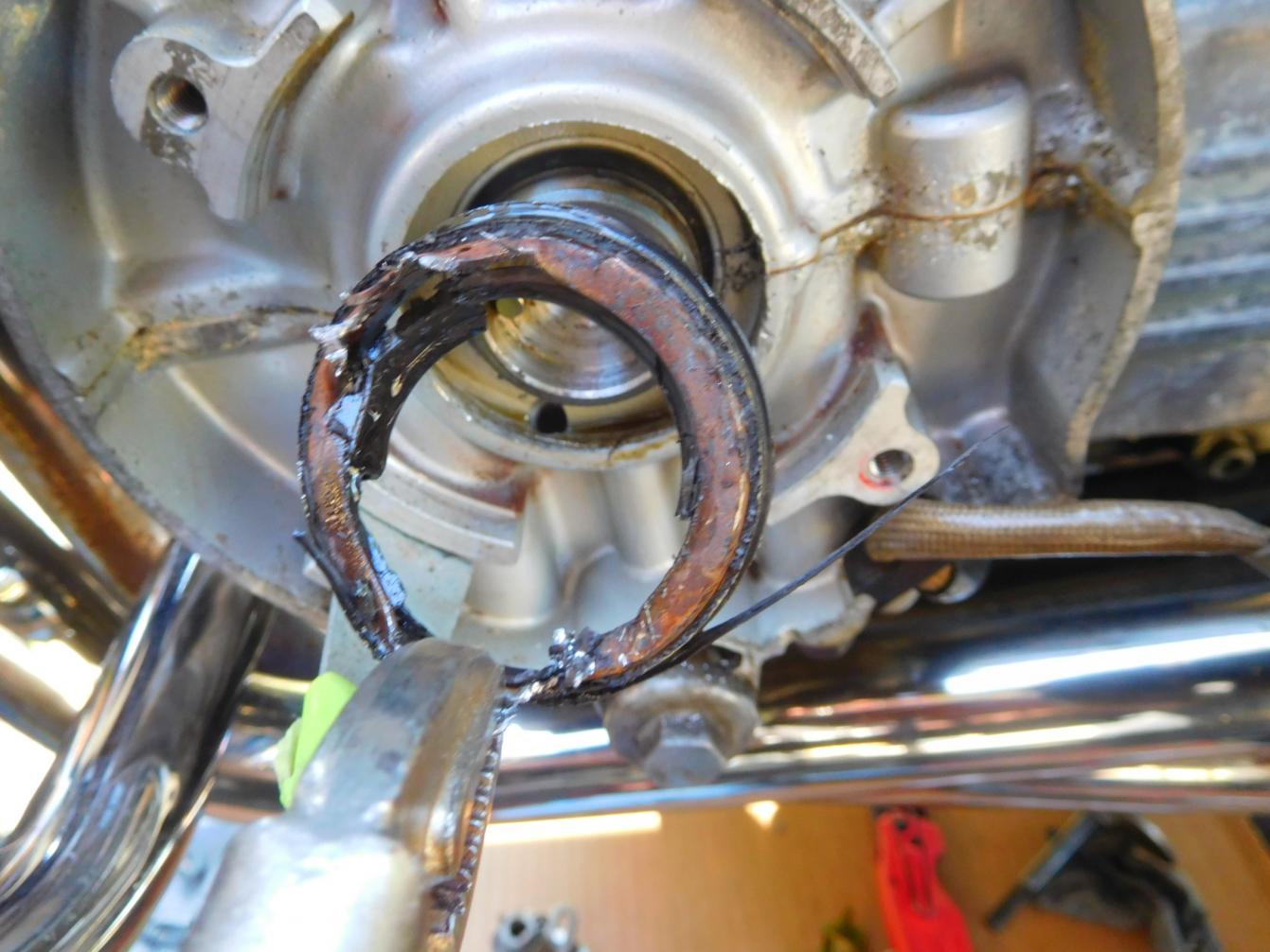

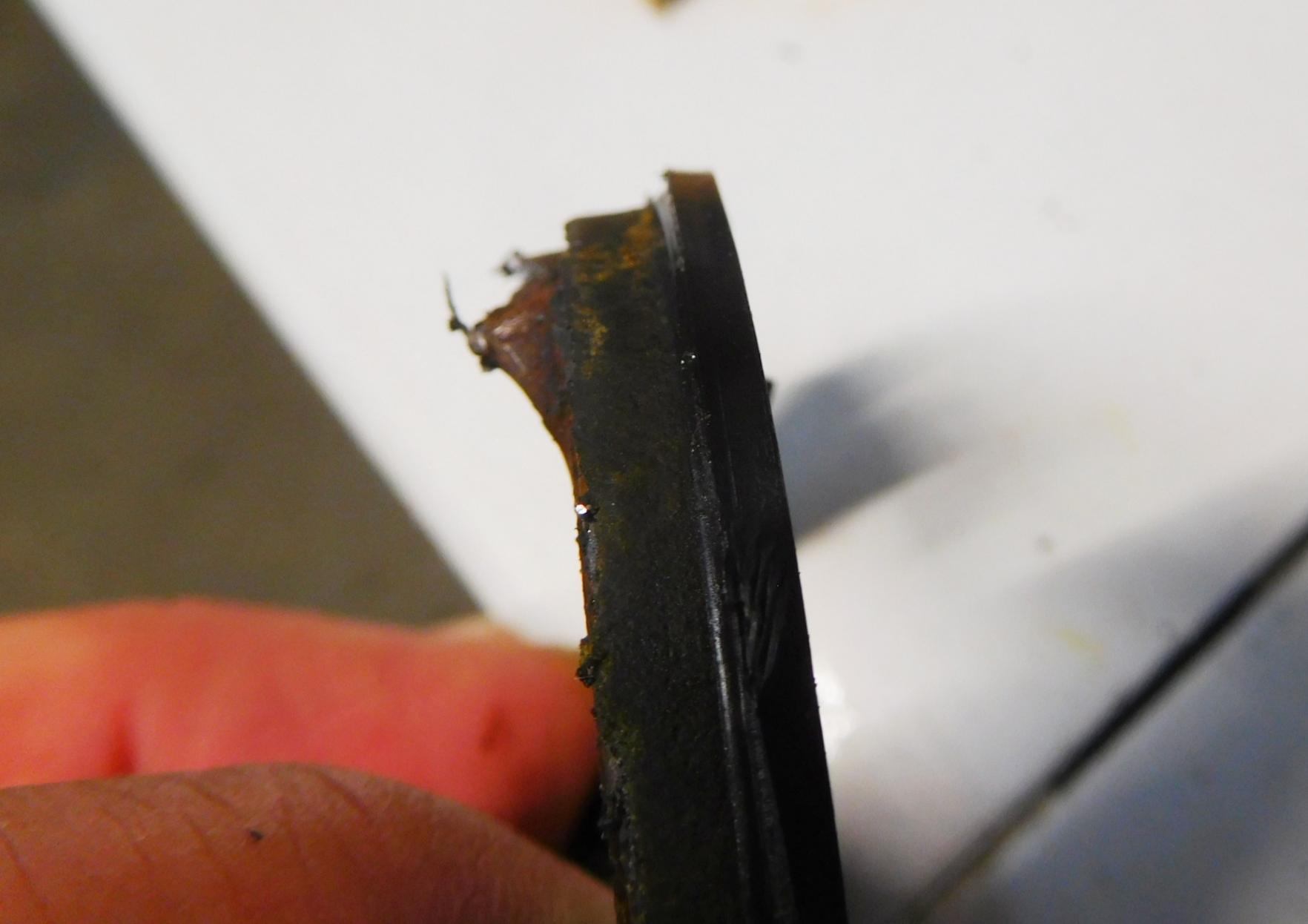

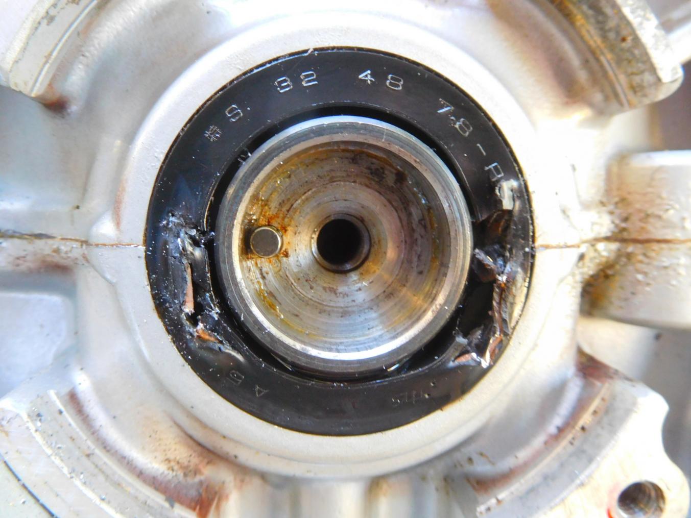

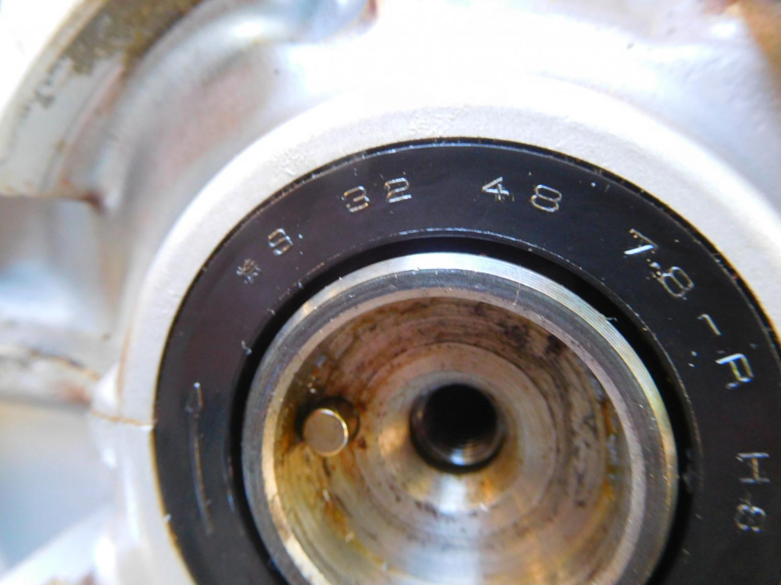

                    OK, I did the repair with the info Phil & Speedlimit85 have provided. The old seal has a lip on it that holds it in the case so its real fun to get out. Just be careful not to hurt the case or the crankshaft end.
                      • 2010

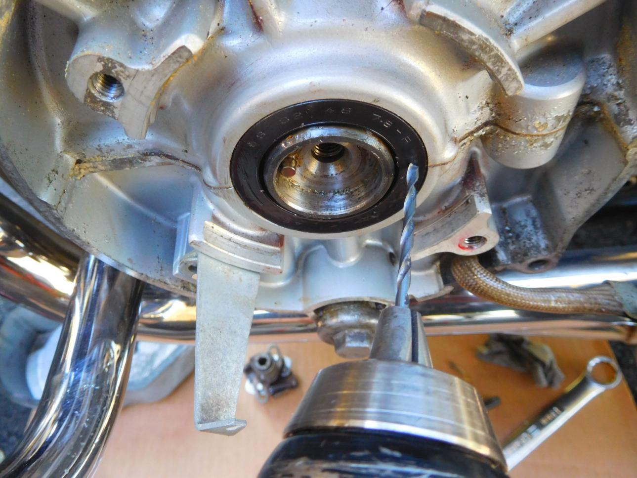

                      #190
                      I started by piercing the rubber covered metal portion of the seal. Only drill through the seal with the lightest of pressure so the bit does not hit the soft aluminum case which is only millimeters away. Start to carefully remove as much rubber as possible using an Xacto razor. Then pull out enough metal to grab on a good size chunk with Vice-Grips. I used a large seal puller tool to fully remove it from the case. Remember - the seal was not to be removed in this way. It was designed to be removed by splitting the cases so it needs an considerable amount of force that could easily damage something.

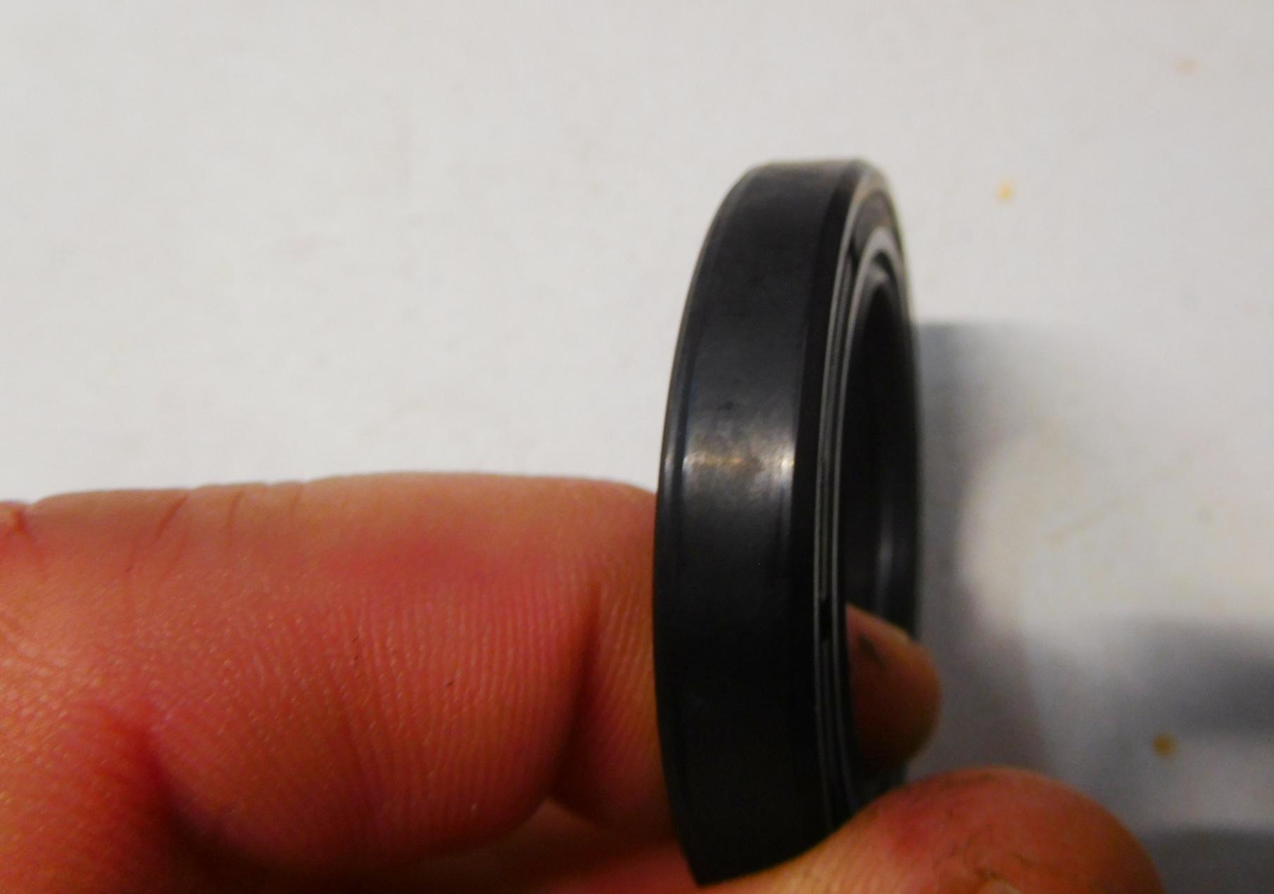

                        Here you can see the lip on the old seal and the new seal with its conventional flat design.

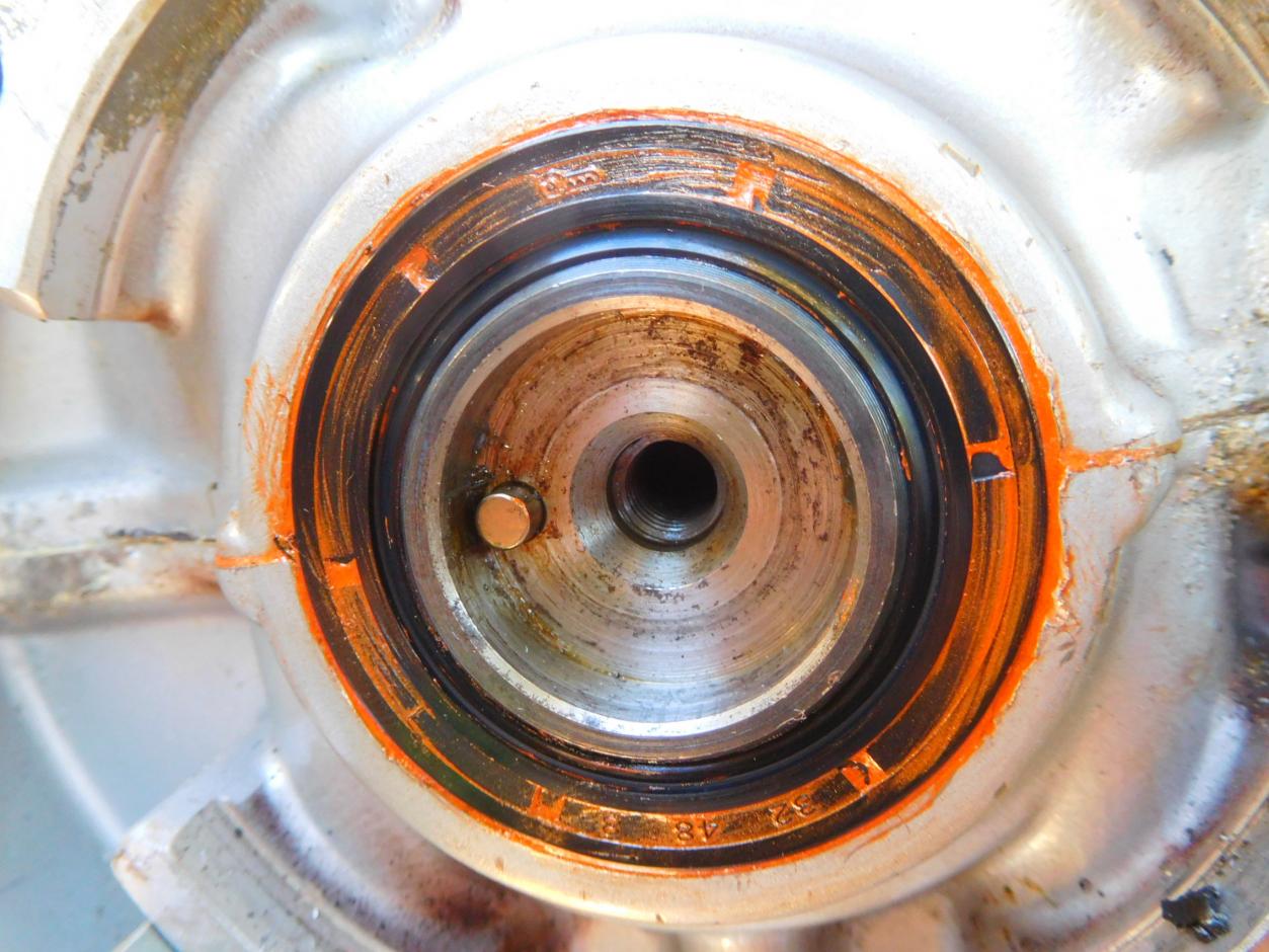

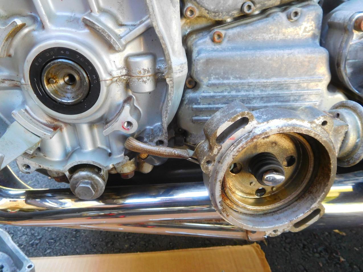

                          The new seal installed. I like to use copper RTV. Let it set up for 24 hours and took it for a good 50 mile ride. No leaks so far. Thank you to all (especially Phil) for the good info.

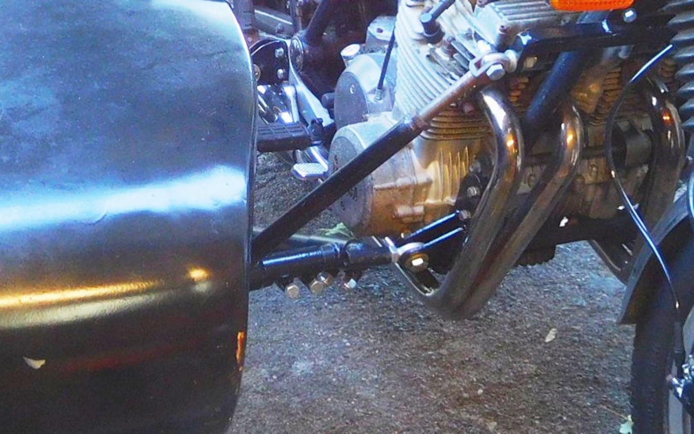

                              Yes, the level of difficulty will be higher because of the rotor. Luckily I have had it out a while back when I changed motors and re-gasketed the cover. The part that I do not look forward to is disconnecting the entire sidecar so I can get at the cover. I did buy the seal to have it ready on the shelf along with another new gasket. I will post if it happens.
