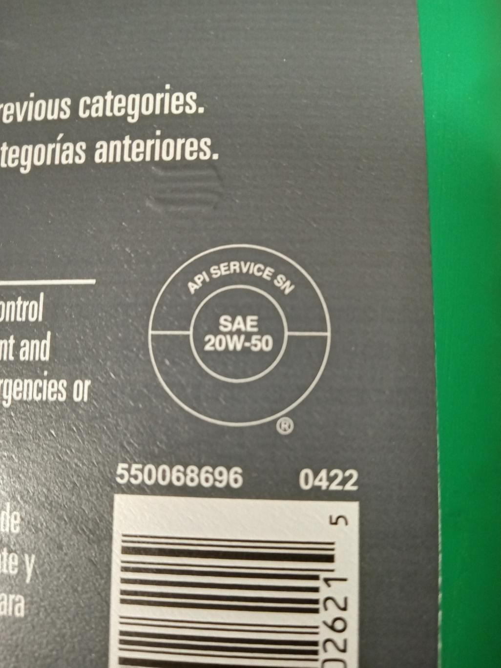

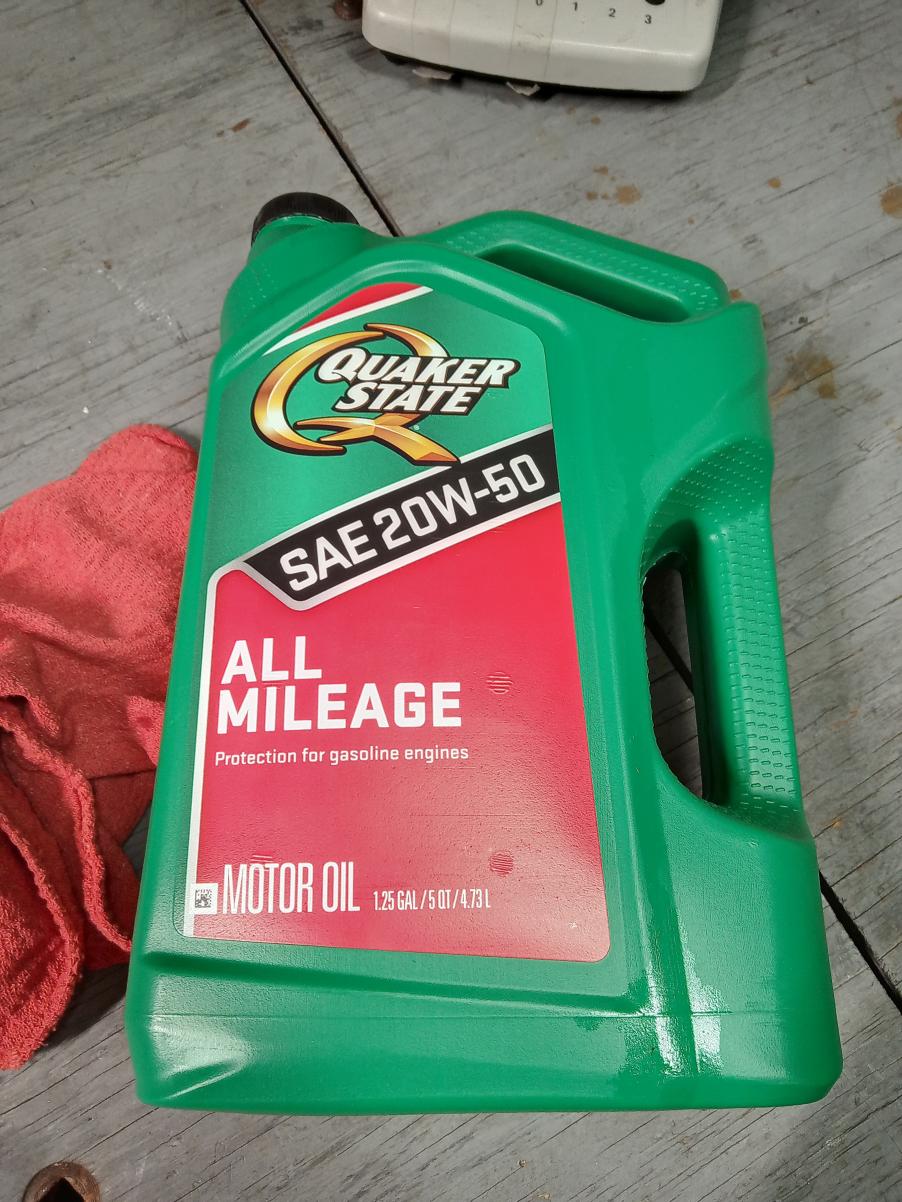

                      Yep, I would try the 20W50 conventional non-synthetic next time around. Yes it is a bit thicker and with 58K on the clock, that's what I would be using. The crankshaft bearing clearances on these old air cooled engines is a bit on the large side, so the thicker oil should help.
                      The 20W50 is getting more difficult to find these days, your Walmart should carry it for $18...
                      The Supertech brand in the blue jug has been changed to a semi synthetic, so this seems to be a suitable replacement.
                      Click image for larger version  Name:	IMG_20230121_085628.jpg Views:	0 Size:	159.2 KB ID:	871750
                      Click image for larger version  Name:	IMG_20230121_085706~2.jpg Views:	0 Size:	130.5 KB ID:	871751

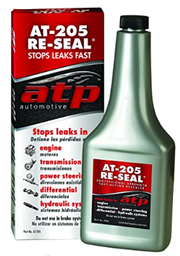

                          If you end up having to revisit the seal, try this stuff. I fixed three hydraulic actuators with it. It works and my save you the hassle of repair.
