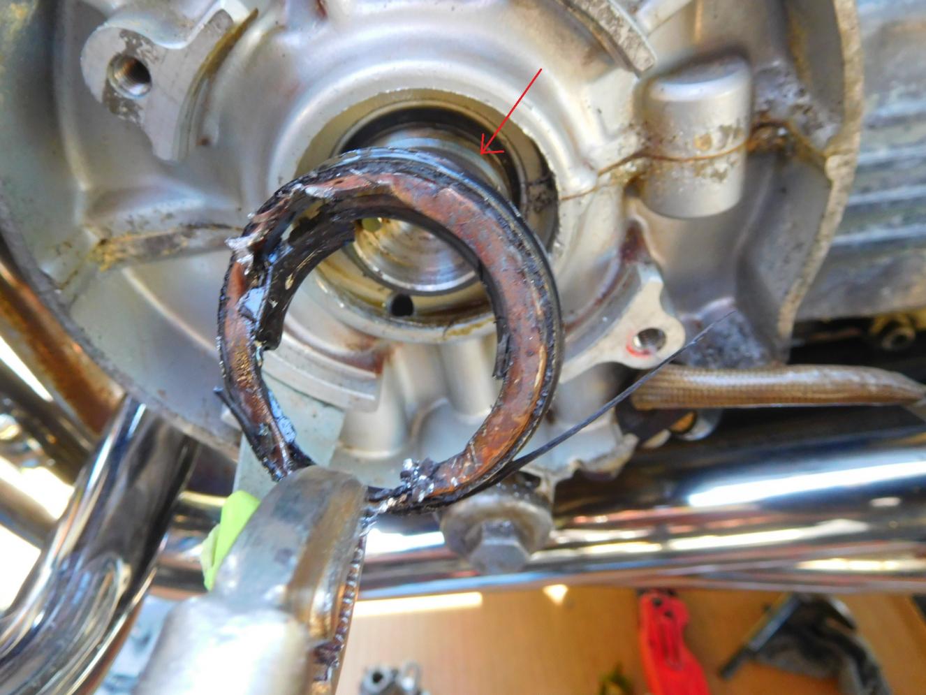

        well after 10,000 mi leaking againClick image for larger version

          #199

              #201
              yea..there was a sliver of metal from edge of speedy sleeve may have cut the seal.
              no way to see if oil got under the sleeve.
              no room for tape to prevent cutting seal.
              I plan to sand the edge of sleeve to make a smooth edge for installing seal.
              This repair was working for thousands of miles, but it should last longer.

                #202
                I was going to try to make a cone out of tape and after the seal is seated, pull it out. I think the leak after many miles of heat and petroleum may have something to do with the rubber itself. Could be Chinese.

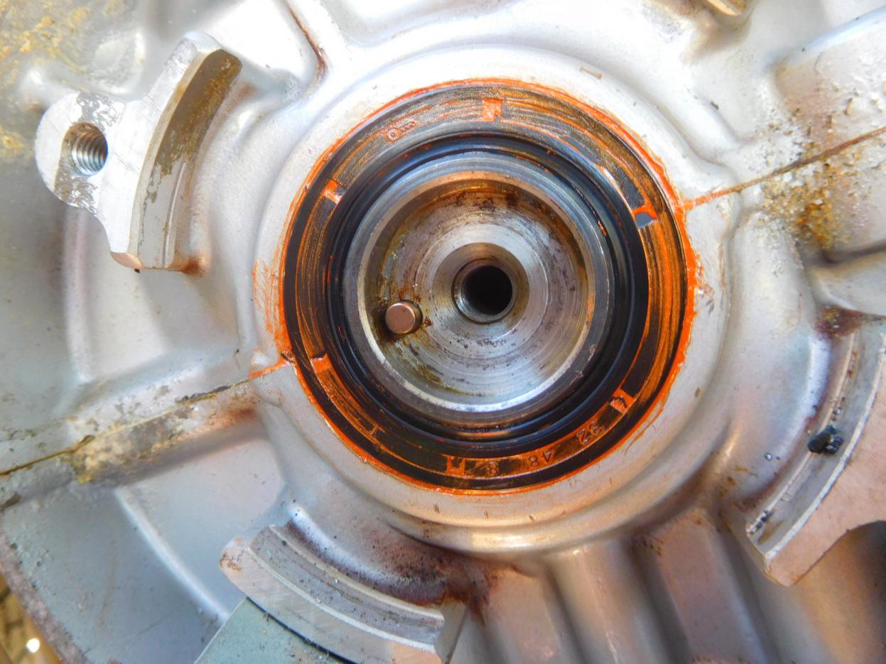

                  #203
                  Stocking distributor of metric o-rings and seals in various materials and sizes. Metric Orings in Buna 70 & 90, Silicone, Viton and EPDM material.
                  I will install this one.
                  It is only leaking from the inside edge and should be fixable...i hope

                    #204
                    I don't see room for tape.
                    80 G

                      #205
                      Ya, that looks better. I think FKM is Viton. I think I will try this part also. If you sand that surface I would used 1500 or higher grit wetted with oil.

                          #207
                          I cannot this leak. Is it on the inner or outer edge?
                          80 G
                            • 1922
                            #208
                            That was actually the picture of the repair done at the time. I believe it is leaking on the crankshaft surface like yours.

                              • Gainesville, Fl.
                              #209
                              may try teflon tape
                              80 G
