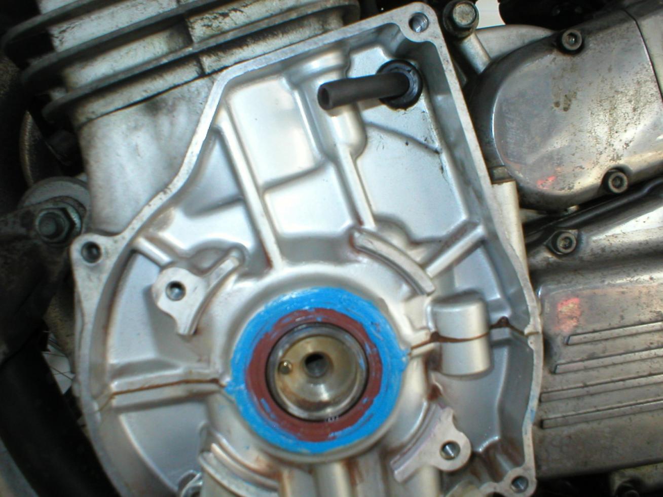

    no room for tape. I did the best I could. Click image for larger version

      Looks good. Hope it works. Hey Phil, yours is still good? How many miles?

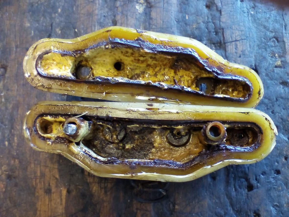

        Still good, I did the repair about a year and a half ago, probably around 15K miles. I didn't use a repair sleeve.
        Hey Eric, If it starts leaking again, I would verify that the breather element inside the air box isn't plugged up. They can get pretty nasty with this Florida humidity.

            Had the airbox out changing the intake boots and it looked good to me.
            The original seal is unavailable- even splitting the cases would not fix it.
            The speedy sleave looked ok to me but it might get a groove like the crankshaft did from the seal over many miles.

              I got a good feeling about this one 65,000 mi
              Phil, those scrambled eggs could be wax from the Pennsylvania oil.

                #217
                Yep, I think all conventional oils have paraffin wax but Pennzoil and QuakerSnot probably have the most. ​​​​

                  #218
                  I break cleaned the oil and old silicone
                  I sanded the edge of the speedy sleeve with 800 grit-wasn't sure which way to go- in out or back forth. Painters blue tape might work if done right.
                  Then put oil on the lip and silicone on the out part of the seal.
                  I hammered a piece of wood against the seal and then a big socket, left it overnight.
                  80 G

                    #219
                    And got oil in the cover right away. I am really disturbed.
                    I am buying 2 more to try and install better.

                        800 grit might be too rough and if you crossed the direction of rotation that would be bad. Micro grooves may be present. You need 1500 + as mentioned and you would need to polish in the direction of rotation wetted with oil. Not across. Maybe a new sleeve is in order.

                            #223
                            That seal and got 2 more coming. I sanded wrong but just the edge, electric tape seems strong to protect it if I can cover the edge cone and remove after seal is in.
                            How to remove the sleeve if needed?

                              Not sure. Never used one.
                                • 2103
                                #225
                                Use a dremel tool with a cutoff wheel and a steady hand, only cut half way through the thickness, then using a small straight pick or sharp scratch awl inline with the crankshaft right at the score line, carefully tap the point of the pick/awl in between the sleeve and the crank to split the sleeve off of the crank.
