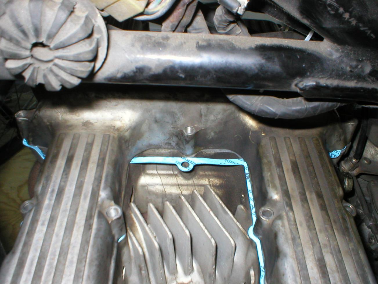

                            The gasket is clearly just a bit off and will not work. I talked to the bike mechanic who would not do the seal. He said test pickups then test spark like down a list...
                            It was running right then felt like running on one cylinder. Could be anything unrelated but it feels electrical like the pickup coils.

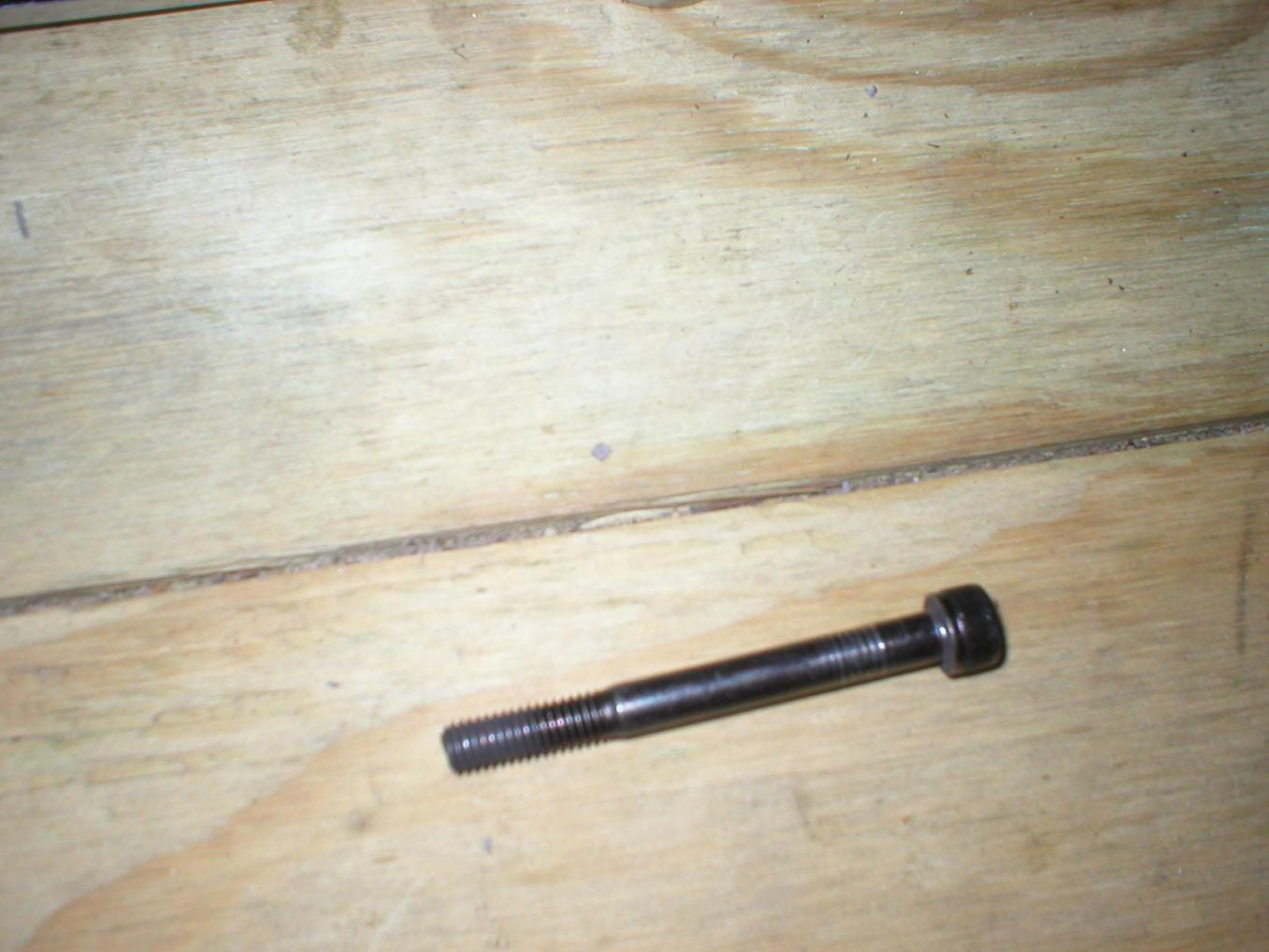

                            Could overtightening the bolt done something? It won'tclick at the right torque anymore.

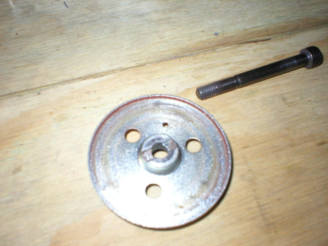

ID:	870814 Bolt and reluctor look ok. I need to put pam on next gasket like Phil says. Click image for larger version

                                Try turning the gasket around 180 deg and see if it fits better. It is never good to overtighten things, who knows what may result.
