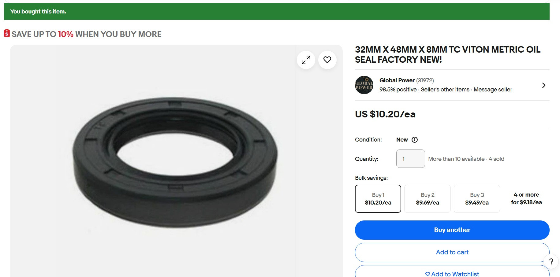

      Did you use this seal? https://www.ebay.com/itm/317124386392
        #63
        Might want to give this a read. Everything you need to know about that seal and replacing it. oil on the good foot - XS11.club Forums
          #64
          Specifically here:
          Only use a Viton seal. If the seal surface it pitted (it probably is!) you will need a surface sleeve.

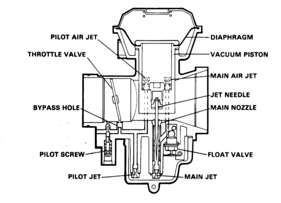

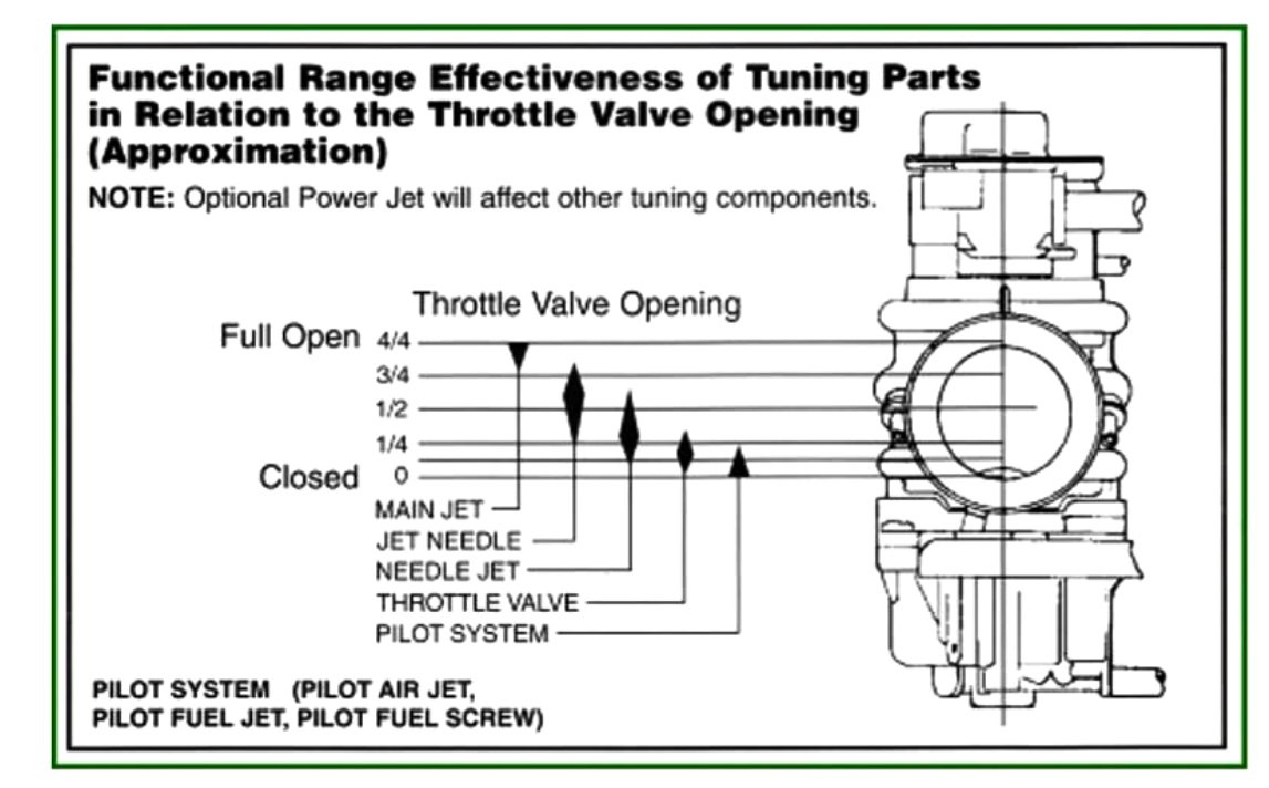

                    That must be a typo. 4 turns out is not right. The needle would not even be needed at that point. Might as well install a bolt.
ID:	889212 Click image for larger version
Name:	Carb Circuits.jpg

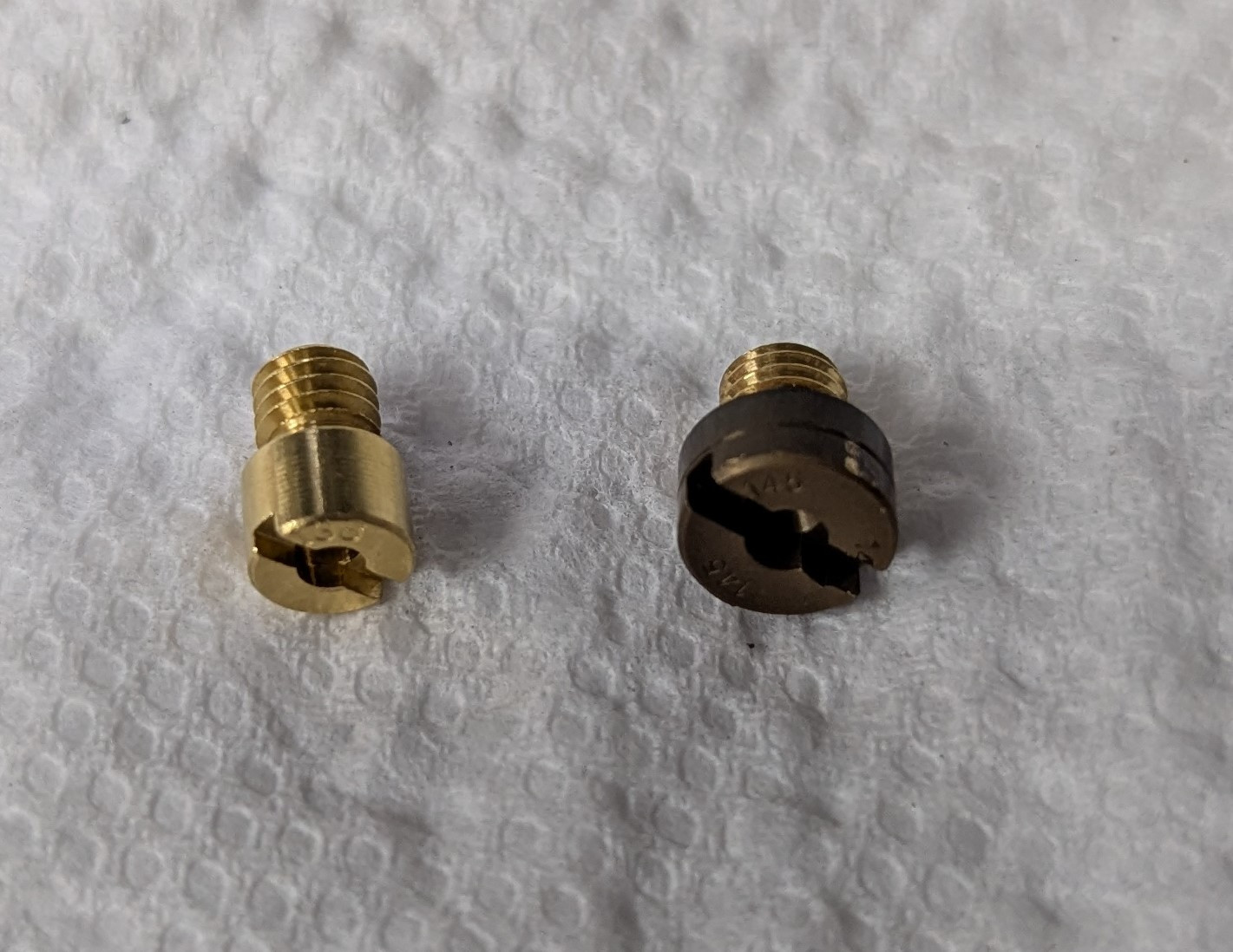

                      Dynojet uses the small instead of OEM big mains?
                        #71
                        Yes, and the numbering system is also different between Mikuni and Dynojet.
                        • autotech44
                          • Apr 2026
                          • 48
                          #72
                          Yes. I have a conversion chart. 138 is about a 130 Mikuni.
