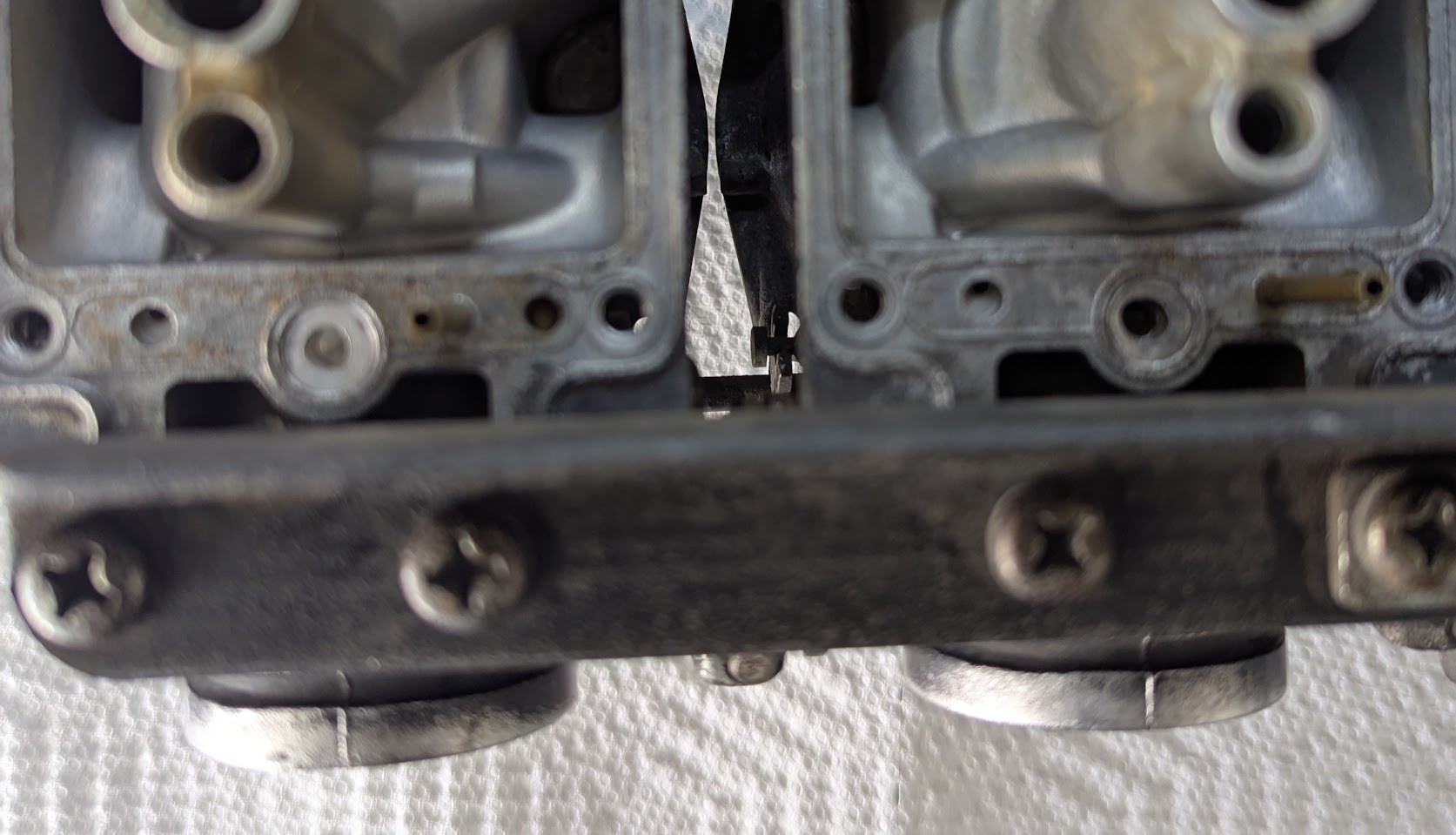

                OK. There are plugs that go straight down to the bore from the bowl surface? #1 Is partially drilled and #2,3 & 4 are drilled all the way through. Why would someone drill them out? Is it possible they were mistaken for the mixture screw caps? I guess the only issue is turbulence at the holes since the top is sealed with the gasket.
                  Click image for larger version Name:	PXL_20260410_201337195.jpg Views:	4 Size:	167.6 KB ID:	889124
                  Click image for larger version Name:	PXL_20260410_194735400.jpg Views:	0 Size:	235.2 KB ID:	889123
                  Don't take this the wrong way but he must be a good friend. I have never messed with the Dyno Jet kits but I do know that they come with a drill bit. The only person that can answer "Why?" would be the person that did the drilling. Curious thing is why just 3 of them and not all 4? Were you planning on getting the jb weld that Marty recommended to you? Might be good for sealing those holes back up. The closer you get back to original to begin with the better. It's no wonder why others gave up on those carbs. They may still be salvageable though.

                      #55
                      Yep. I just don't know if jb weld is worth the effort. And it's the putty version which is difficult to work with. Wish I had new plugs.

                        #56
                        The drill bit with the Dynojet kit is to drill the diaphragm slide hole in the bottom of the piston. It's 4mm.
                        Kit comes with 2 bits. 2.5mm for the slide hole and 4mm for the screw plug. That's the size of the holes. He definitely thought they were the mixture screw plugs.
