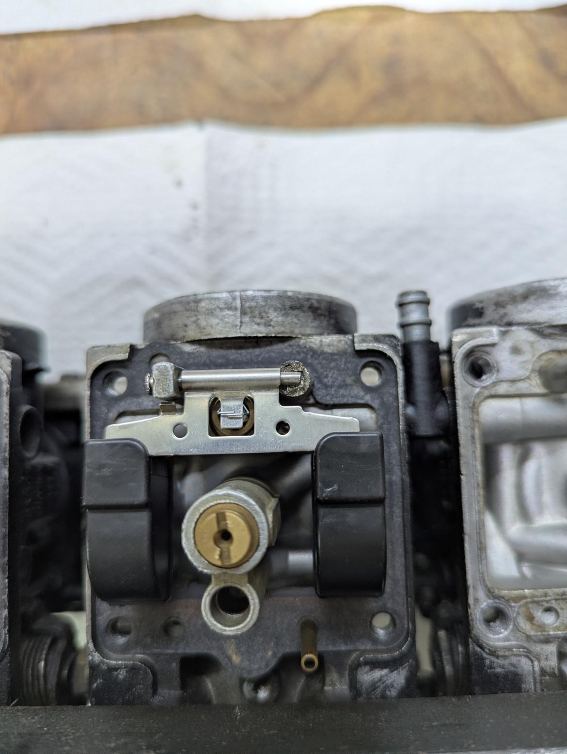

              Bike is a mess. Just hoping to get it running decent cheap. Hoping to get away with this also.

                  Been there done that. I use the K&L kits for gaskets, needle/seat and o-rings. OEM other than that. I'm gonna set the floats at 27mm I believe is the height spec. Then I'll double check the fuel level once assembled. Always been dead on for me. The LH supplement shows 3mm below the bowl edge. I don't know if you noticed the broken float pin perch on carb 3 housing in the picture. The pin stays fixed with one so I'm gonna have go with that.

                    No you won’t get away with it. That has to be repaired or the carburetor body replaced. Do you have the piece that broke off? JB has a fuel proof product if you do. I had a post welded on mine. A replacement carburetor body is your best bet if you can find one.
                    • autotech44
                      • Apr 2026
                      • 48
                      I was thinking about JB weld. But surprisingly with the pin istalled it stays in a fixed position having no effect on the float. The only risk is the other one breaking off. I've seen it before and it never let go.

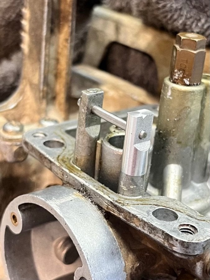

                        • 2057
                        Add heat, petroleum, vibration and time and it will surely fail.
                          • 2057

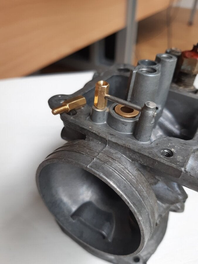

                            • 2057

                              I'll add a dab of JB weld. Can only spend so much here. Don't even know for sure the engine is good. Owner is fully aware. He broke it.
                                • 2057
                                Carburetor Float Post Repair Service - Permanent Mechanical Repair For Broken Float Posts
