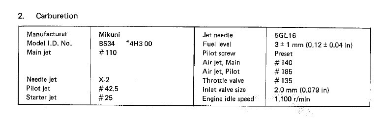

    Needle jet is correct (X2) but looks a little corroded inside. Not sure if I should replace them. The needles are aftermarket with no markings (does dynojet have markings?). The specs show (see attached) correct needles are 5GL16. Yamaha part discontinued and can't find it anywhere. I guess I need the next best thing.
