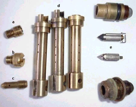

    here are jet pictures for reference
    a air jet - b main jet - c pilot jet (some have different # of holes)
    d various needle jets (emulsion tubes) - e two styles of float needle valves and float needles
    (note: there are several styles of Mikuni main jets - the ones of interest to us are the 'large round' style)
