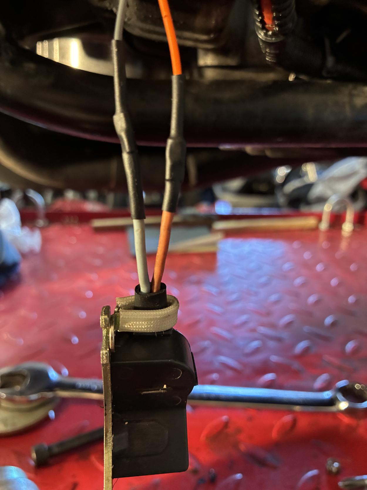

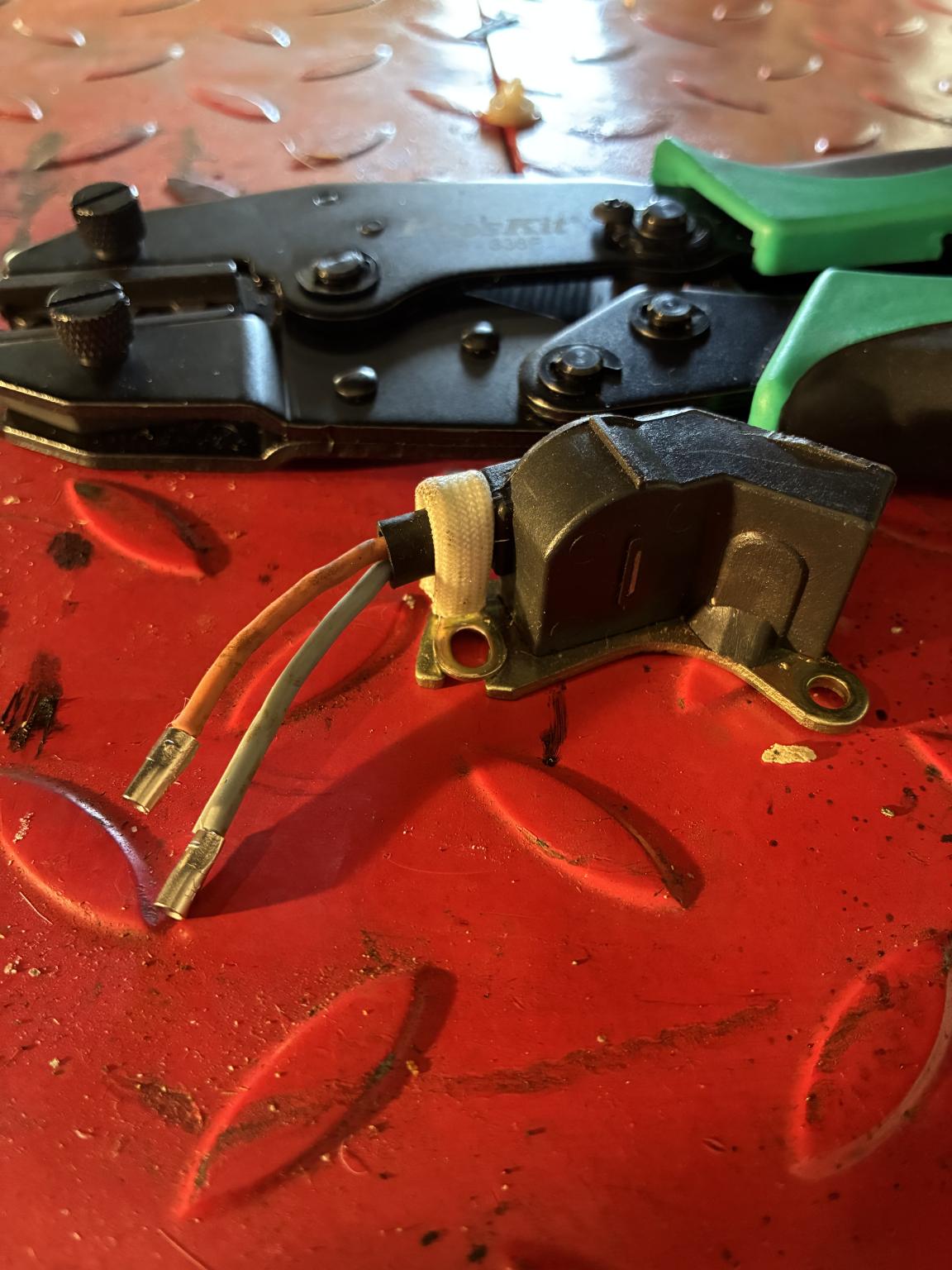

      I replaced both pickups. One had a broken wire right at the housing. Once again, it runs on four cylinders. At least, on the lift. This ignition advance is really wonky. I’m sure my bike has a lot more years and miles than were ever intended.

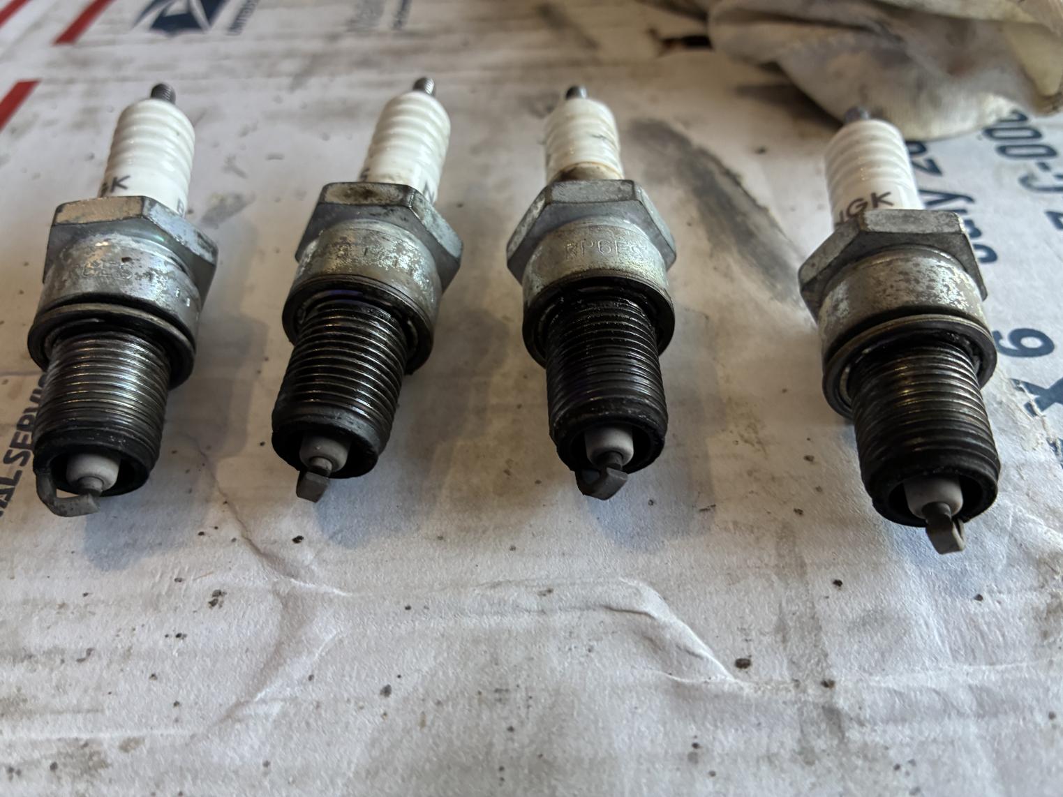

              I let it sit a few days with 20 ml of MMO on top of each piston. I also found spark plug gaps way too fat. It fired right up after this last fix. I hope I can give it a good run this coming weekend.

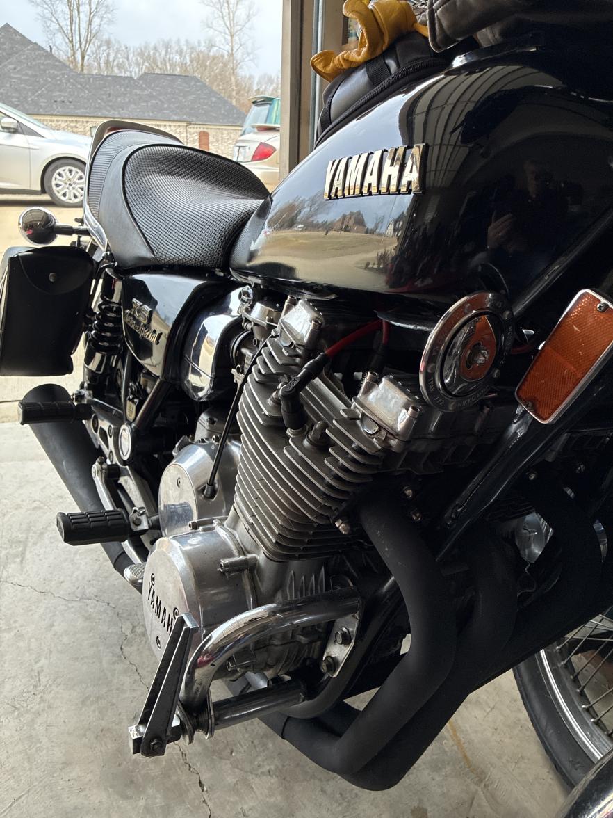

                            I poured half a can of Seafoam into the tank, took it off the lift and rode it. I did almost 50 miles of local backroads. Thunder is getting close as I garaged it.

                              It seems to run just fine. Pulls hard. I can’t detect smoke. It started right up from cold. Seat of the pants, it feels great!

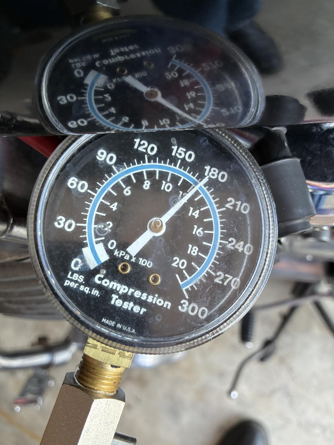

                                Just to recap:
                                I let it sit for days with MMO in the cylinders. I did close spark plug gaps into spec. Fresh oil. Seafoam in the tank 50 miles. Today, I filled the tank from empty with Top Tier 93 octane. I drove 14 miles.
                                I just did another compression test warm.
                                180-172-165-170

                                The spark plugs went from sooty black to what looks very good.

                                I’m happy to say it pulls very hard now. I still have to address the clutch.
