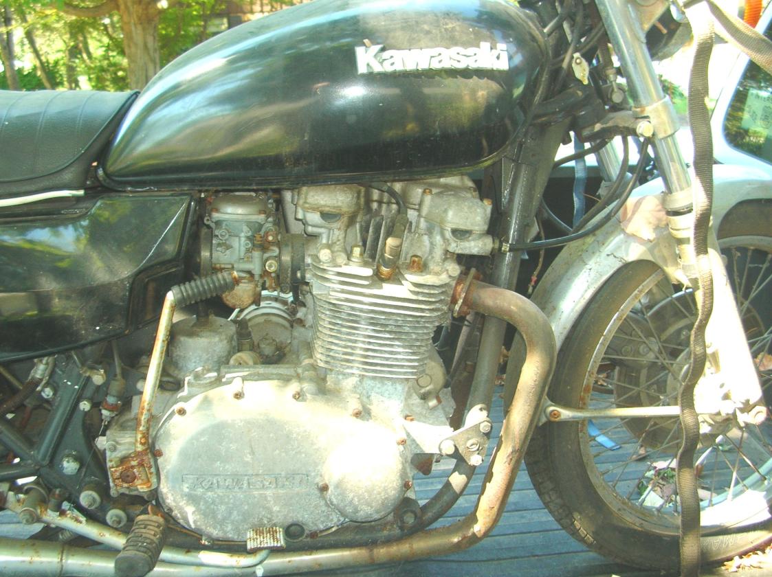

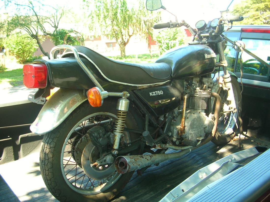

                Marty, in 2011 my KZ750 twin had a seized motor when I purchased it for $50.00 at a tag sale. I freed it up with MMO after soaking the pistons and rings for two weeks. The compression was off on the seized cylinder more that 10%. I rode it work every day sun, rain and snow for over 50,000 miles. It used a little oil between 3K mile oil & filter changes. That motor never let me down in conditions that an engineer would have said it could never do. These Japanese engines are VERY forgiving. My advice, just ride it. it will more than likely outlive all of us.

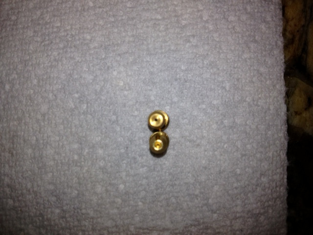

                                Gfix sells K&L kits. The K&L folks put the right sized pilot jet in their kit, but it is right sized 42.5 for the VM family of carbs, not the BS34.
                                I don't know why the 42.5 size is different than the 42.5 size for the BS carbs, but it is.
