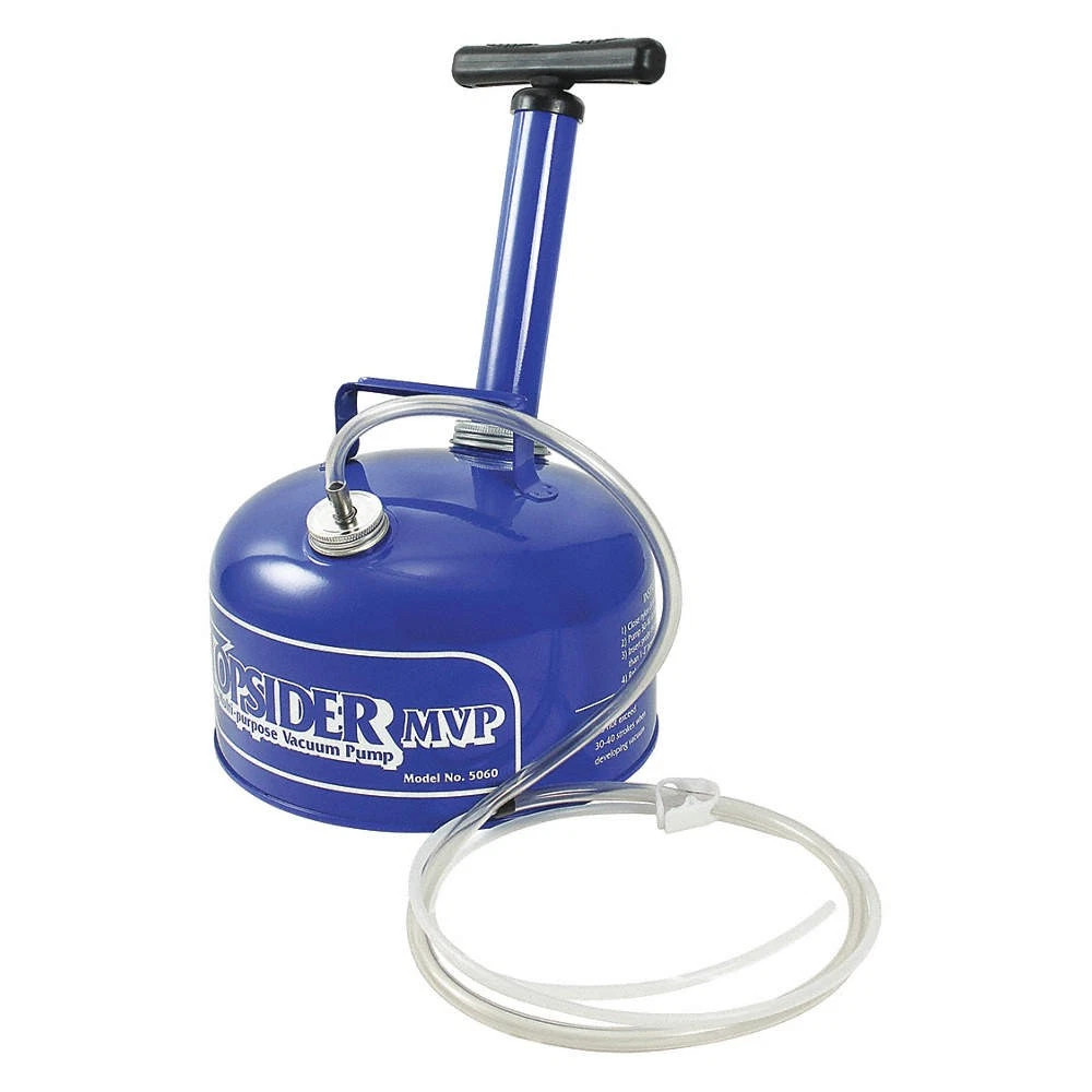

                Umm... off topic but nut by much....(´._.`).。oஇ()
                In the pic of the bike.....izzat the kind of 4-into-one exhaust what makes oil changes a beeyatch? (O_o)
                I mean.... blocks access to the filter/drain so's the owner gots to R^2 the exhaust to do an oil/filter change? (◔ヘ◔)
                I change the oil in my bike every time I see it turn to coffee color thru the lil' window. (´c_`)

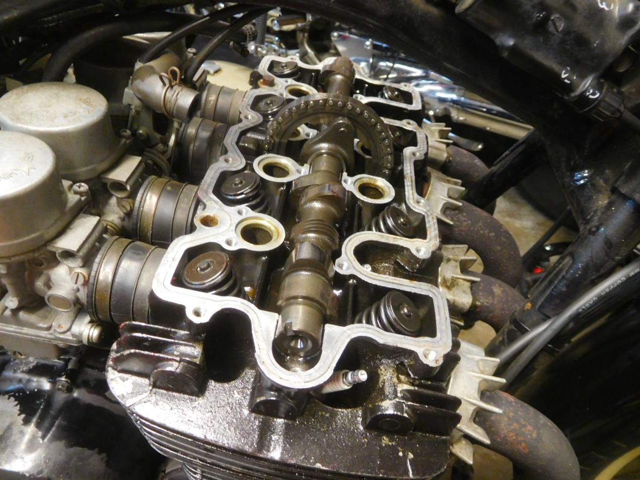

                  Larry, those pumps do work in a pinch but do not get out sludge and sediment that draining from the lower plug can do. I would just remove the exhaust. Sometimes I will wrap tin foil around the drip area to keep the pipe clean.
                  As far as oil, I always go by mileage not by time. When I open up a motor years later it's always shiny clean inside. 3K miles in between changes. I get motors that have sat for years with dirty oil that looks like black paint in them and there is no damage at all to the internals. I have worked on hundreds of lawn mowers and motorcycles and have only seen water corrosion inside a motor one time. Guess what? I changed the oil and it ran perfectly for many years after that (My XJ650 Turbo).

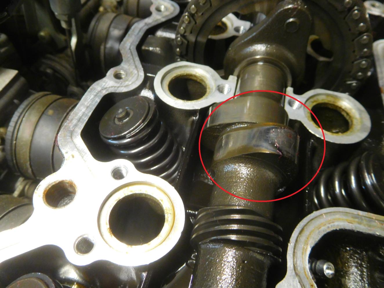

                      This is a CB650A that I have been working on. Look at the hardface on that lobe. Not an oil issue. Metallurgy issue. Some Hondas had soft cams. It will run for years like this. It's not the Space Shuttle.

                        At that time I owned a sailboat with a YanMar 2gm Diesel inboard engine. NO drain plug on the motor or the X-mission. (⊙_◎)​
                        Turns out they's made that-a-way and IIRC.... drain plugs were actualkly illegal in marine usage. ミ●﹏☉ミ
                        Got my first Topsider Vacuum System then and kept'a using it when I went back to bein' a land-lubber. (•̀ᴗ•́)و ̑̑​
