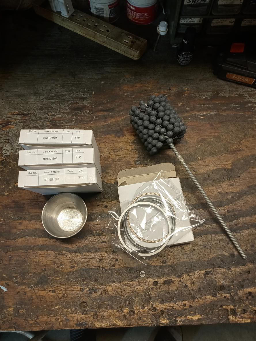

                            My friend and I just did a hone and ring job on an XJ11 (same as 80-81 XS) last summer. We used the standard size rings and the correct size ball hone. Also did a valve lap and valve seals. The bike is now running great for around $200 including the gasket kit....
                            Click image for larger version  Name:	IMG_20260202_204806.jpg Views:	0 Size:	181.9 KB ID:	887381
