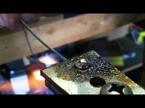

                      Ummm... 'bout your cable concerns. (O_o)
                      'Bout 12 years ago the end sort'a just slipped offa my own clutch cable. (●´⌓`●)
                      I did my own repair similar to wut's shown here-
                      O'course I got a spare eventully and even carried it wit' me on my gad-a-bouts cross the continental USA. (☉_☉)
                      But I ain't had to use it cuz the repaired one ain't failed yet. (ʘ‿ʘ)
                      Still waitin' tho.... (*′☉.̫☉)

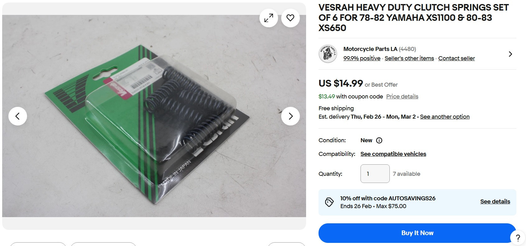

                              The cable ends used to be solid solder. It may be with the "new" tin only solder they are not holding onto the cable like the old lead/tin solder.
                                • 2010
                                #60
                                I have had motion pro clutch cables break on 3 of my bikes. Speedometer/tachometer cables as well. Especially in icy conditions. They are junk. I always grab extra OEM cables when I see them. As far as clutches go, Barnett is great equipment for the 25 year old drag racer. That clutch will never slip and that's the problem. It's a mother on your first gear in the morning. The "crunch" sound from shifting into first gear on a freshly started bike has to be experienced in order to fully understand the cringe moment it induces. I learned this in the 80's and never went back. I use only OEM plates and pads with Vesrah springs. Almost stock pull on the cable and the bike shifts like stock. No clunk. Even pulling a steel sidecar won't make it slip if it's properly adjusted.
