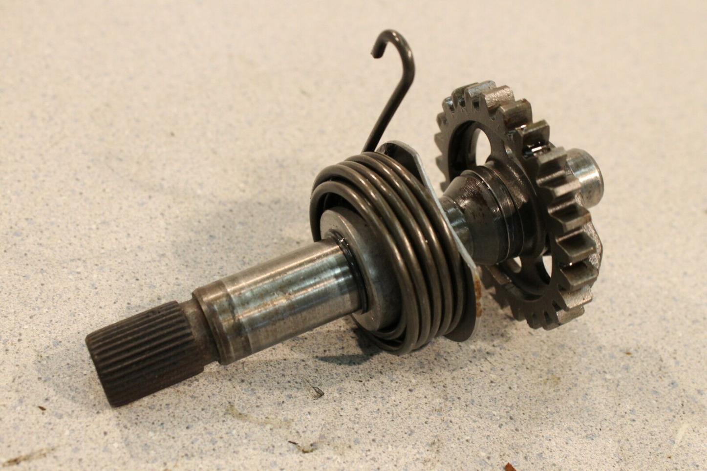

      Kicker. Perhaps the 850 style kicker fits a little better. Try that first.
      https://www.ebay.com/itm/22156088042...Bk9SR7istO_GYw
      Click image for larger version  Name:	s-l1600 (3).jpg Views:	0 Size:	144.4 KB ID:	878345

        #48
        Your 80+ motor would need the clutch removed to install the kick shaft assembly and seal. I did this to my motor using info from the forum.

              #51
              Correct Mathh, this is what you will see inside. There is a small gear and circlip that must also be installed.
ID:	878352 Click image for larger version

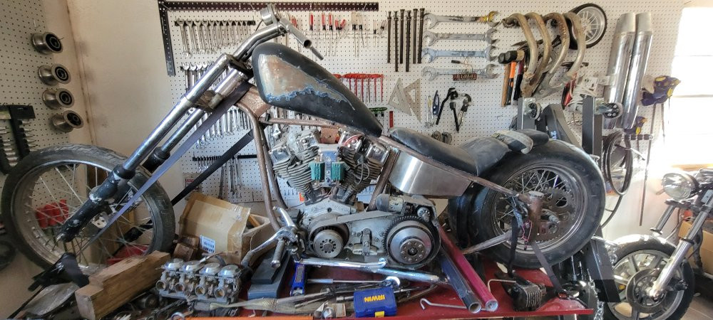

                          #57
                            #58
                            Love the way you have the xs11 carbs sitting next to the Harley. I had to look twice. Here is a manual you can reference for the shaft drive. It is for the xs750 but still has a lot of information that still applies. https://www.ringler.us/xs1100/ShaftDriveManual.pdf

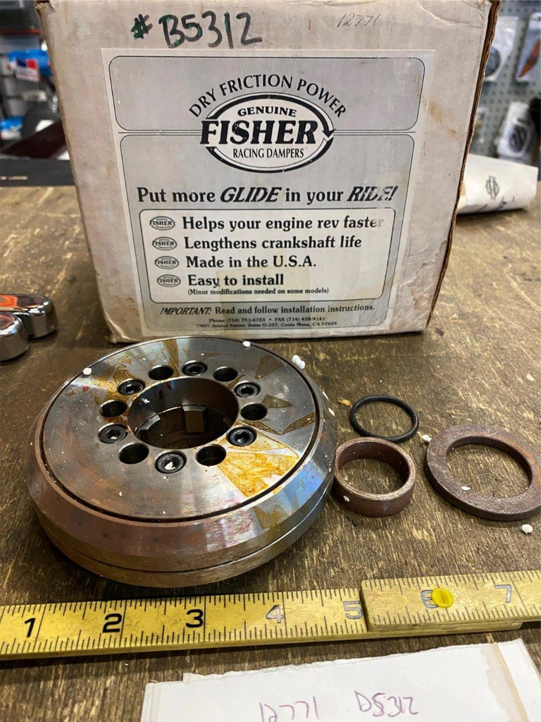

                              #59
                              Is that a Harmonic balancer and single fire ignition on that Shovel?
