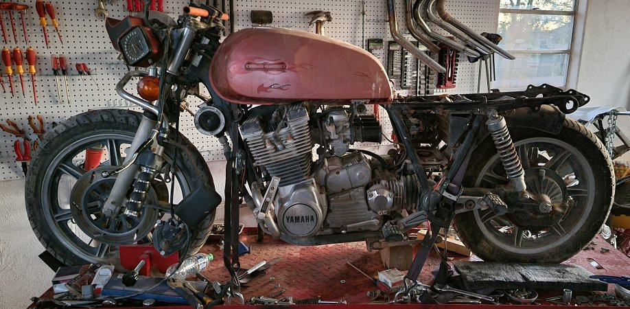

                Some pics of the disassembly process:

                  My guy at the local indy shop hooked me up with a front tire just so I can roll her around in the shop when I need the lift for other projects. The plan at the moment is get the wiring down so I can light her up before anything else. The brake system is completely shot... dried out, crackling reservoirs, calipers are shot... with that, shoddy splices and many of the electrical plugs disintegrating, it's going to be a long project. Not to mention that the tank is completely rusted through (my buddy found this out as he tried to work the petcocks and one came off in his hand along with a piece of the bottom of the tank).

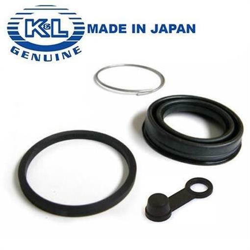

                        Caliper rebuild kits. Some with pistons as you may find pits on your parts like I did. If the pistons are good you will only need seals.
                        https://www.ebay.com/itm/195879596266
                        https://www.ebay.com/itm/293557441325

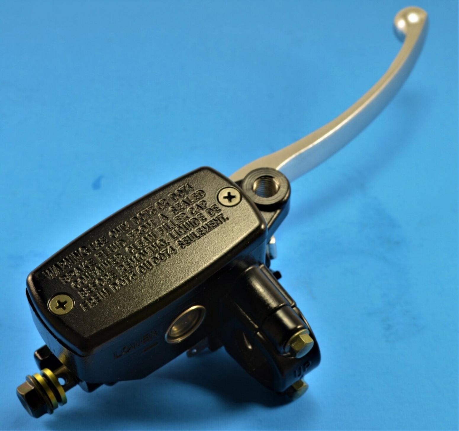

                            Master cylinders. I usually chuck the front and use this one. I run these on several of my bikes and they have held up in all kinds of weather for over 8 years. It's important to note that you need the large 16mm piston for dual disc brakes. These also have a brake light switch. Your brake light wires are inside the headlight housing and hook up easy to this.
                            https://www.ebay.com/itm/202821810271
