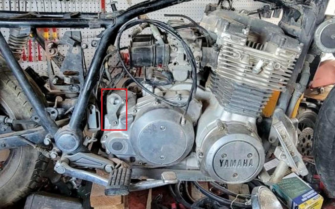

        This bracket is interesting. Start switch holder? Breather?

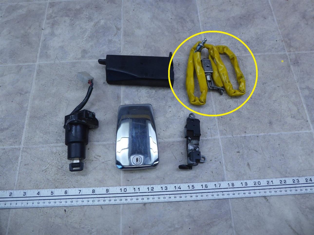

          Looks like a cable lock holder ...

            Hey Mathh, you mean for this chain?

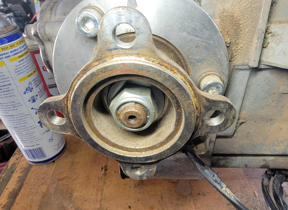

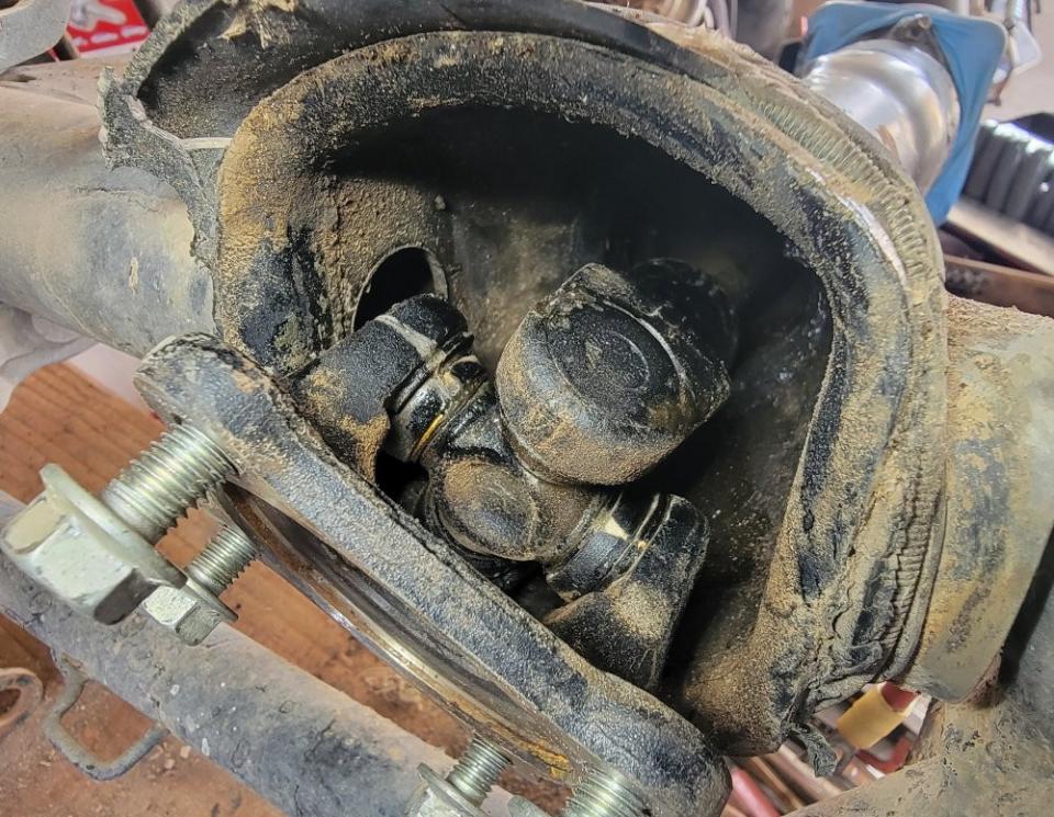

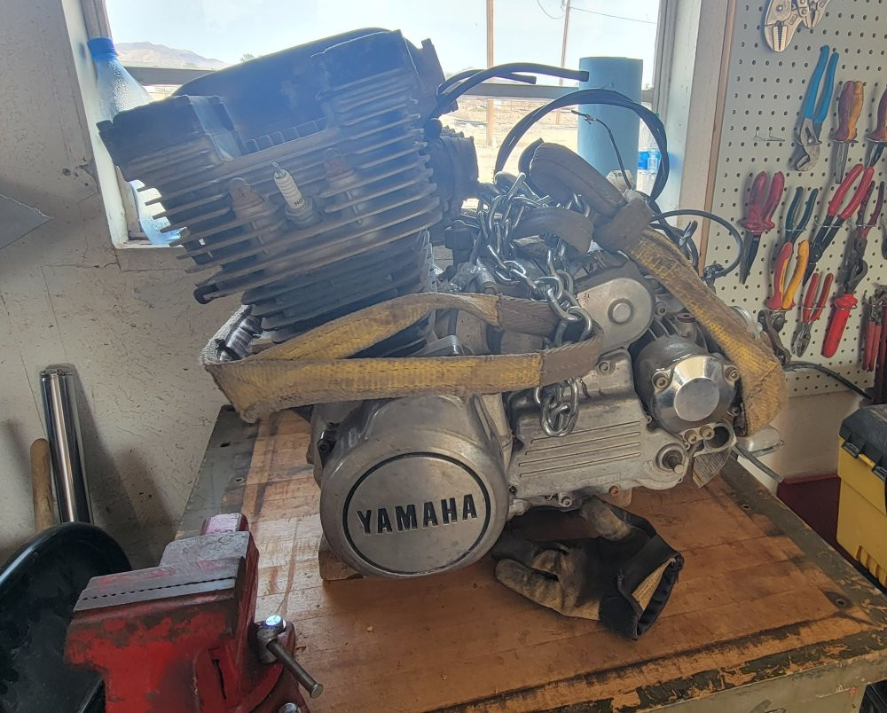

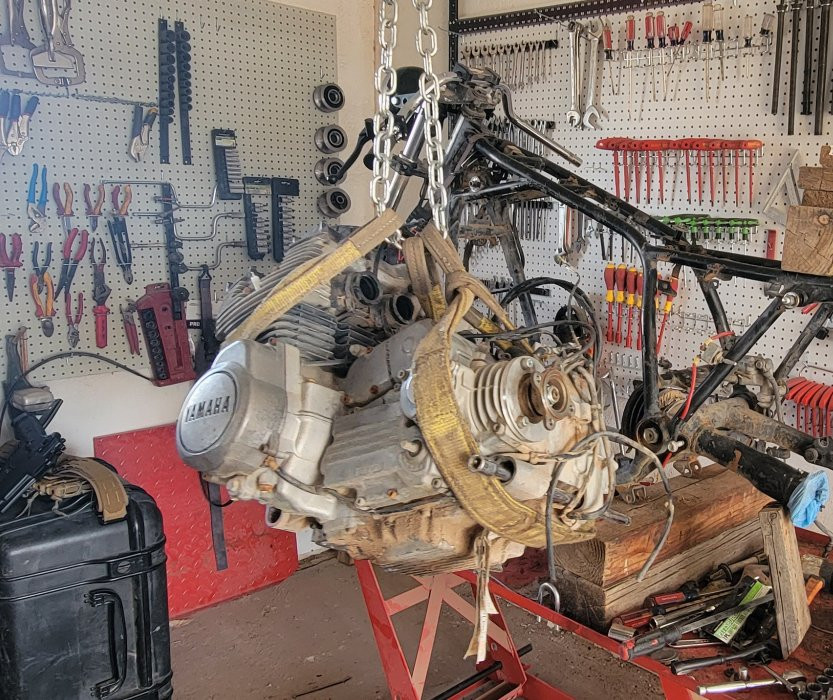

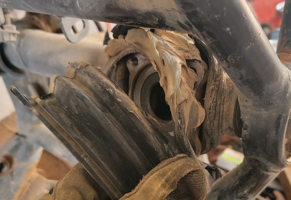

                I had to use the cherry picker again to remove the motor since it's only me. Once I got in there one thing led to another. There is no way of knowing what small things may be bad in there so I figure I'm just gonna break into her. The PO slathered a gob of gunk on the rubber gasket and when I looked in there, I saw some rust and corrosion. The shaft looked dry so in the interest of being thorough I opened her up. I have plans to open up the engine and massage the internals. Anyone have any idea of upgrades available?

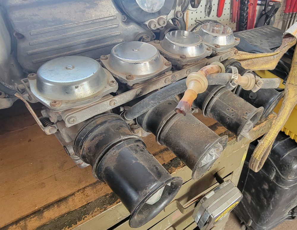

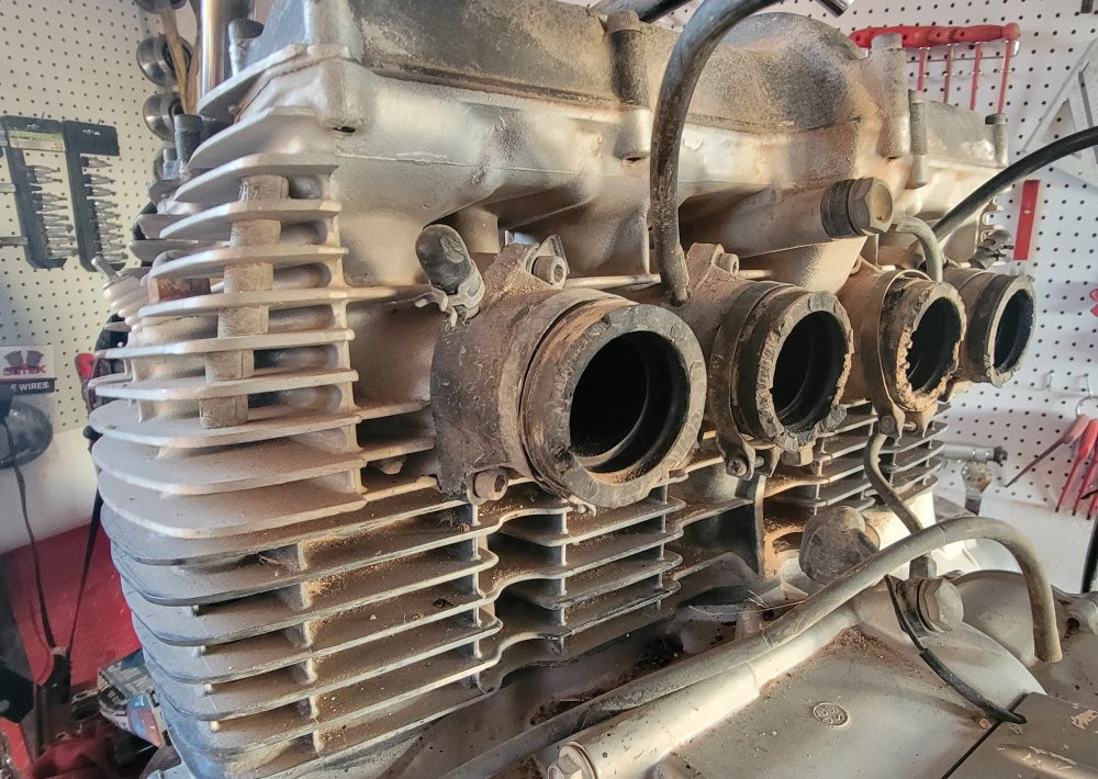

                  The carbs will definitely need a rebuild and anything that is rubber will need to be replaced. I also discovered that one of the exhaust bolts is cross-threaded so I'll have to see about that. Maybe while she's apart I'll paint the engine and pretty it up. Click image for larger version

                    Do NOT buy the "cheap" carb holders, or anything else rubber. Do a quick search and you will find parts others have used that work well.
                    Do plan on the second gear fix, as doing it now will save time later. Second gear dogs WILL round, but if fixed before they get too bad your good for 100K miles.
                    There are big bore kits available, but be sure to look for one with forged pistons.
                    I have an engine in parts myself, just trying to get the time to start putting it back together. Most bits are available on ebay, and georgefix is who I use for most of my buying. Remember if you get the K&L carb kits, DO NOT use the jets!

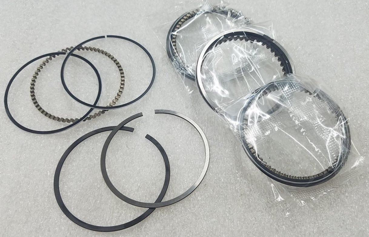

                          Rings.
                          https://www.ebay.com/itm/303234375714

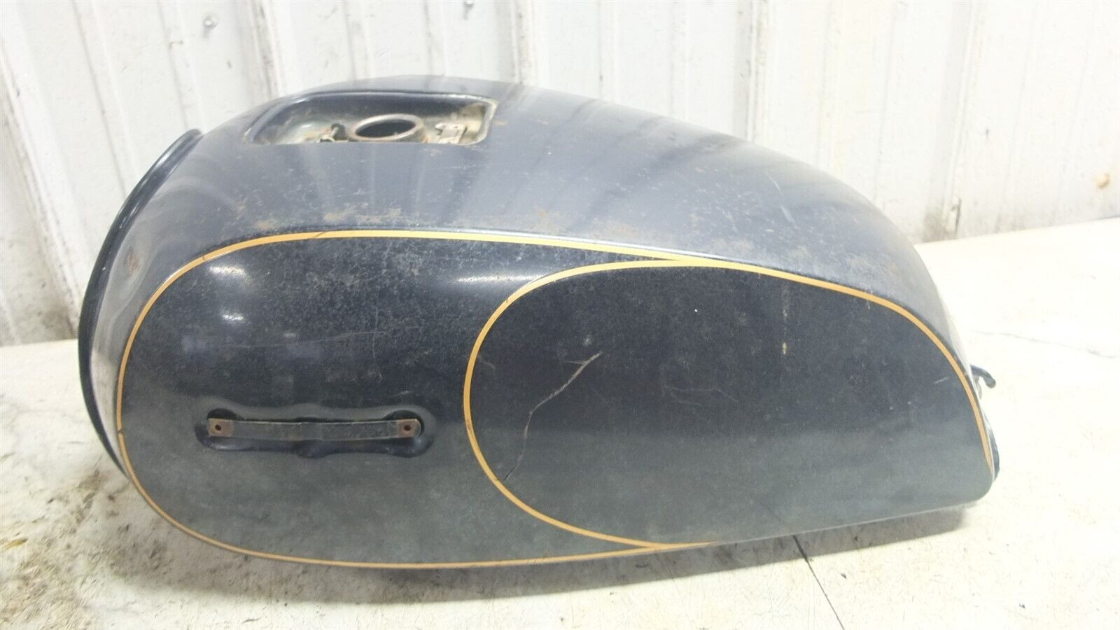

                            Tank. Needs work.
                            https://www.ebay.com/itm/27634669509...Bk9SR_KDqO3GYw
