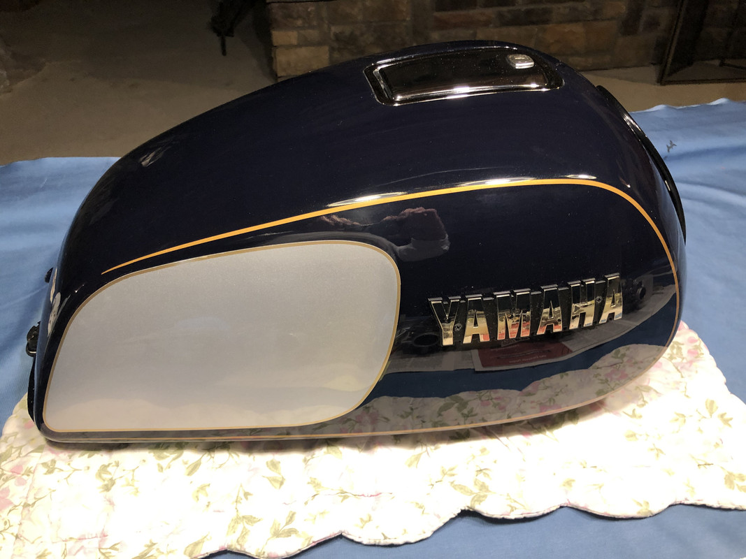

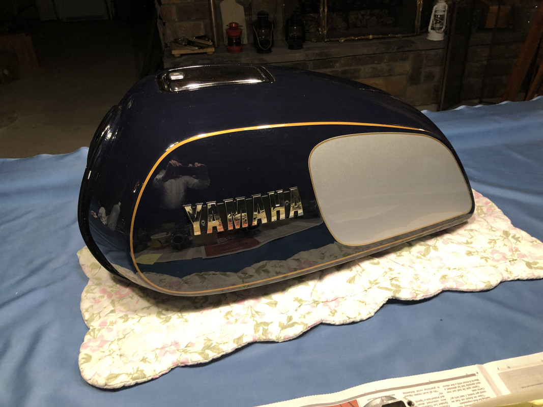

        Believe it or not, I just now finished the tank, after another 2 weeks have passed:
        I bought the OE SG emblems to see how they might work compared to the Chinese options. The size is slightly larger than the original emblems, but they are far more flexible and they have a pre-curve; albeit the right-hand Special tank contour. I found these were by far the best choice because they have the best chance to remain stuck on the tank.
        I epoxied screws in the emblem screw holes and cut off the threads on the backside back with a Dremel.
        I compared 3M and Scotch double-sided tape. The Scotch brand was stickier, so it won the contest.
        I expected to spend hours polishing orange peel after the final coat, but I accidentally nailed it with no orange peel at all. However there were four sags that scared me. Fortunately I got them polished out so you would never know it even after after I told you.
        The tank is not perfect, but I am pleased because I was so worried I would screw up something along the risky path I chose.

          Yes it was risky and you did it. Looks perfect. Well done.

            Nice Job !!!
            So shiny you photo-bombed your own pic

              I kept trying different angles to get out of the picture, but it seemed impossible.

                Mike, great job on that tank. Yamaha would be proud. Another one of us just refurbished an E tank and it turned out great. Keep up the good work.

                  That is beautiful. I really like the Venturer tank, and you nailed that restoration!
