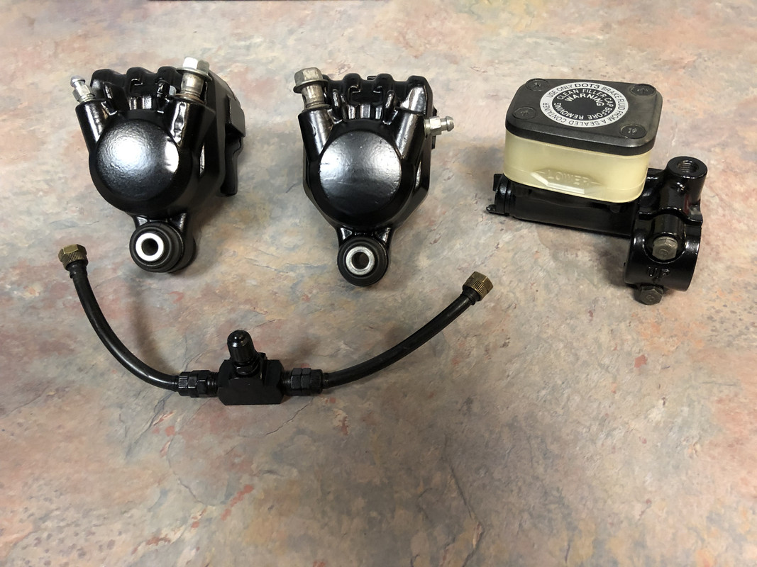

                          Last night I was gung-ho to bleed the Front Brakes. I noticed my DOT3 brake fuild was slightly yellow, so I decided I should postpone it and get some fresh fluid. There are plenty of other things to work on....

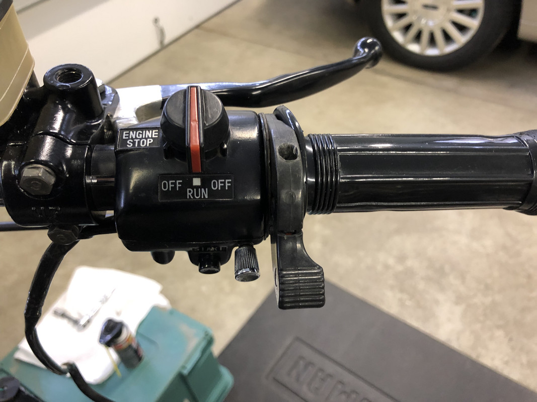

                          There are two cruise controls on the bike:
                          There is the (a) normal black lever, and (b) the silver knob. The silver knob pushes on a leaf spring inside the switch assembly. It rubs on the nylon throttle sleeve to cause resistance to throttle movement.
                          Is this silver knob stock? If it was added by the PO, it is a nice job because the leaf spring inside appears to be tooled to fit the space perfectly and it engages nicely in the drain hole to stay in place.
                          I've been leading up the problem. The black cruise control is not supposed to rotate with the throttle. It has a tab on the bottom that keeps it stationary relative to the switch assembly.
                          However, the Handgrip rubs on the black cruise control and makes too much friction:
                          This is not safe, as the throttle should spring back to idle when the cruise is not set.
                          My possible solutions are:
                          (a) Delete the black Cruise Control- There would be an awkward gap where one would see the white nylon throttle sleeve. The silver knob doesn't seem adequate by itself.
                          (b) Cut the flange on the Handgrip. If the diameter was reduced, it fits the profile of the black cruise control better. May or may not solve the problem.
                          (c) Look for another Handgrip- It's doubtful any other grip would have a flange diameter small enoungh to avoid the interference.
                          (d) Look for another Cruise Control- Might be a good solution, even though the existing cruise is a nicer model.
                          (e) Slide the Handgrip outboard- See if it feels OK at the unsupported end.
                          It seems obvious (e) is the low hanging fruit. I guess I'll try that first. Don't know if I can do it without damaging the grips I'm not satisfied with.

                              Hi Mike,
                              Bikes lookin' good.
                              Here's a link to a CC that may work better for ya :
                              https://lockitt.com/NEP-Sound-Off-Cruise-Control.html
