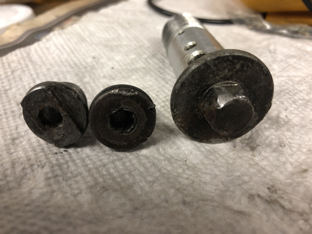

            The gearcase filler plugs and filter bolt were replaced because they are badly buggered. You can see the PO ground flats onto one of the plugs to remove it:

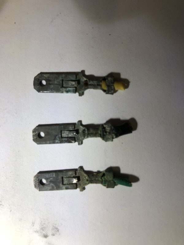

            These are the connector terminals that were sitting a puddle inside the vinyl bag behind the headlight:
            I had cleaned the bigger terminals twice with Deoxit and brushes, then decided they must be replaced.
            I have always been skeptical that crimps were truly impervious to corrosion. I was always a believer in solder. I measured the resistance of these corroded crimps and found no measurable resistance! (Can you hear Marty applauding?!?)

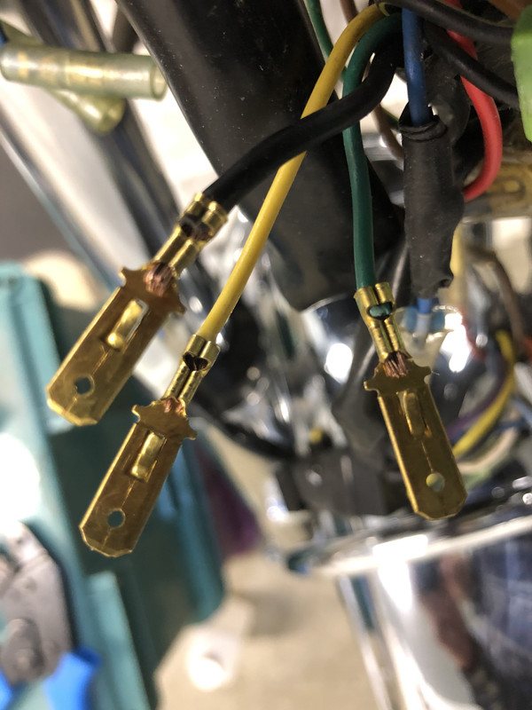

            It took me 2 tries to buy the right tool (for non-insulated), but now I have new skill:

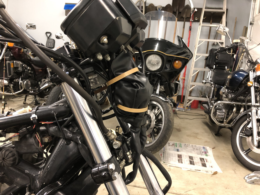

            I used the zip-tie suggestion from Mike P and was successful to position the front connector bag upside down, as best I could:

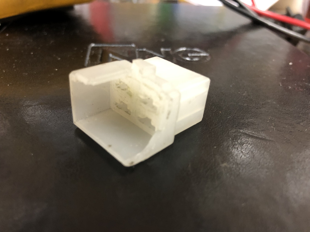

              Oh yeah, forgot about the IGN switch connector:
              PO had it zip-tied together. Effective, bot not eloquent nor durable.
              I was surprised the replacement from Parts-n-More was an exact replacement for about $3, so I didn't bother to change the female side.
