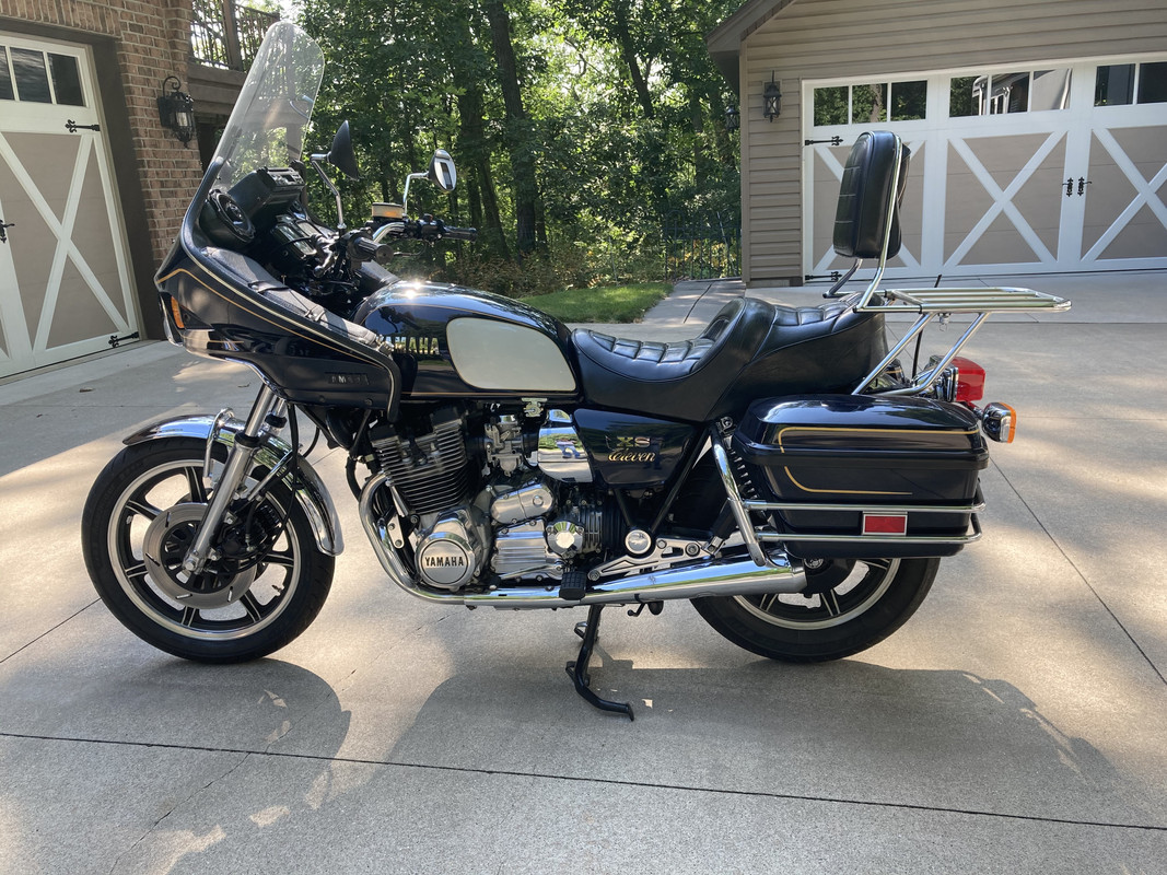

            Put the bags on:
            I have had it out a few times now. Today I rode it about 65 miles. It runs perfectly and everything works perfectly. It's quite smooth and comfortable to ride. The only issue I have is I can hear a ticking noise like a "noisier than usual" valve. I checked the exhaust and it's tight. Might be nothing to worry about?

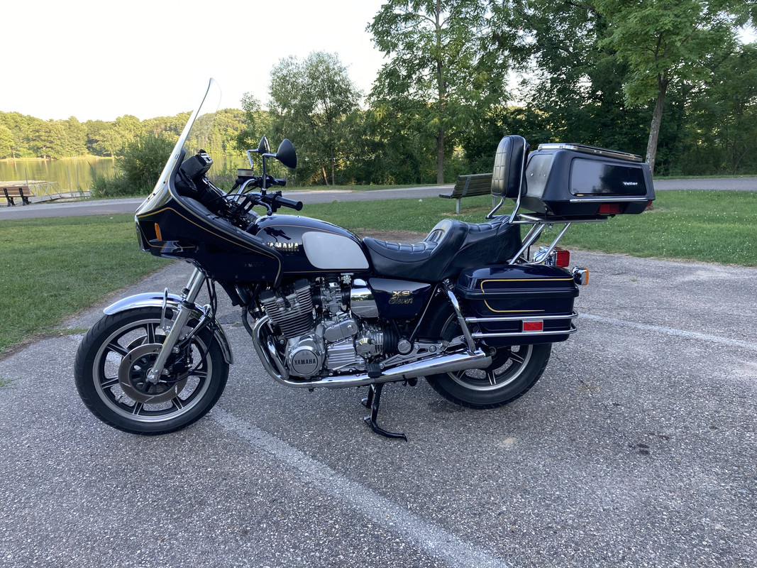

                      I have been polishing the trunk, and have it installed on the bike for now:
                      The wife and I don't care for the way the bike looks with the trunk, but it would be so functional for trips.
                      Now I have put 171 miles on her since getting back on the road.

                          Mike, the Vetter trunk is fairly rare. Venturers had two options for the passenger back rest. Some of the trunks had their own back rest. With those you removed the Venturer factory one.
                          Skids: There are front crash bars installed on this one. And you can add foot pegs that allow the use of the lowers.
