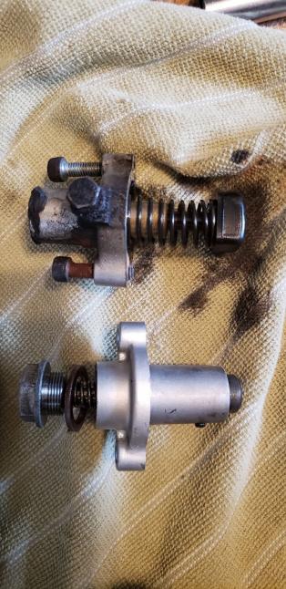

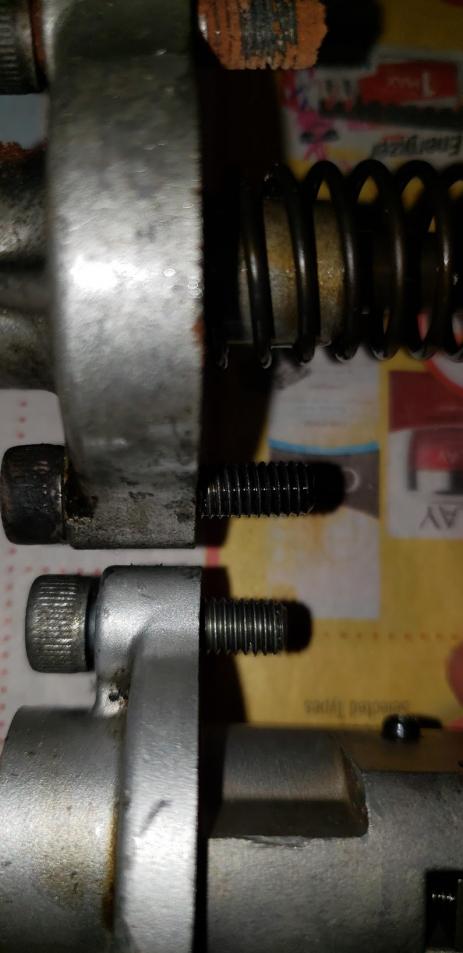

                    Yesterday all the parts were in to fix the CCT.
                    I bought 2 Vmax ACCT for $10 on eBay. It's convenient that each Vmax has two ACCT.
                    I had read the sticky about this topic and I saw the recent post by dbbrian (and motoman) about Brian's ACCT. In both places, it is noted the "OE" bolts should used, or the "OE" bolts are too long. It's not clear to me whether "OE" means the XS11 bolts or the Vmax bolts.
                    Here's what I found:
                    XS11 Bolts:
                    XS11 Bolt compared to a Vmax Bolt:
                    So, it's obviously better to use the Vmax OE bolts to mount the Vmax ACCT on an XS11.
                    I noted the spring on Vmax ACCT is MUCH stiffer than the stock XS CCT. It does make me worry about wear on the rubber tensioner arm that contacts the cam chain.
                    Last night I installed the Vmax ACCT using a Vmax gasket and the Vmax bolts. I couldn't help risking waking the wife at midnight. I started it. It ran perfectly, but it leaked around the ACCT.
                    Today I removed the ACCT and found what I expected. The bolts left witness marks on the inside of the mounting holes where they were rubbing, due to the slightly different mounting hole pattern of the XS11 vs Vmax.
                    Looking at the ACCT on the engine, I filed both holes about 0.5mm to the right. Then the ACCT fit well. I bolted it up and the leak was gone.
                    Since I had to remove the ACCT after it was already installed, it gave me an opportunity to compare the plunger position with the stock XS11 CCT vs the Vmax ACCT. I found the XS11 was extended 41mm beyond the flange, and the Vmax was 45mm. That implies the stronger Vmax spring seems to push in by 4mm more than the stock CCT*
                    *Assuming the chain didn't stretch over the 300 miles after the bike was revived.
                    So, I was able ride the bike about 75 miles this evening. The engine is a little quieter, but the clickety sound is still there. For now, I'm going to ride it and pay attention to see if the noise gets worse. Probably it's just my imagination worrying about nothing.
                    This bike sure rides like new despite 35k miles on the clock.

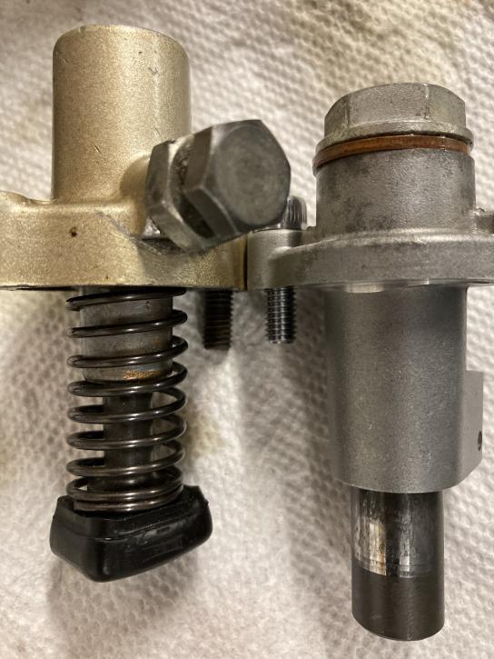

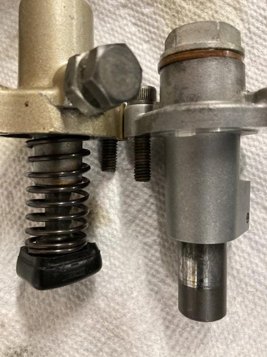

                                #150
                                Hi Mike - the ACCT you pictured on the right looks the same as the one I used. Mine came with bolts that were shorter than the original, which as I understand might be unusual. I used them. The picture below on the right shows the deeper shoulder of the original CCT (top) compared to the shllow shoulder of the ACCT (bottom). Short bolts are in the ACCT in my pic. You can see why shorter bolts are required.
                                Click image for larger version  Name:	CCT and ACCT.jpg Views:	0 Size:	50.6 KB ID:	859053 Click image for larger version  Name:	ACCT bolts.jpg Views:	0 Size:	45.6 KB ID:	859054
