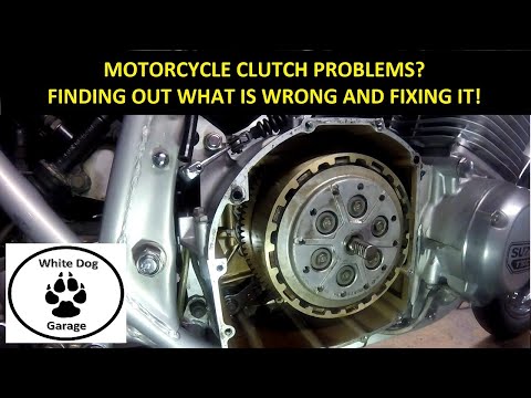

          Looks like it's time to get all workbench "Sciency" on those frictions, steels, and springs. (Θ︹Θ)
          I've NEVER been able to detect/find warpage in the plates by eye... (•﹏•╰)
          Always had to use a feeler gauge to find it... like seen HERE at time 17:54-
          Diagnostic Powers ACTIVATE! (^_^)

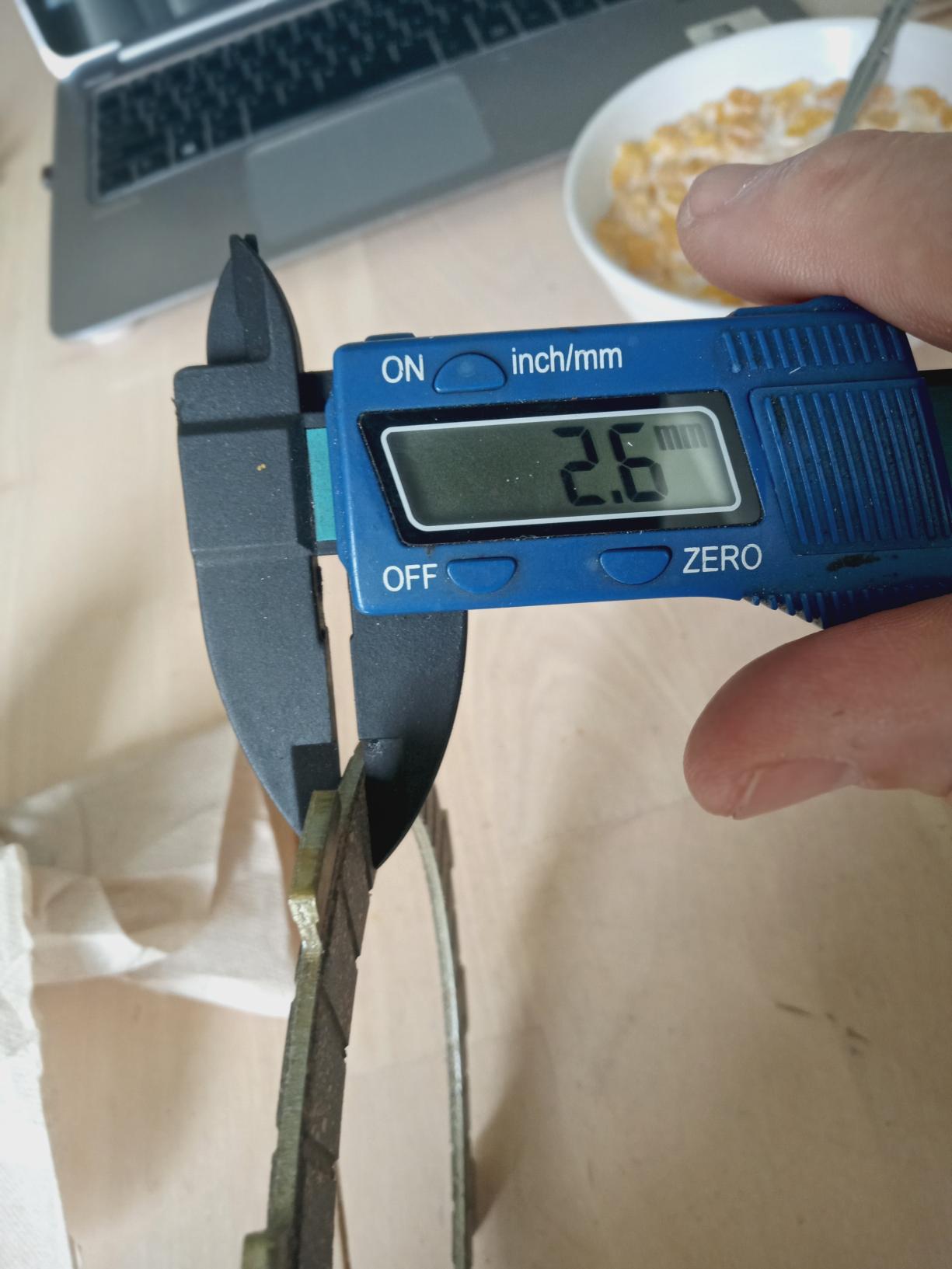

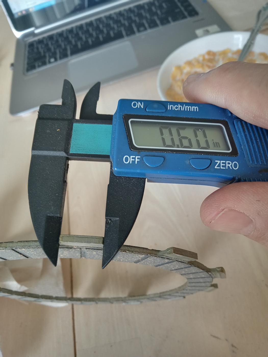

                    That doesn't seem right, they need to slide freely. Here's the measurements from a new PartsNmore friction...

                        I just took the measurements I was too busy to do before. My old clutch plates all measure about 2.9 mm, all over 2.8 mm so they're in spec. Three of my springs measure 41.6 mm which is a fail.
