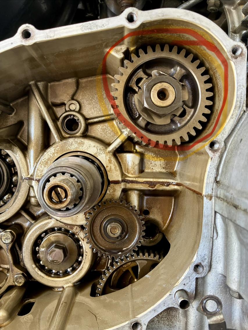

              This gear circled in red does not turn. I assume that’s the starter gear. I installed the clutch basket (no plates) and I can’t rotate it in neutral.
              When I rotate it, I rotate the entire engine. How did this happen and what am I in for now?
                #67
                Sorry, I have my thinking cap on backwards. Friction plates drive.
                  #68

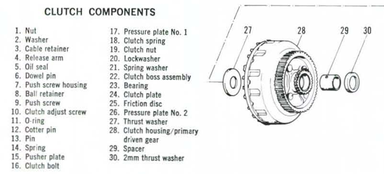

                  It's fixed. It's perfect. Here's where I went wrong:
                  I pulled the specs from my FSM on my laptop. I watched the Steptoes video about clutch replacement and carried the Clymer book into the garage. I will not callout Steptoes as wrong, but when I installed the assembled clutch basket, I could not tell if the basket was seated all the way and it wasn't. When I installed the basket by itself, I found it to be fiddly. It resisted my efforts to seat it fully, but I could see when it went on all the way. Another thing is that the Clymer book calls for a 2mm thick thrust washer behind the clutch basket. That's wrong. The 3mm thick washer goes behind the basket, the 2mm thrust washer goes on after the basket. I did the assembly in accordance with the factory service manual.
                  In the end, my six springs were worn out. My clutch lever was roached. My clutch cable was stretched and dragging even after lubricating it. I reinstalled my OE frictions as all are still 2.9+ mm thick.
                  With a properly assembled clutch, the Motion Pro clutch cable fits perfectly!
                  I just ran some miles on it, and I can't remember when it shifted so well. Pure joy! I did the 5th gear 40 to 80 mph roll-on test and there's no slipping. Lever, cable and springs were the necessary fix.
                      #27 is 2mm thick. #30 is 3mm thick. That kind of confusion wasn't helping.
                      I think DiverRay said just replace the springs. That would have worked though the worn-out pivot hole in the lever would have continued to give me a poor release.
