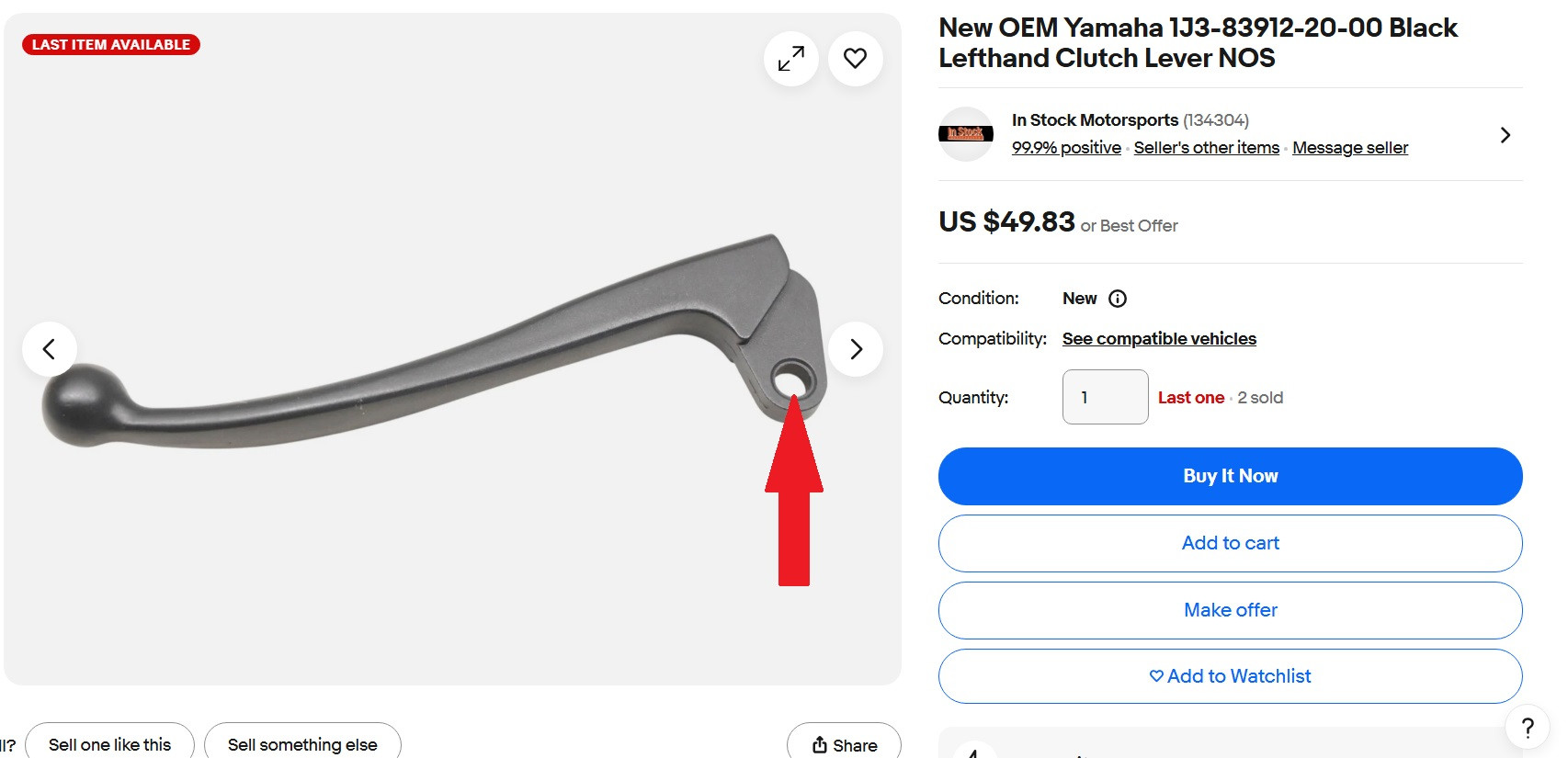

            OK. Three times apart and back together. I had a step way back for reevaluation. I can adjust all of the slipping out of it. I cannot get it to fully release. It's all buttoned up. I'm going to order a new clutch cable. I think mine is old and stretched. Secondly,[U
            the pivot hole in the lever is oval[/U]. I need to address that as well. I'm not sure when I can next get on this, but I'll let y'all know when I do.
            I appreciate all of the input gentlemen.
            The oval lever bearing might lessen the throw of the lever and it might have an effect on the plate separation.
            Click image for larger version  Name:	lever bearing.jpg Views:	0 Size:	173.9 KB ID:	889346

                      NOS lever:
                      https://www.ebay.com/itm/20578064687...Bk9SR5C_tPO1Zw
                        • 8061
                        #56
                        Yes sir! I mounted a brand new NOS lever. I even installed the o’ring on the bottom. I’m wasting my time futzing with a cable that is too short.
