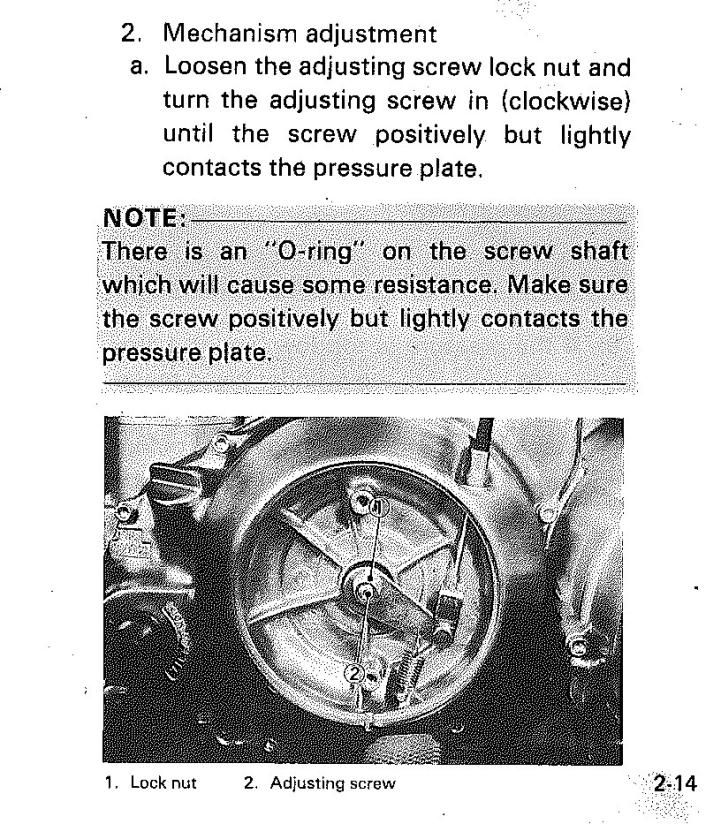

                Marty, can you get any slack by the lower adjustment under the right side cover?

                  Marty, what DEEBS11 posted, but turn COUNTER clockwise until loose, then clockwise until it touches, and back off 1/4 turn. Quick easy try before replacing the cable again.

                    Yes. I’ve done that exactly as described.

                      You could try 1/2 turn out on the adjustment screw under the clutch cover, it may create a little more slack in the cable. This is the way Bob Jones described the adjustment in his XS Eleven Heaven book. May be worth a try.
                      Maybe tie the lever down overnight to stretch the new cable some. Also, maybe remove the lockdown nut at the lever end to give a little more space for adjustment.

                          I can get slack with that screw, but I get creep with the lever against the grip.
                          There’s no slack with a proper adjustment. I’ll putz with it more but it has to be in a few days.
