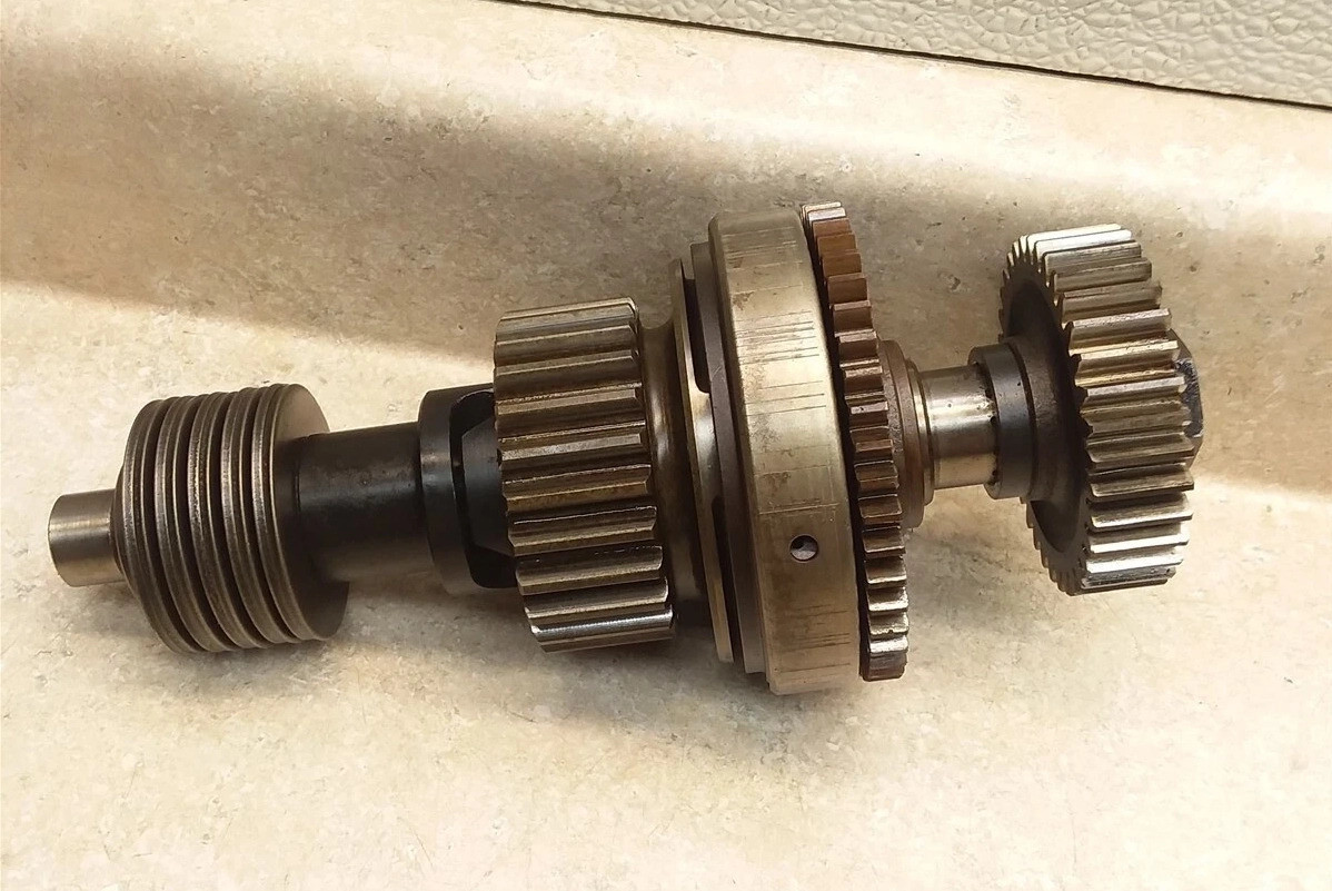

                            I have seen starter clutches slip. Many in fact. However, I have never seen or heard of one seizing. This will be an interesting test.
                              #74
                              I found that if I put the bike in gear, and rock the back tire to bounce the free play in the drivetrain, I can feel the starter clutch bind and unbind.
                              I removed the starter from my XS11SG to confirm what is normal, and found the gear moves smoothly and freely, even if I rock the drivetrain.
                              Therefore, I feel confident the problem is the starter clutch binding.
                              Like Deebs, I read about a lot of slipping starter clutches. I've had 4 cases myself. However, I also have never had one bind or seize, and I've never heard of it.
                              If I try to imagine the cause, maybe it is a broken spring...maybe one of the cups disintegrated,... or maybe the laminated substrate that houses the rollers is cracked????? Maybe a piece of debris got in there somehow (unlikely).
                              Regardless of the cause, I don't see any way to fix it other than splitting the cases.
                              I see the head coming off for the 3rd time. I'm not sure, but I may put this aside for next winter.
