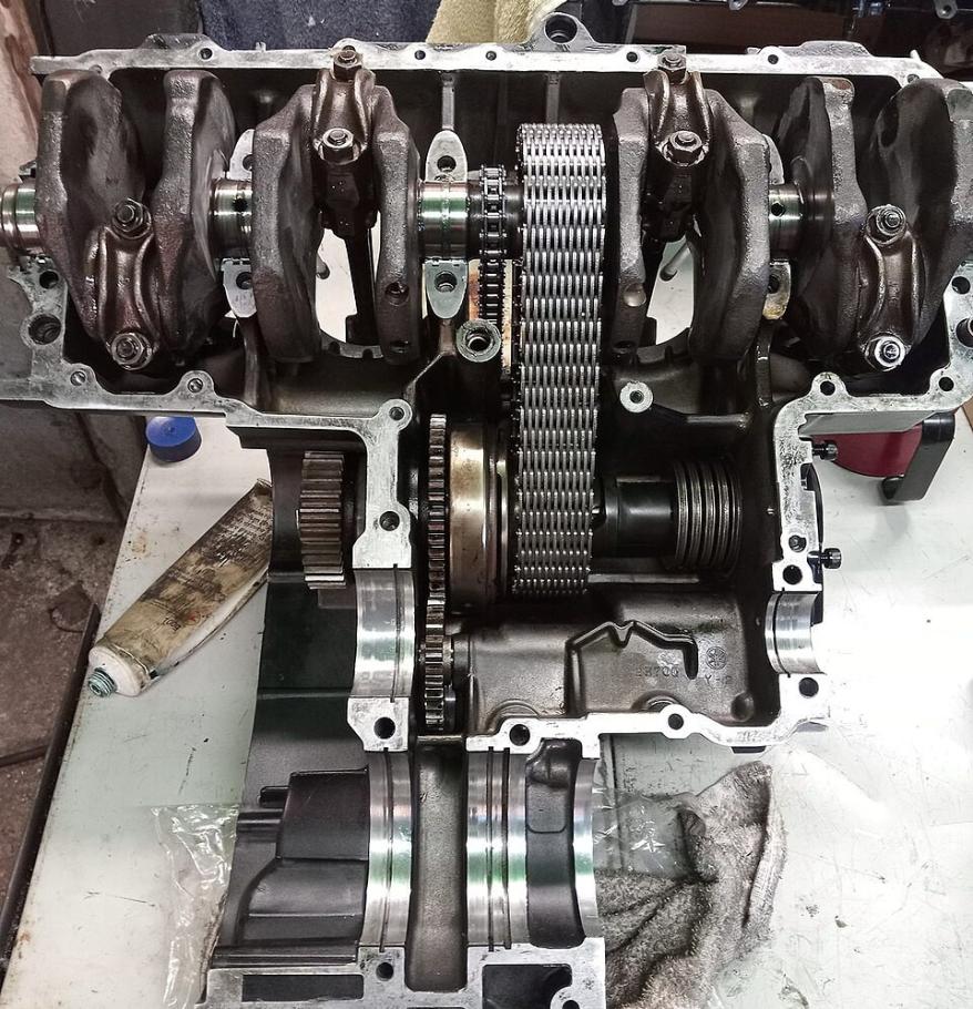

                      Rust and corrosion are the only actual explanation for a locked up starter clutch. Very unlikely. The broken spring theory does not hold water. The spring holds the roller against the shaft. A broken spring will only cause the opposite effect. It will make the clutch slip. I have worked on many starter clutches.

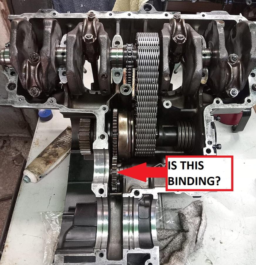

                          #87
                          That's where I am able to feel something is binding. I doubt it it is actually that idler gear, but I am listening if you have a thought.
                          I don't know how the cam chain guides would interfere unless some material came off of them.
                          I like your thinking that something is jamming in there. That's why my mind went to the springs and cups inside the clutch. I also wondered if I dropped something into the cam chain tunnel when I was working on it. All the parts and all the tools are accounted for.
                          So if we follow your train of thought, I will try using a small mirror to look in the starter hole toward the clutch. Long shot, but small effort.
                          Maybe I could fit a magnet through the starter hole toward the starter clutch.
