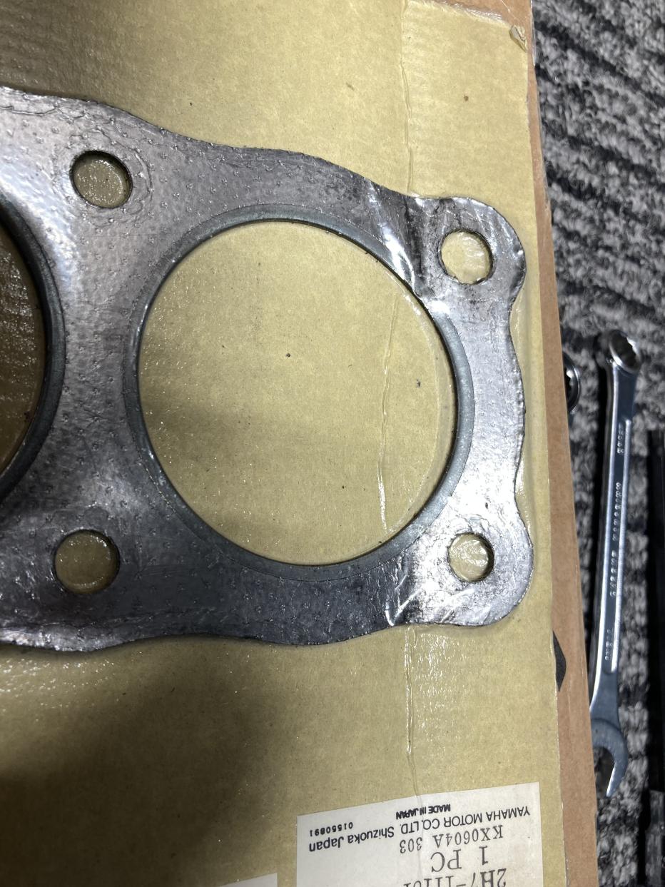

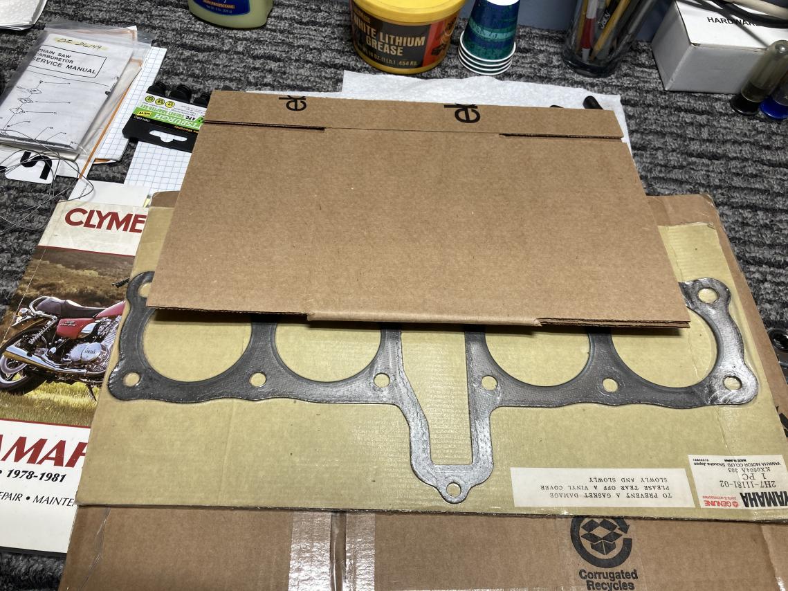

                          The head gasket finally arrived today.
                          I bought the nicest OEM gasket I could find. It cost $106 Canadian, and I paid another $44 Canadian for brokerage and tariff fees; all so I could maximize my chances to avoid the same problem.
                          Unfortunately, the gasket was bent during shipment due to inadequate packaging:
                          Click image for larger version  Name:	Bent Head Gasket 1.jpg Views:	0 Size:	189.5 KB ID:	889607
                          Click image for larger version  Name:	Bent Head Gasket 2.jpg Views:	0 Size:	180.8 KB ID:	889608
                          Of course I have complained to the eBay seller, but now I have to decide what to do next.
                          Would you use this gasket? It's bent but there are no kinks in the metal rings around the cylinder.
                            #58
                            Would you use this gasket? It's bent but there are kinks in the metal rings around the cylinder.
                            No, I don’t believe I would use that gasket.
                              #59
                              That gasket is ruined. I have had mail men shove head gaskets into my mailbox and they were ruined just like that. You can get your money back (eBay) because they were not properly packaged for idiot mail carriers (need to be packed with reinforcing cardboard with big words "do not fold" and "fragile"). When I purchase gaskets from an possible armature seller I will request they reinforce the packing so the rare antique gasket does not get damaged. These things happen.
