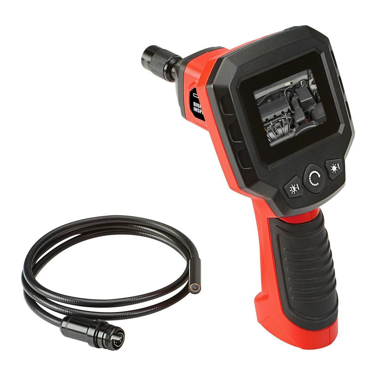

    Might I suggest pulling the plugs and taking a peep inside with a borescope/snake camera? ( •_•)
    One I gots looks like THIS-

    I got it from Harbor Freight... HERE-
    https://www.harborfreight.com/digita...RoCYpQQAvD_BwE
    I suggest NOT doing any mOaR start/run tests until you can actually SEE something what explains them scarey noises... ƪ( ` ▿▿▿▿ ´ ƪ)
    Based on your excellent audio descriptions? (O_o)
    Imma expecting for the camera to see crescent shaped dent(s) in the tops of the piston(s) from the valve edges. (╯•﹏•╰)

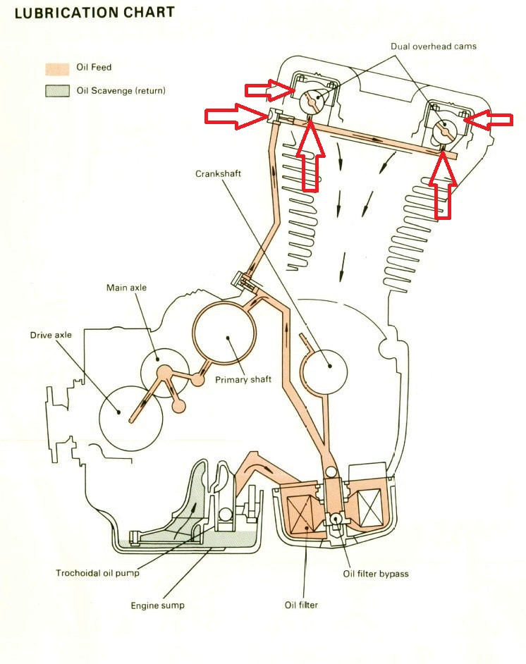

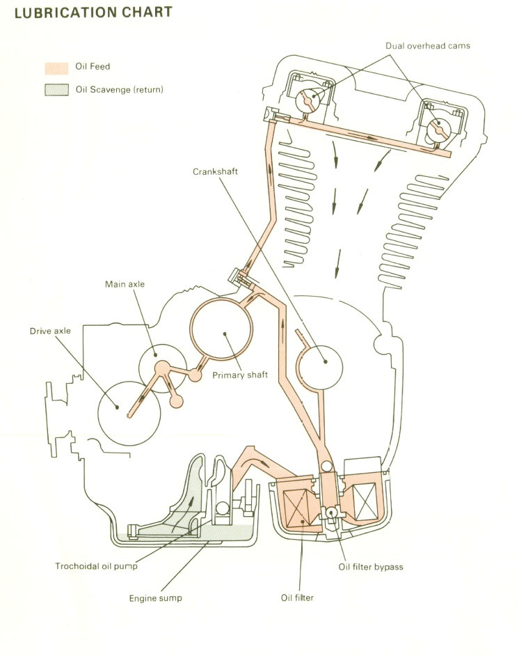

        Looks like there is no chance a leaking head gasket could directly have exhaust gases starve any bearings of oil:
Name:	Oil delivery.jpg
        That's comforting.
          I believe that oil looked like it just had some condensation moisture in it. Normal for short start ups. Screeching can only be moving parts that have been worked on last (most likely). The crank & pistons (should) be ok. Maybe cam chain or cam bearings. Maybe an oil galley got plugged. I would take it down again and check everything. It's a pain but you need to find the issue (obviously).

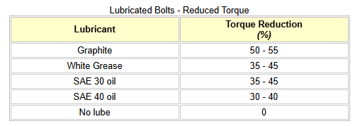

                It has been my understanding that the torque values in any factory service manual are referenced to clean, dry threads. Of course, this is born of my training and experience as an Airframe & Powerplant technician. Case in point, my Moto Guzzi Service manual states right up front that all listed torques are "lube torque" unless otherwise stated. If the Yamaha specs are lube torque, I can't find it. Therefore, torque values are clean, dry threads. This post is just FYI.

                Lubricated Bolts and Reduced Torque​
                  #38
                  I have a Harbor Fright torque wrench. It's cheap, but they actually get good ratings. Could be the problem.
                  Those tools are generally good in the middle of the scale. So, a 0-150 ft lb torque wrench is most accurate at 75 ft lbs. Several years ago, I tested my cheap wrenches in a calibration lab that I had easy access to. My cheap wrenches were all dead on in the middle of the scale. If the manufacturer stated that their tool was within 6% accuracy, my results were 6% over torque at the bottom of the scale and 6% under torque at the top of the scale. It's a much smaller discrepancy than adding lube where it isn't called for.

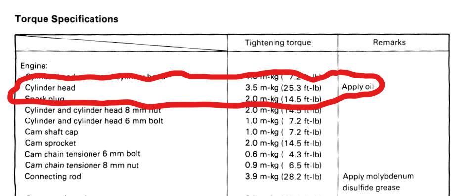

                    In the Yamaha FSM for XS1100E:
                    Click image for larger version  Name:	Torque Specs.png Views:	0 Size:	139.9 KB ID:	889480
                    Doesn't say where to use the oil.....but I assumed it would be the threads only..

                      In the Yamaha FSM for XS1100SE:
                      Doesn't where to use the oil.....but I assumed it would be the threads only..
                      Perfecto! Yes, that's a lube spec. So, in the Yamaha FSM, the torque specs are assumed clean, dry threads unless otherwise specified. I appreciate your post as I wasn't really sure about that.

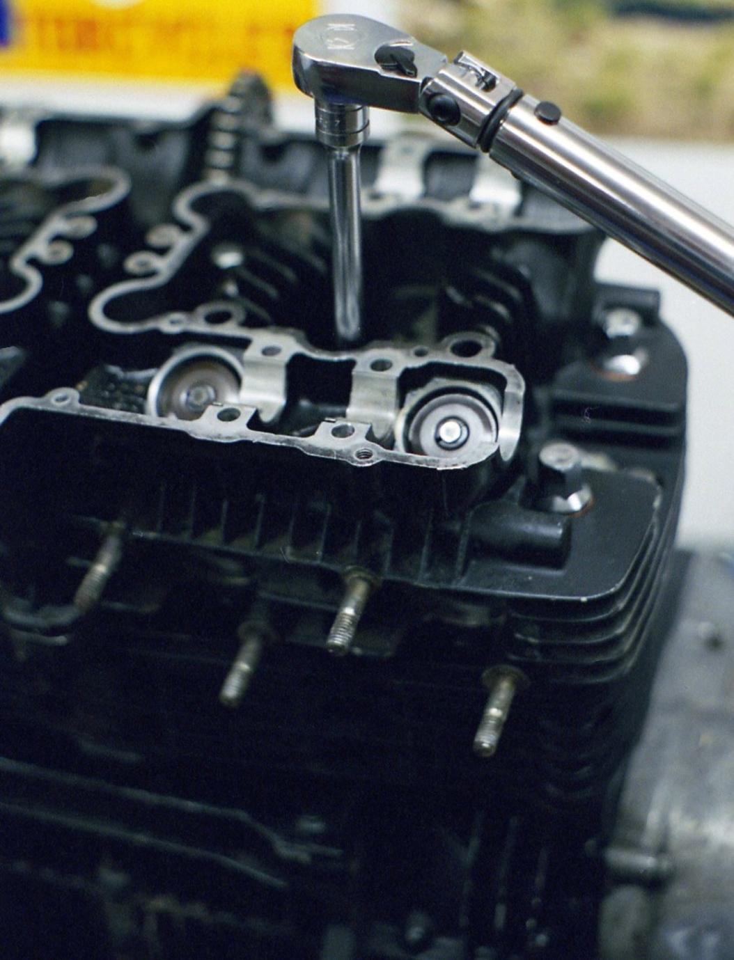

                              Typically new, clean parts are torqued dry. Old parts need a tiny bit of oil to prevent galling and locking up which throws of the torque wrench readings (it will "click" too soon). That small amount of oil practically dries up over time and it does hold the torque. I have been doing this for over 40 years without issues.
