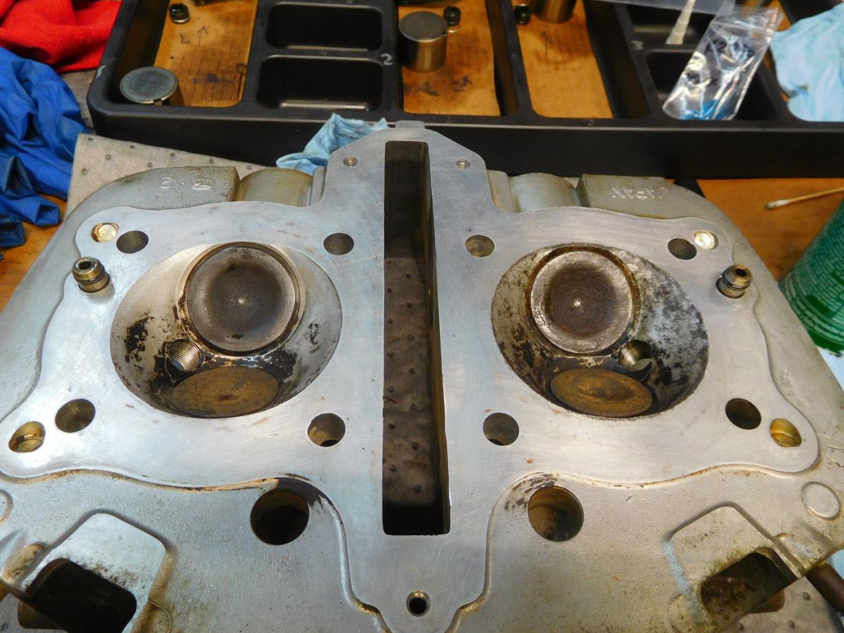

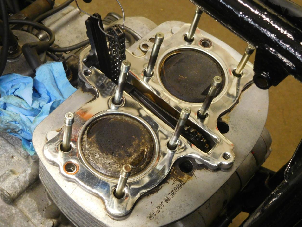

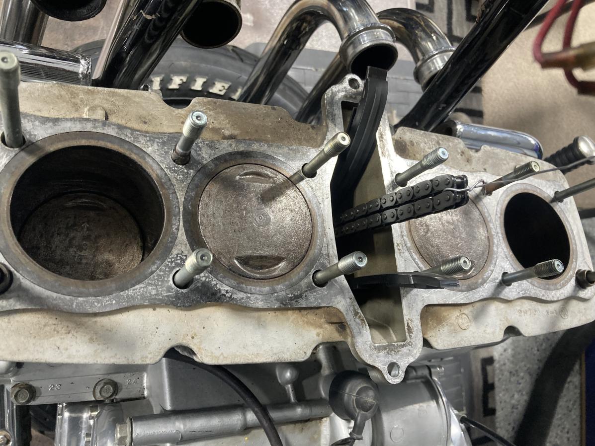

              I did clean the head and the pistons.
Name:	Dirty Pistons.jpg

Name:	Clean Pistons 2.jpg

Name:	Clean Valves 2.jpg

              I installed the new valve seals and got the head back on a few weeks ago.
              At first I found three valves clearances had shifted to the low end of the spec due to light valve lapping. I re-shimmed those and measured the compression.
              I got 155psi on all four jugs if I let the engine turn over about 20-25 times for each reading. I was pleased they all were the same and they were favorable.
              After measuring the compression, another intake valve has clearance at the low end of the spec. Must have had some crud under the valve. I am still waiting for an ordered shim to adjust that one.

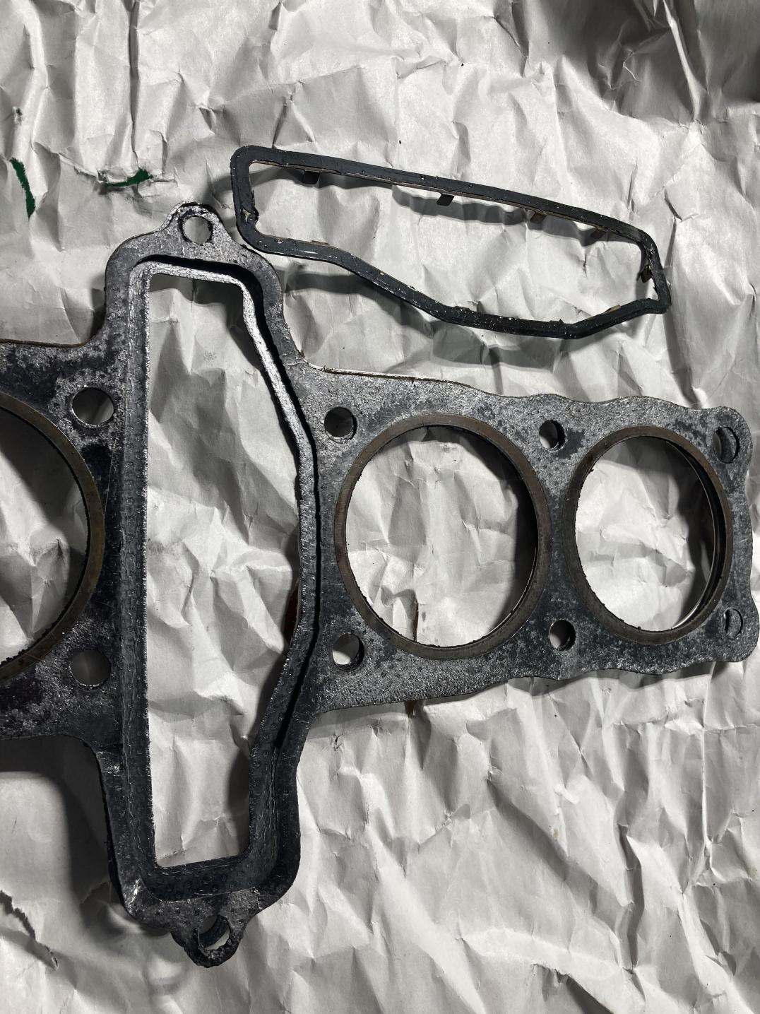

                As a side note, it's apparent that the Vesrah head gasket is made so you delete the seal around the chain tunnel (at least I hope so ).
                Here is the old gasket laying top the new gasket:
Name:	Head Gasket.jpg

                  Yes, that cam tunnel seal has been omitted from the aftermarket and OEM head gaskets for many years now.
                    Mike, nice job on cleaning up that carbon. How did you end up doing it?
ID:	887255 Click image for larger version

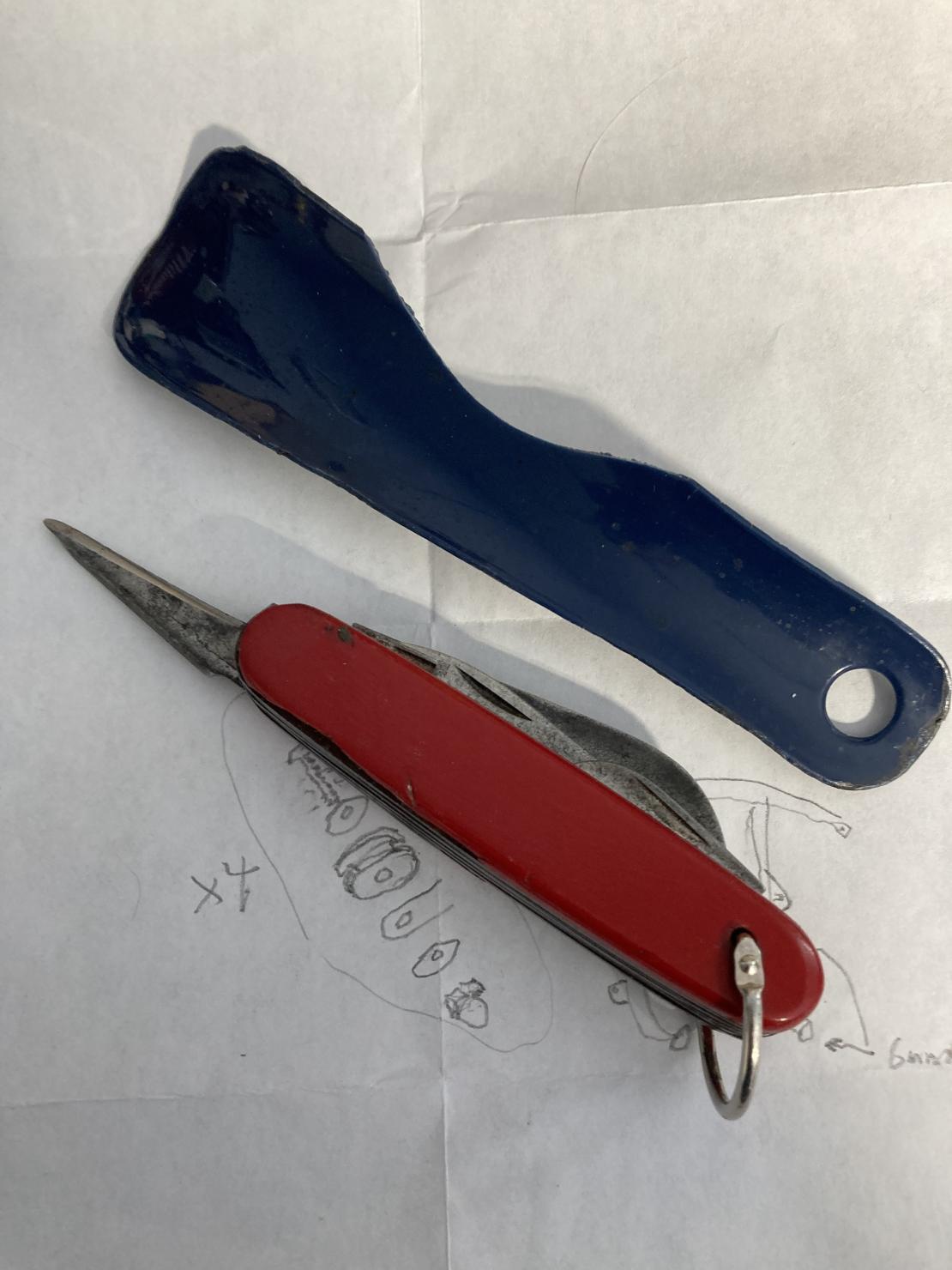

                      For the head, I mostly used a plastic cheap plastic shoe horn that had big radii on each end and a knife-like die parting line. I used Goof-Off and lacquer thinner to help. I also used a Dremel brass wheel and scotch bright to help along the way.
                      I used a brass wheel on the bench grinder to clean up the valves.
                      For the pistons, I mostly used a Swiss Army pocket knife blade that was more like a scraper than a blade. Then I hit them with the Dremel brass wheel.
                      I cracked the shoe horn using it as a shoe horn after I was done, but here is what I used:
Name:	Scraper Tools.jpg
                        Looks great Mike. Simple tools and some elbow grease.

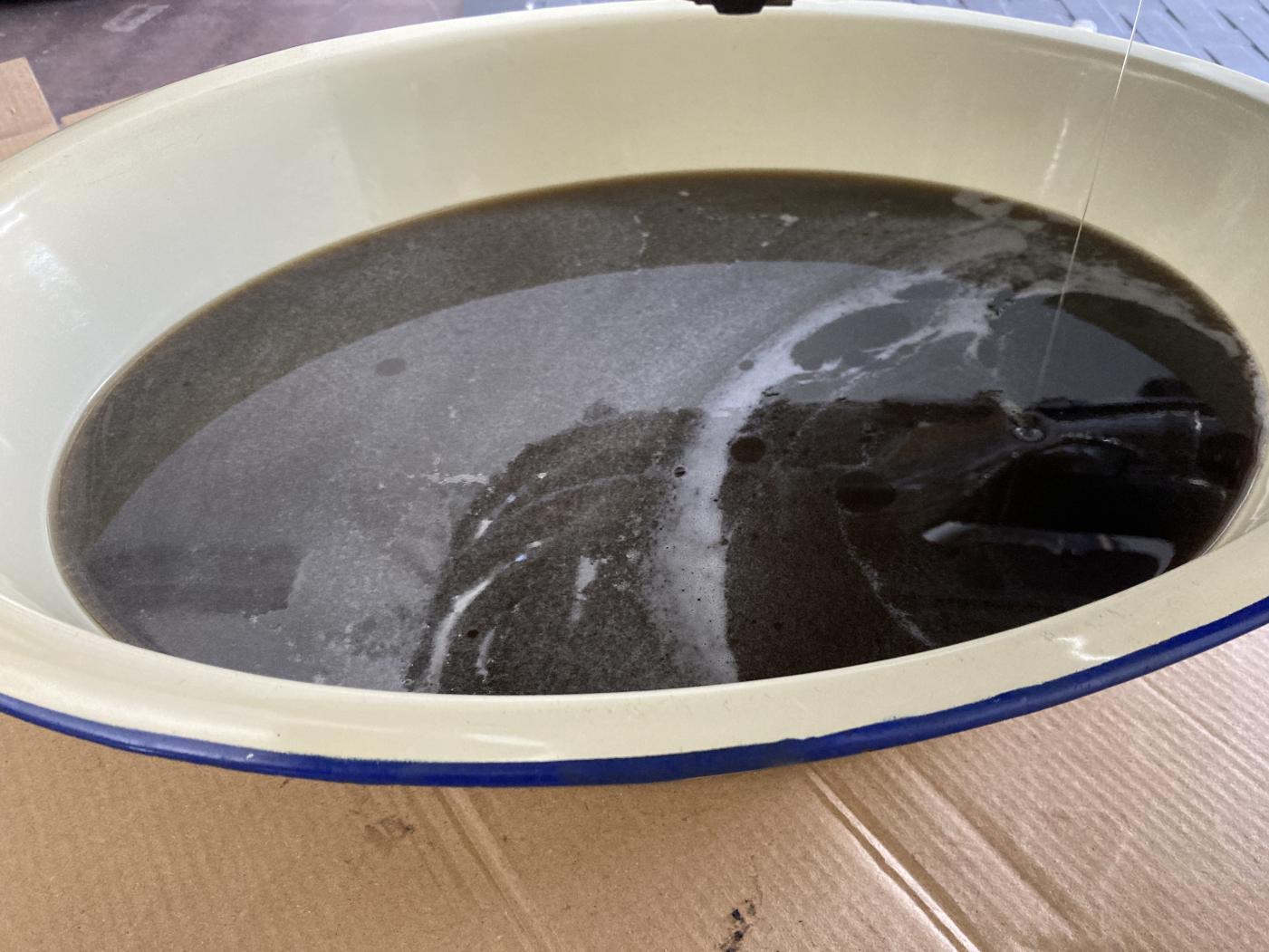

                            I tightened the head bolts (nuts) and started it today.

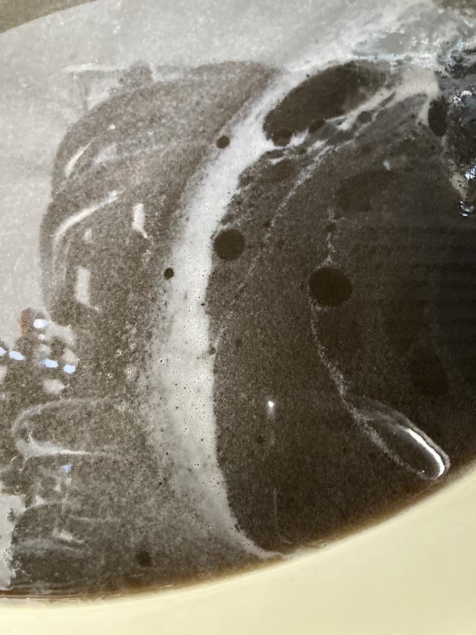

                            At first, it sounded normal except #2 cylinder didn't seem to firing, because that vacuum gauge was near 0 PSI. (That plug looks very clean compared to the others.)
                            As I tried to adjust #2 sync to see if it was just set too low, the awful sound came back.
                            It went Erk-Erk-Erk-Errrrrrrrrrrrrrrrrrrrr. It is loud and sounds like something is terribly wrong.
                            I drained the oil and I didn't see any metal flakes, although I haven't poured out the pan to see what might have settled.
                            I did notice that as the most of the oil had come out, I began to see a lot of foam in the oil. In fact it seemed like the bubbles sometimes came up from the oil. I wonder if it is exhaust residue.
                            Therefore, I am beginning to conclude the head gasket installation is NG.

                                Here is what the oil looked like right as I drained it:
                                Click image for larger version  Name:	Foamy OIl 1.jpg Views:	0 Size:	156.2 KB ID:	889460
                                Click image for larger version  Name:	Foamy Oil 2.jpg Views:	0 Size:	141.2 KB ID:	889461
                                After the oil sat for a few hours, it looked normal again (no foam).
