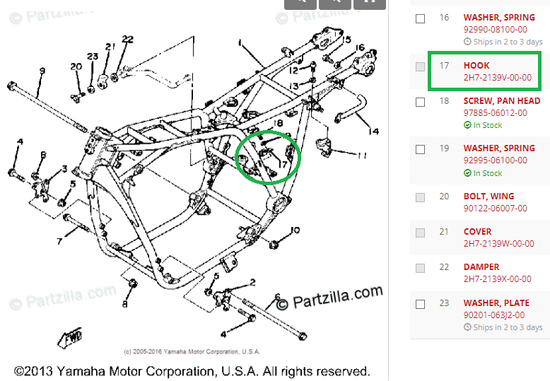

    (2H7-2139V-00-00) HOOK is the part number for the hook. Probably only going to find one thru Andreas or off a parts bike.
    2-79 XS1100 SF
    2-78 XS1100 E Best bike Ever
      • 2057
      #47
      That's it! Thanks!

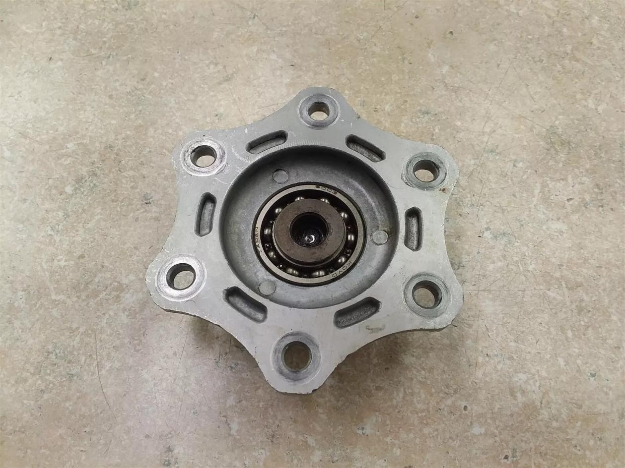

                  • 2057
                  #53
                  Like they said, the pressure plate can crack if not loosened or tightened evenly. The M6 screw does not have to be Godzilla torqued. Just snug tight. It's steel in aluminum threads. Easy to damage.

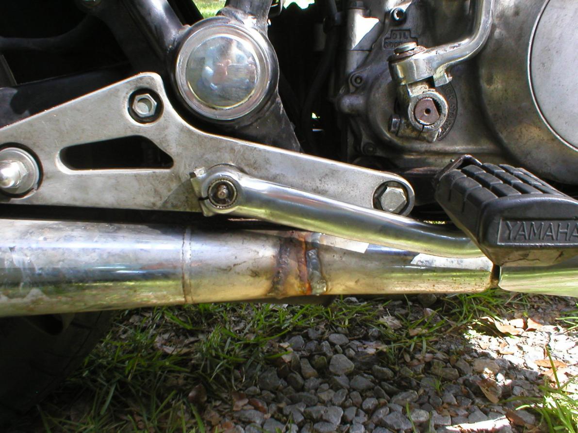

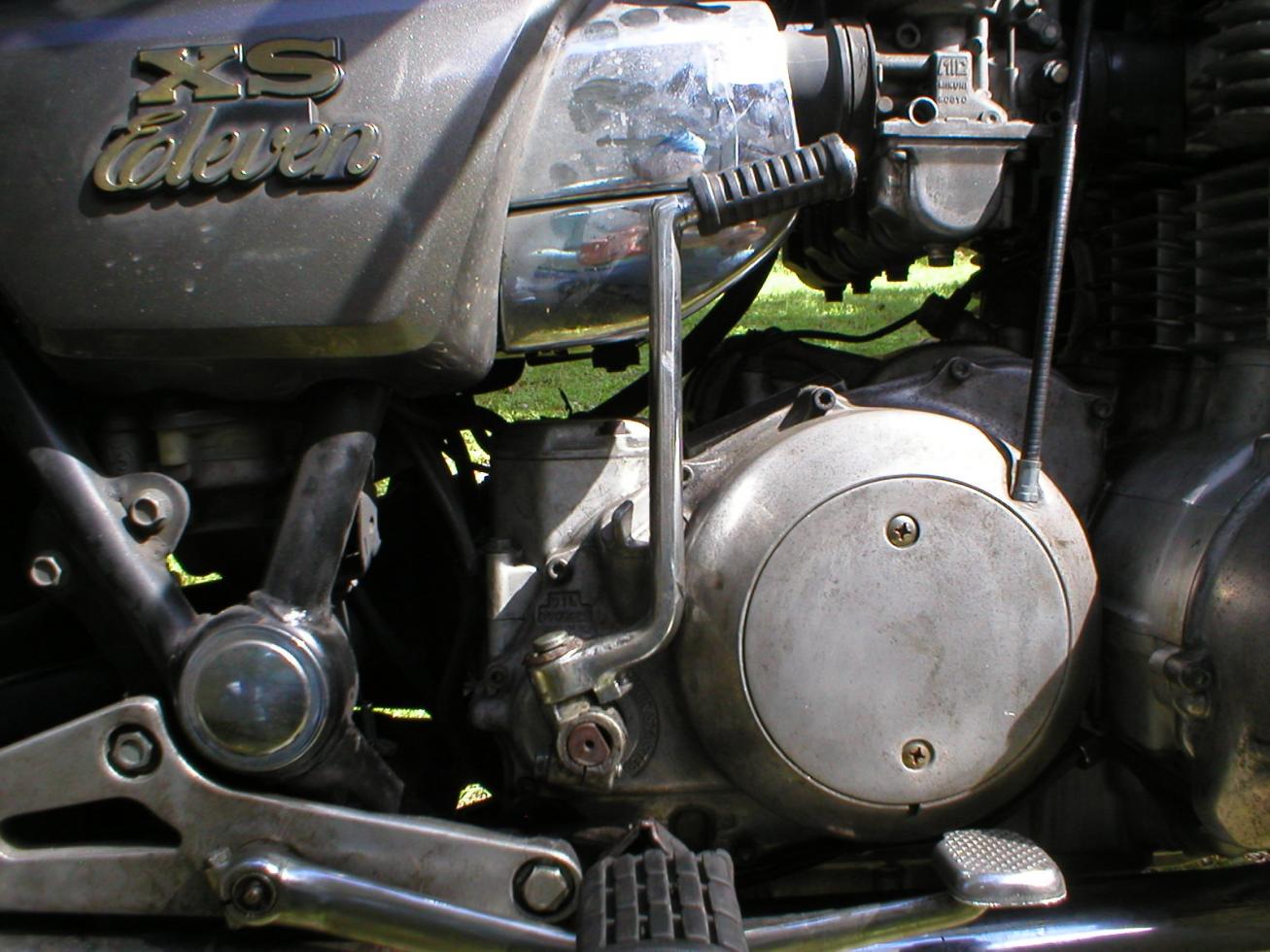

ID:	881376 Great shop here put kickstart in and welded pipe again.
                    80 G
                      • 2057
                      #55
                      Looks great! Even got the pinch bolt on.

                        #56
                        Awesome bro. Tell us, does your engine kick over pretty easily?
                        • speedlimit85
                          • Jan 2017
                          • 454
                          • Gainesville, Fl.
                          #57
                          Yea.I'm able to get it in a few kicks, Less choke and more throttle than starer button.
                          80 G
                            • 8930
                            #58
                            I kind of recall kicking one once with a foldable kicker, and it seemed to be dangerously close to the side cover. I was afraid it would break if I hit it with my boot. Any clearance issues with yours?
                            • speedlimit85
                              • Jan 2017
                              • 454
                              • Gainesville, Fl.
                              #59
                              I was worried about the side cover but it's more up by the air box.
                              Good idea to push up the rear peg out of the way.
                              80 G
