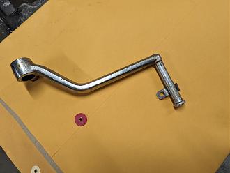

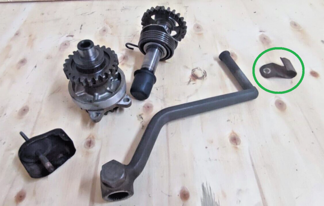

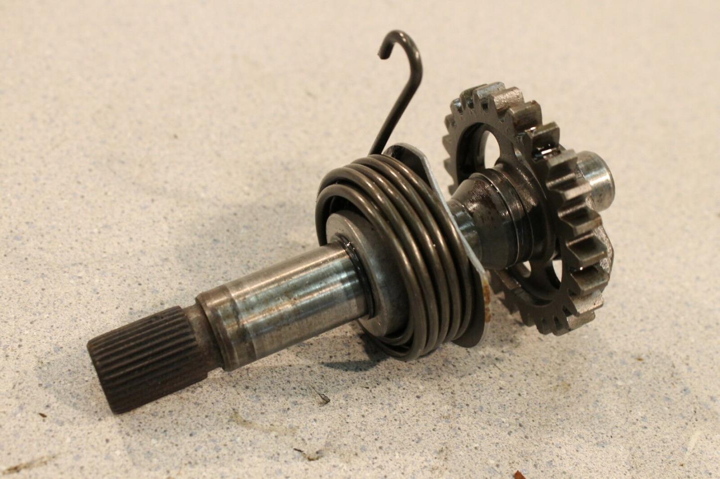

                • 2057

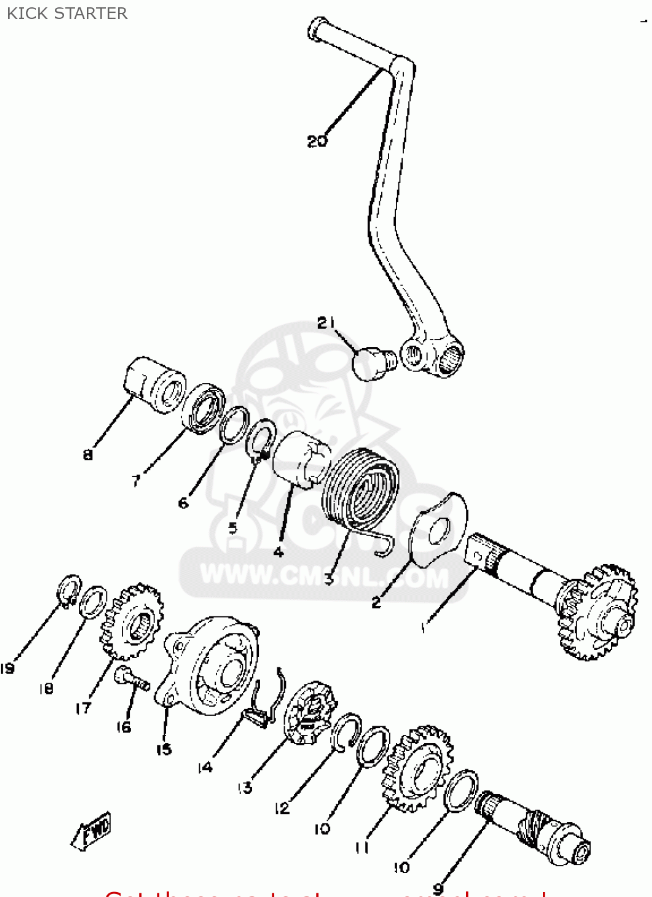

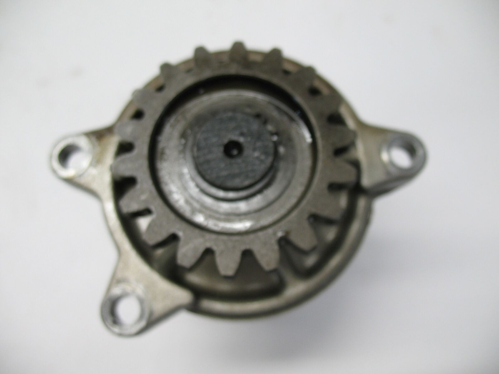

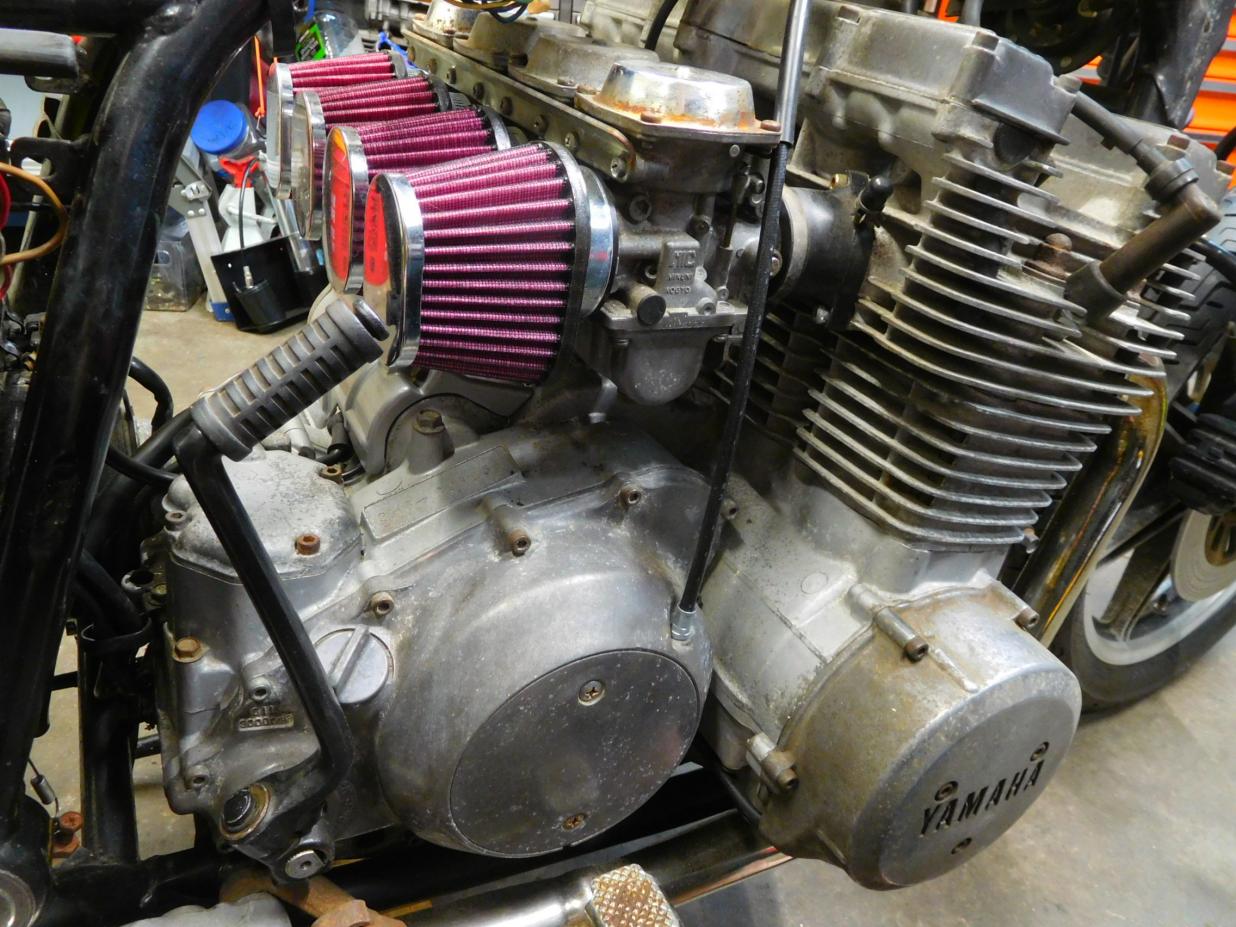

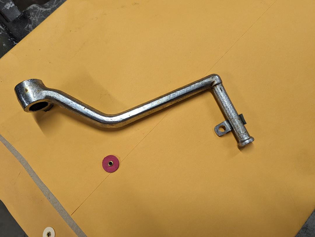

                I have an 80 motor in my 78. Added a used kicker gear cluster from a 78/79. You must remove the clutch and add a new kicker seal but it's all bolt in. Works great.

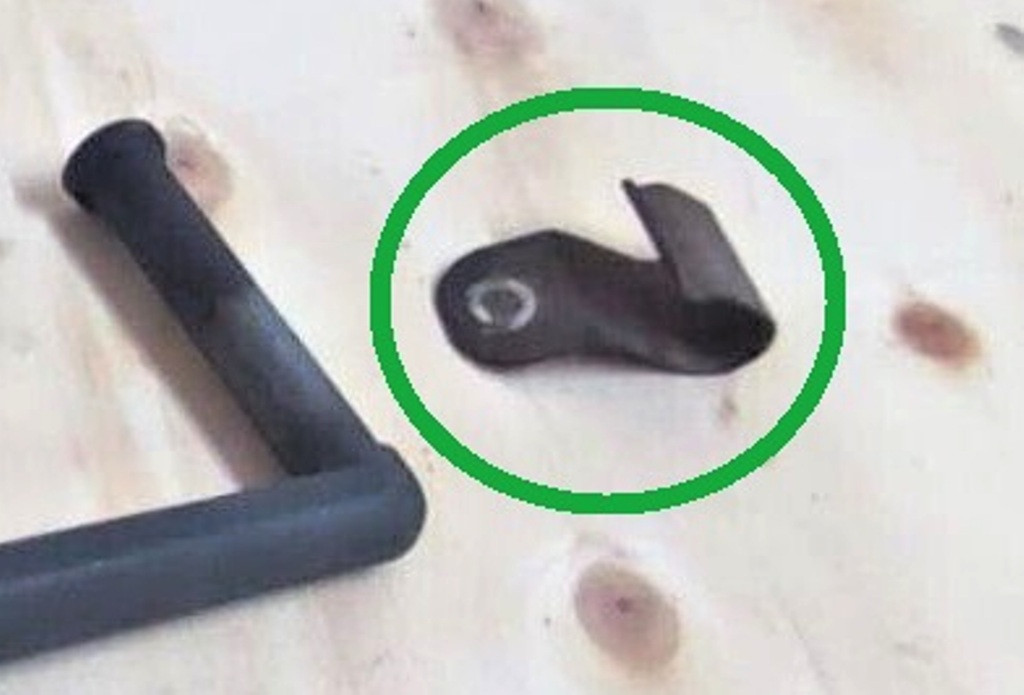

                    • 2057

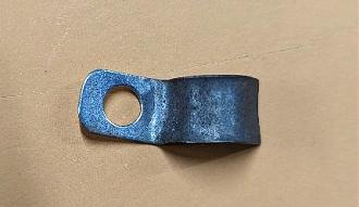

                    By the way, this is one of the rarest XS11 parts known to man. The elusive emergency kick start frame clip that is bolted under the battery box. I have been looking for one for a few years now. Only on 78 and 79 XS11s.

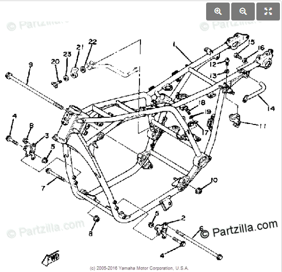

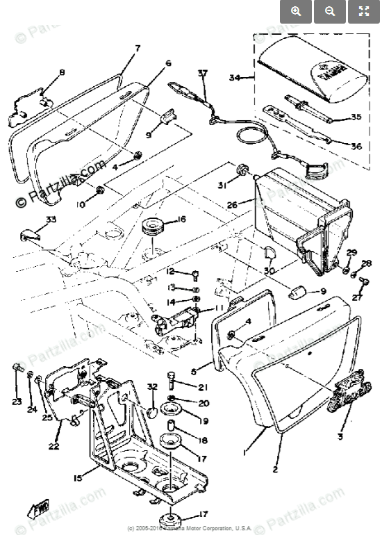

                      • 2057
                      That damn clip is never mentioned in any parts diagram. There is no known part number.

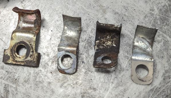

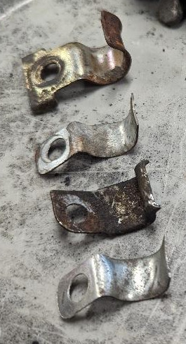

                          Deebs, I don't know what this part is for, but I found it in my misc. parts hardware box. Might it be the clip you are looking for? Seems like it would fit the kicker. But then it might just as well be a wire harness clip or something else.
                          No Clue!

                            Deebs, Found a few more. Maybe one of these?

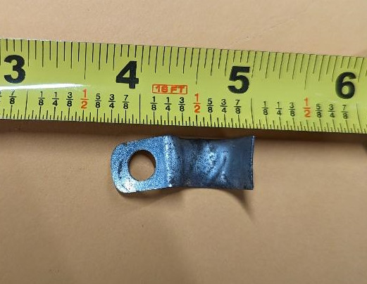

                              • 2057
                              I will try and take a picture of the one that is in my 78 frame. We will see if it matches up. The picture I posted seems to fold over quite a bit and fit the footrest of the emergency kicker. It should snap in with a "click" I believe.
