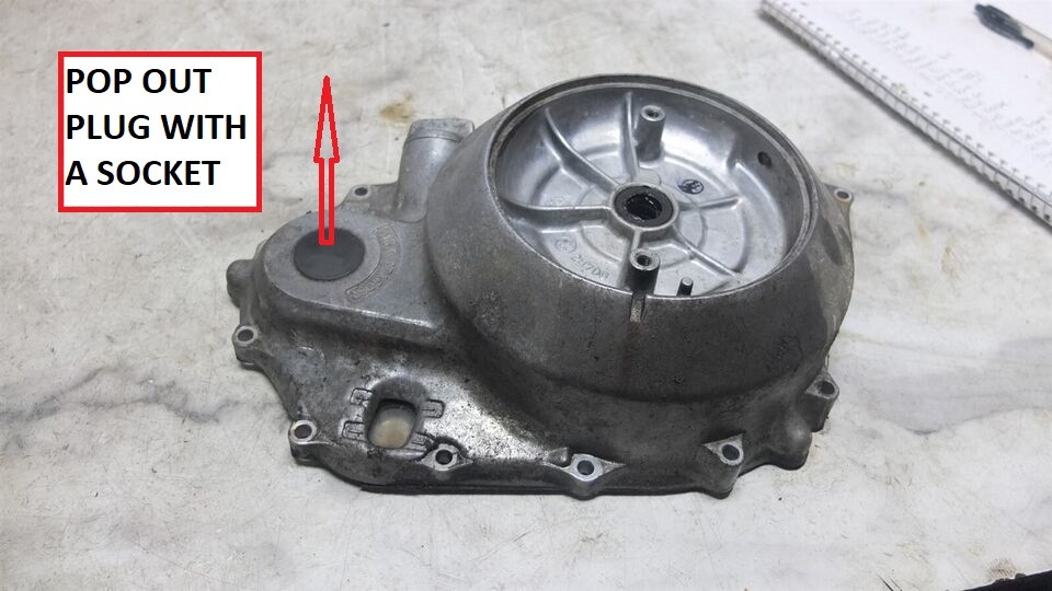

                        A good mechanic here won't touch the oil seals but will put a kick-starter on. But... If I get parts wrong or missing, he'll put it back together charge me twice- won't leave a bike apart in limbo in his shop.

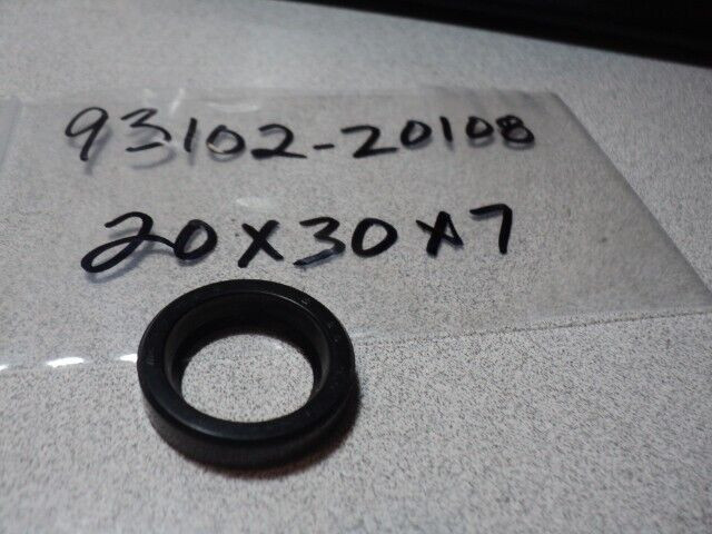

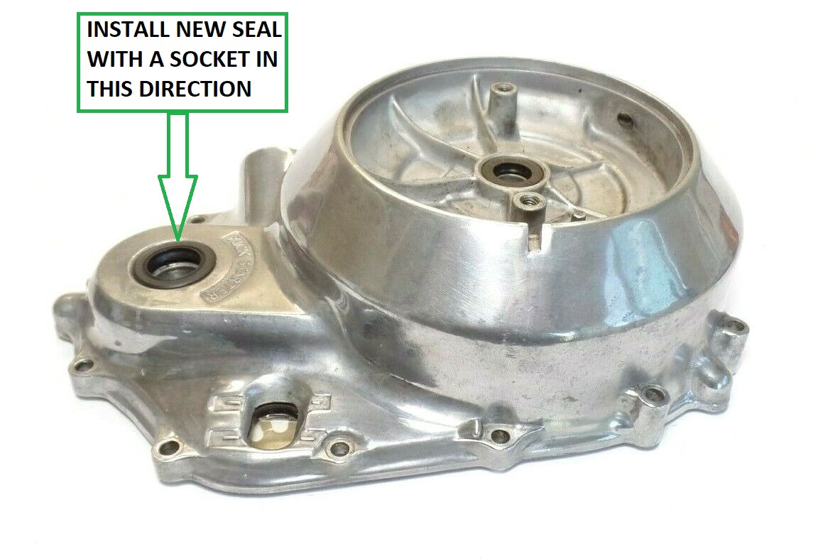

                            A good mechanic will install a simple seal without hesitation. Not sure why he would not touch the seals. It's arguably the most important part of the modification. Don't buy another cover with a used seal or you will have yet another oil leak. The seal must be new and installed carefully so you don't nick it.
                            https://www.ebay.com/itm/18618020925...Bk9SR_z0gMfmYw

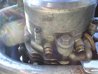

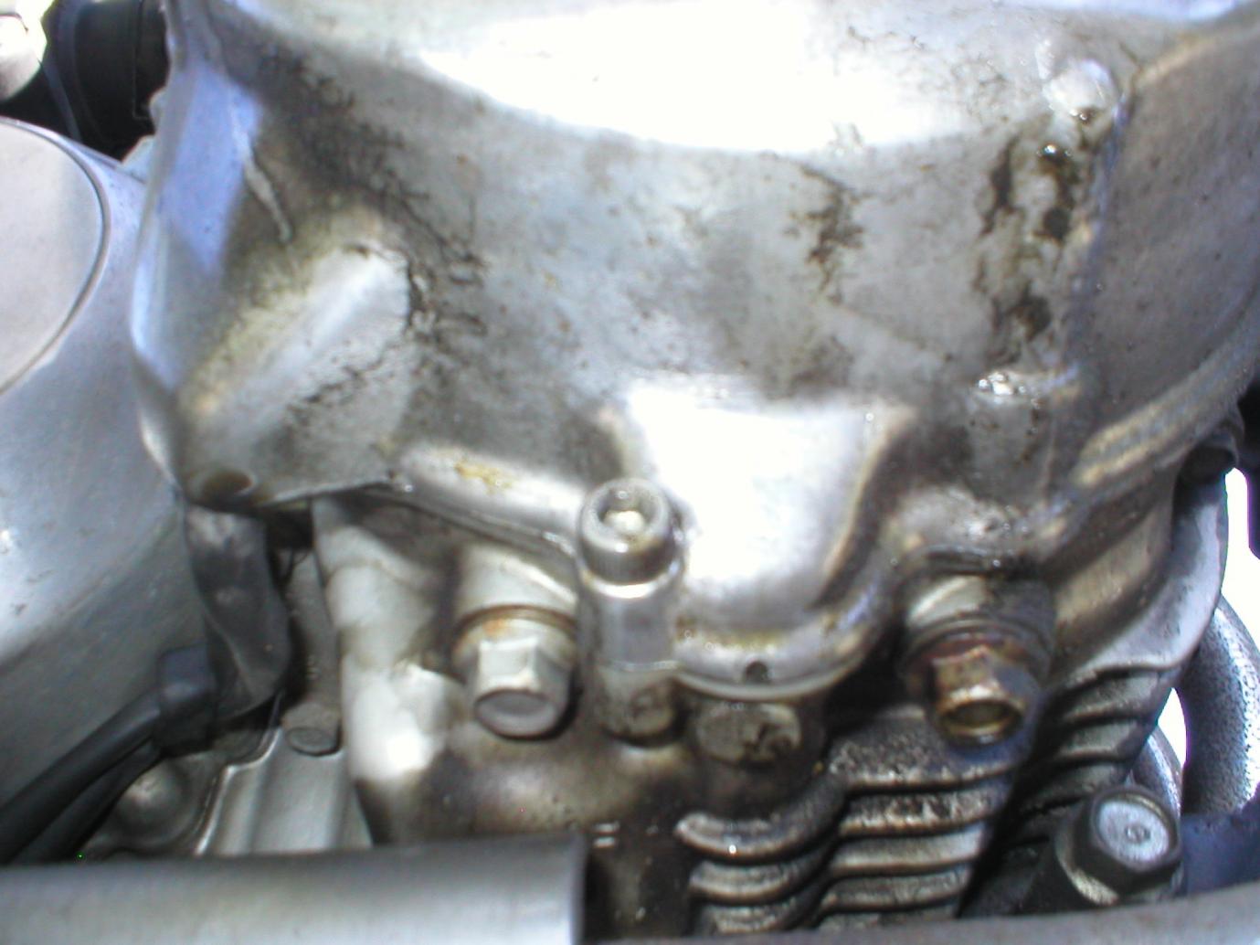

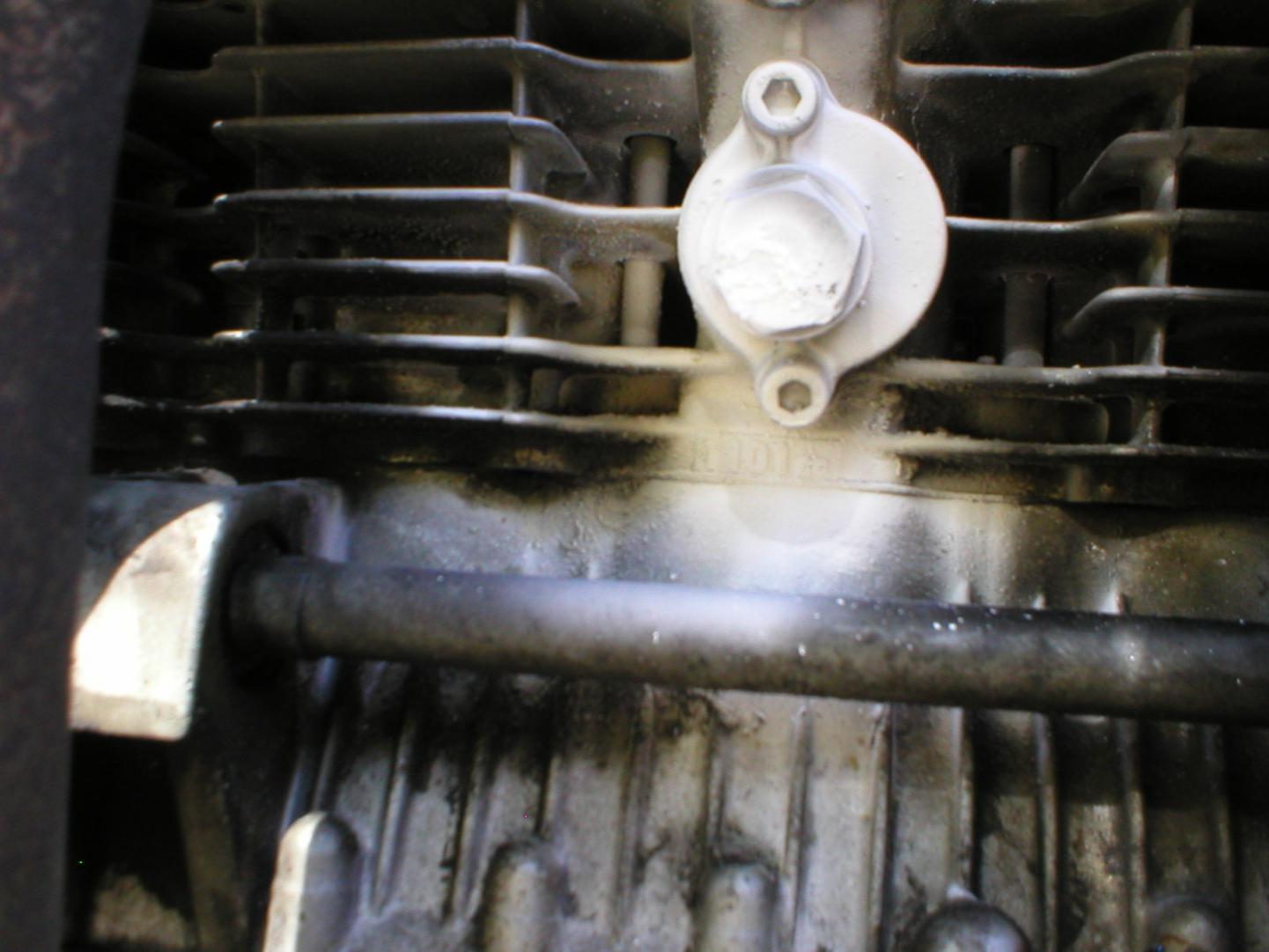

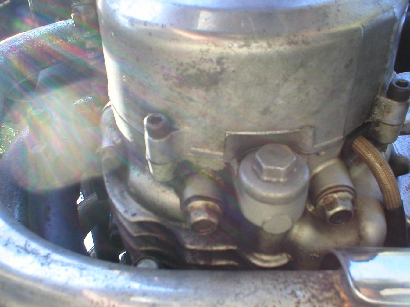

                                I appreciate the pictures and instruction. Click image for larger version
ID:	879509 Left side good. Click image for larger version
ID:	879510 Right side bad. Click image for larger version
ID:	879511 Front... not sure. Some leaks show only after longer rides.
