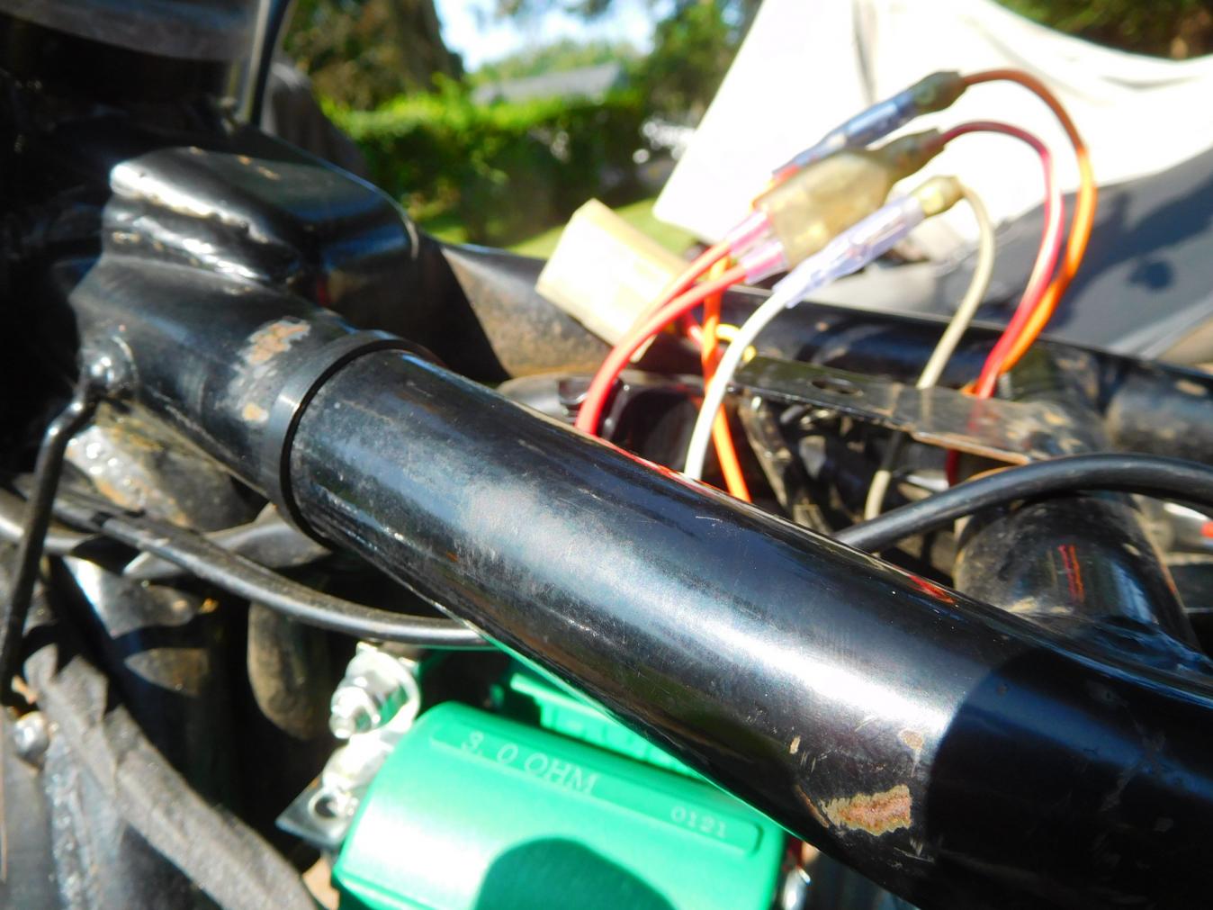

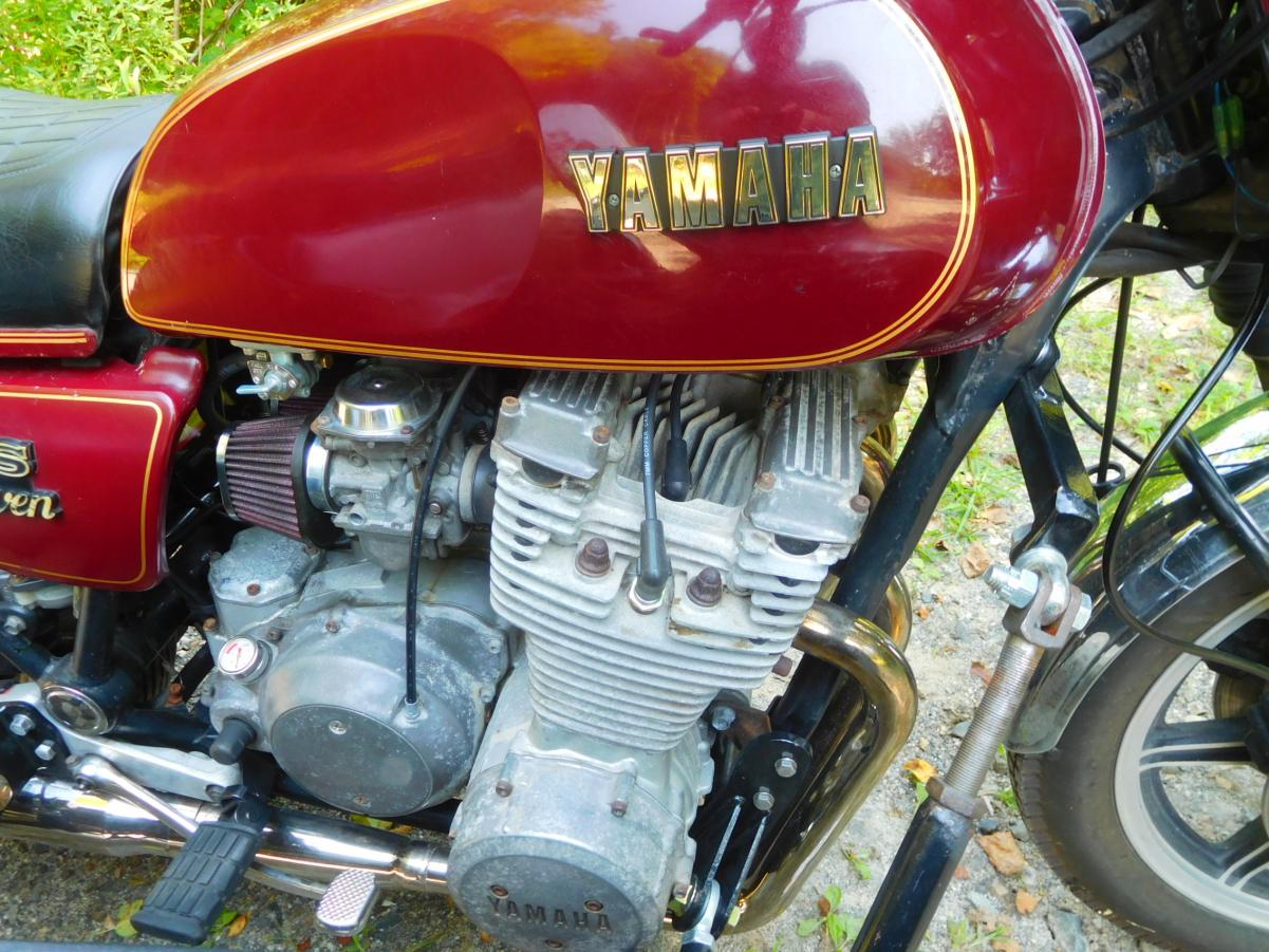

78 Sidecar Project

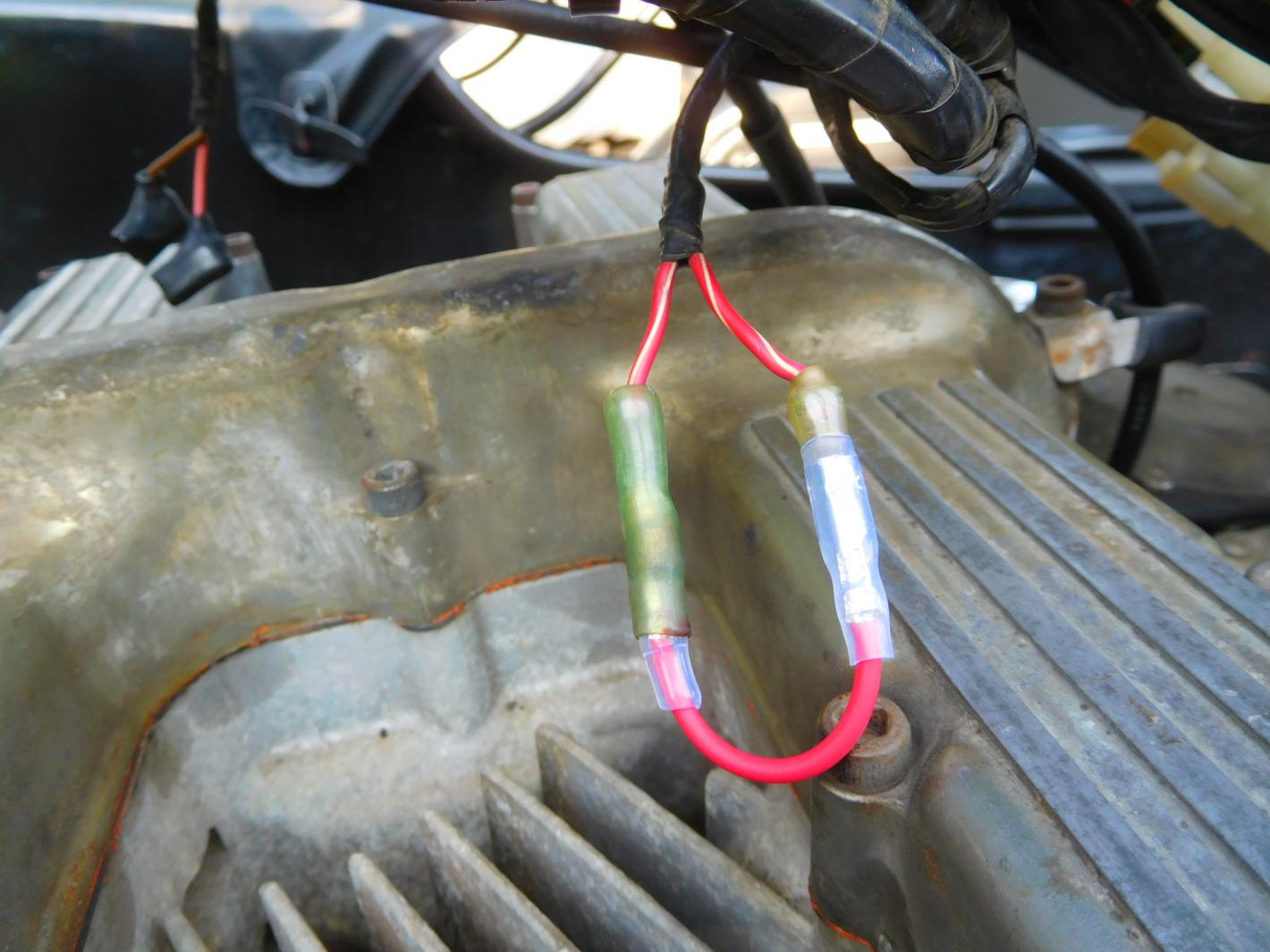

    • 1932

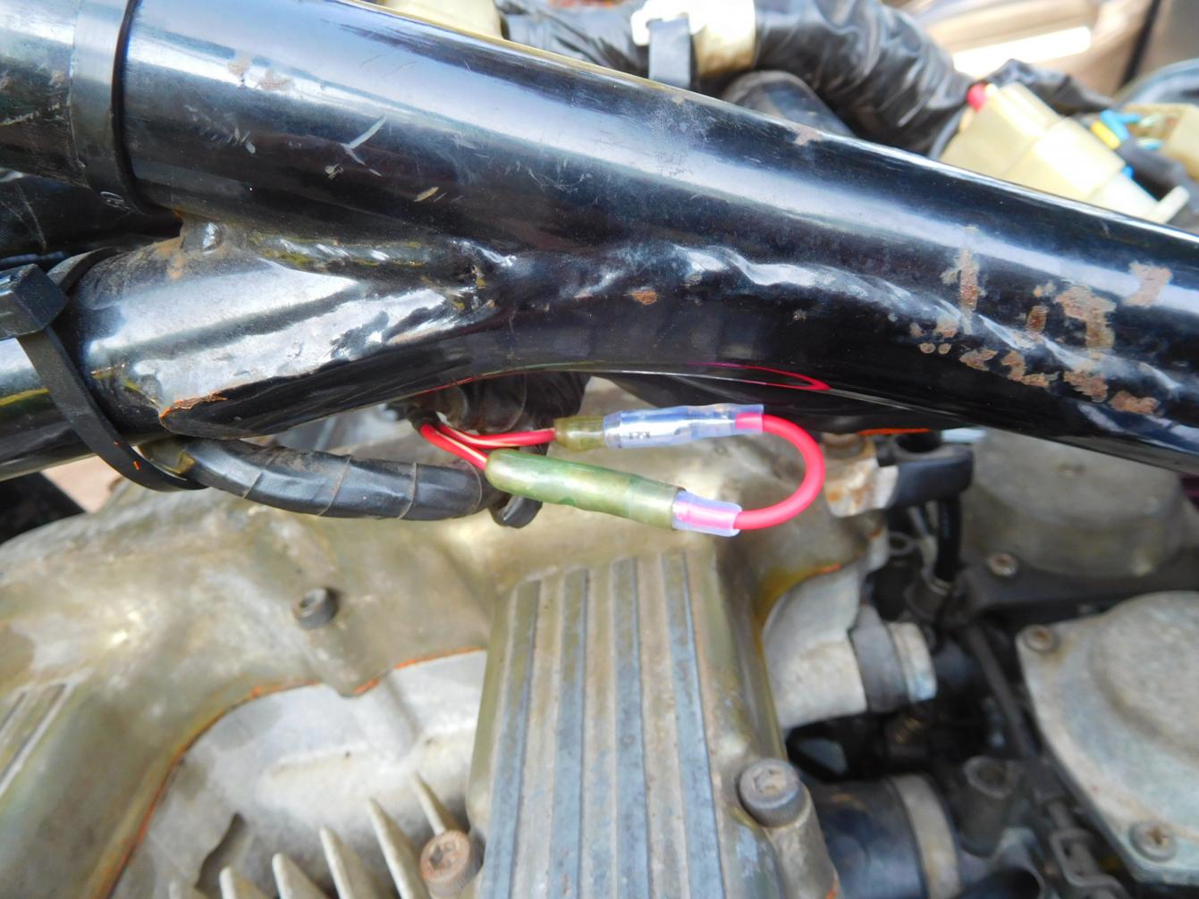

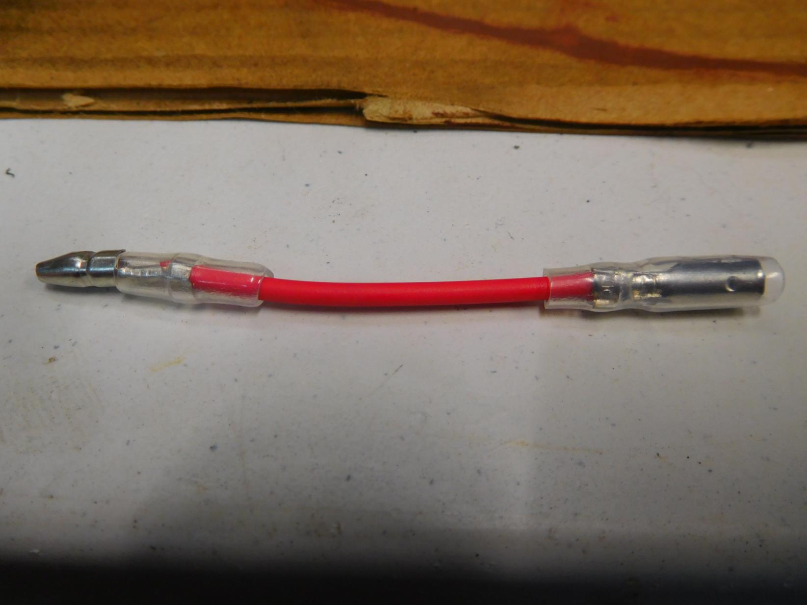

    #61
    New jumper to eliminate ballast resistor.
ID:	875002 Click image for larger version
ID:	875003 Click image for larger version
ID:	875004 Click image for larger version

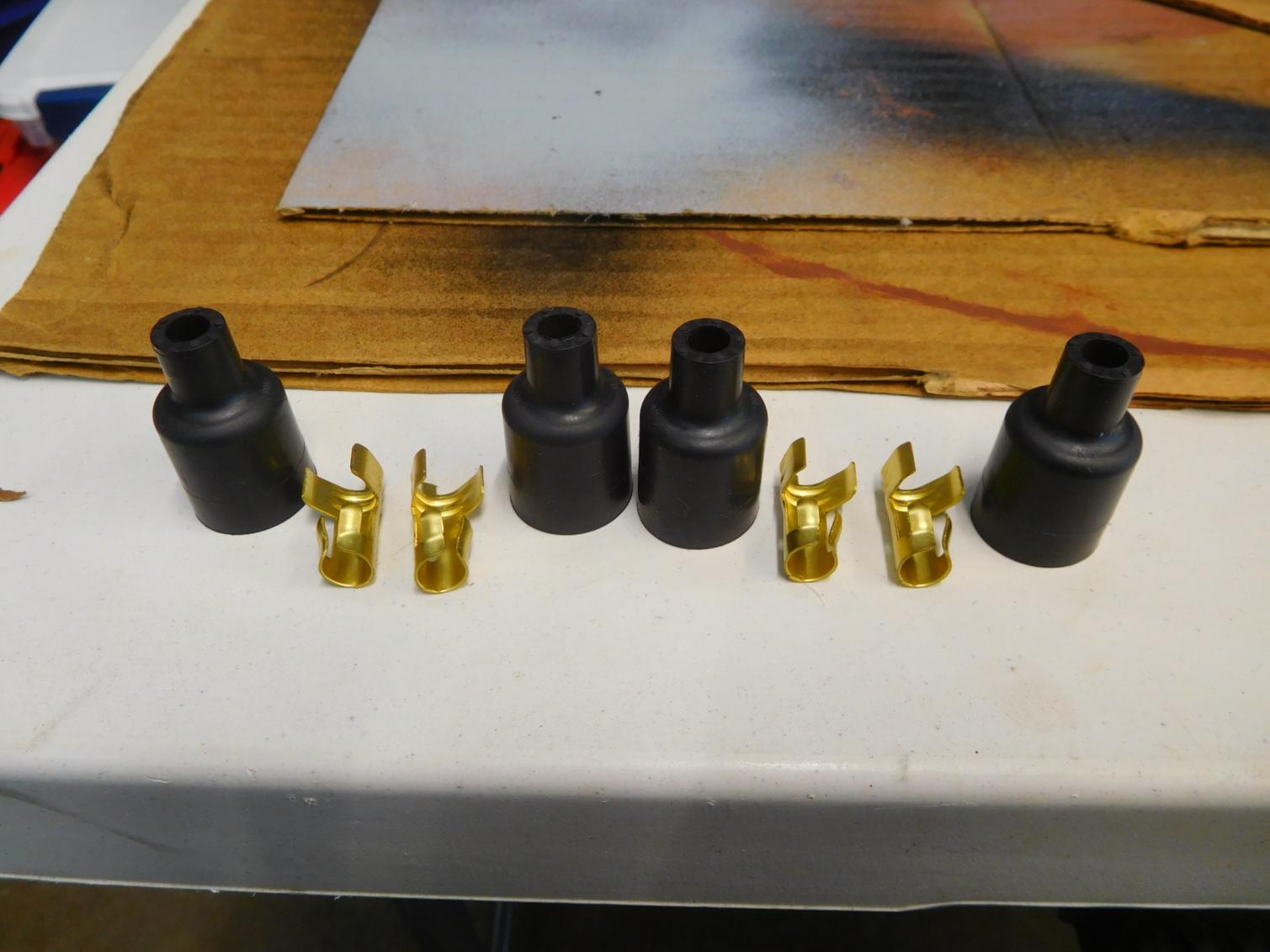

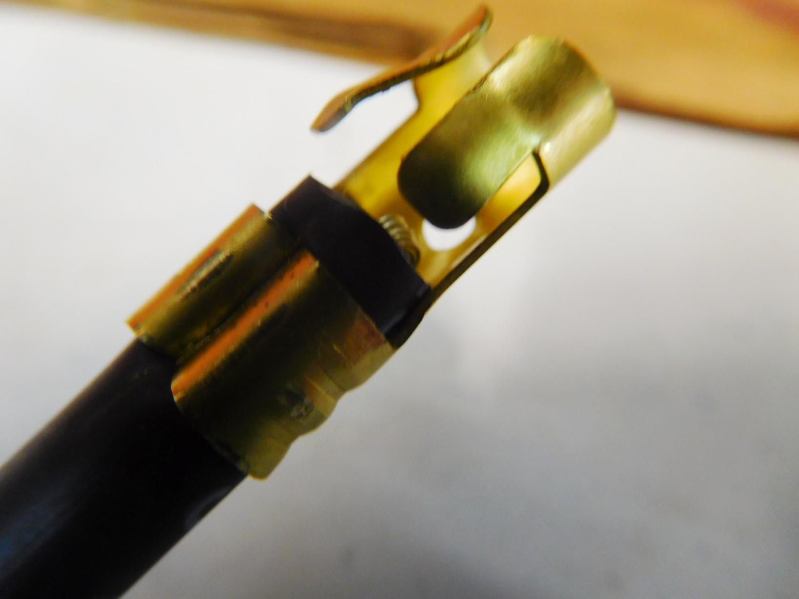

      • 1932
      #62
      Crimping coil secondary wires.
ID:	875007 Click image for larger version
ID:	875008 Click image for larger version
ID:	875009 Click image for larger version
ID:	875010 Click image for larger version

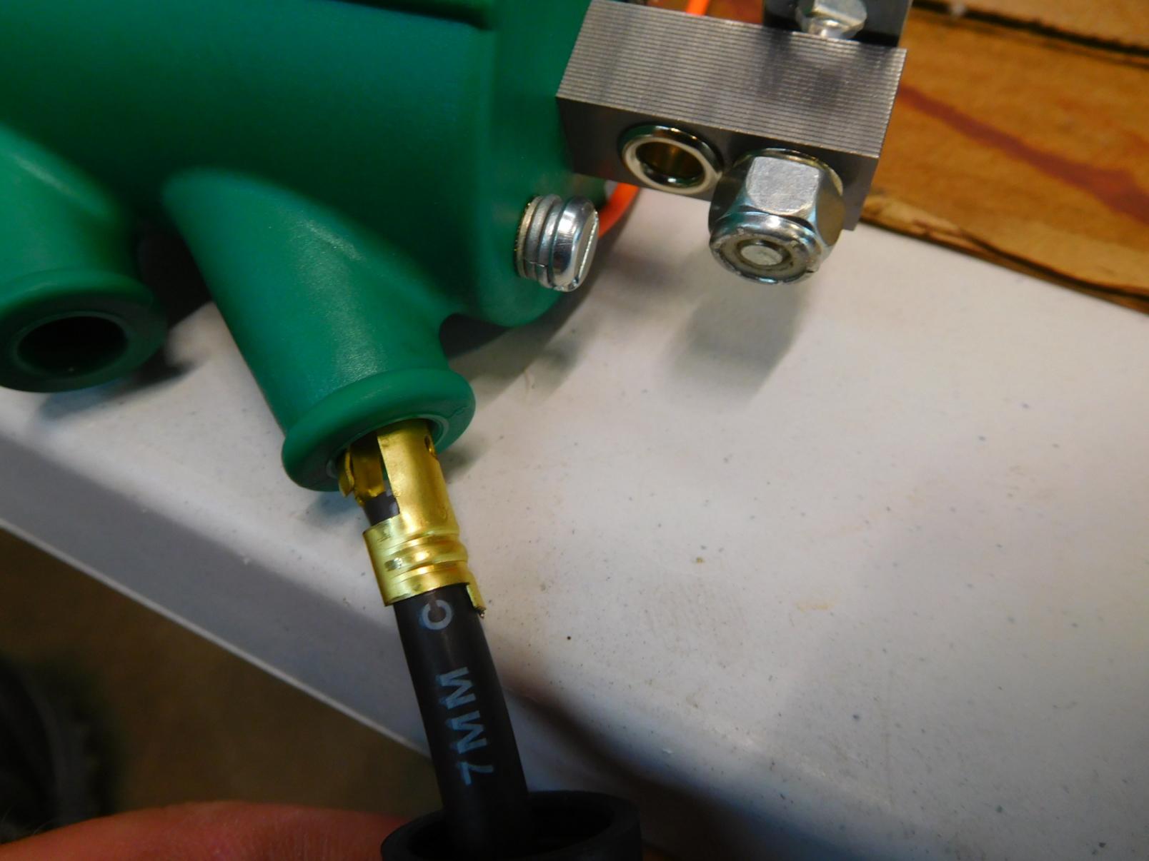

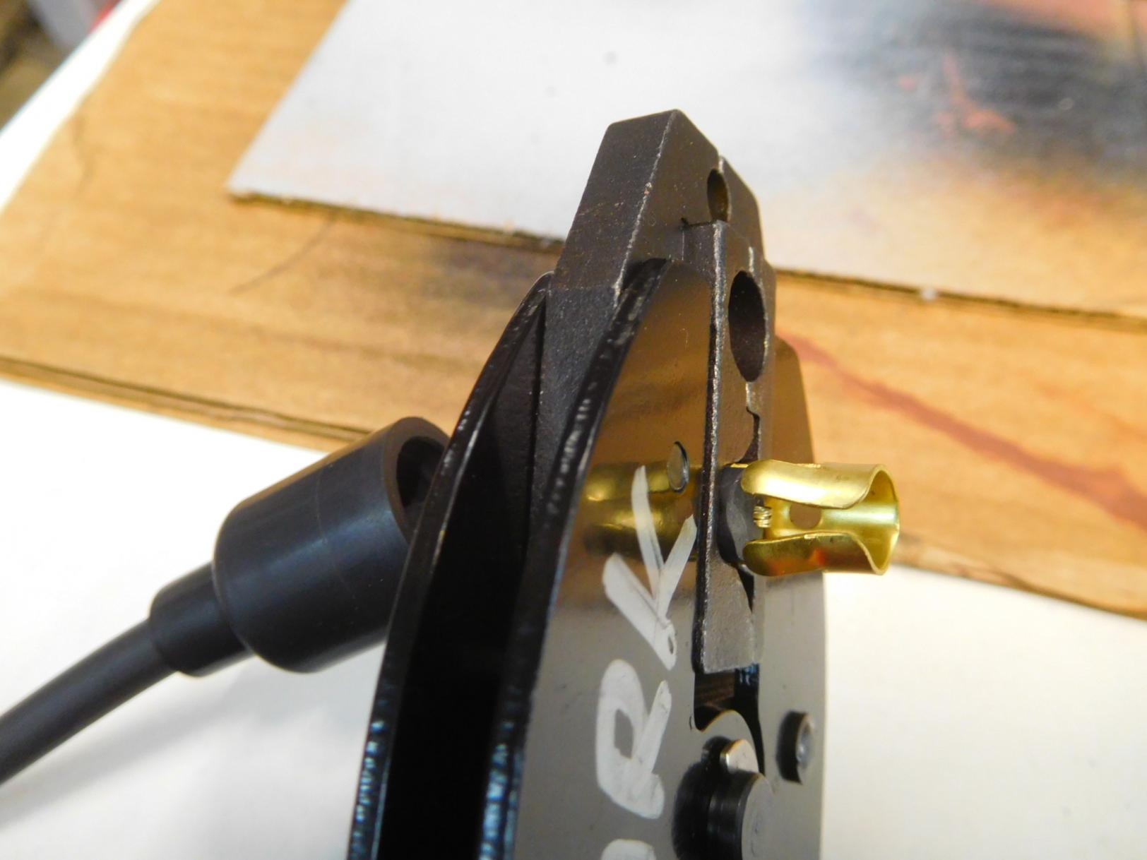

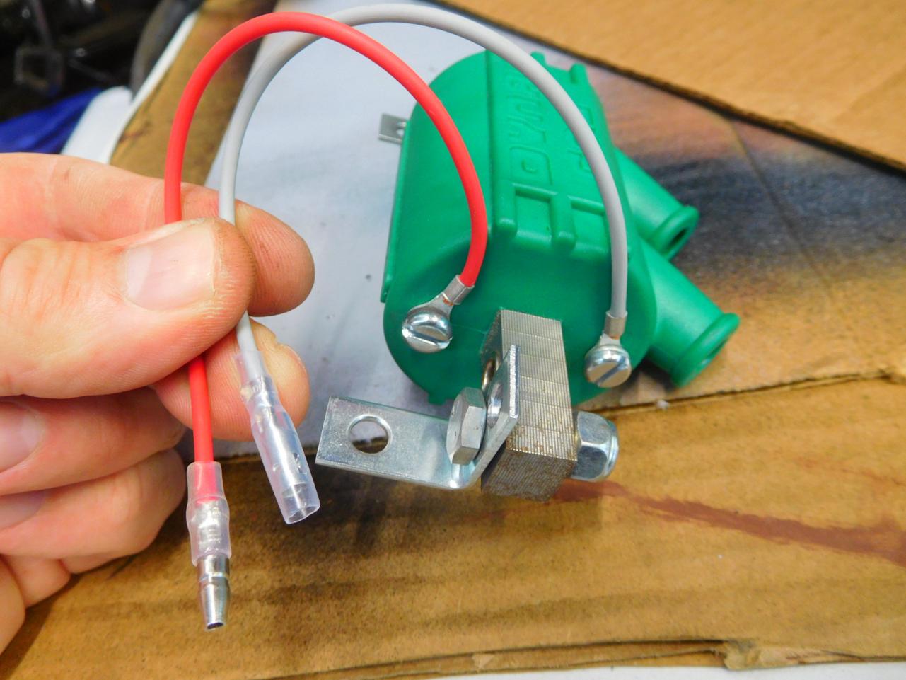

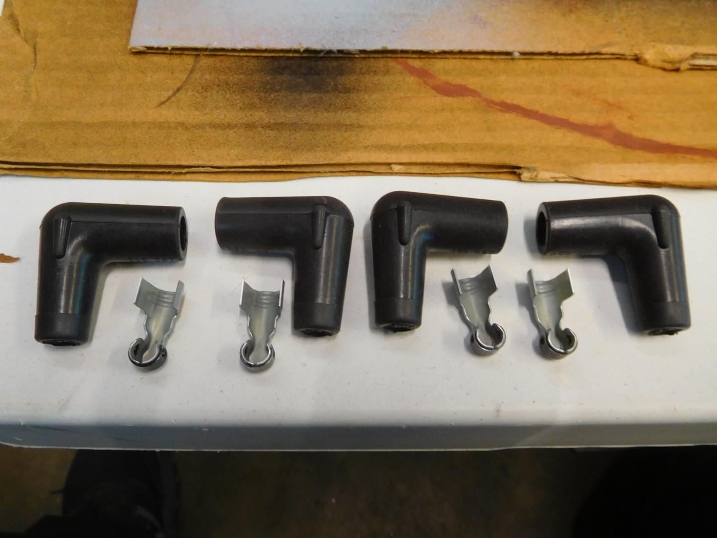

        • 1932
        #63
        Coils ready for install.

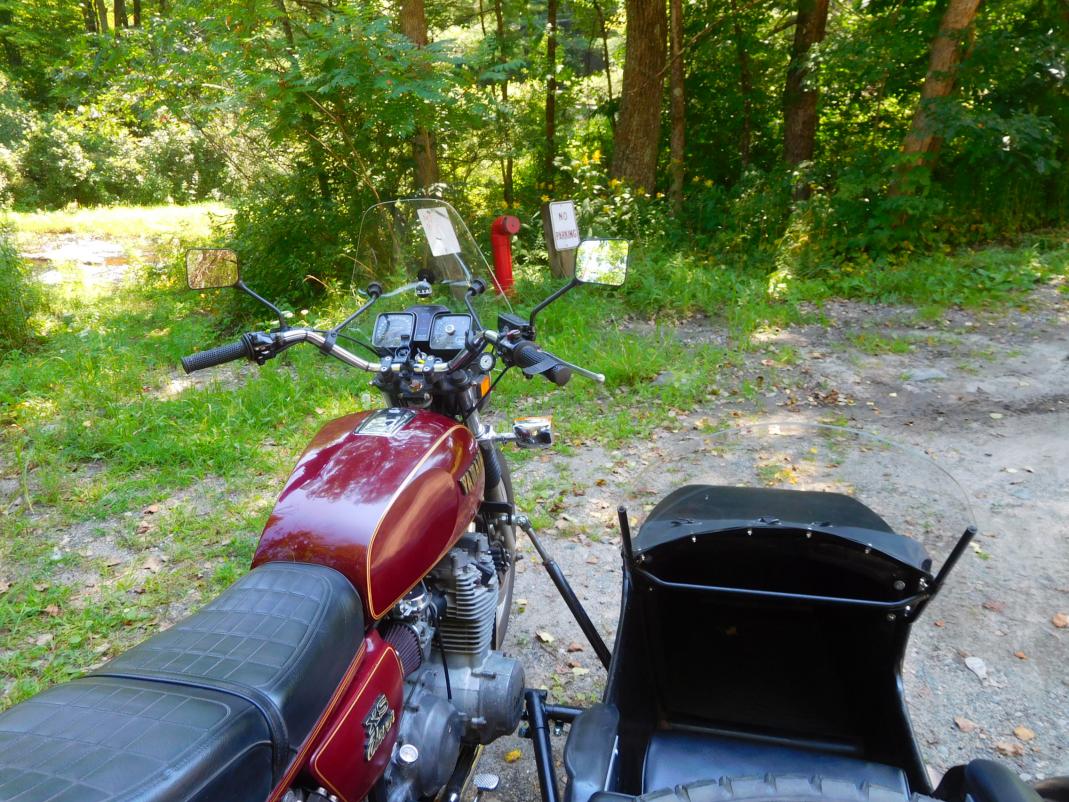

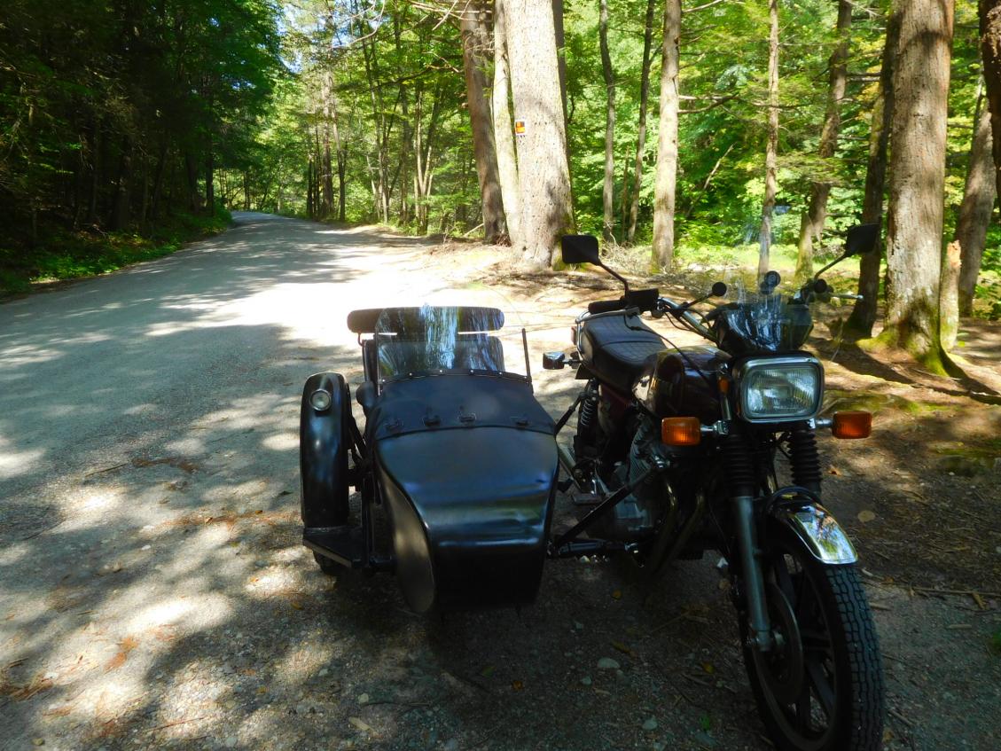

            • 1932
            #65
            On the road in Western Connecticut. Click image for larger version

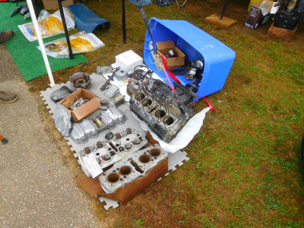

                        • 1932
                        #71
                        Some more Rice-O-Rama pictures...

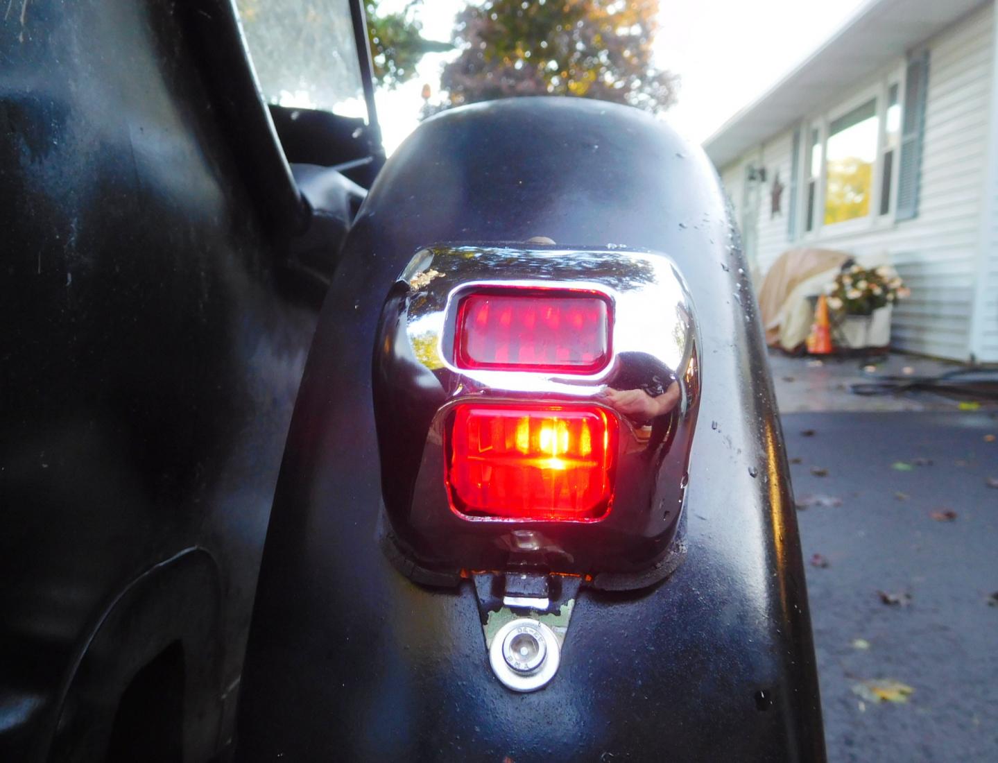

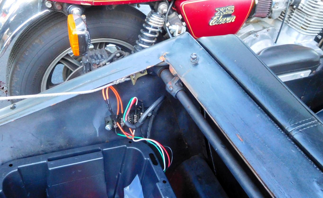

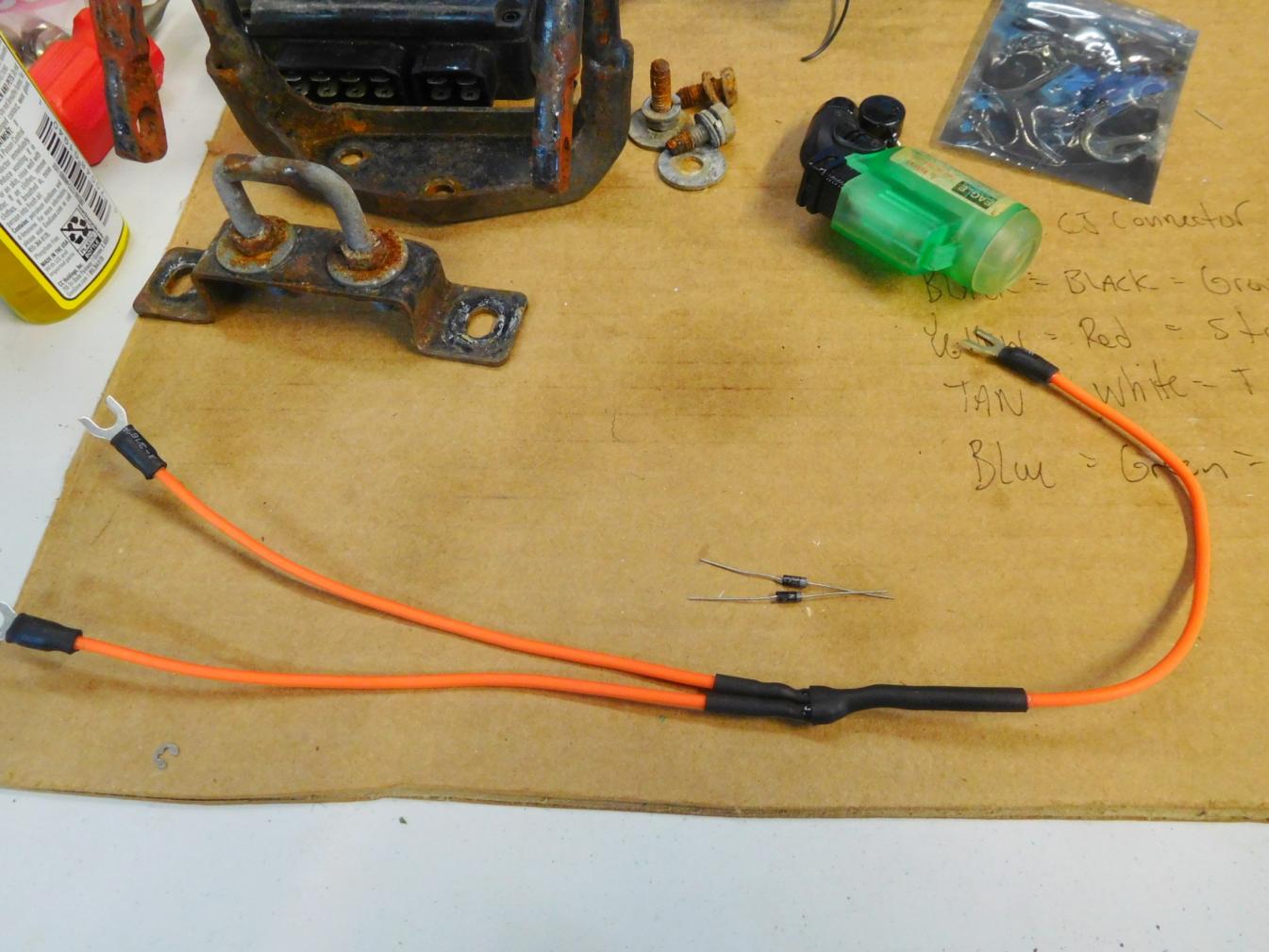

                          • 1932

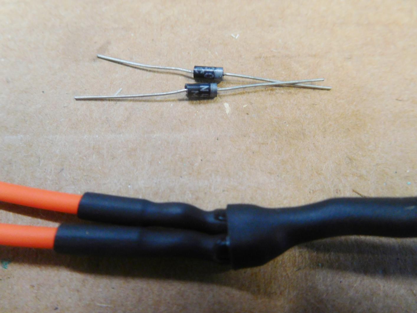

                          #72
                          I only have a brake light and tail light on my sidecar. How can you add right hand turn signal when you only have one 1157 bulb with two filaments? You add two 1N4401 diodes with the cathodes (-) tied together. The 2 anodes (+) will receive signal from each source. One from the stop light and one from the right turn signal. On my bike the stop light is in red and the right signal is in green. I wired the adapter in orange. Now I have turn signal in my sidecar tail light but it can always be over ridden by the stop light.
