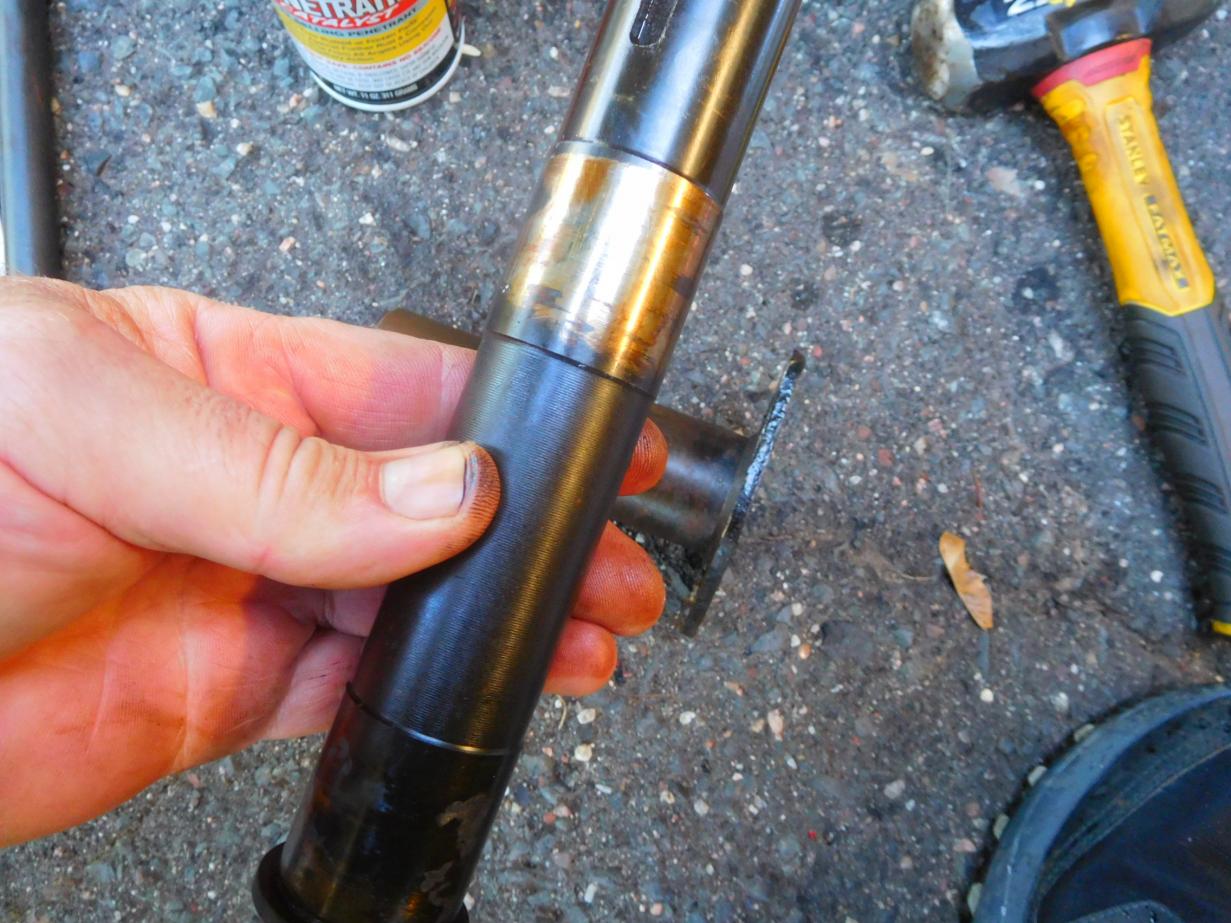

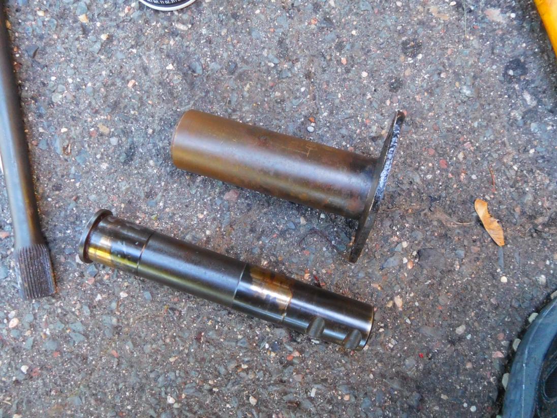

          #49

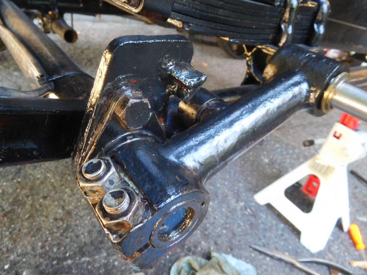

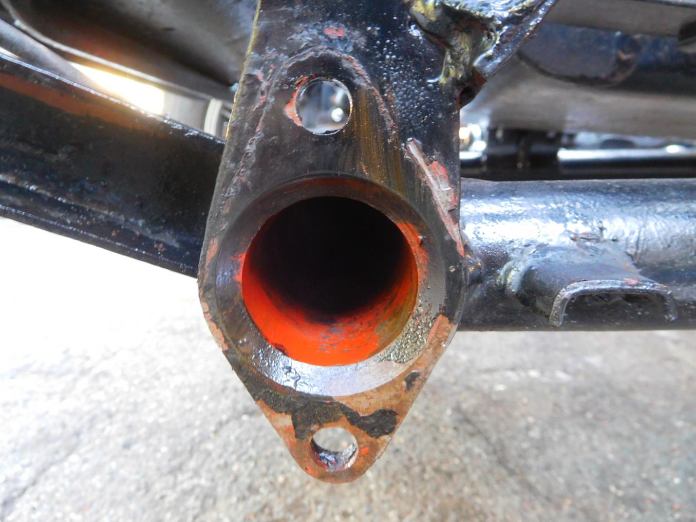

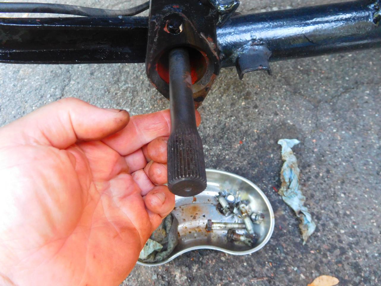

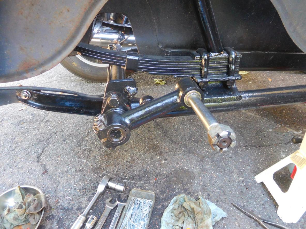

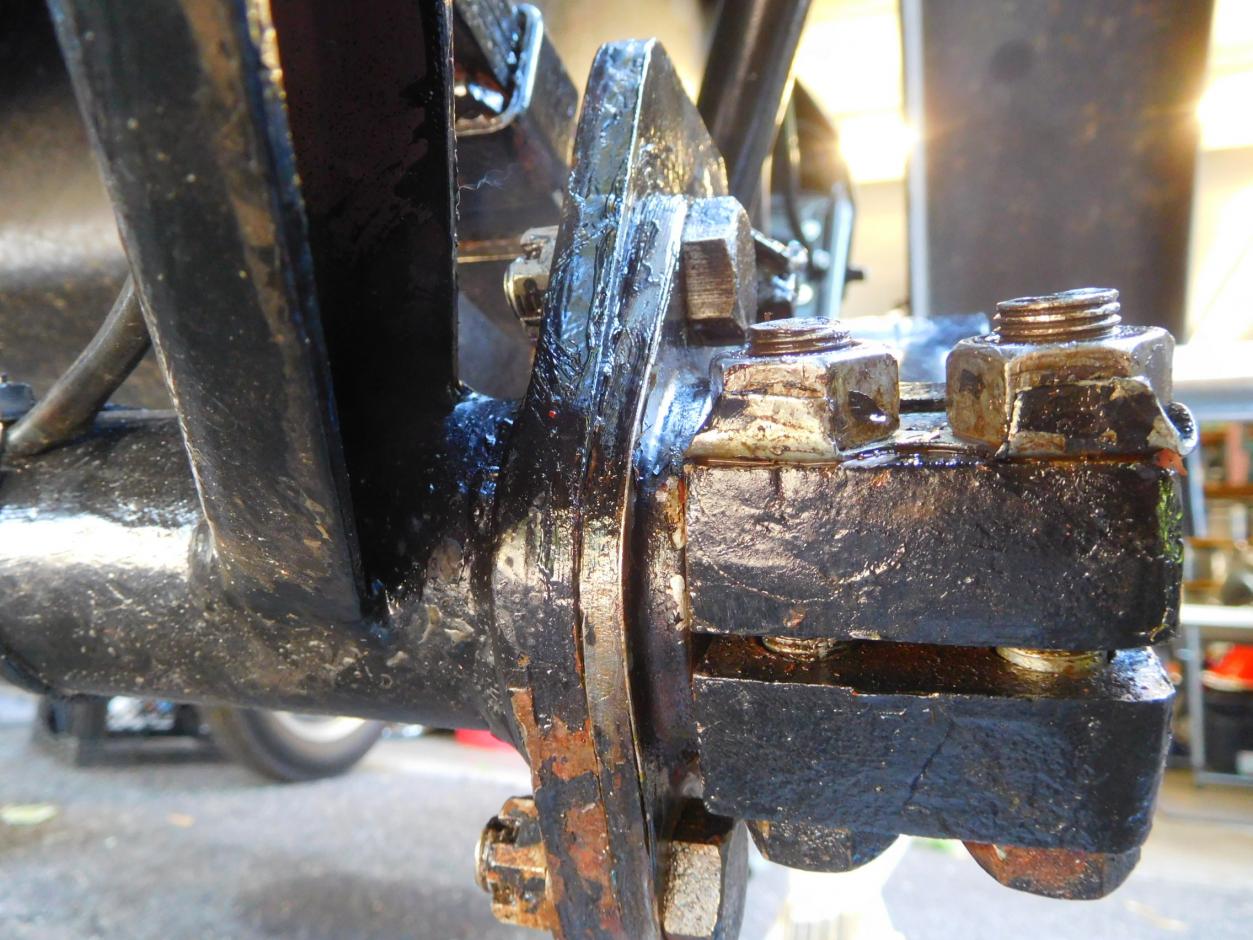

          Some sidecar suspension maintenance. This Chang Jiang unit does not have a swingarm or shocks. Its a torsion bar set-up like an old VW Beetle. It's a BMW military copy. The rod is spring steel and it twists to give you a few inches of travel. Had to use the heavy duty puller to get it apart and lube the sleeve bearing. There was a little wear but it works fine with very little play.

            #50
            Repaired. I also did a valve adjustment today.

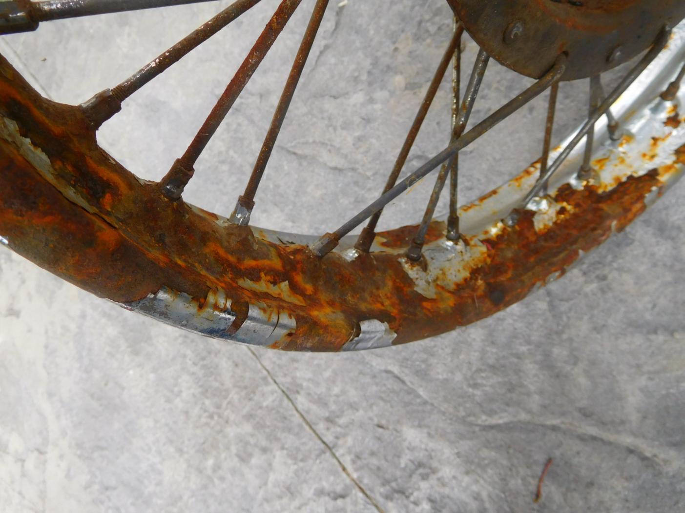

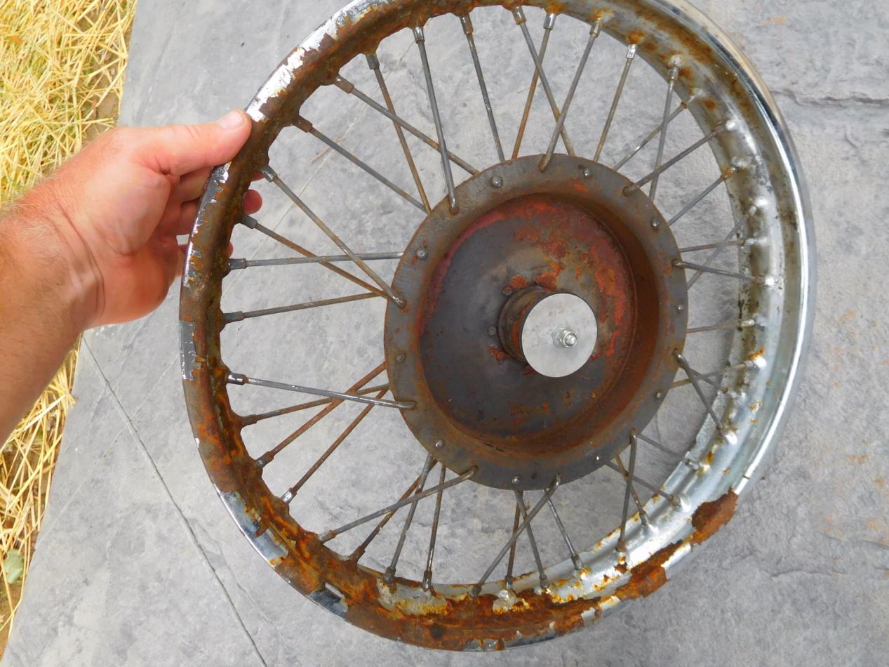

                #52

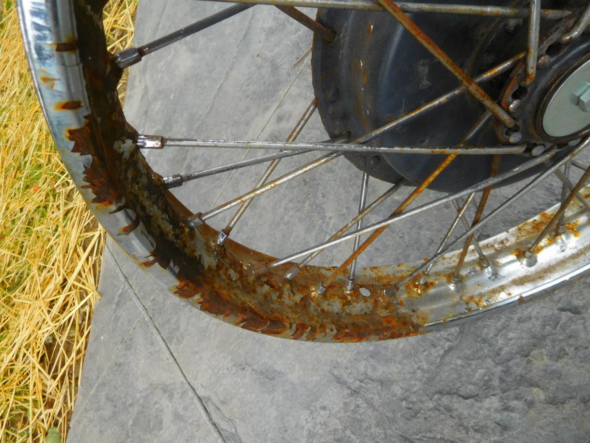

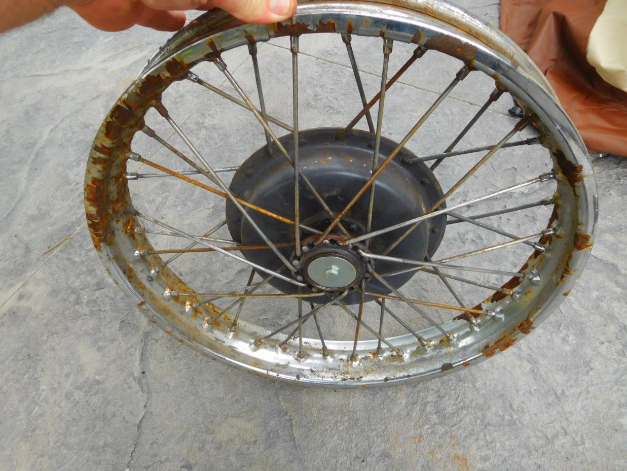

                Working on 19" spare sidecar rim. Pretty bad.

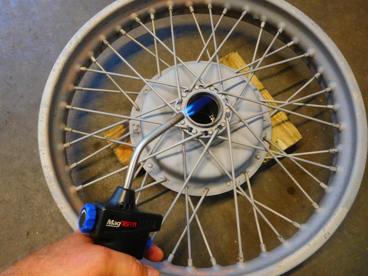

                  #53

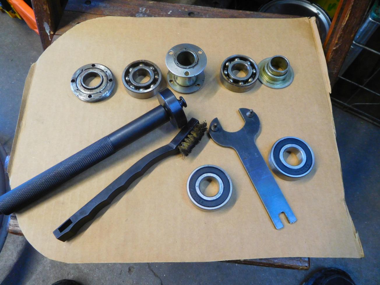

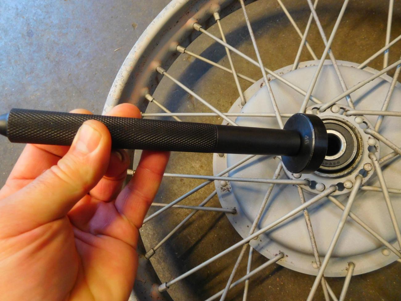

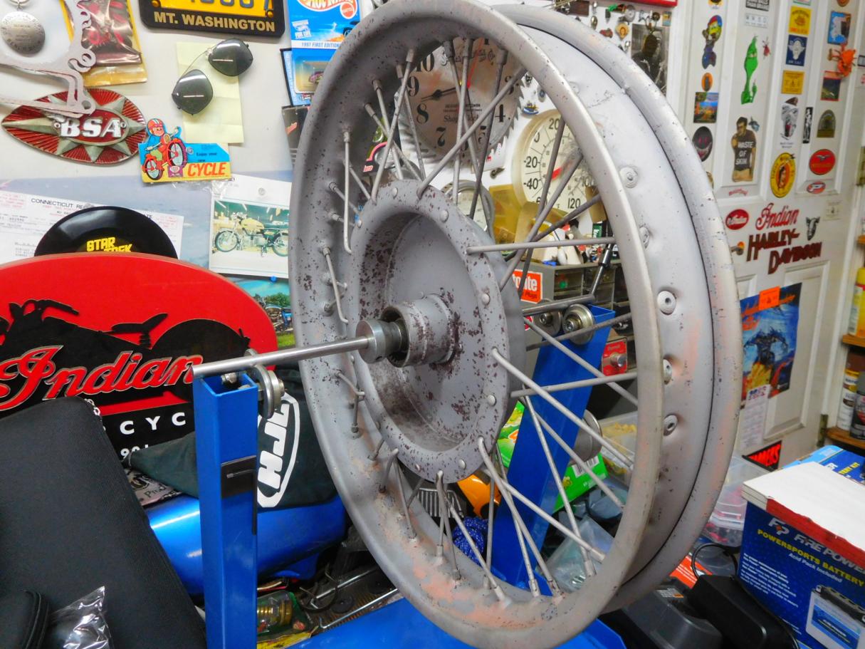

                  Remove bearing pack and sand blast. Install new bearing pack and true rim. Always heat the bearing seat evenly. Freeze the bearing and use a tool such as a socket or bearing installer to drive it home without damage.

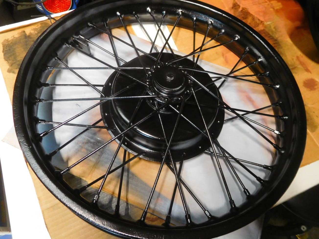

                              #59

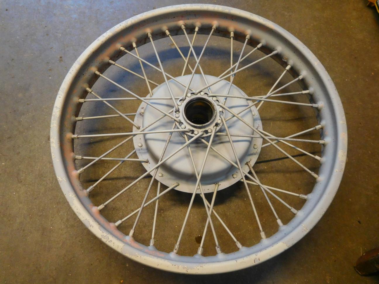

                              Restored spare wheel.

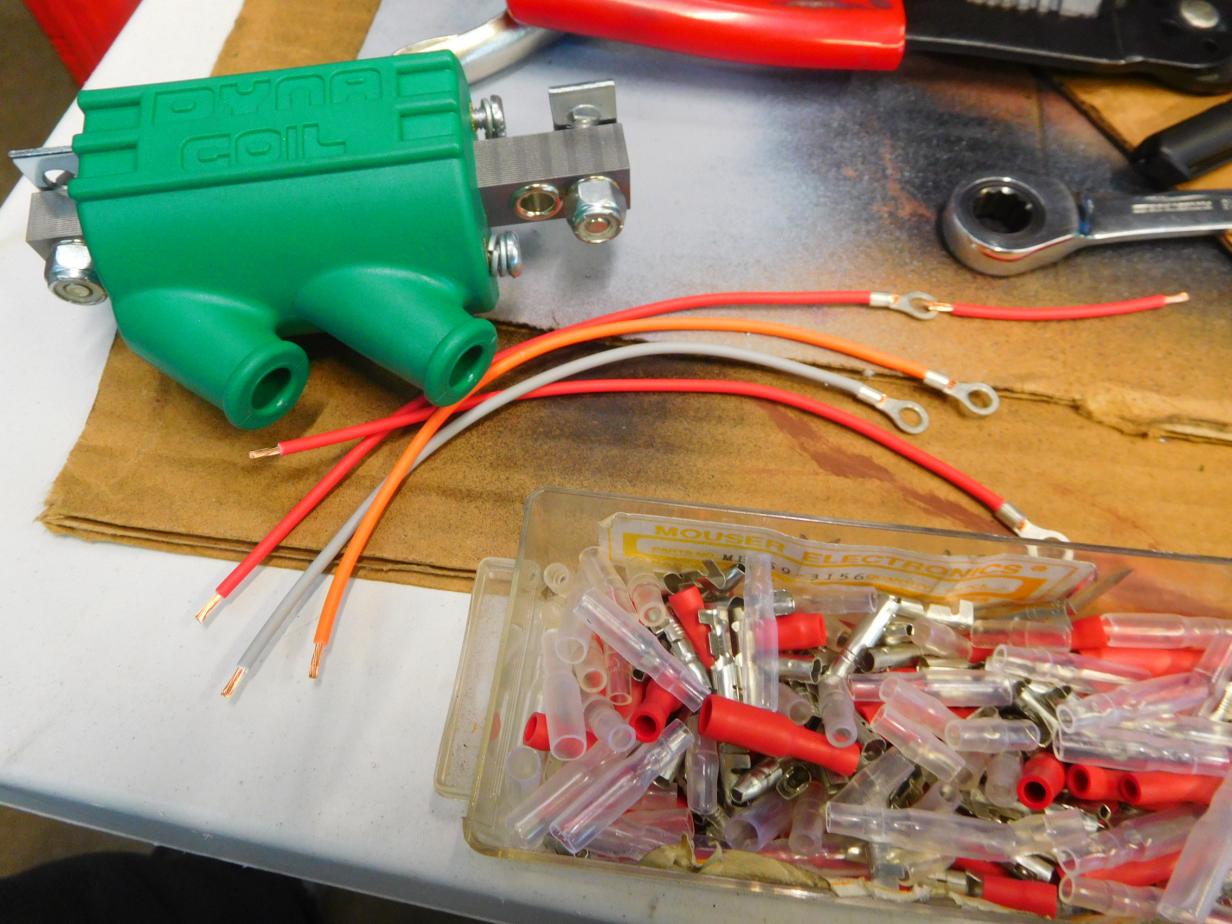

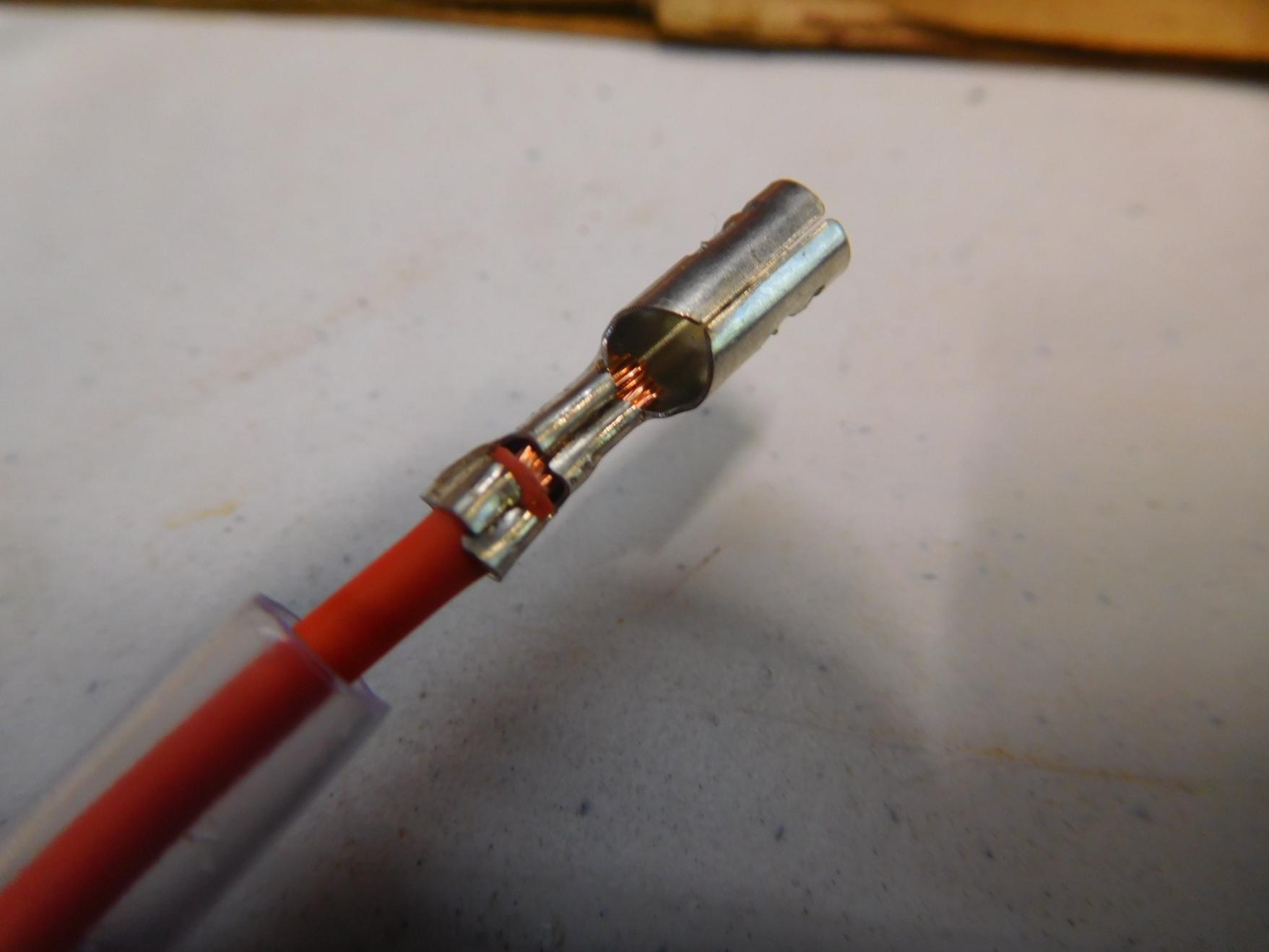

                                #60

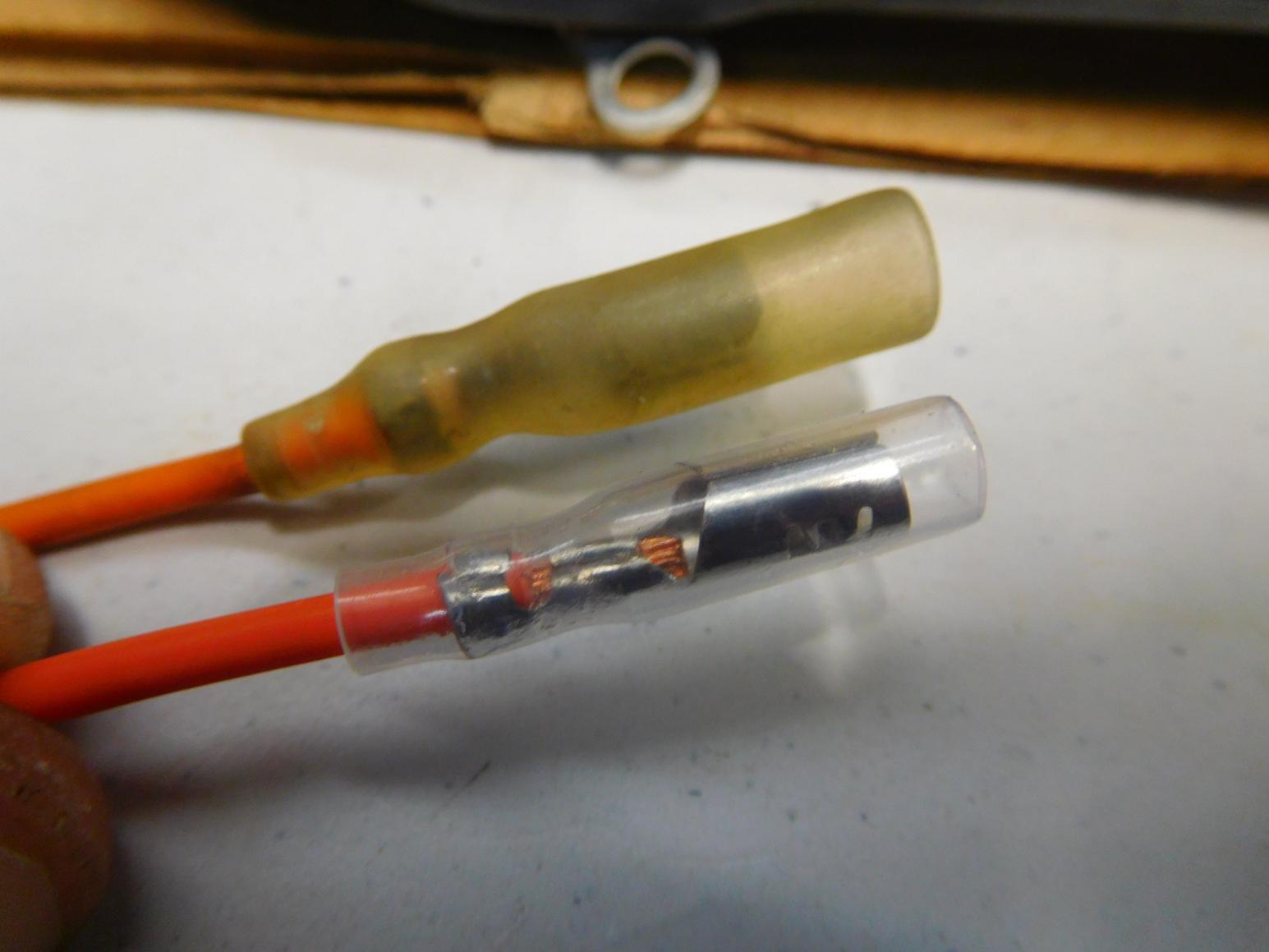

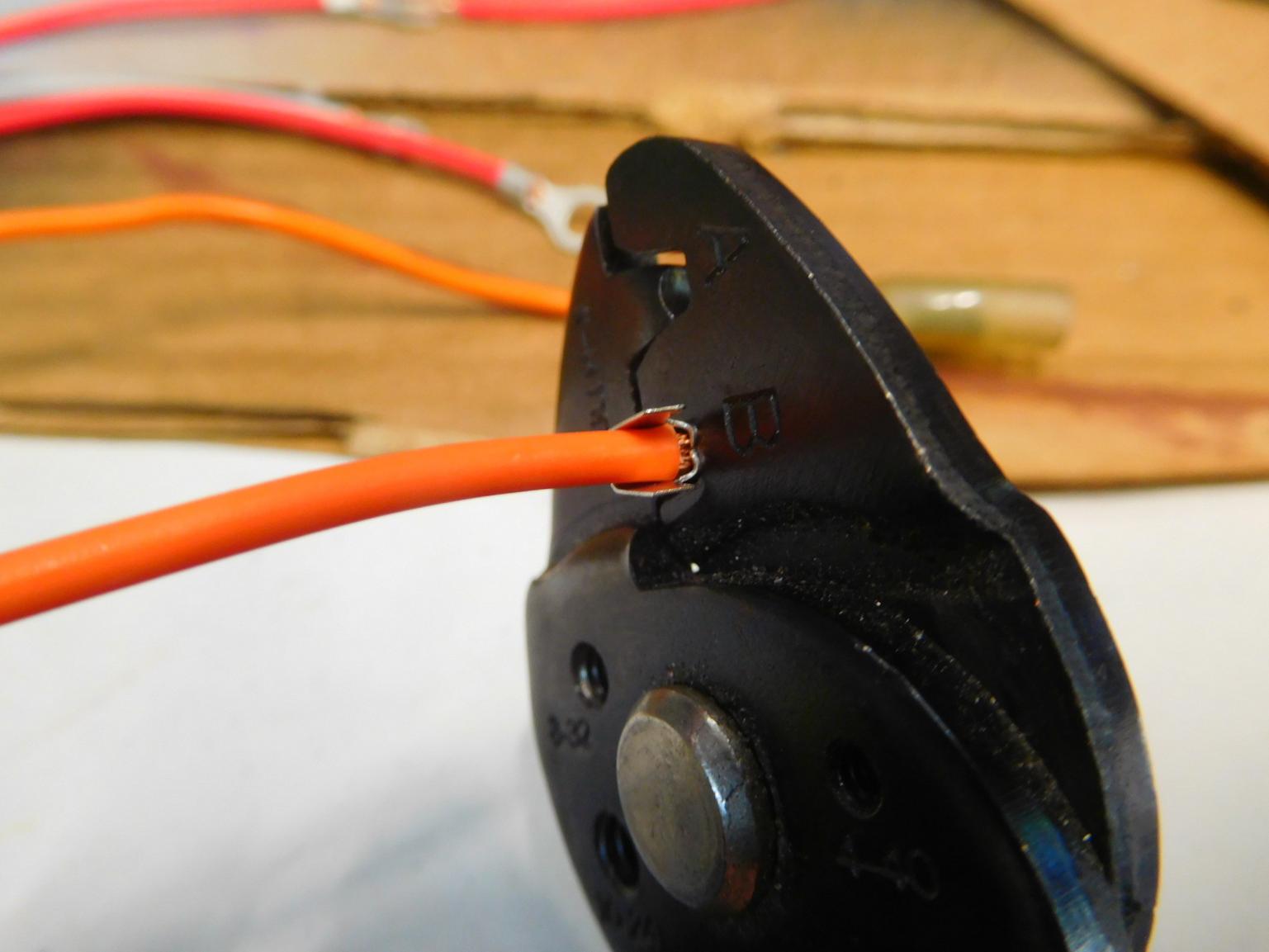

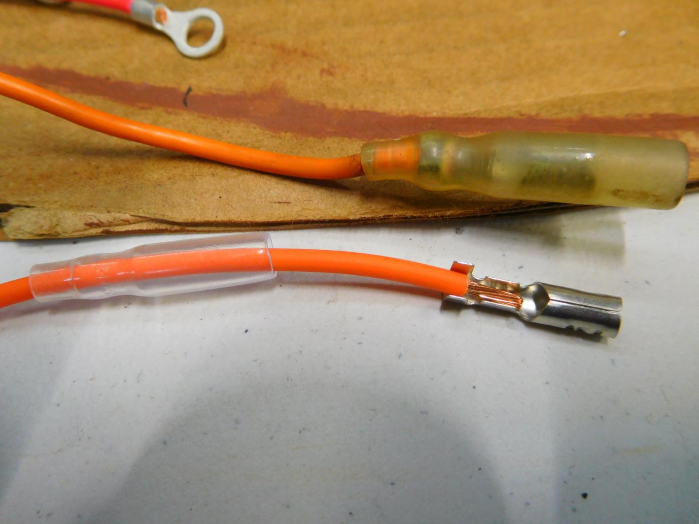

                                New Dyna coils. New primary wires crimped.
