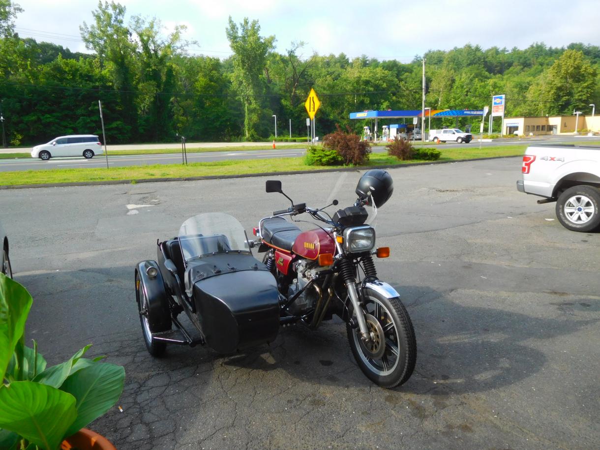

78 Sidecar Project

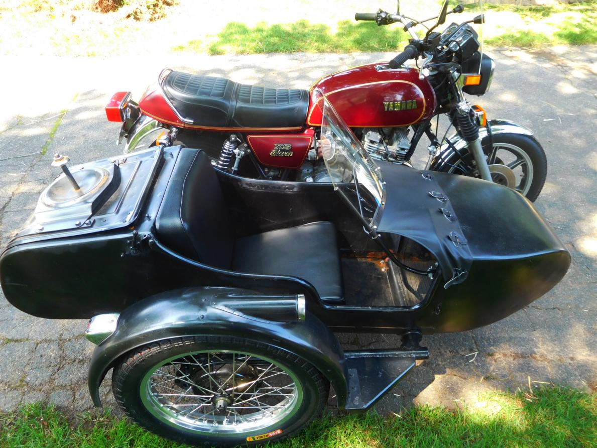

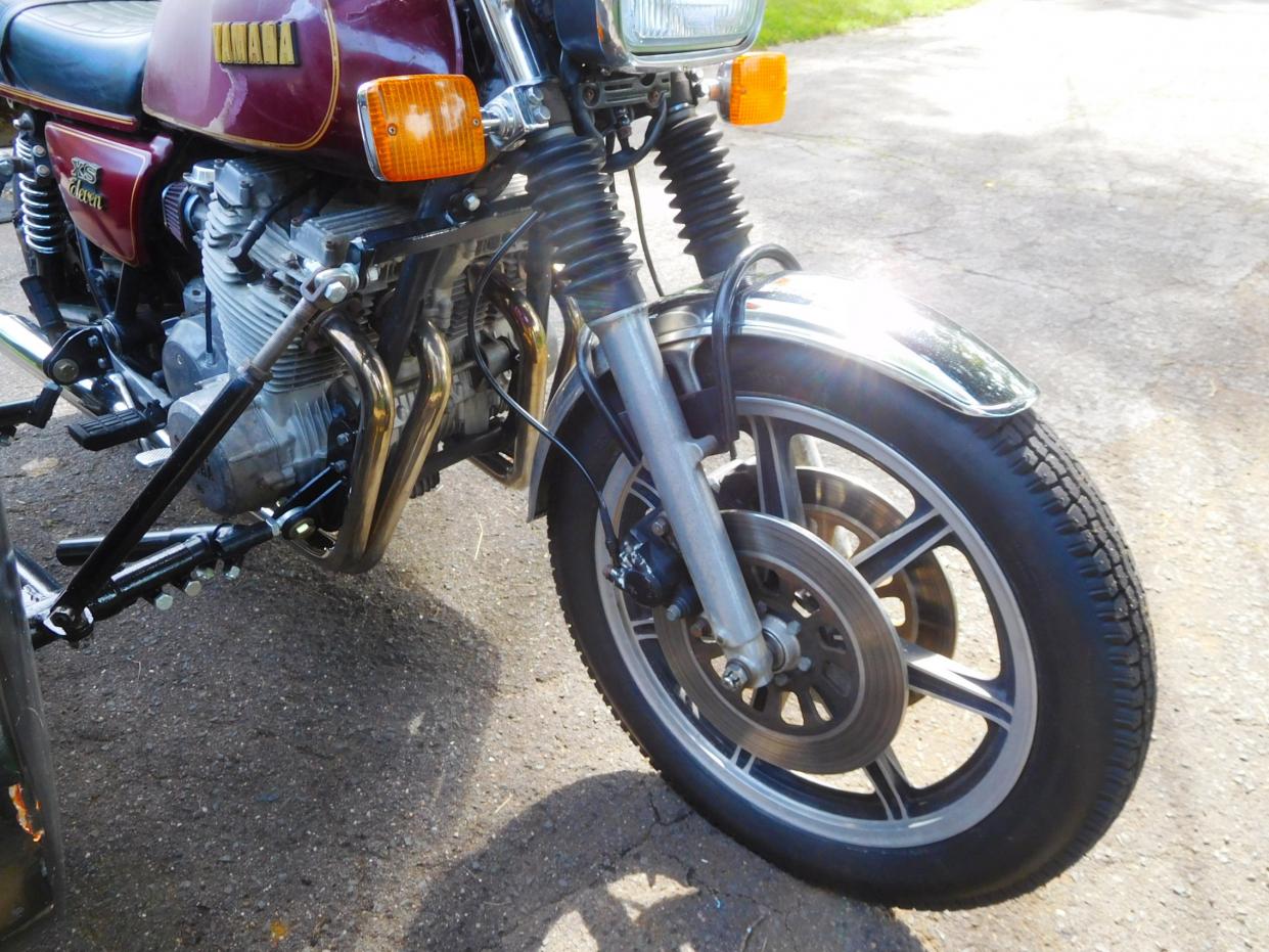

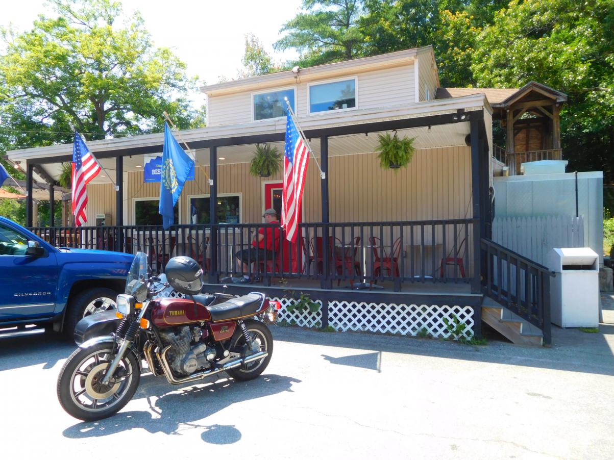

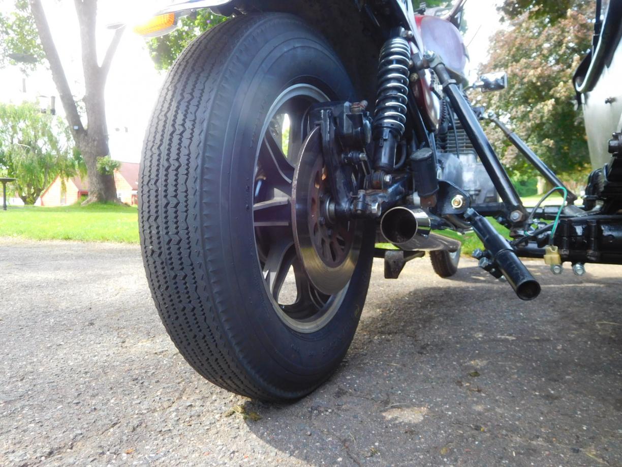

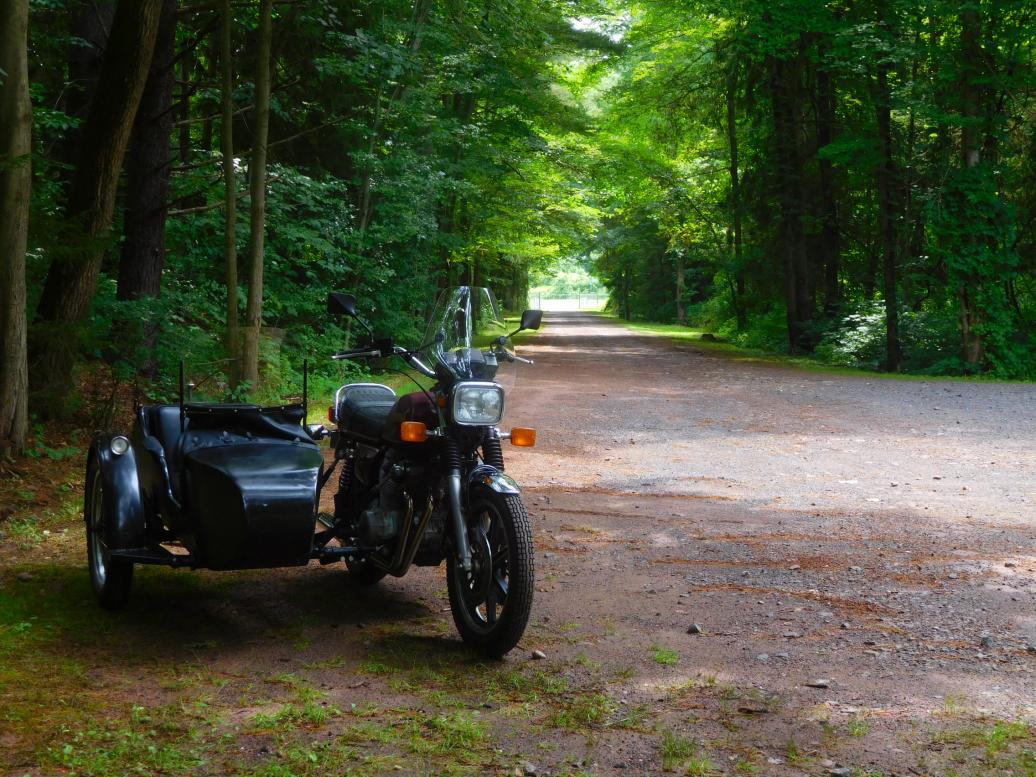

    Installed an Avon Triple Duty sidecar tire on the front and a car tire on the rear. Really sticks to the road.
ID:	874411 Click image for larger version

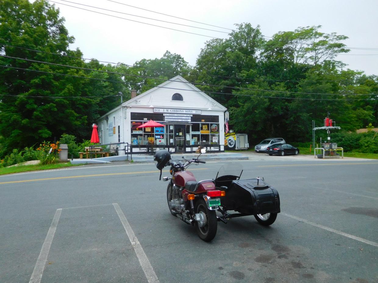

      A few more pictures from the road.
ID:	874414 Click image for larger version
ID:	874415 Click image for larger version
ID:	874416 Click image for larger version

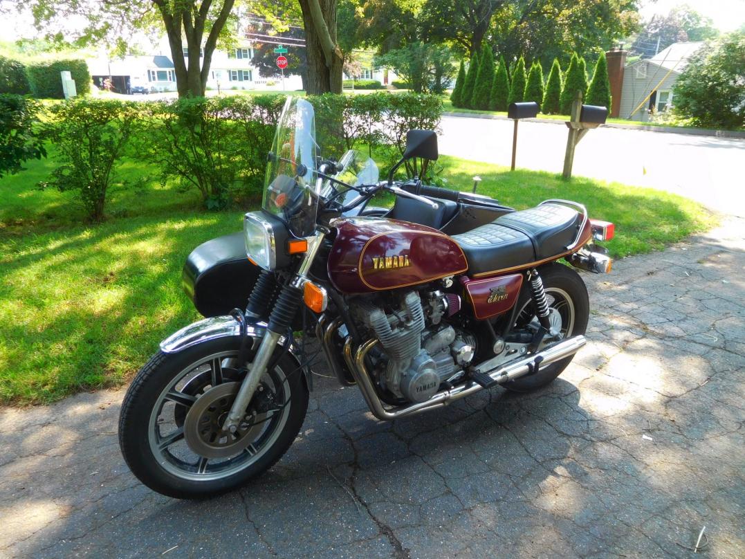

              Thanks Ranger. Next step is to install a nice gas tank I picked up at the AMCA swap meet in Oley PA back in 2019. Real nice original paint. I will be using the NOS tank badges I bought from you off of eBay. I am going to clean the inside first with apple cider vinegar and then neutralize the acid with a baking soda solution.

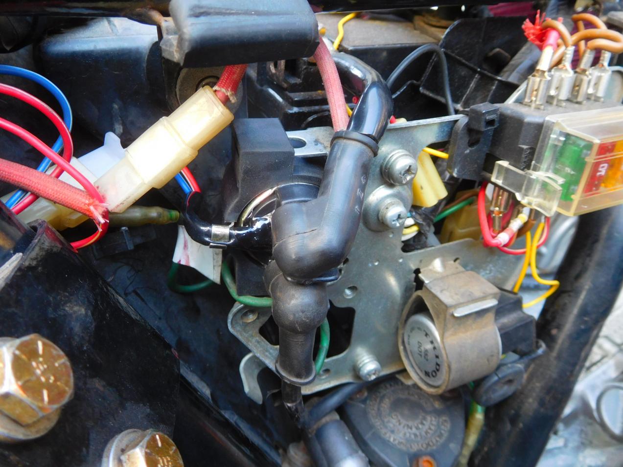

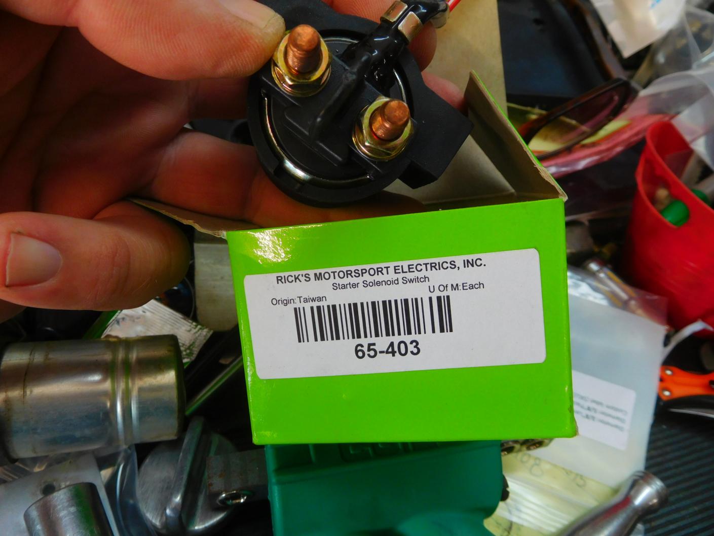

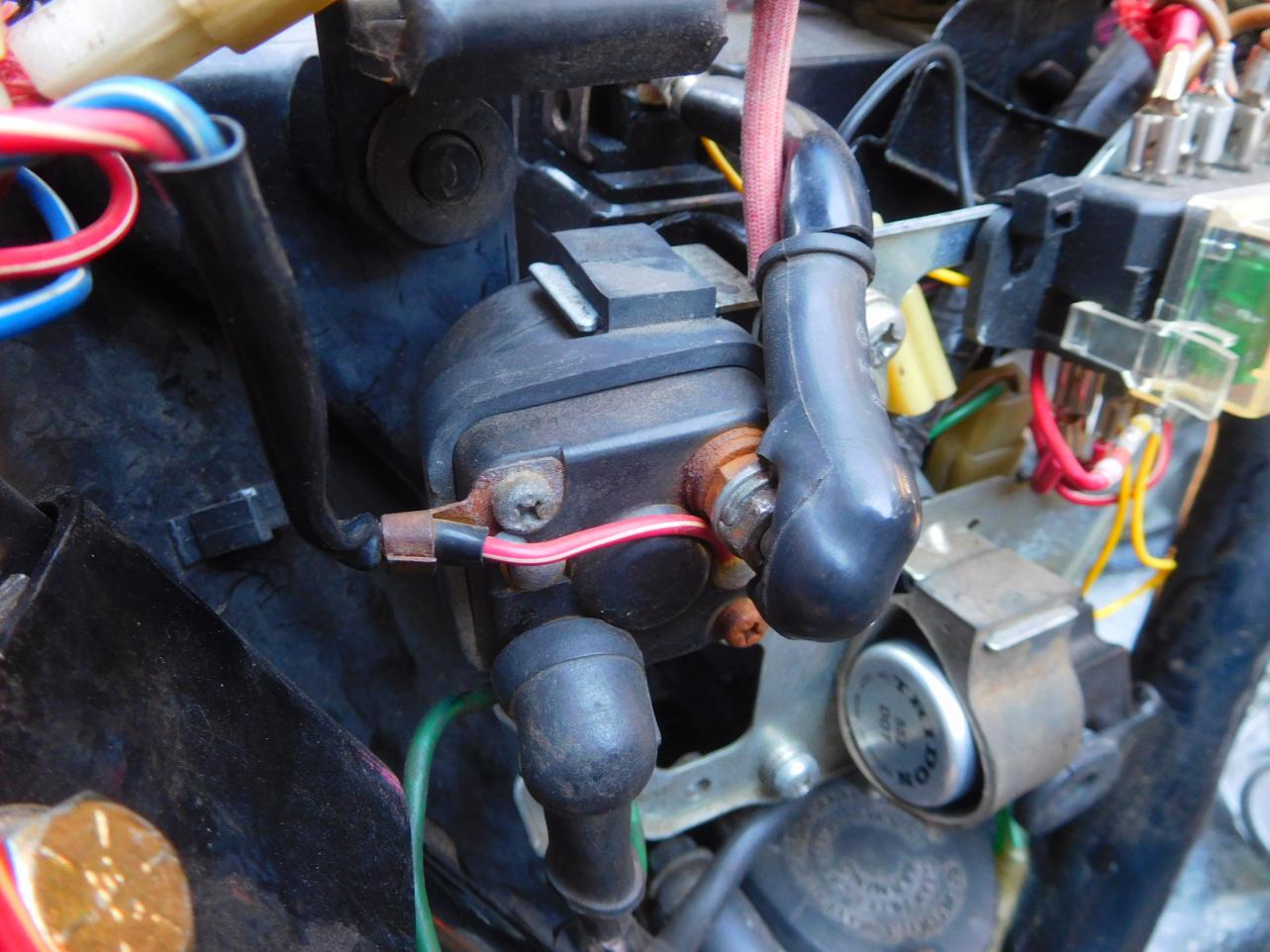

                New Rick's starter solenoid.
ID:	874496 Click image for larger version
ID:	874497 Click image for larger version

                  Cleaned the "good" tank with apple cider vinegar. Soaked for 24 hours. Lots of crap came out. Neutralized acid with baking soda and water (base). Made sure it was bone dry inside. No flash rust. New petcocks & new NOS emblems from Rucksack Grunt.
ID:	874689 Click image for larger version

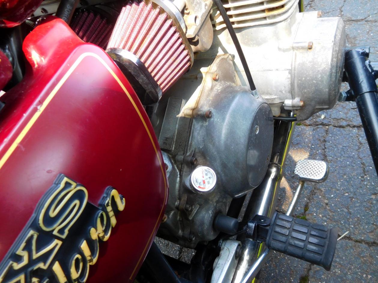

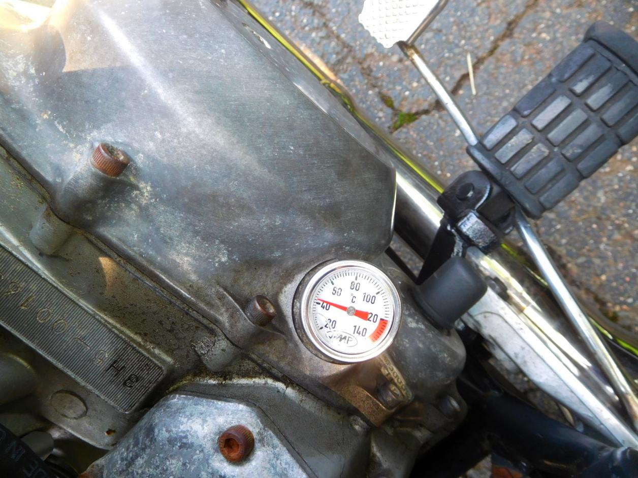

                    New oil temp gauge. It's in C°.
ID:	874692 Click image for larger version

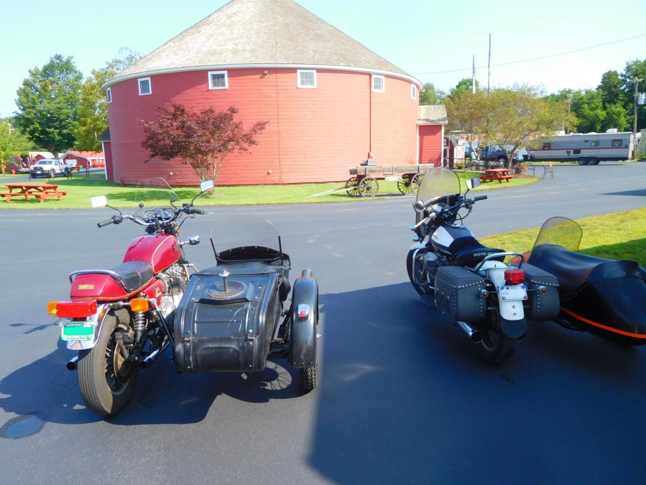

                            More sidecar adventures. My buddy Greg's 80 Guzzi Police bike with Eagle sidecar.

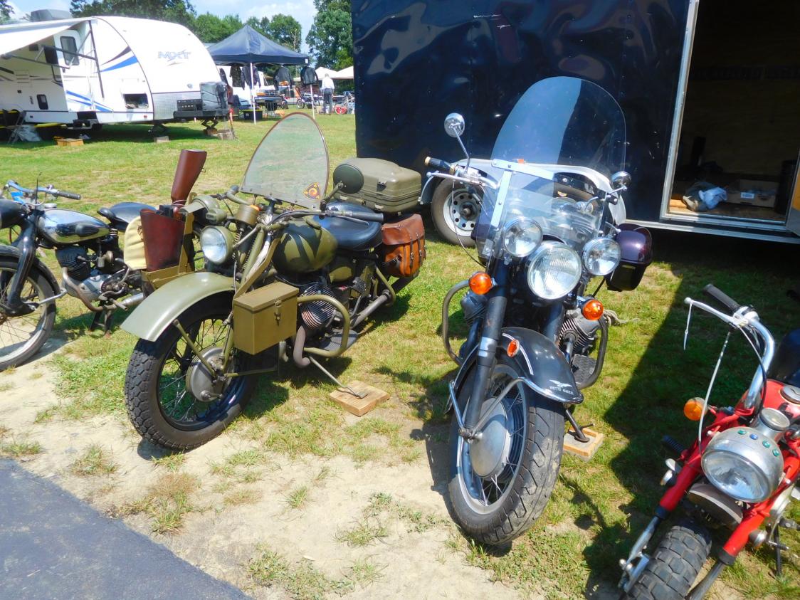

                              #44
