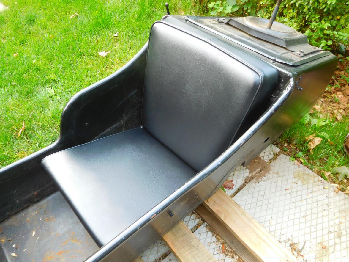

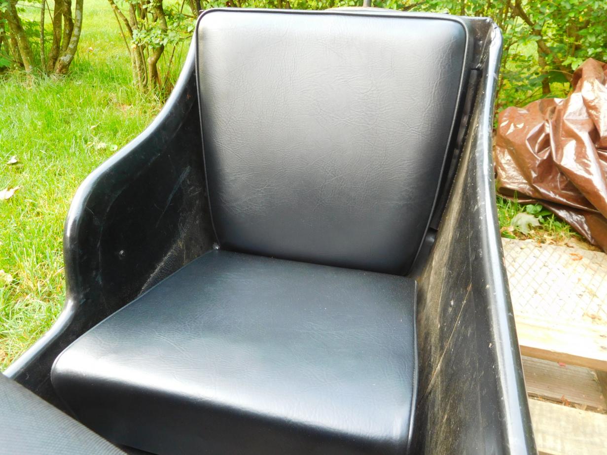

        Completed seat

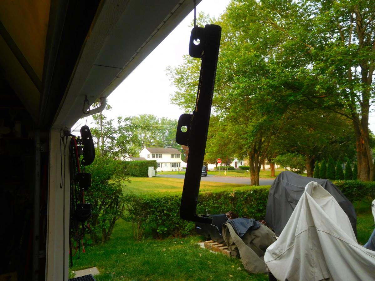

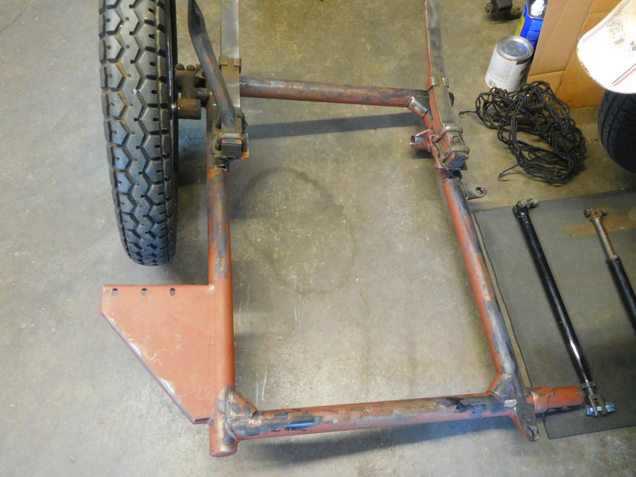

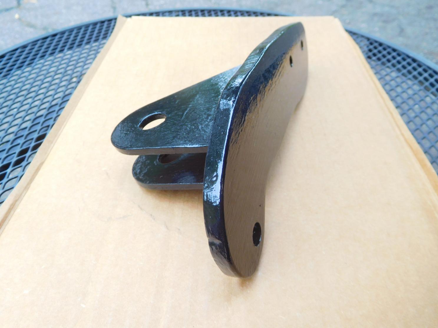

          Painting mount brackets and sidecar frame: Click image for larger version
ID:	873931 Click image for larger version
ID:	873932 Click image for larger version

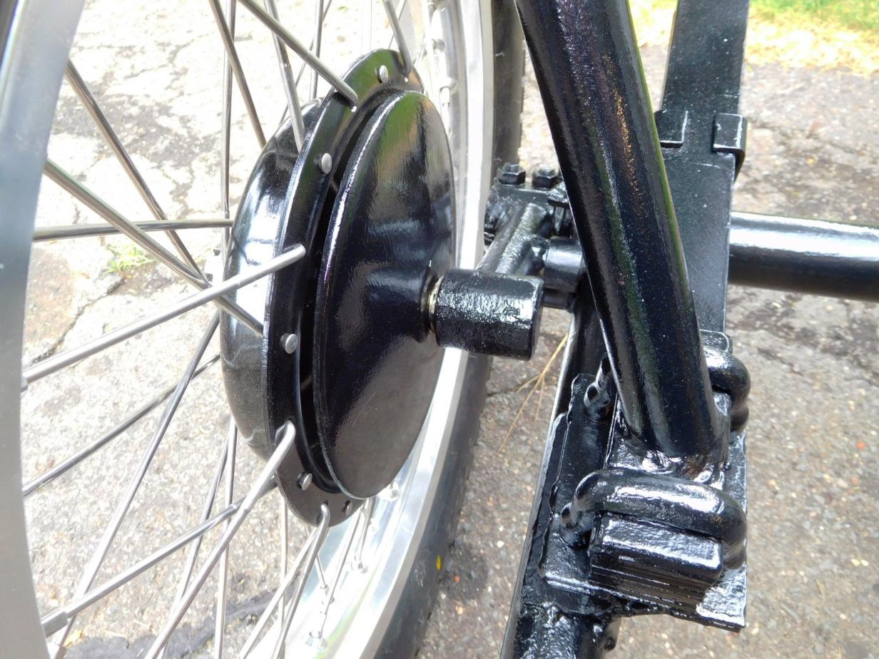

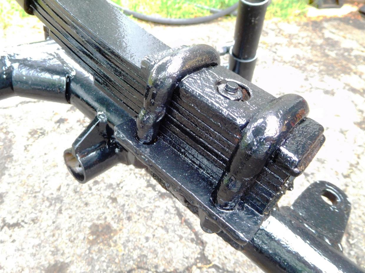

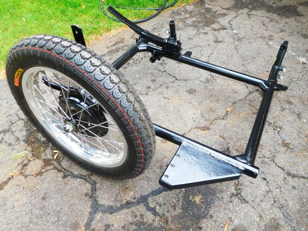

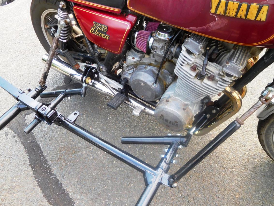

            Sidecar frame fully restored.
ID:	874071 Click image for larger version
ID:	874072 Click image for larger version
ID:	874073 Click image for larger version
ID:	874074 Click image for larger version

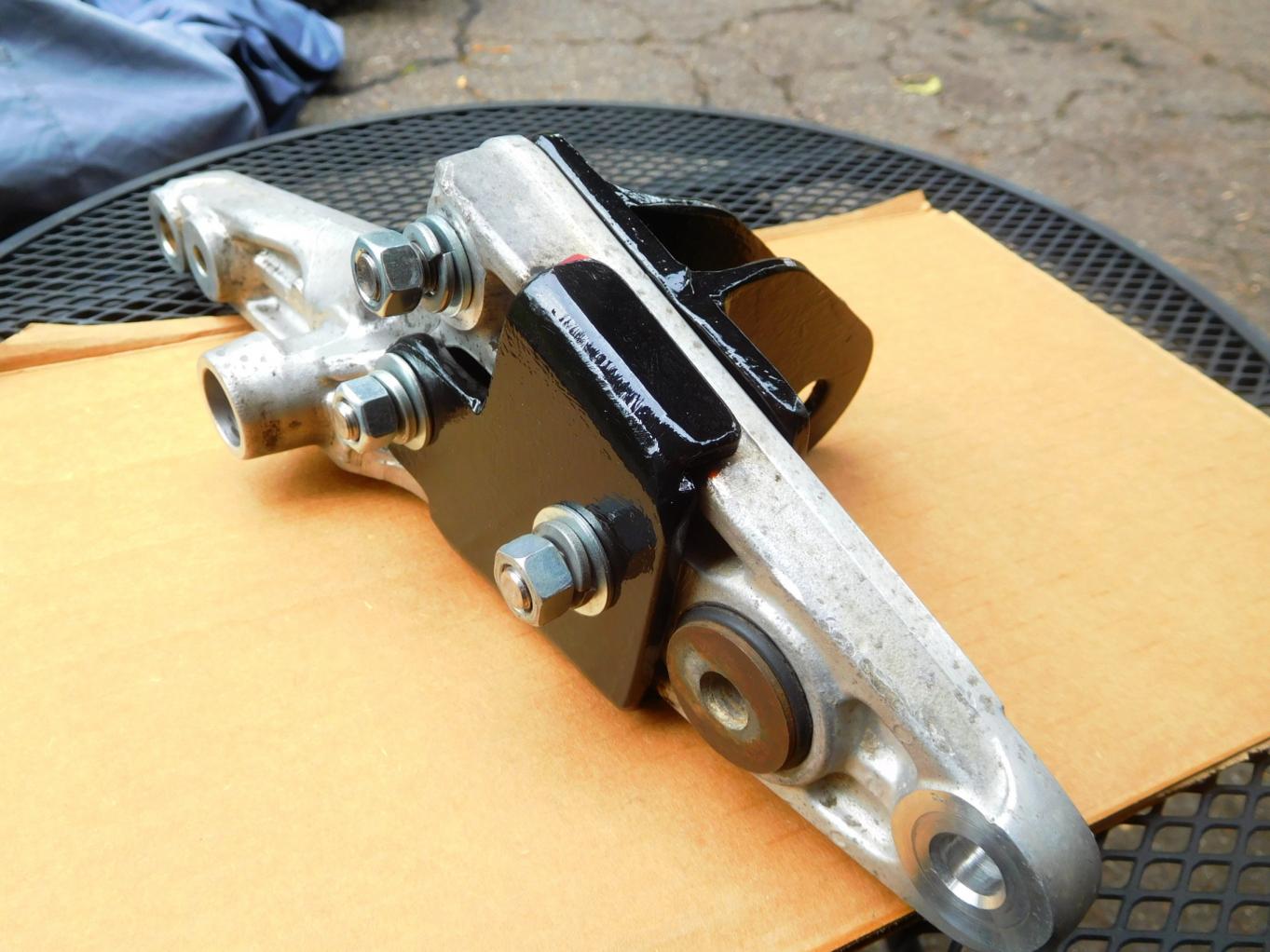

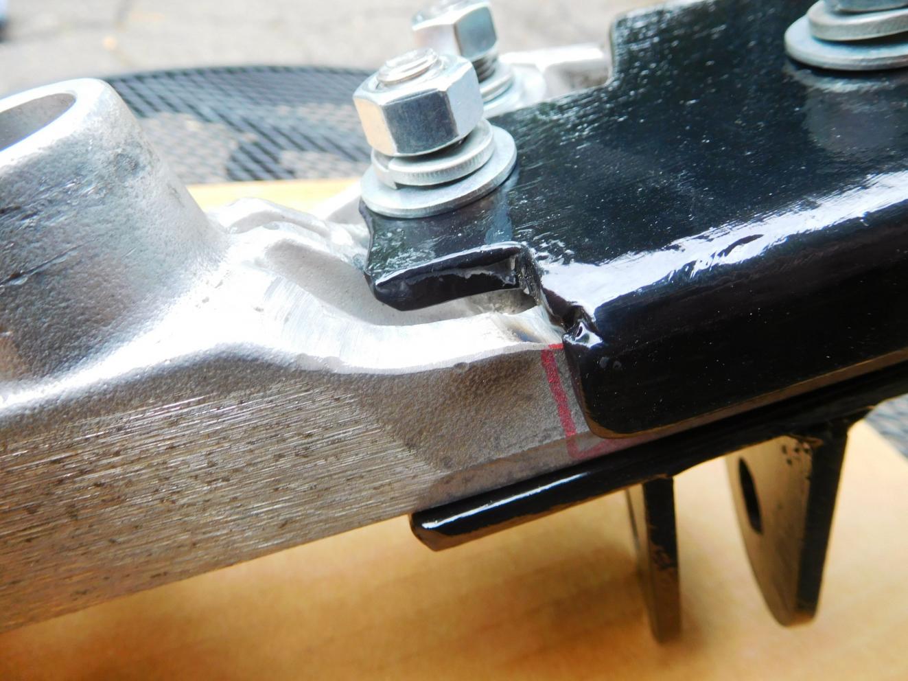

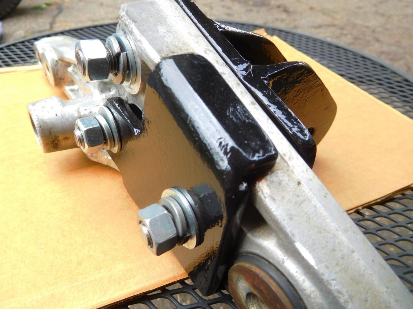

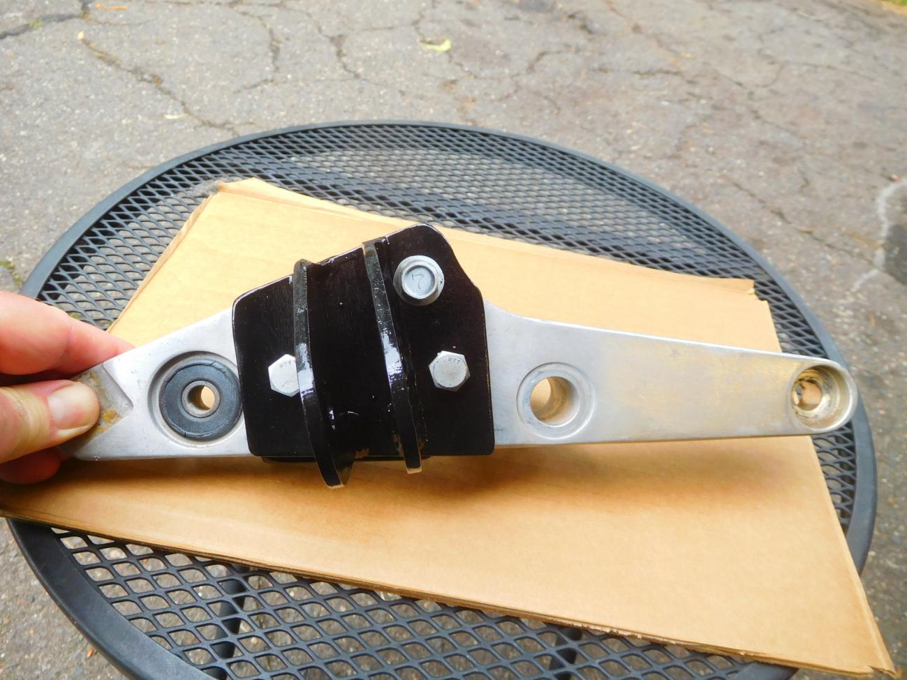

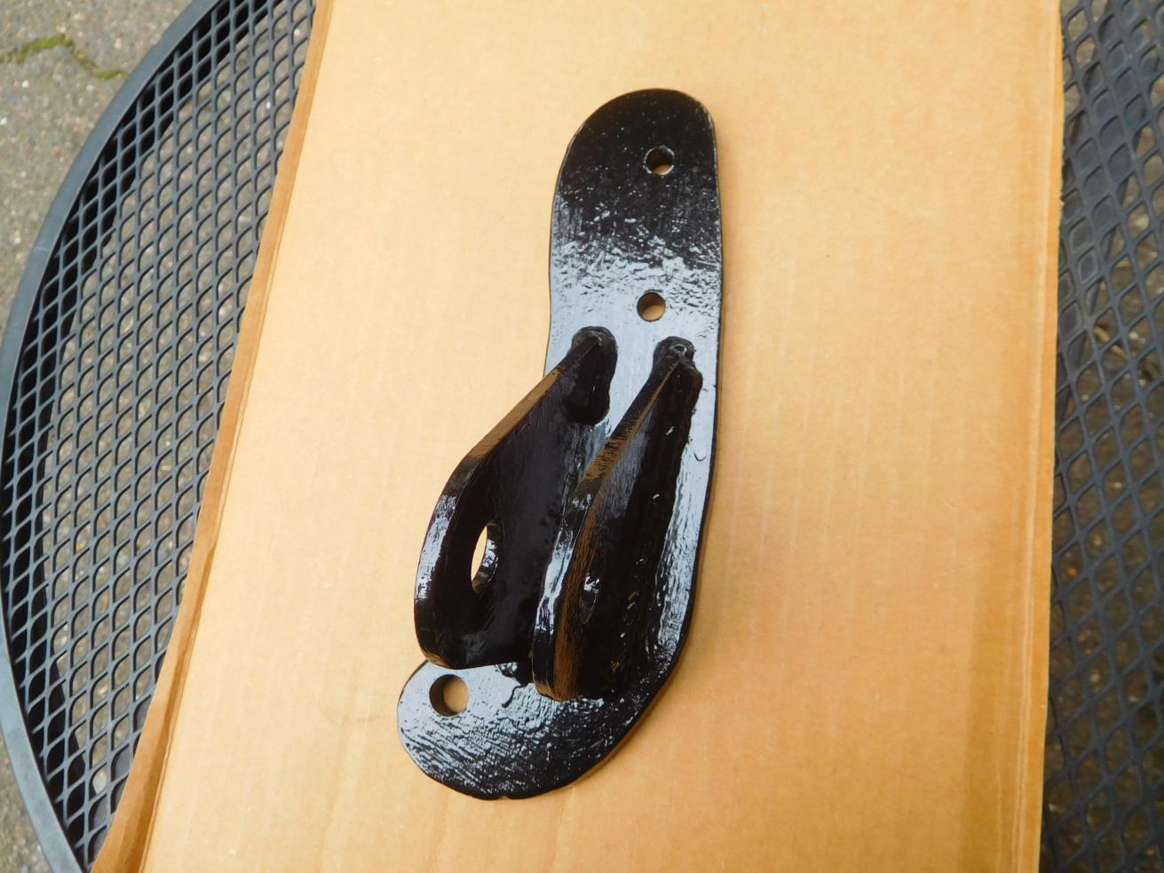

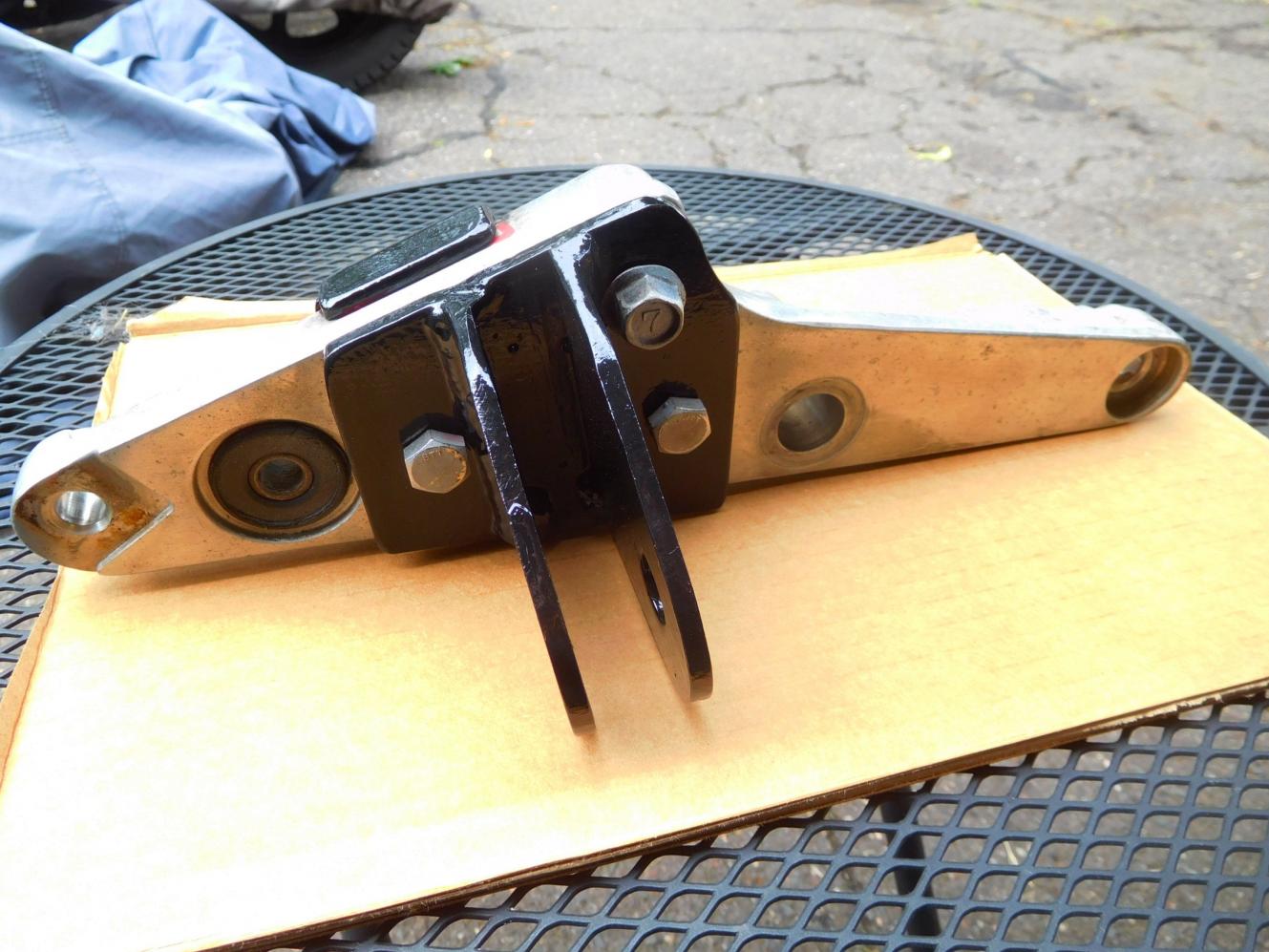

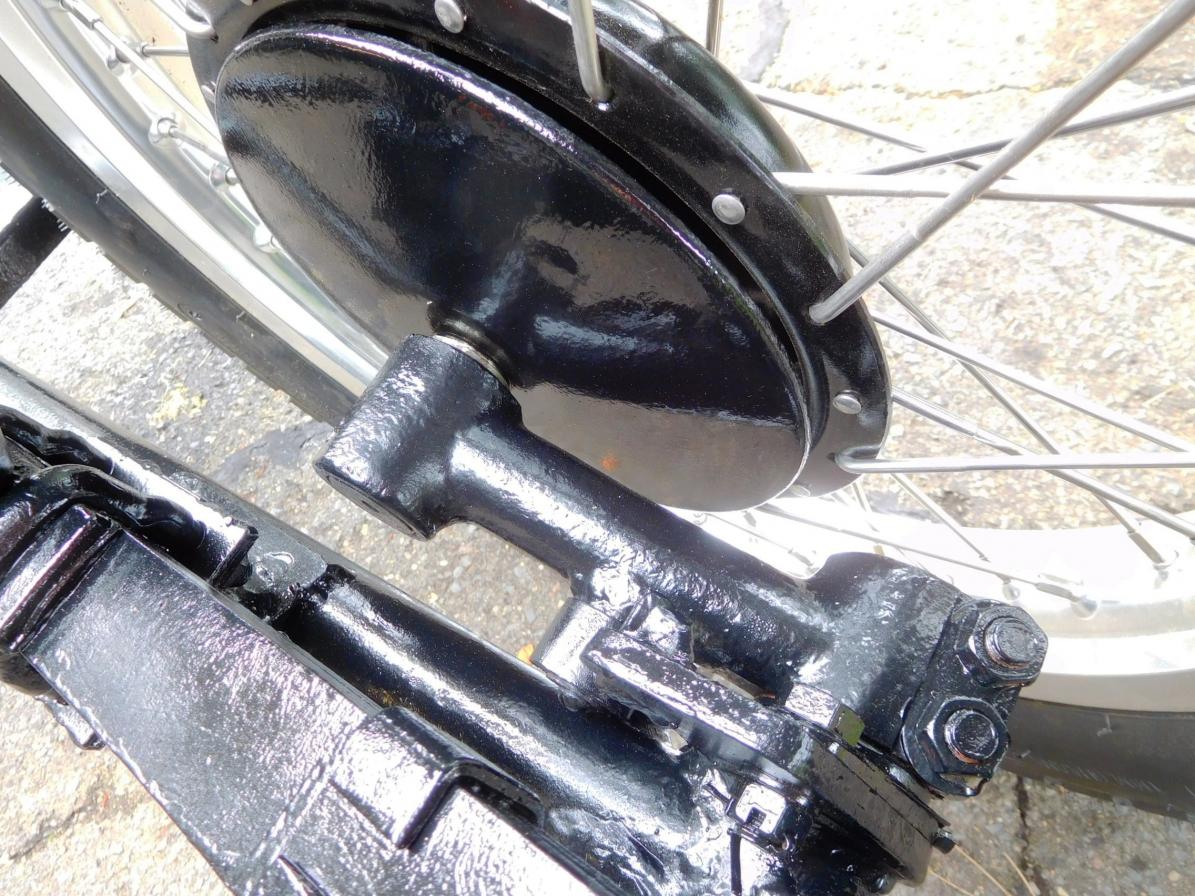

              Rear mount. Fabricated a clam shell design that won't rotate under extreme pressure.
ID:	874077 Click image for larger version
ID:	874078 Click image for larger version
ID:	874079 Click image for larger version
ID:	874080 Click image for larger version
                Front Mount. All parts painted with Rustoleum Professional. All brush painted to hold up to salted roads. This paint only comes in gallon pails. It's just like powder coating when cured.
ID:	874084 Click image for larger version
                  The paint. Very rust resistant.
                      My trailer frame and hitch need some attention, how long does that stuff take to set up? Seems I remember it taking MONTHS.

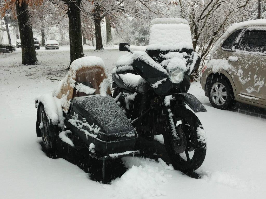

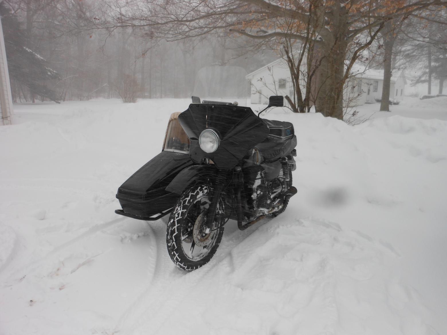

                        The paint has to be properly mixed. I use a mixing tool mounted to a drill. The trick is to use thin coats. 24 hours between coats. And don't use spray paint. It only lasts a few years in the harsh weather. I had severe corrosion on my snow-bike and this brush paint really holds up to the salt.
ID:	874098 Click image for larger version
ID:	874099 Click image for larger version
ID:	874100 Click image for larger version
Name:	KZB Snow 1.jpg
ID:	874101 Click image for larger version

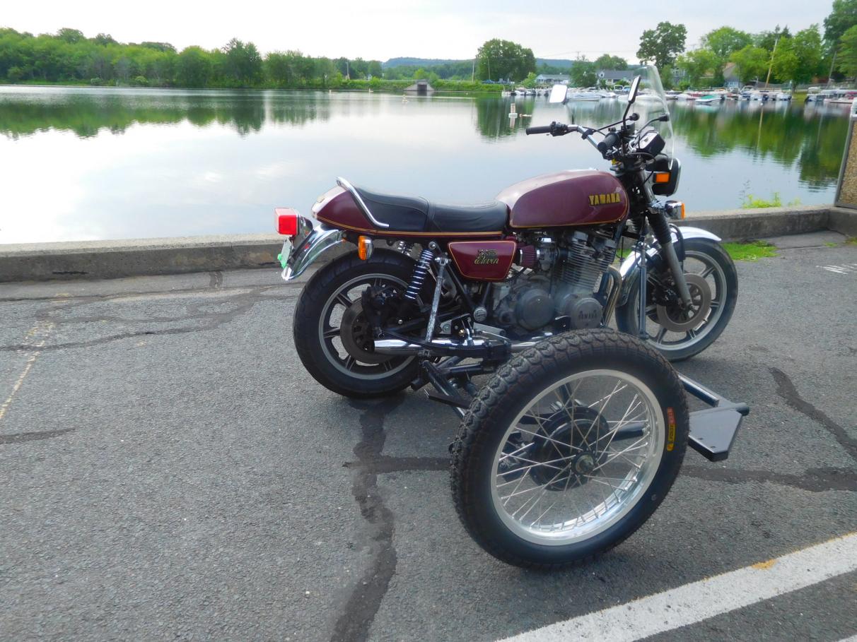

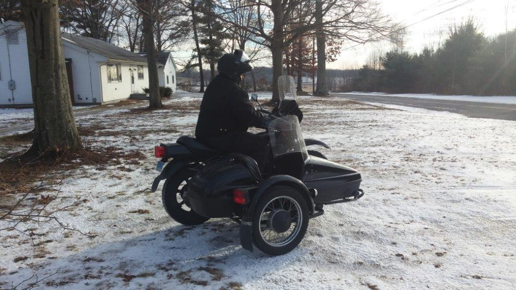

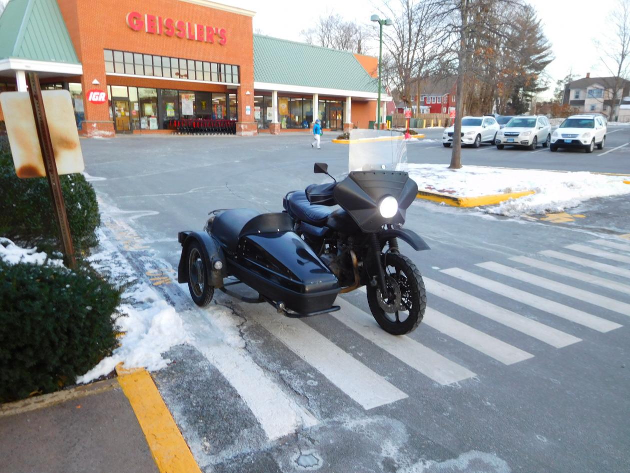

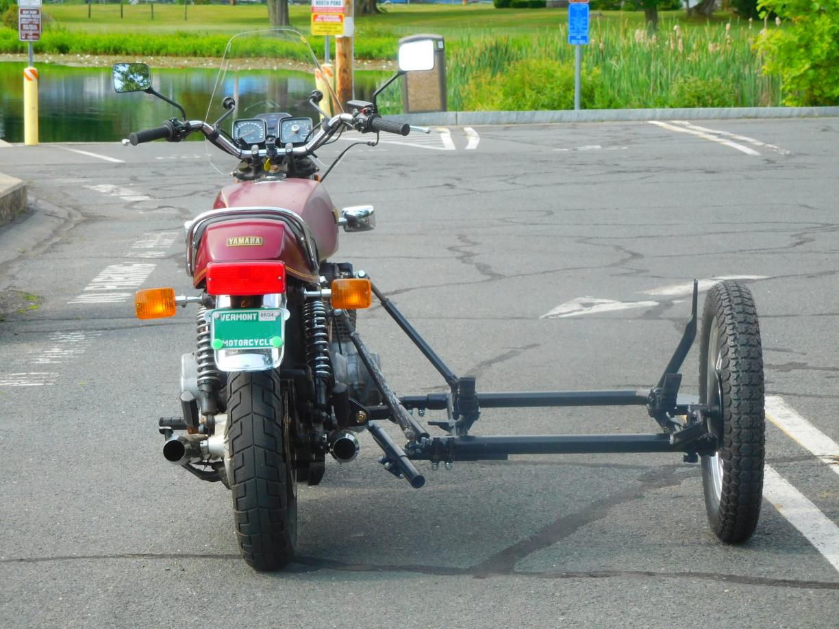

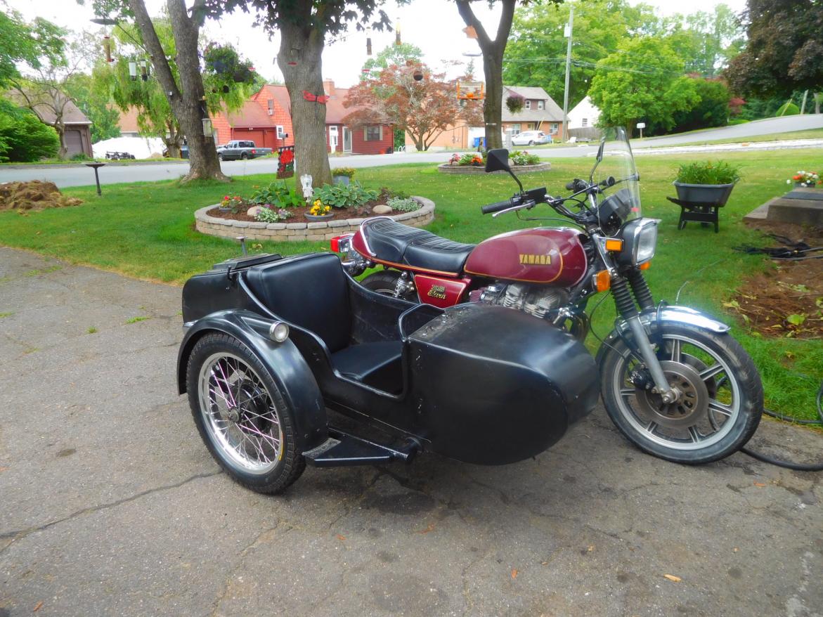

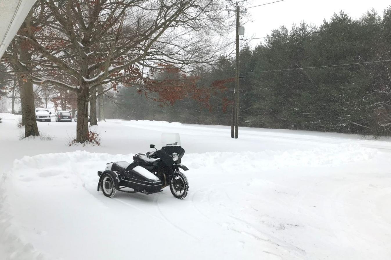

                            All hooked up. 3/4" toe in. 1° lean-out. Tracks nice and straight.
ID:	874171 Click image for larger version
ID:	874172 Click image for larger version
ID:	874180 Click image for larger version
ID:	874181 Click image for larger version

                                Nicely done! I've considered an "outrigger" for lack of a better term for winter grocery getter use.
