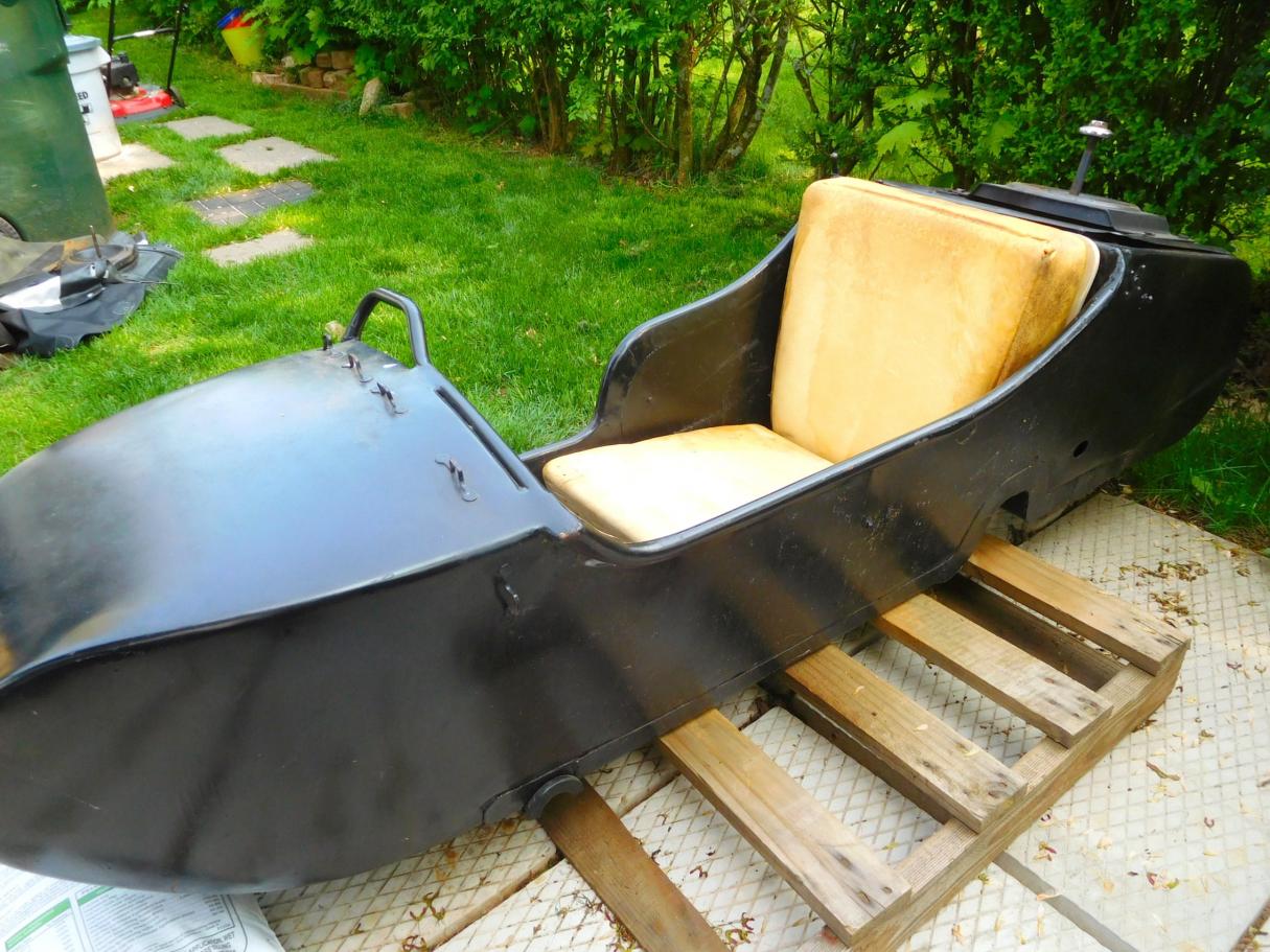

          • 2069
          This is the CJ sidecar. I have DMZ mounts to weld up. The front lower mount will be a challenge. Got some ideas. Might need a sub frame. It's a big and powerful machine..

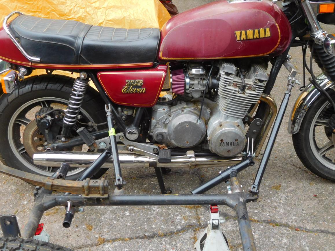

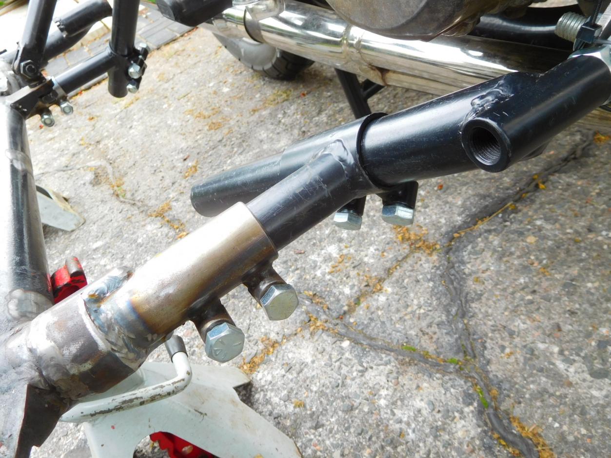

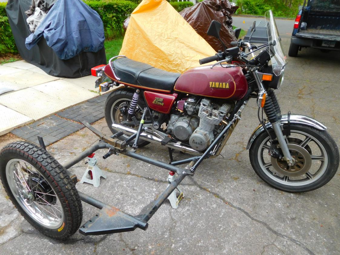

                            • 2069
                            OK, I just got the welding done and am now measuring the hook ups. About 10" lead from the rear axle to the sidecar axle. Cut off the ball mounts and welded heim joint mounts. Super strong.

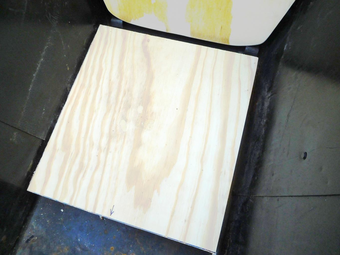

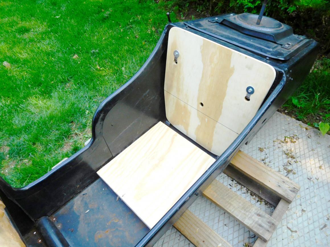

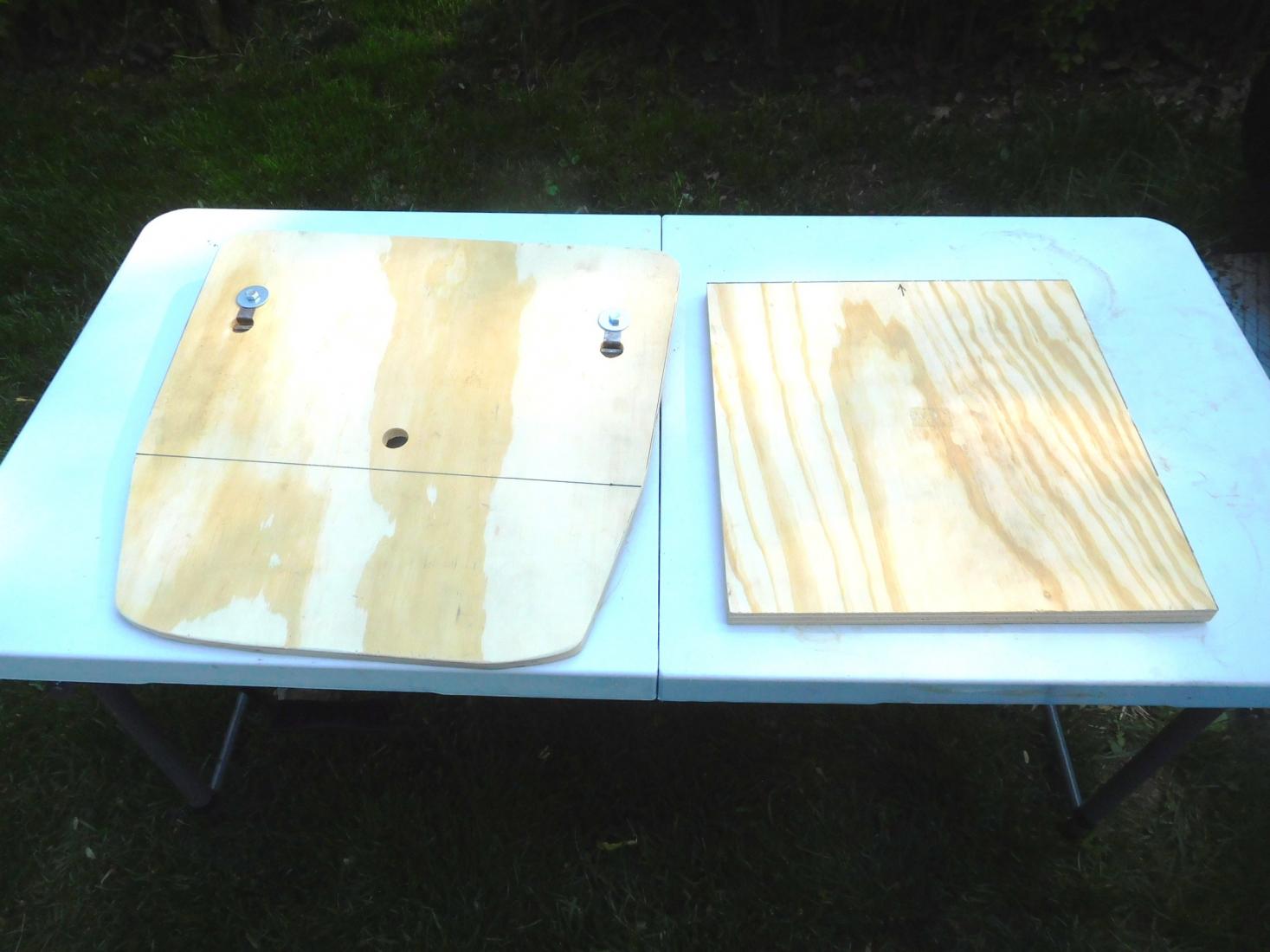

                              • 2069
                              Working on new seat covers and plywood bases. Will re-use foam as it is in good condition.
