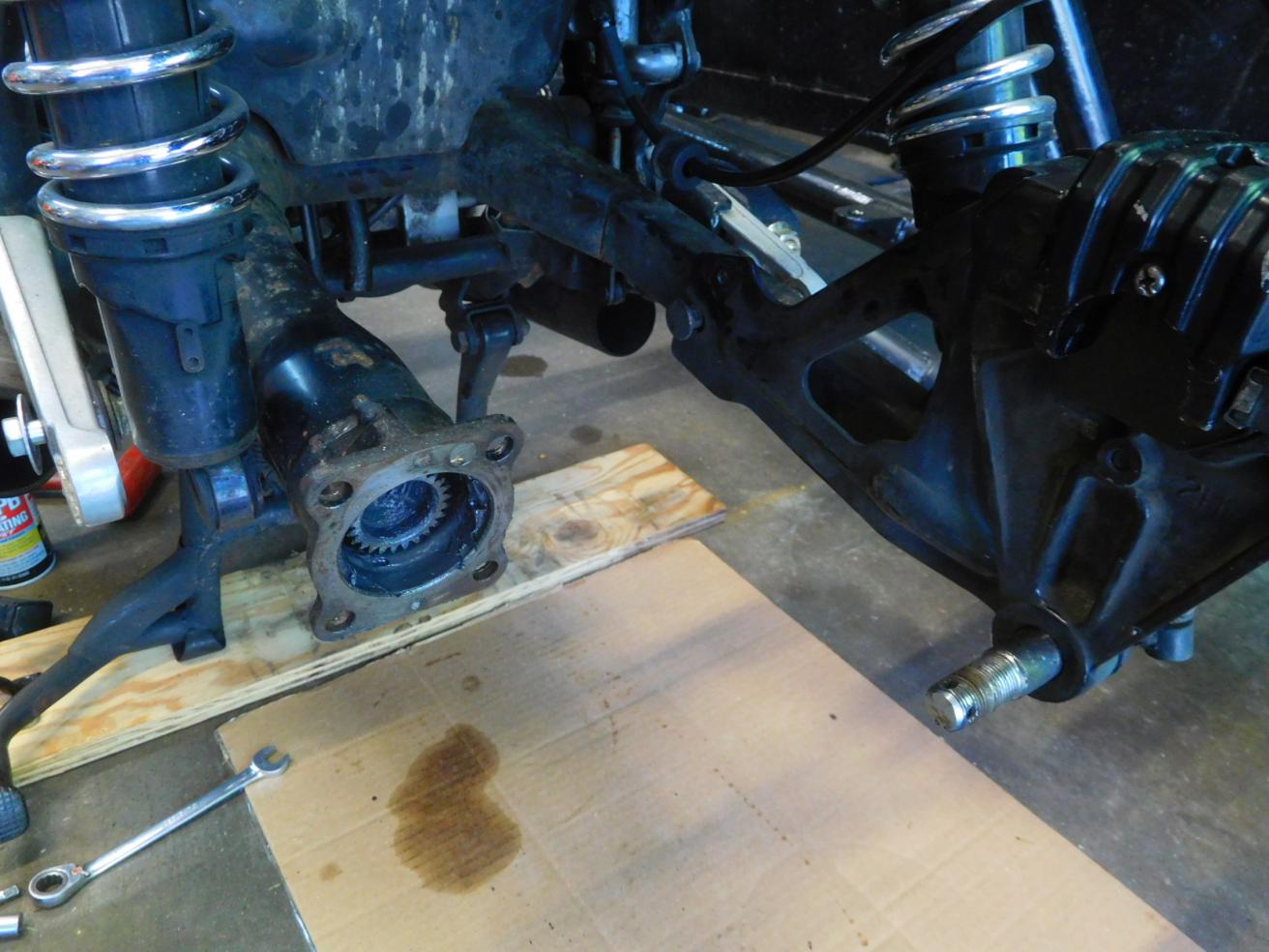

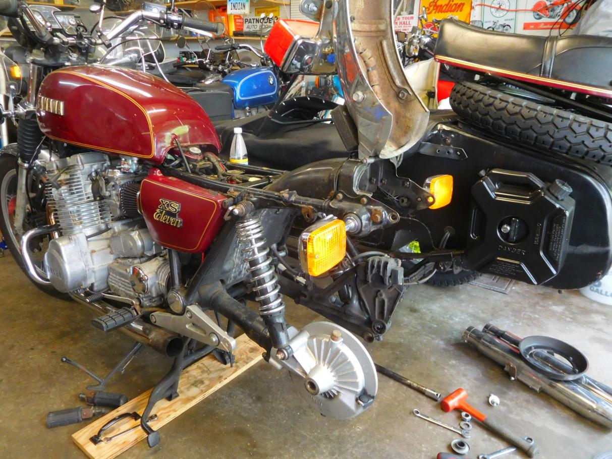

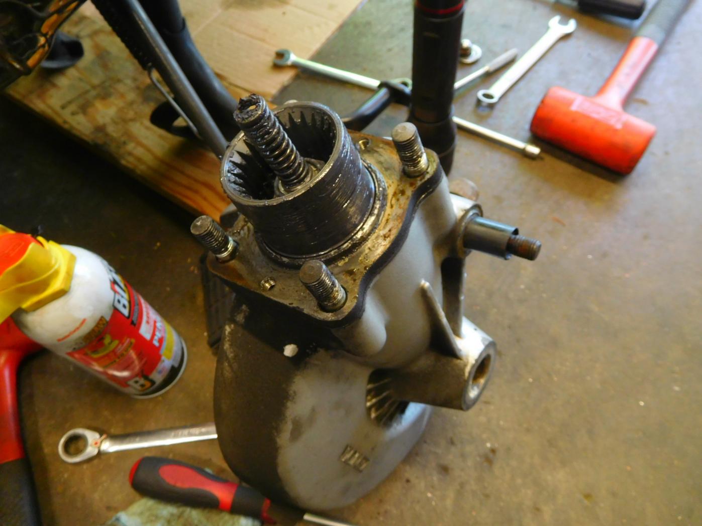

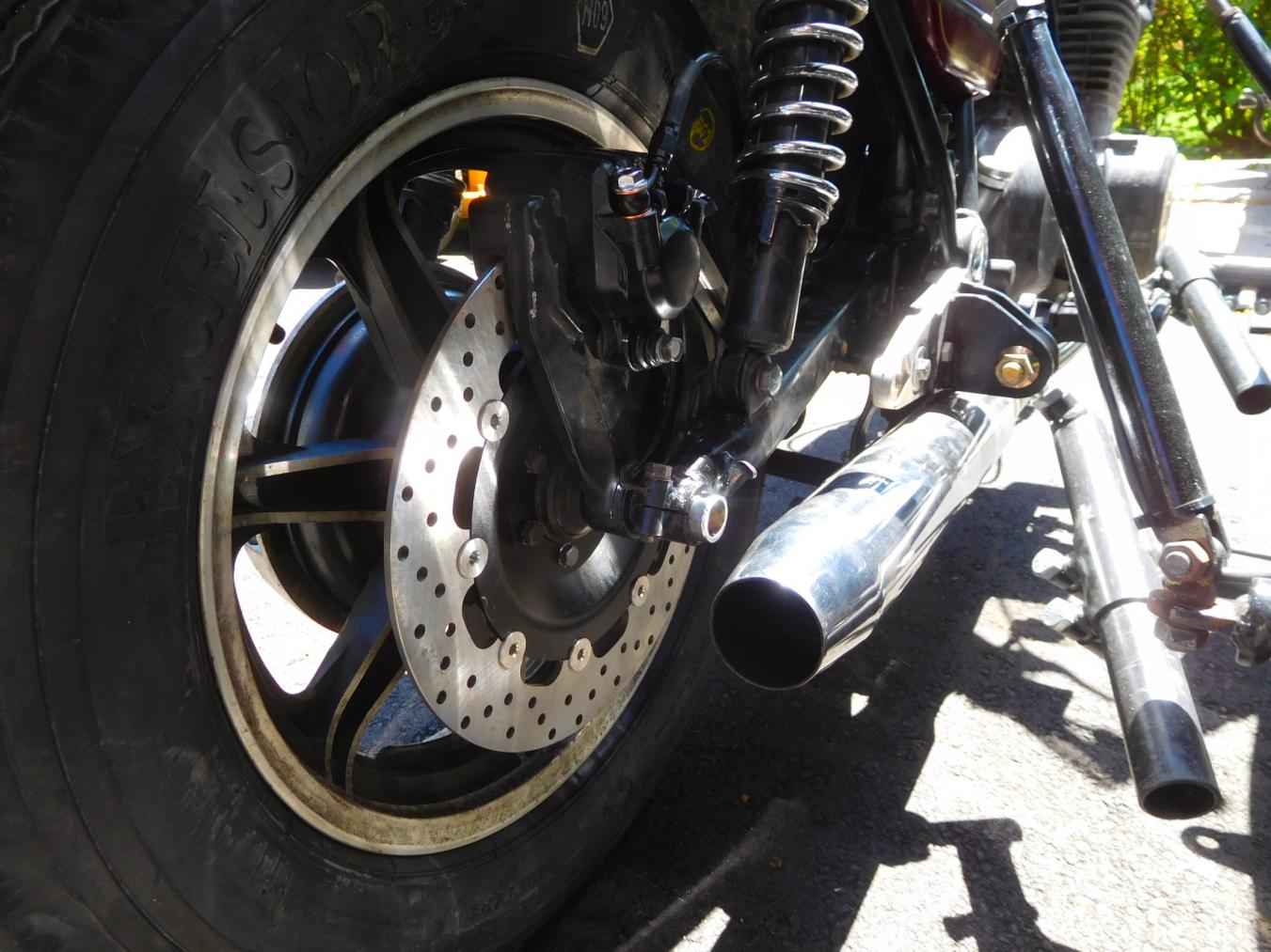

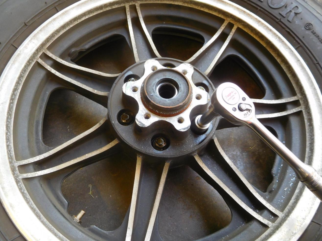

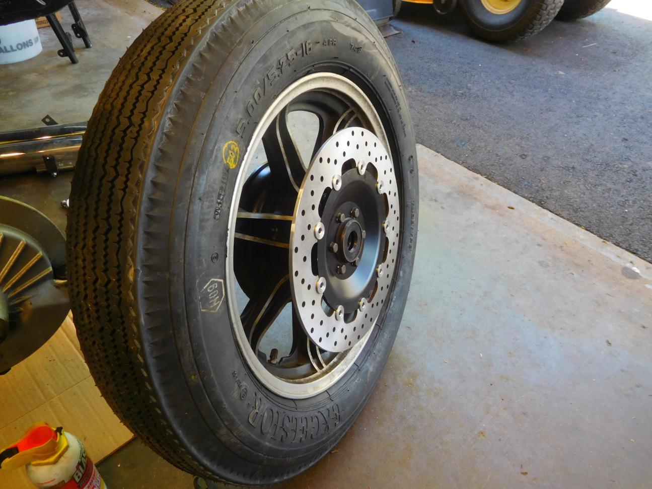

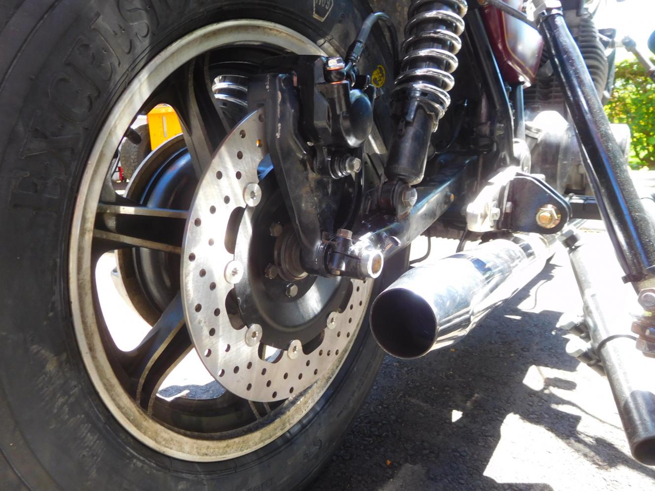

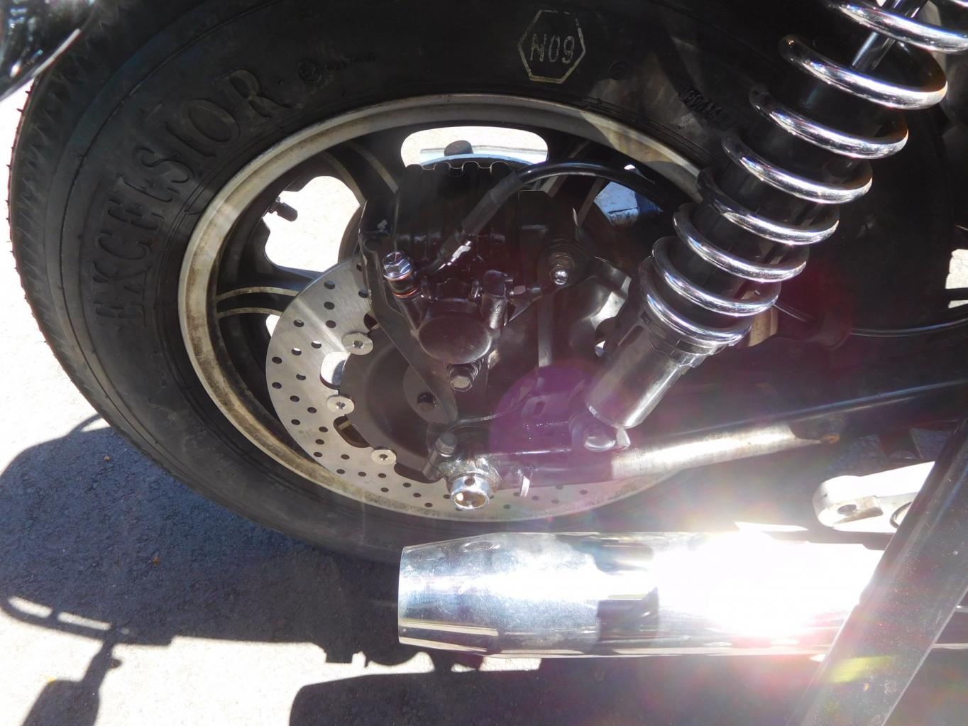

    More work. All new rear wheel bearings including genuine Yamaha special bearing and new seals. Rebuilt rear caliper with new piston & seals. 3rd floating rotor. Black stainless 17" brake line. Spline service. New tire & tube.

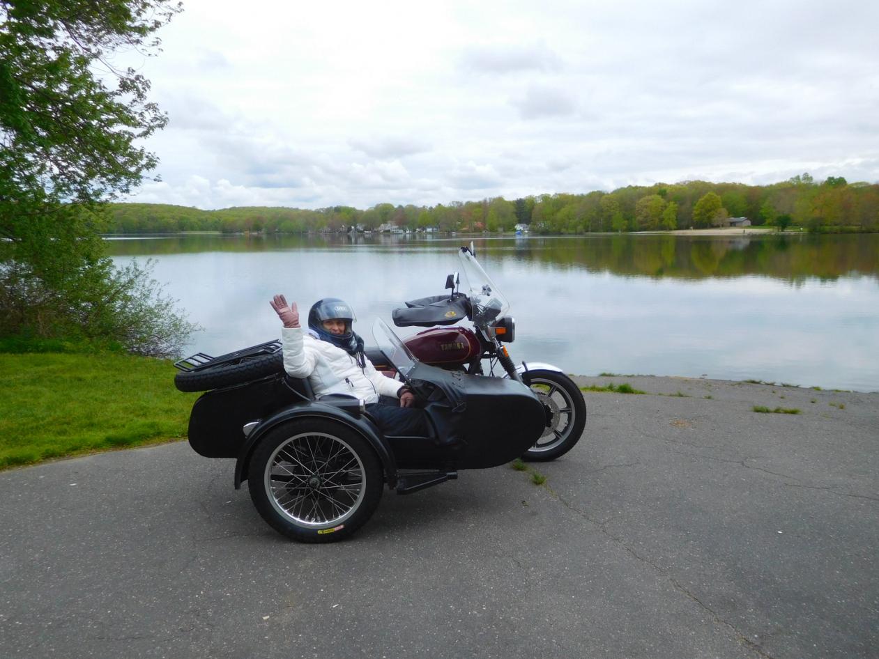

        • 1932
        #108
        Mom on Mother's day!

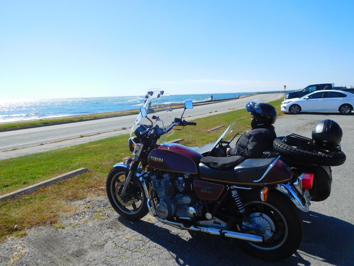

          • 1932
          #109
          On The Road.

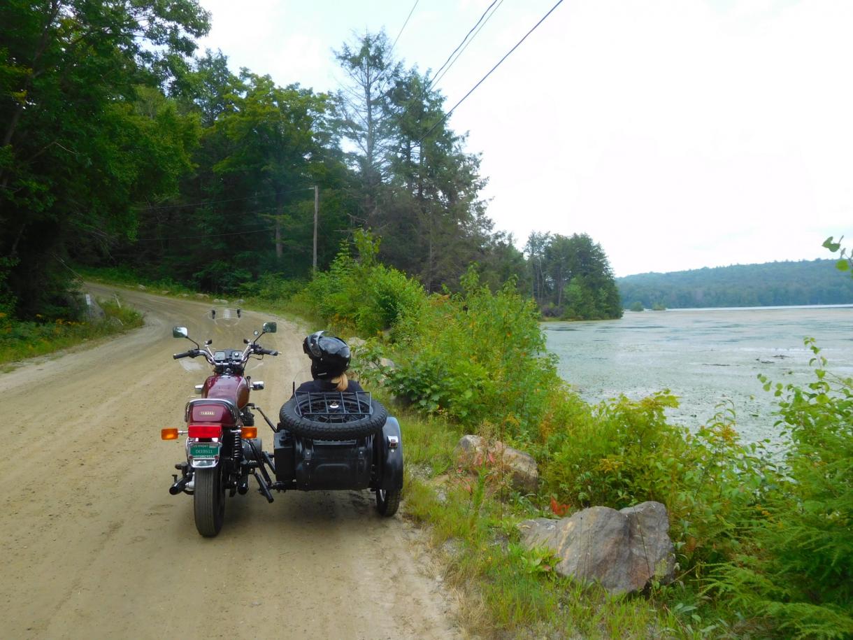

            On the road. Granville MA.

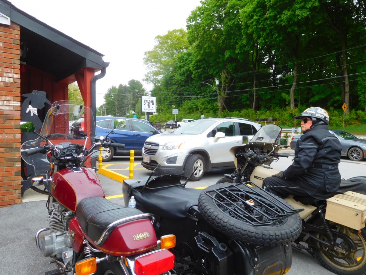

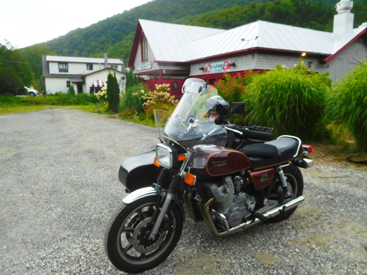

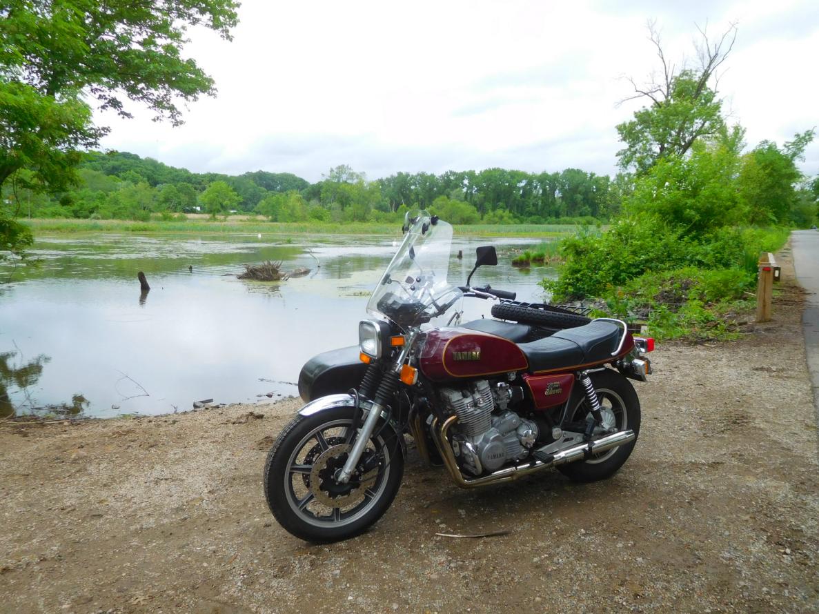

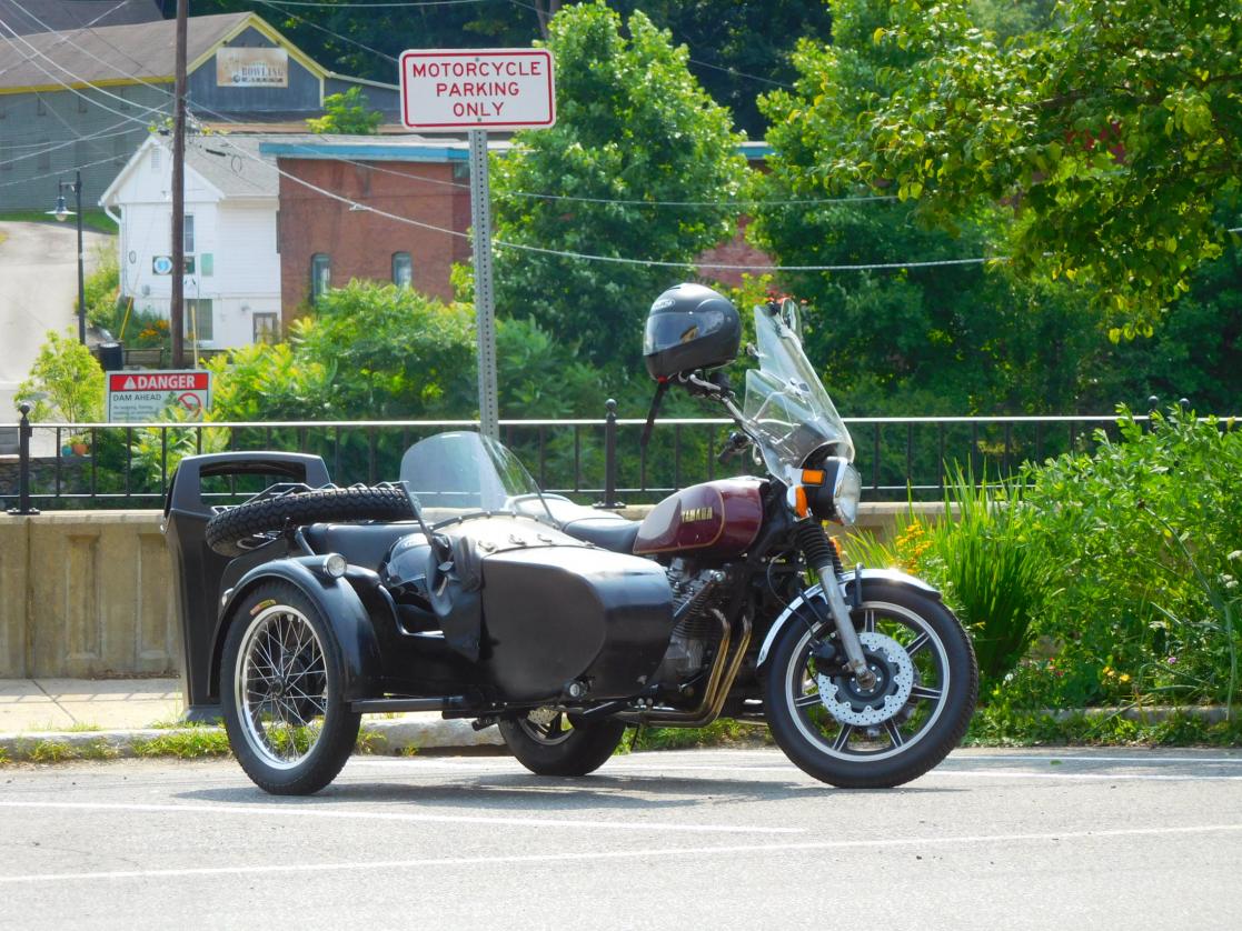

              On the road. Just turned 10,000 miles on the rig. Living the dream.

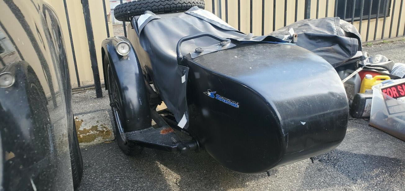

                        this is what im wanting to do to my 1979 yamaha xs1100 since a long time. where did you get your sidecar at and the mounting hardware? i have a welder too. any info would be appreciated. gary in Fort Worth Texas

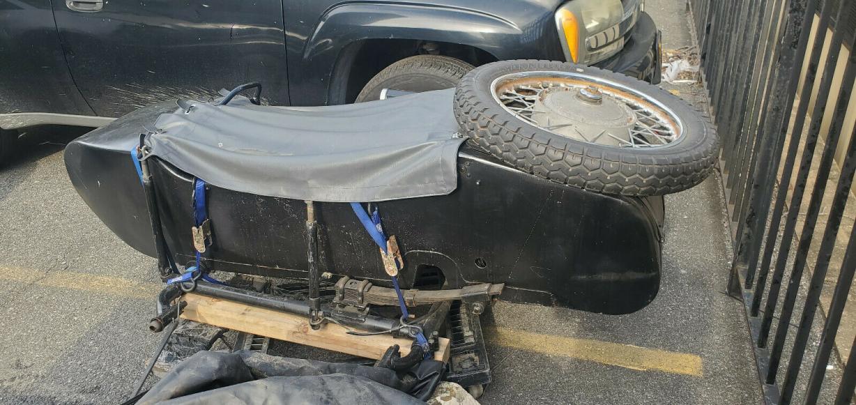

                          • 1932
                          #117

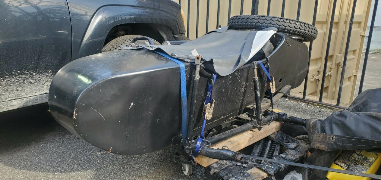

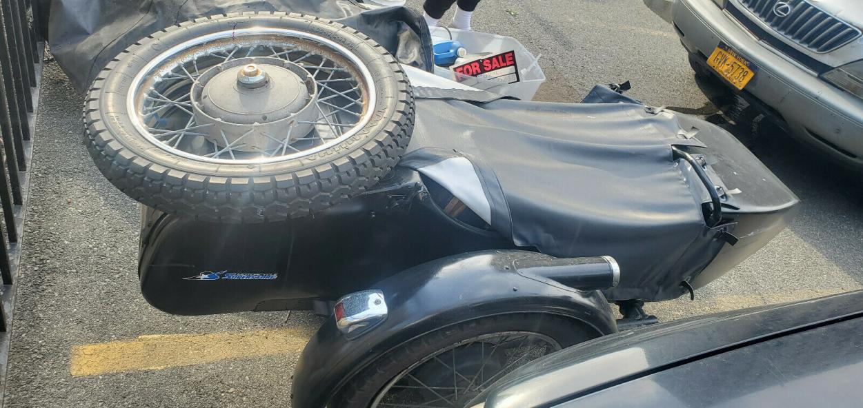

                          Hi Gary, the M72 CJ750 sidecar is ex military and is well suited to the power of an XS11. I picked this unit up in front of Coney Island in Brooklyn New York several years ago. It needed a lot of work. The bike needed a lot of work. The fabrication work was very time consuming. Most of your questions can be answered by reading this post from the beginning. I tried my best to be detailed in the construction of this project. Hopefully it will be helpful to you and others long after I am gone.

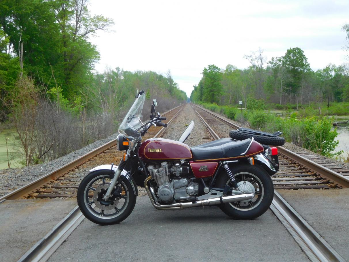

                            Pulled out the bike (after 3.5 month layup). Took out the drain plugs on the carbs and turned the manual petcock on and flushed fuel through the carb bowls into a stainless catch. Returned the plugs with new copper crush washers. Put air in the tires and off we went. Ran great. Pulls like a train.
